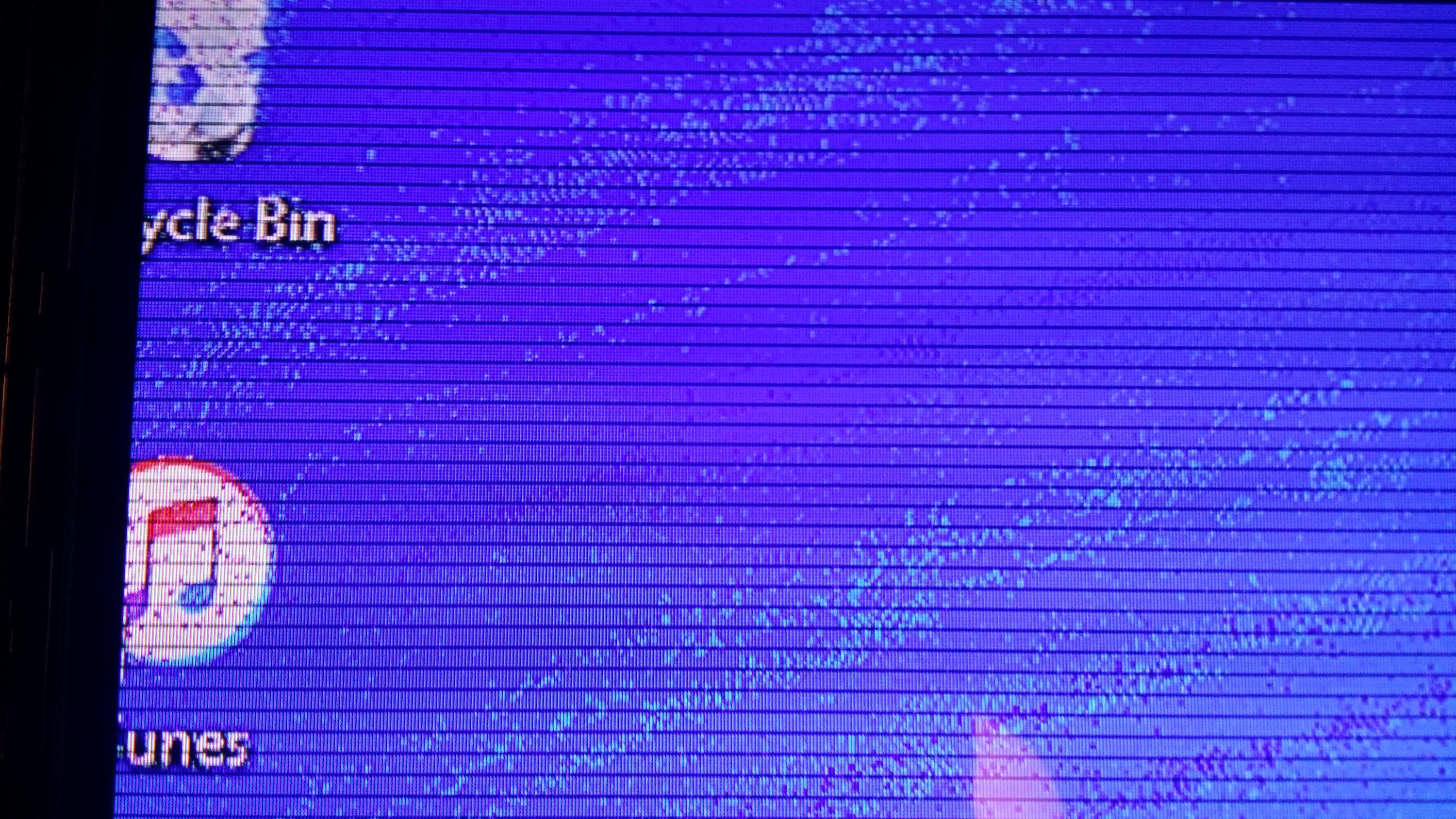

    Samsung UN55B6000VFXZA bad panel?
    I put some pressure with a pencil eraser on the panels tab bonds and on the TCON bonds but it did not make any change.
    Is it worth trying a new TCON or is this another crapped out Samsung panel?

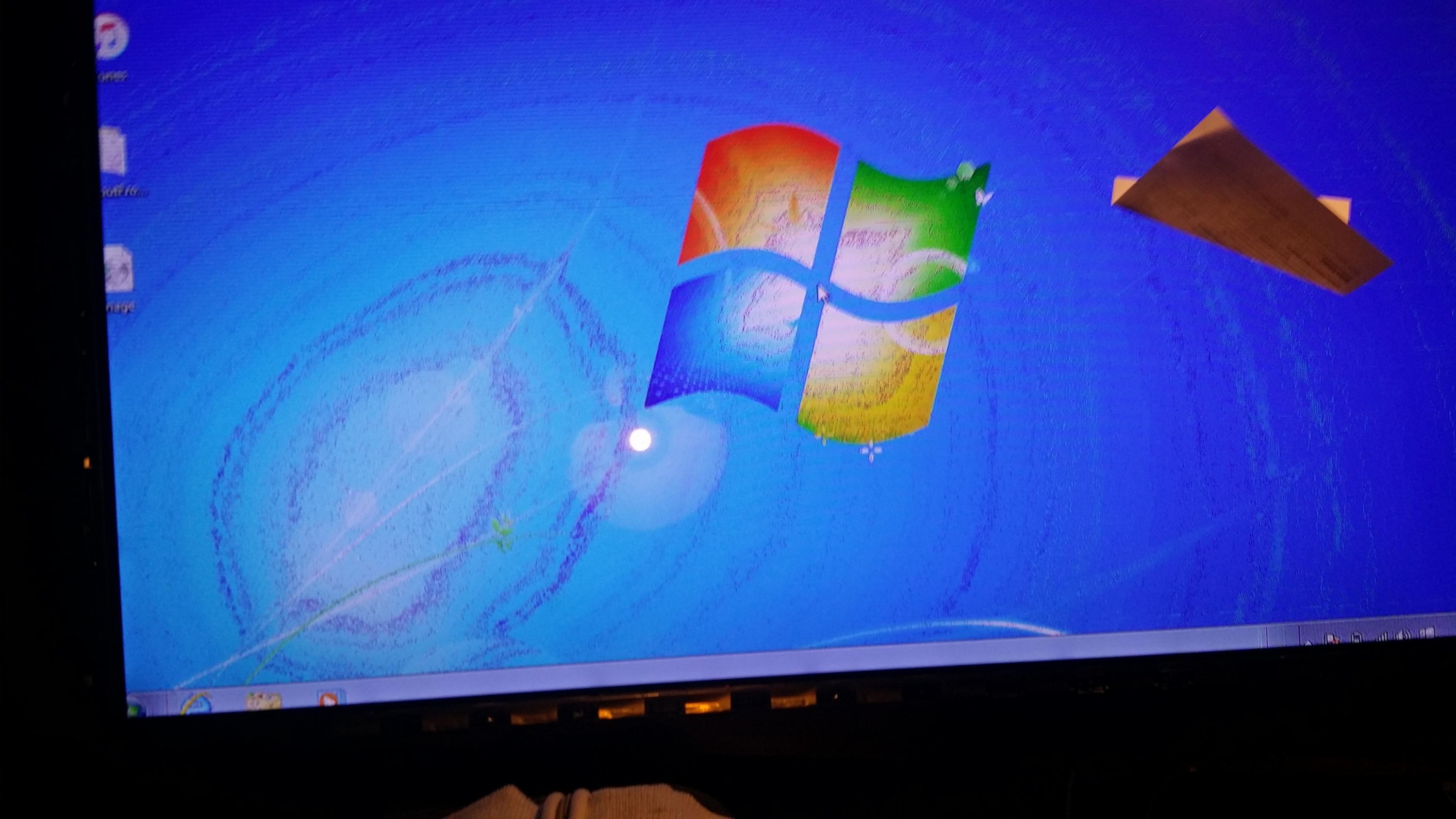

    Re: Samsung UN55B6000VFXZA bad panel?
    the way it is rippling out from a central point (at least thats what i think i see) makes it seem like something either hit the screen or bumped into it.
        I think that is being caused by the Windows 7 background. I should have set it as a solid color.
          odd indeed... x2 looks like solarized a bit though...
            Bad panel and bad t-con, notice black horizontal lines in photo two are very common in B series LED Samsung panels and there is no fix or no known cause as to why they happen.
            Sometimes they cover full screen or most common is left to middle and dither out on the right side
            If the t-con is cheap you can try to see if it remedies the solarazation issue but those lines will probably stay.
            • Shinju
              • Mar 2014
              • 1239
              One other thing you can try before spending money on parts is to access the service menu and locate the test patterns and see of those lines persist post t-Con or pre t-con.
