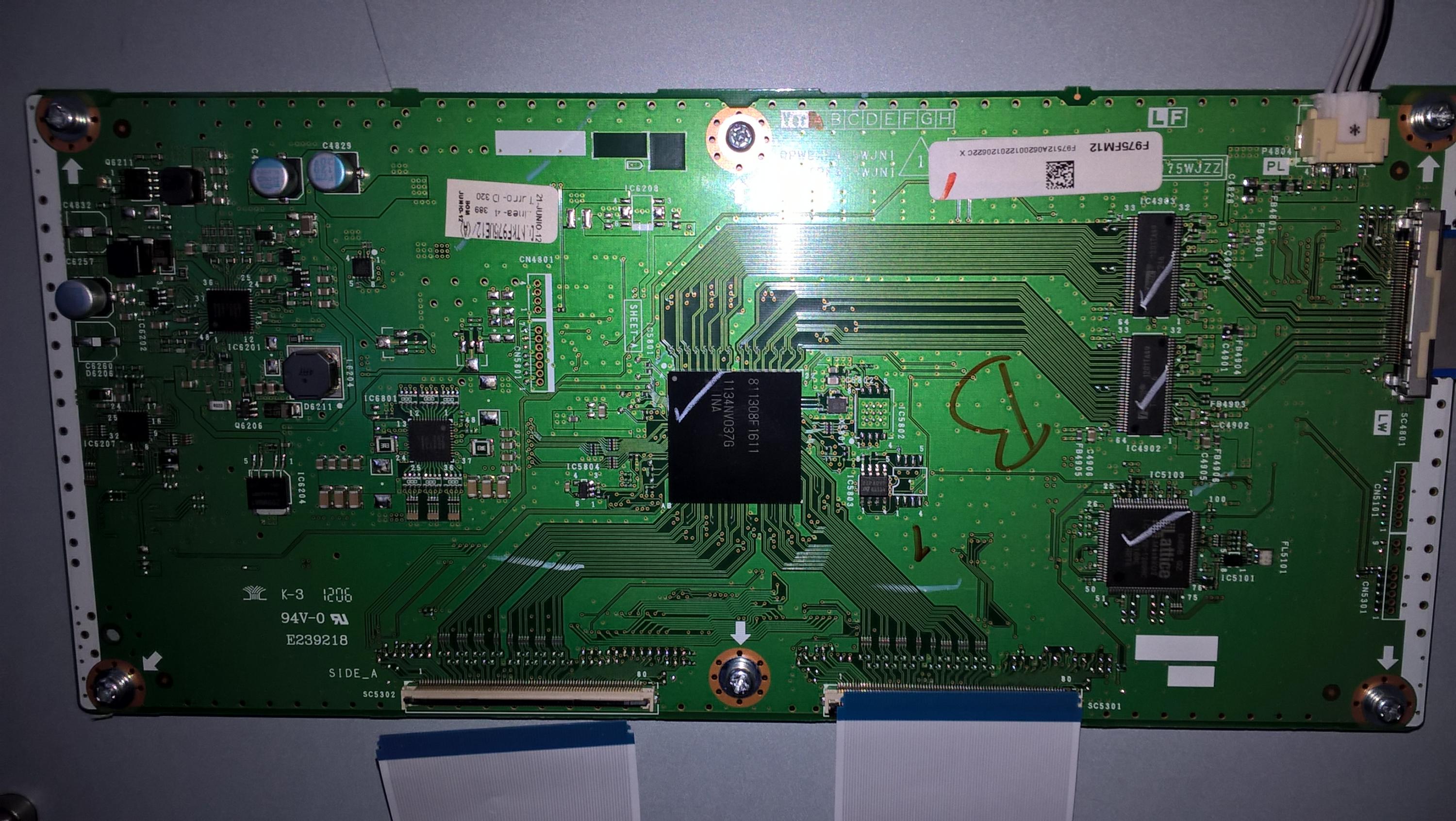

    I do have some hope because it appears the T-con is shorting out the 12V lines. If I disconnect the 4 pin connector I have 12V sitting there (until the PS clicks and goes into shutdown). If during this time I connect the cable back to the Tcon the voltage drops to near 0V. So according to TIP1541 I should replace the Tcon board.
    I don't mind buying all new boards, but I don't want to throw any good money at it without knowing the panel is good. I can't see any visible signs of damage... but I also do not get any backlight flashing or any sign of life coming from the screen. Is there anything I can do to trick the backlight on? Or any other things I can try that might make me feel confident the screen is ok?

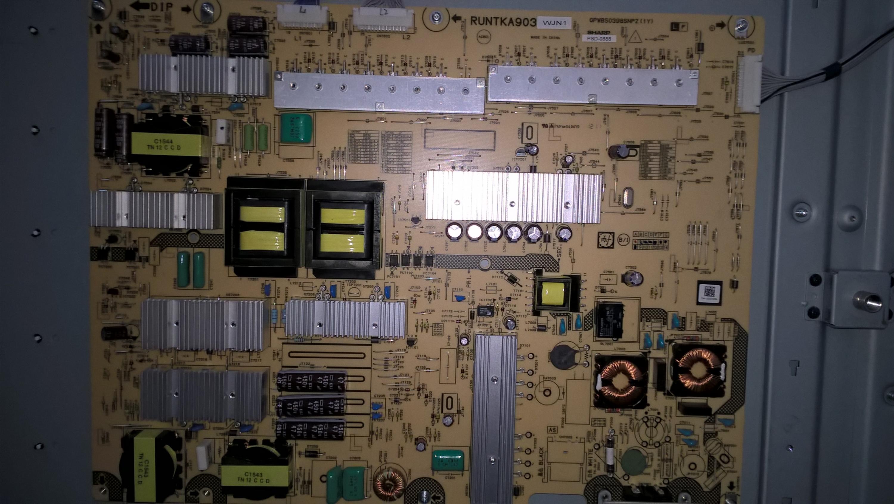

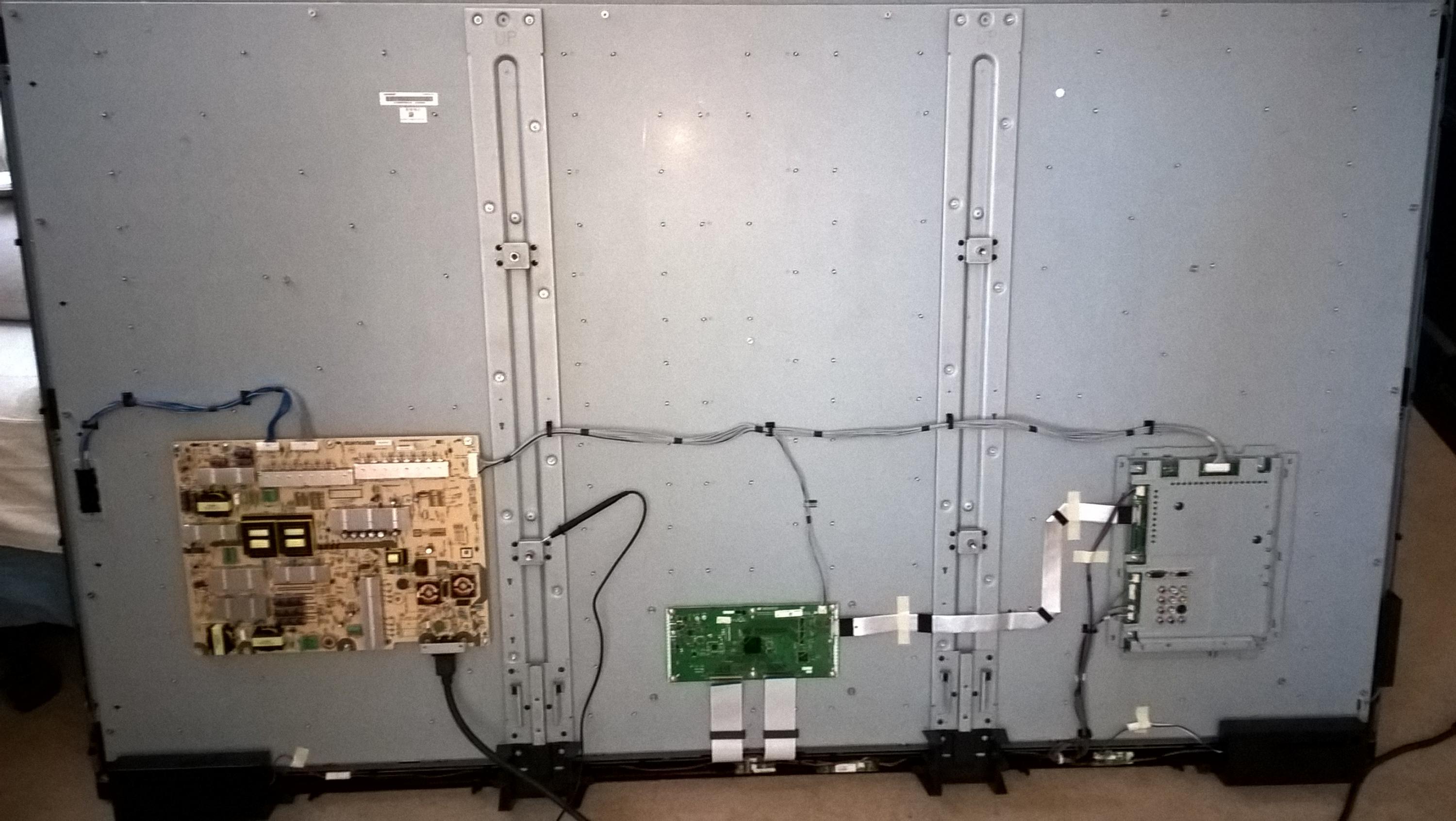

      Posting pictures of the back of your tv showing the boards with clear pictures may help you more with fixing your problem

        Re: Another LC-80LE632U 2-5 thread
              Ok, holding all three buttons stops it from going to the 2-5 blink state. But I never see or hear any sign of a backlight.
              I have .7V on the 12V pin of PD, then disconnect the 4-pin PL connector on the tcon board and the 12VDC comes back. i.e. the Tcon is either shorting out the 12VDC, or the power supply no longer can supply enough current to turn it on so the volts drop to near 0.

                okay now disconnect both white flat ribbon cables going from the tcon to the panel in try the restart code again

                              Ok, I assume the Tcon power source is the 4 pin connector (PL)? When it is disconnected there is 12V coming from the power supply sitting at the disconnected 4 pin connector. When I connect the 4 pin connector back to the Tcon board there is 0.7V.
                              "probe tcon 12v output voltages and see if they briefly come up" <- Are you referring to the power supply 12V output? Or does the Tcon also have a 12V output?
                              Man, schematics sure would be nice! If I just had a power supply schematic I know I could figure out a way to power up those backlight led's... without a Tcon or a main board even connected. I'd bet the main board is just sending discrete signals to it.

                                I would have thought that if the Tcon was taking down the 12v line that it would have blown the onboard fuse on the Tcon. Can you load up the 12V line when disconnected from the Tcon with resistors and check it is supplying reasonable current. Power supply problem?

                                  I was thinking the same thing... the Tcon board measures about 4 ohms between the +12V pin and gnd and is dropping the voltage to 0.7V. Is my thinking right for that 12V PS to only be sourcing 175mA?
                                    you would be better off tracking / checking ALL the voltages "labeled" on the power supply. I doubt that the tcon is bad. More than likely you lost a section of the power supply... further check all diodes on the power supply as some have found ones to have been "broken". Once replaced, they are happy.
                                    • dick_barton
                                      • Aug 2015
                                      • 6642
                                      • Wales
                                      I'd agree with budwich and take a real good look at the power supply. Check the fuse rating of the fuse on the Tcon and that should tell you what it expects in terms of current.

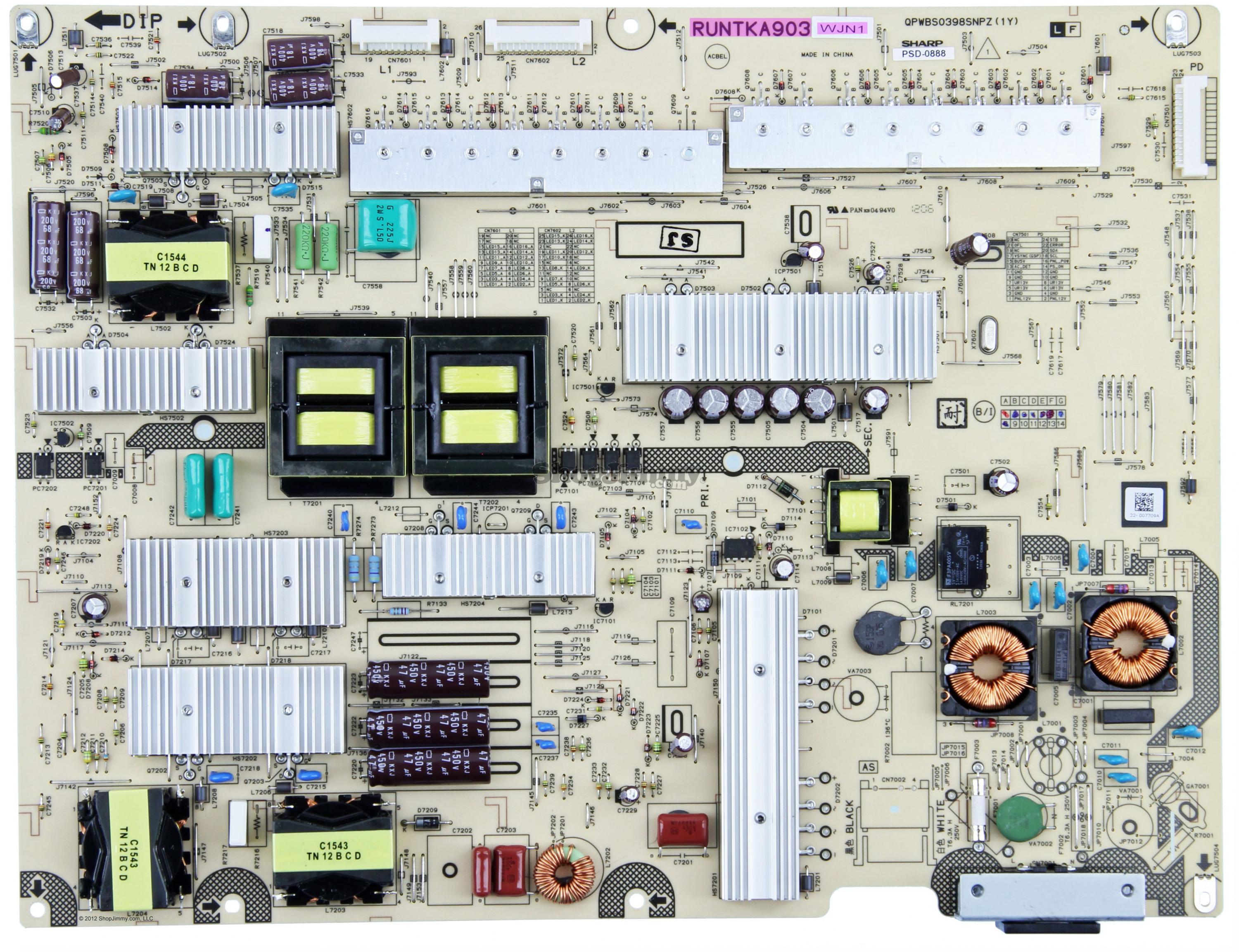

                                        It this your exact power supply-LED driver board?
                                        Sharp RUNTKA903WJN1 Power Supply LED Board.
                                        http://www.shopjimmy.com/sharp-runtk...pply-unit.htm#
