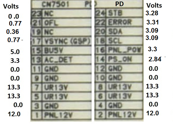

        #63
        Re: Another LC-80LE632U 2-5 thread

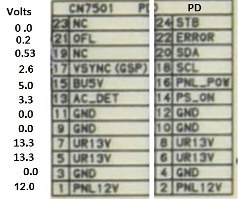

        I am not getting to go into the Service Menu I just get a flash of the backlight.

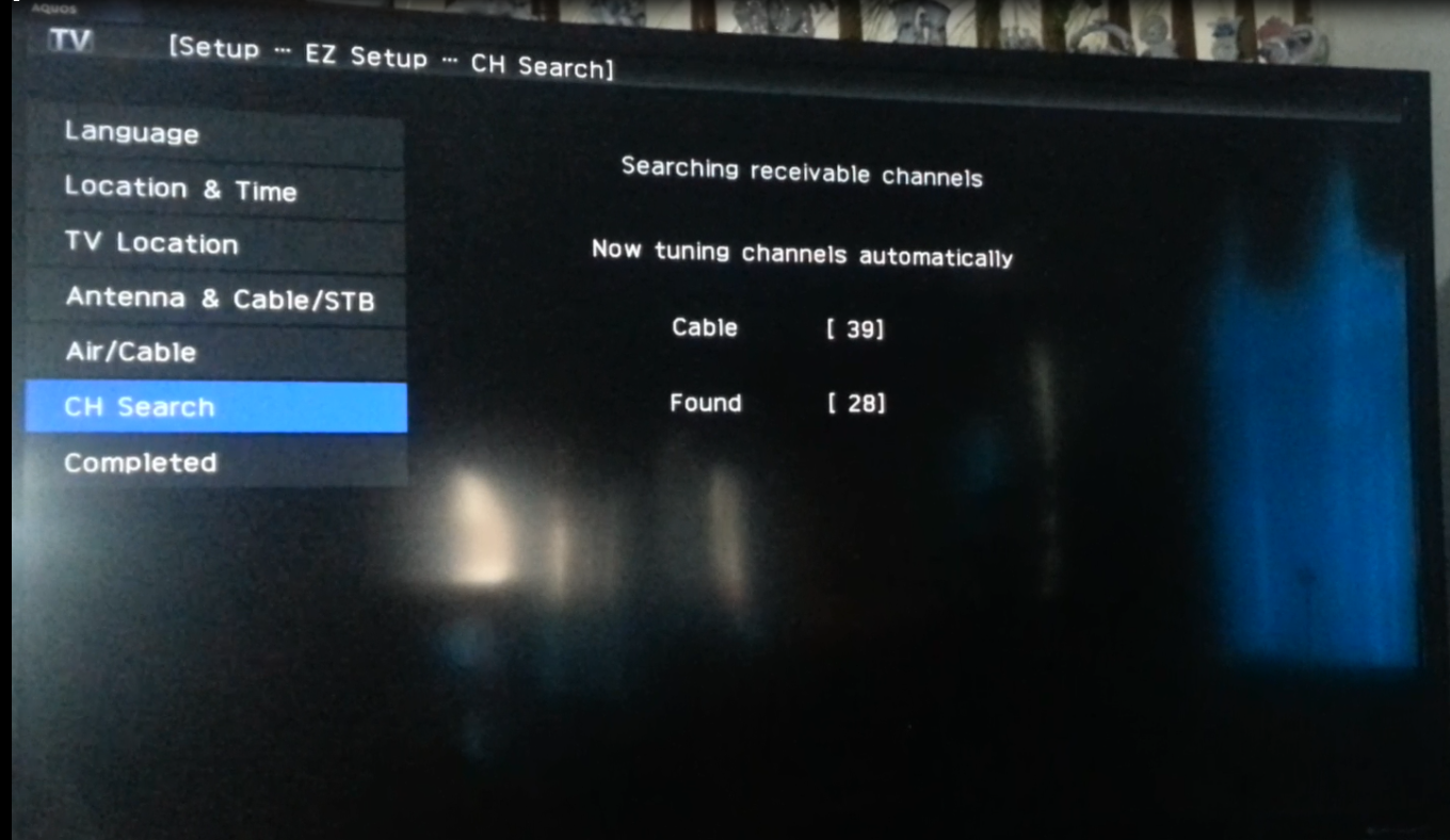

        I left it disconnected overnight and when I switched it on today I got a view of the Menu long enough to tune all the cable channels then after that the backlight went off but if I switch the TV off then back on I just get a flash of the Menu or Channel. I made a video of this event but the file is around 190mb so I did not upload same.
        I did a re-check of the voltages at connector PD without backlight and a steady Power light and got the following results in the attached jpeg file.
          #64
          Please see attached Jpeg with the voltages on all pins.
            #65
            if I understand the readings (limited experience), the system is erroring.... but I don't see anything else. :-( maybe someone else will have an idea. might want to post pictures of some of your "board work" just in case people can spot something.

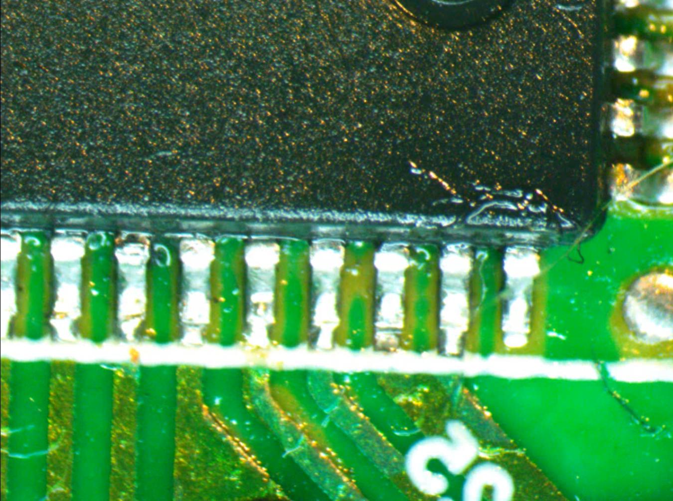

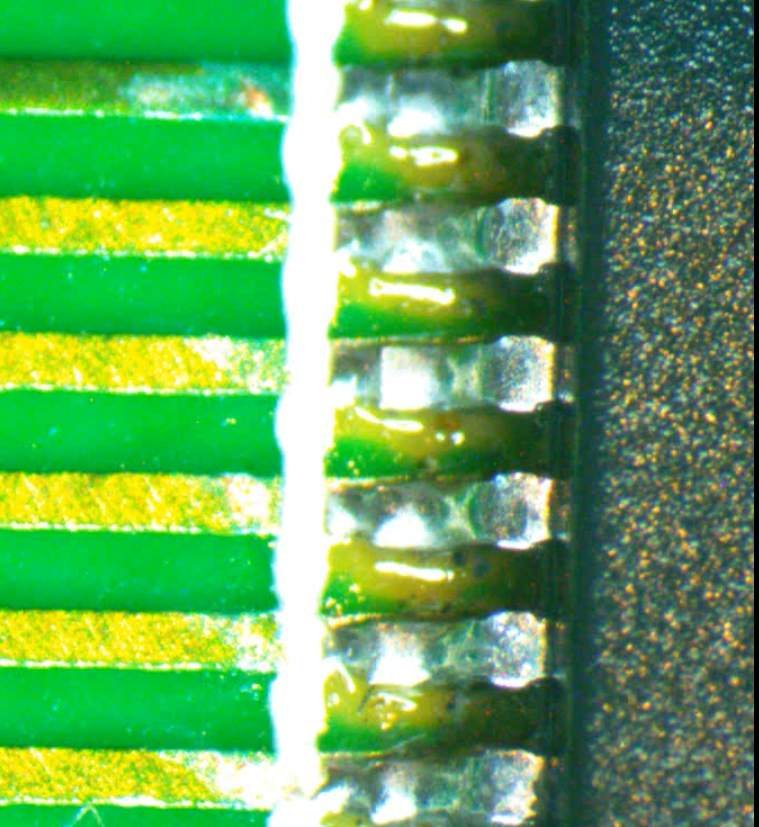

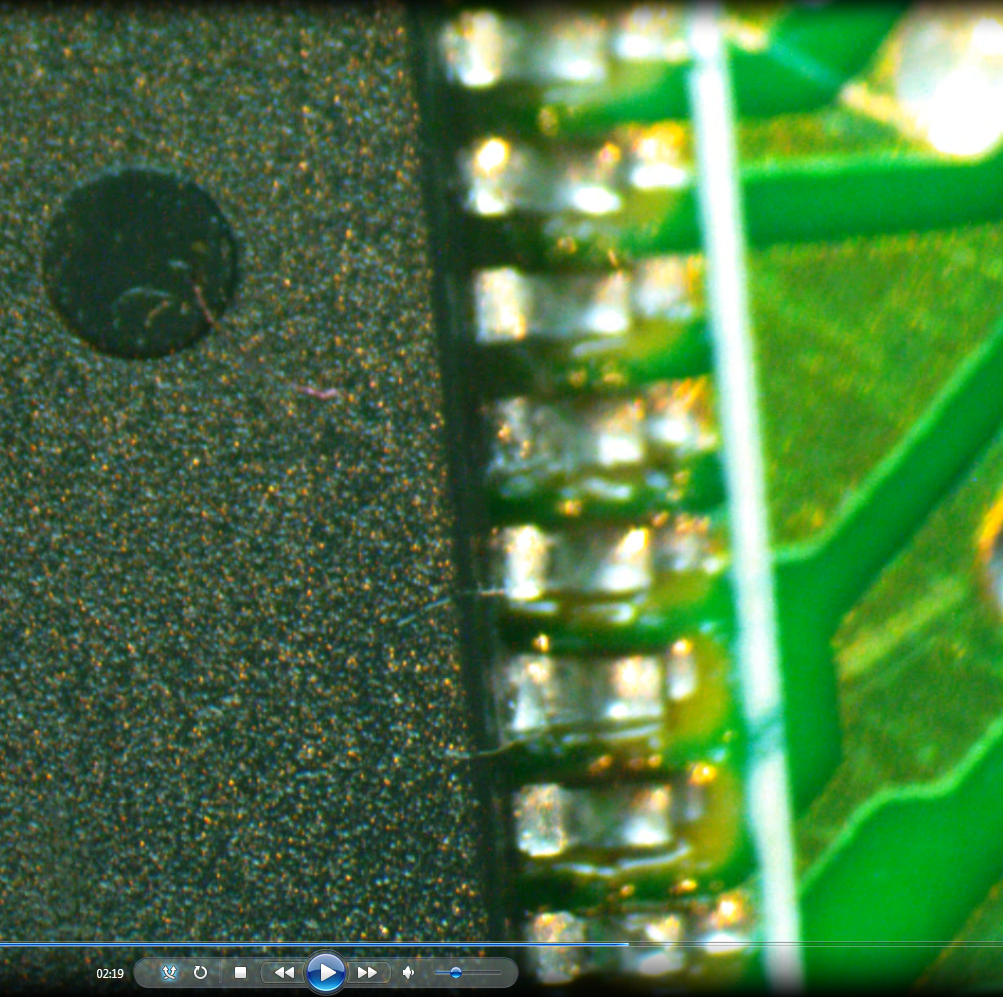

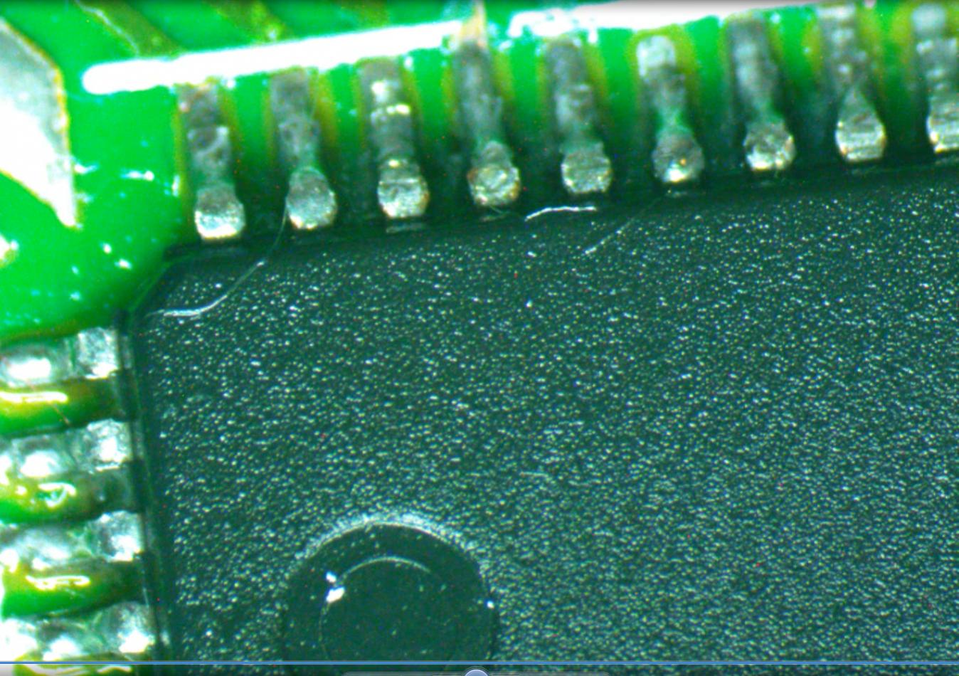

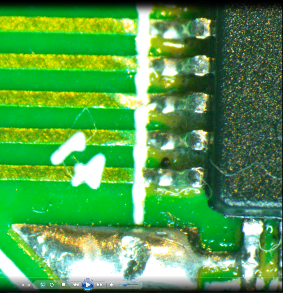

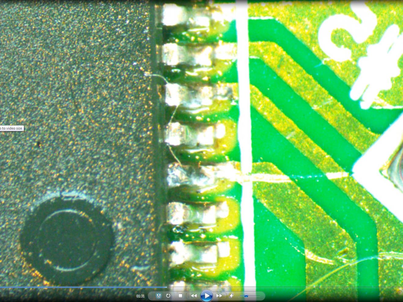

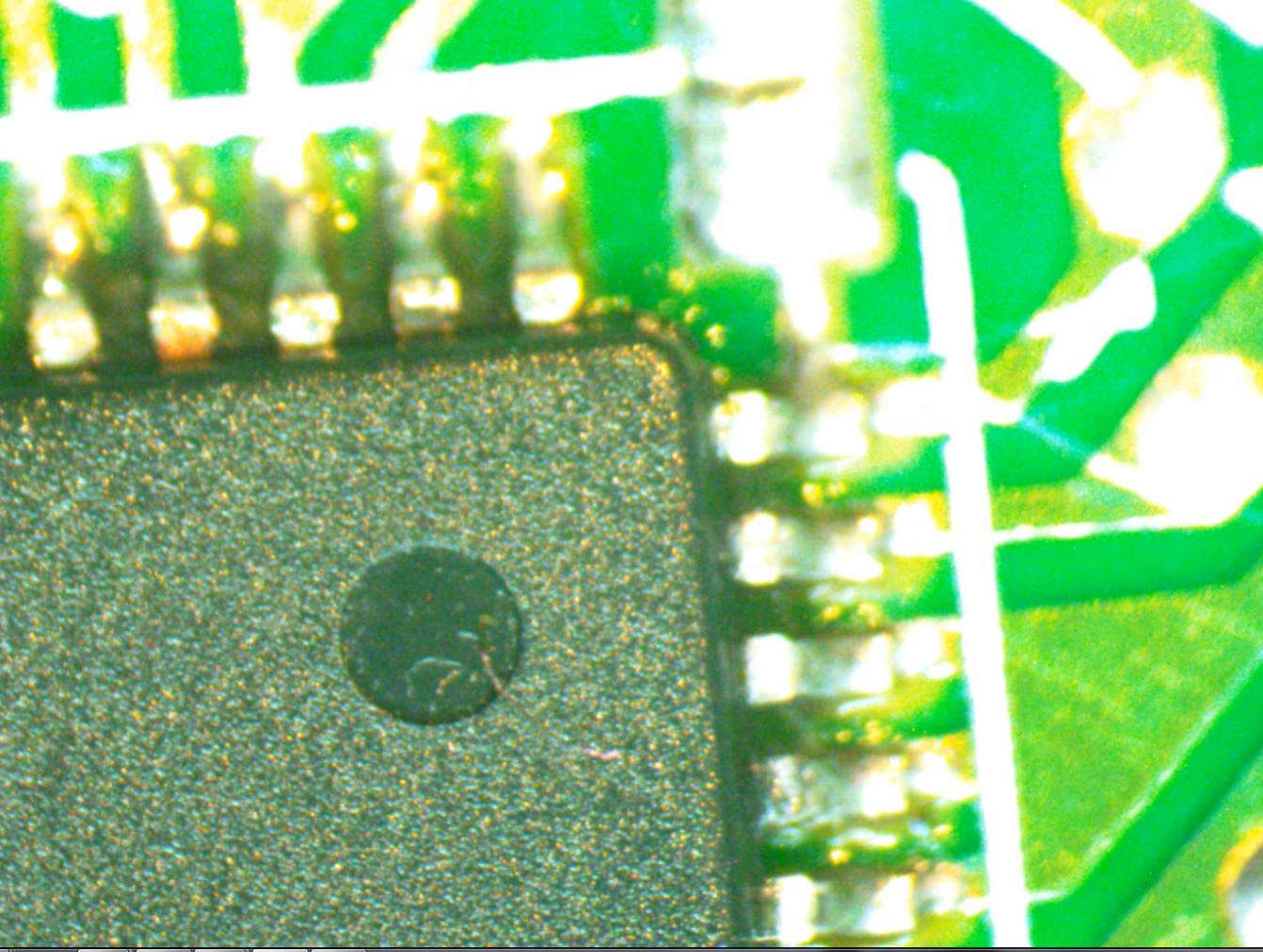

              #66

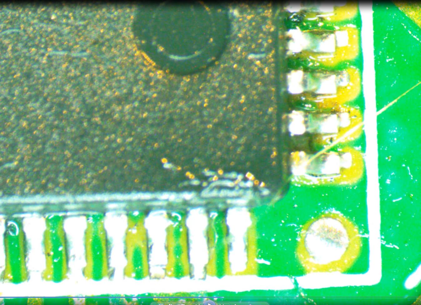

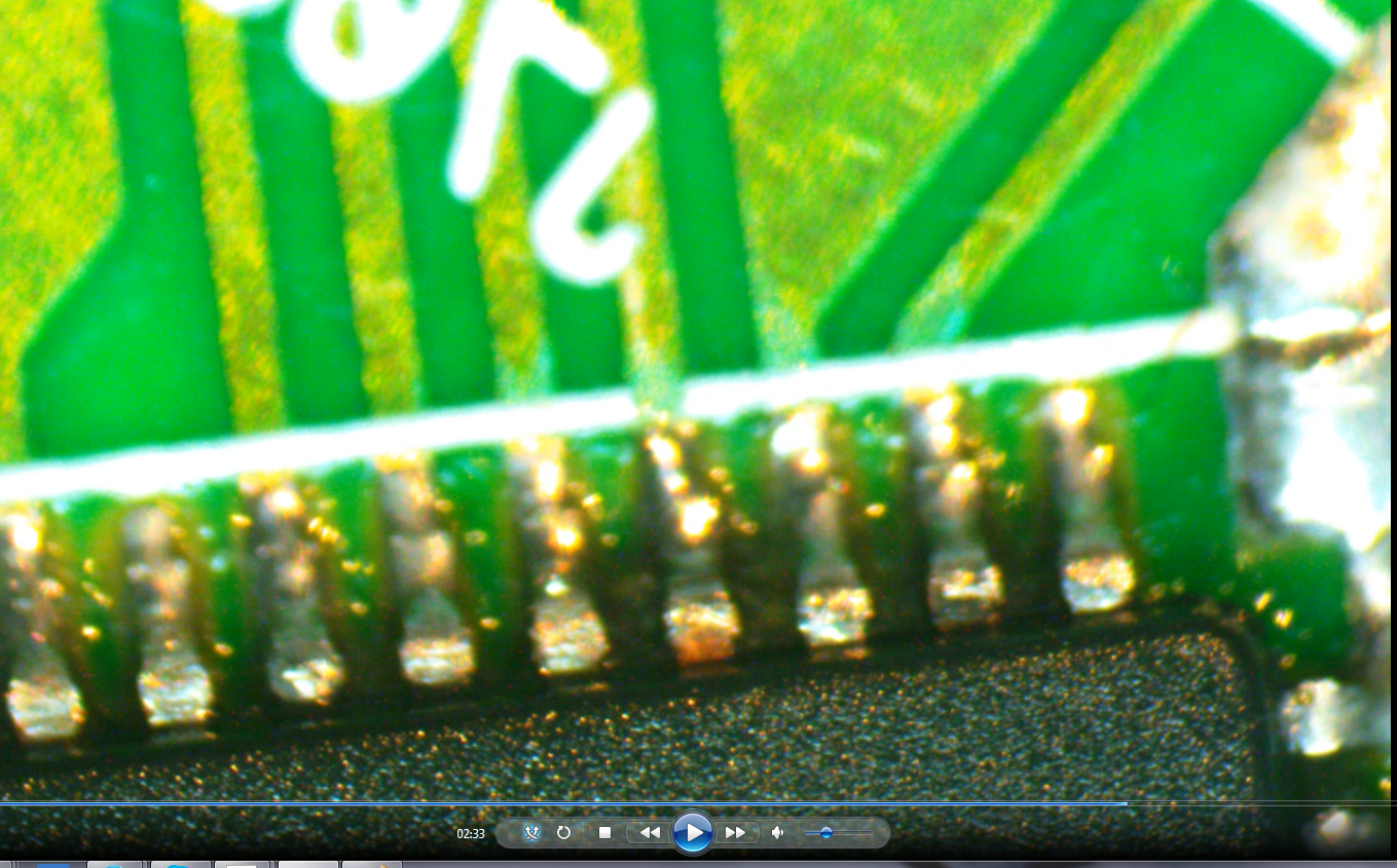

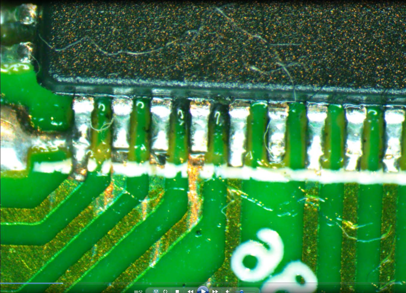

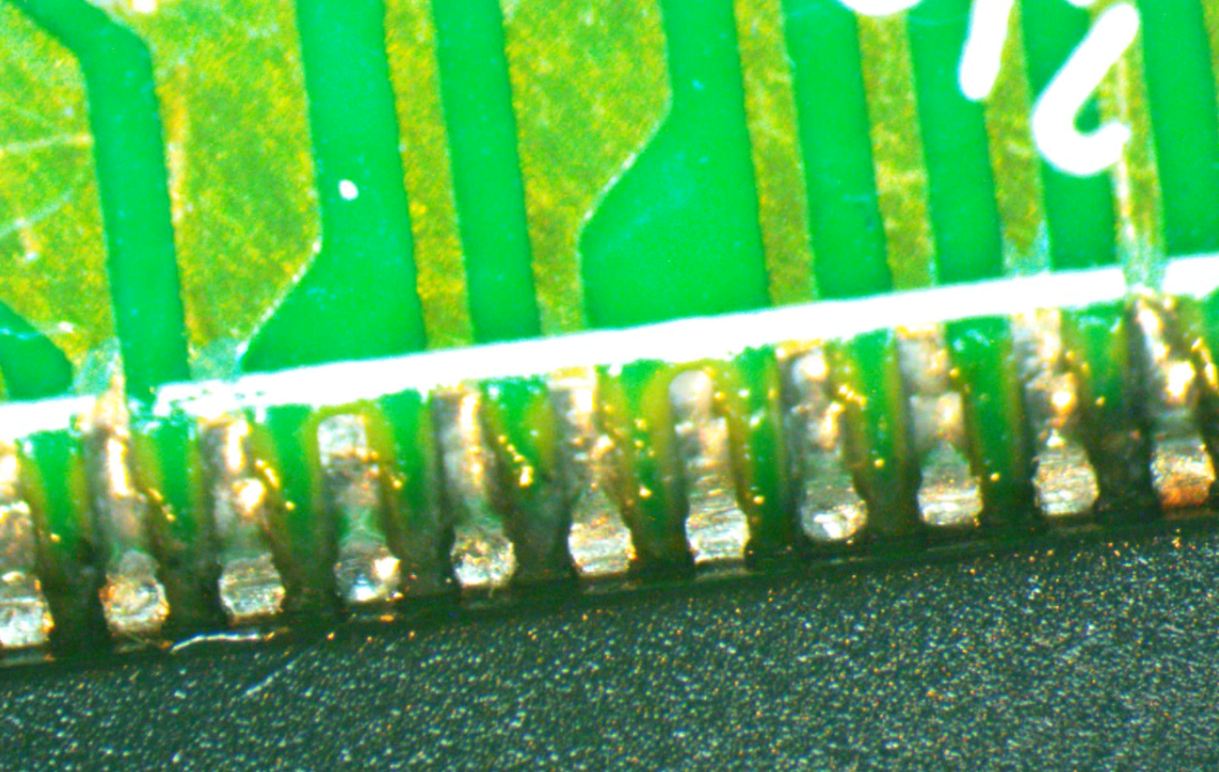

              Please see attached picture files of board work on installation of IR2E67M chip.

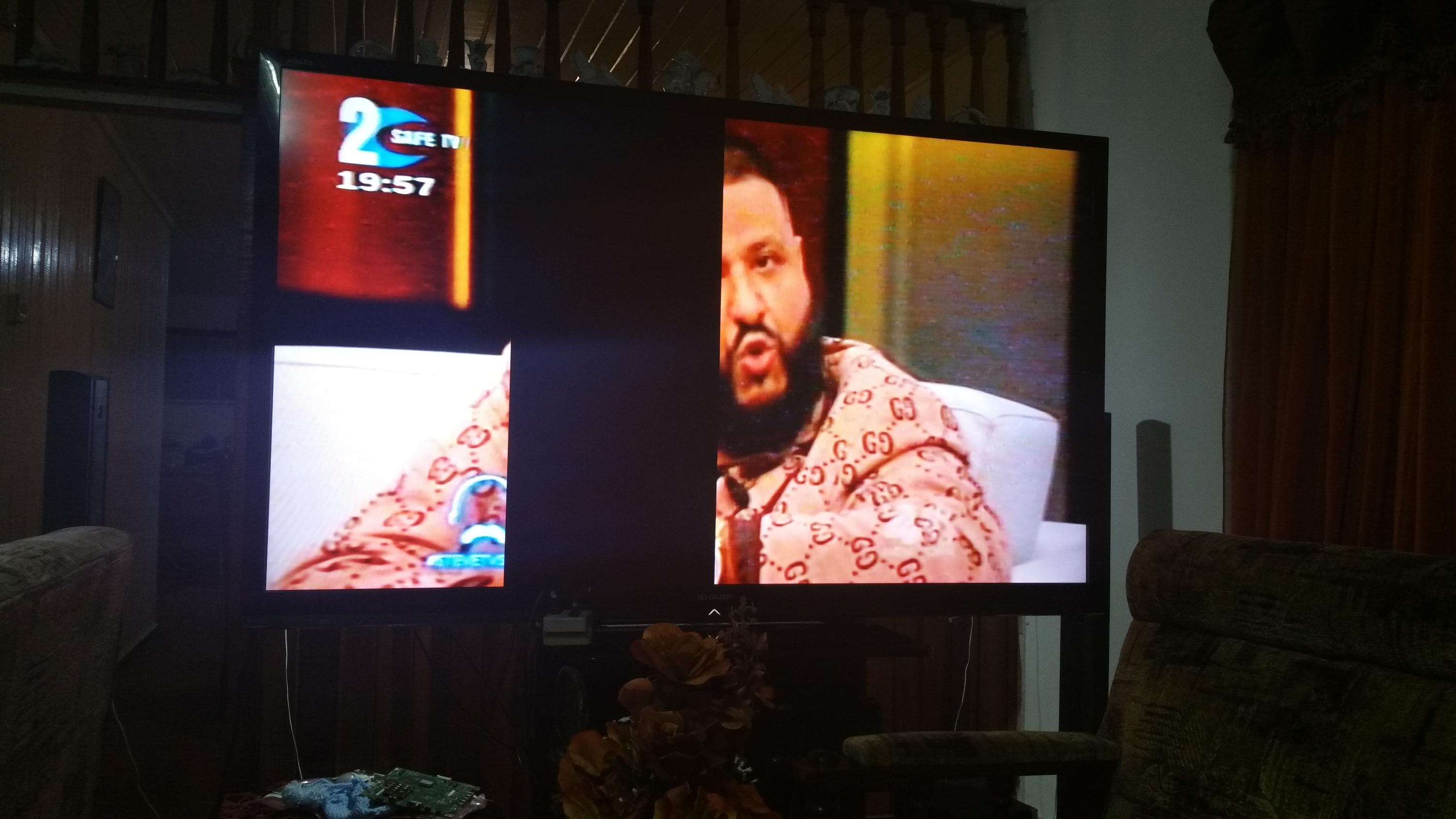

                #67
                Please see attached picture file of TV screen just before the backlight came off .
                  some of your pictures appear to show "foreign lines" running from one pin to another. Ensure there is no "contamination" between pins as the high voltages may "leak" thru to areas they shouldn't be.
                  Might be a main board problem if the "power strike" caused a weakening of a component (eg. capacitor). Might look for a replacement board somewhere.
                    #69
                    There are some left over Fibers from a Cotton Cloth that I was cleaning the pins with.I used Isopropyl Alcohol to get off excess soldering flux .

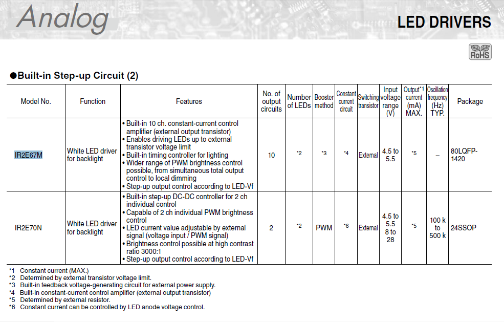

                      #70
                      Please see attached picture file with some data on the IR2E67U chip.
                        #71
                        That should be IR2E67M.

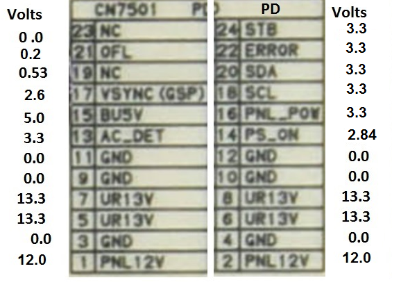

                          Hello all, "Happy New Year".
                          The present state of the TV is as follows:-[1] I have installed the original Power Supply Board after replacing the Backlight Driver IC .[2] I have replaced the Main Board with the original Board after reflowing the Power supply connector soldering joints, [3] I replaced the T-CON Board with the original board and replaced the two flat ribbon cables with new ones due discolored ends and corrosion.
                          Presently I am getting Video and Audio and images on screen without backlight . and if I unplug the Power cord it goes back to 1S-1F Blink error.
                          The Back light is not coming on even if I leave the TV off overnight I came to the conclusion that the Rainy weather is making the TV Circuit Boards operate sluggish so I placed two lights behind the TV to keep the boards warm.
                          I am getting +127 VDC on all the pins of the LED positive wires and 1.8 VDC across the Collector and Emitter of all the Main Driver Transistors (KCY4217 or C4217 )
                          Please see attached voltage chart with present voltages in this condition.
                          The E-Bay T-CON Board that was removed was working satisfactory .
                          The E-Bay Main Board removed ,was not getting Video or Audio because I did not get to complete the auto tune cycle with it but I believe it's serviceable.

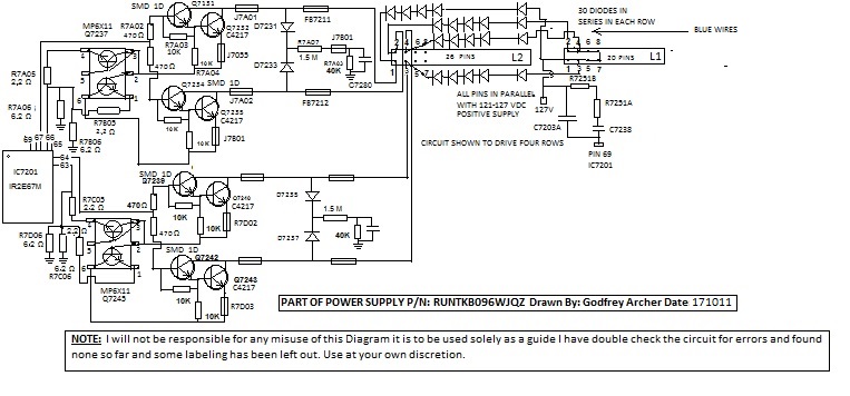

                              #74
                              I have done some reverse engineering to draw a part of the Power Supply Schematic for P/N: RUNTKB096WJQZ. It's a work in progress but from this diagram you could do a modification to fool IC7002 about the current hopefully. The alternative is to change all the LED, s with new ones which is very expensive as recommended by a Technician on Fixya.com. I have removed the whole panel with the Back light LED's and tested them and they are all displaying with the same brilliance.

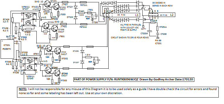

                                    I have made a correction to the Diagram of the LED power supply where the two connectors L1 and L2 were labelled incorrect .This diagram covers only four rows of LED's out of fifteen all of which connect to different pins of the IC in a simular way .I have purchased another new Board with the same Part Number quoted in the Service Manual ..I will do a resistance test before to check for leakages of current to chassis simular to the test below.
                                    I will be re-testing the LED's by leaving the Connector L1 plugged in and applyng 147 Volts Positive from the LED tester Red lead to pins 1 which connect to all the fifteen rows of LED anodes and testing the Cathode side with the connector L2 disconnected and selecting each of the pins that goes to the first Cathode of each row. The information is marked at the side of the connector . I would be monitoring the Current of the Positive lead of the tester for leaks to ground.
