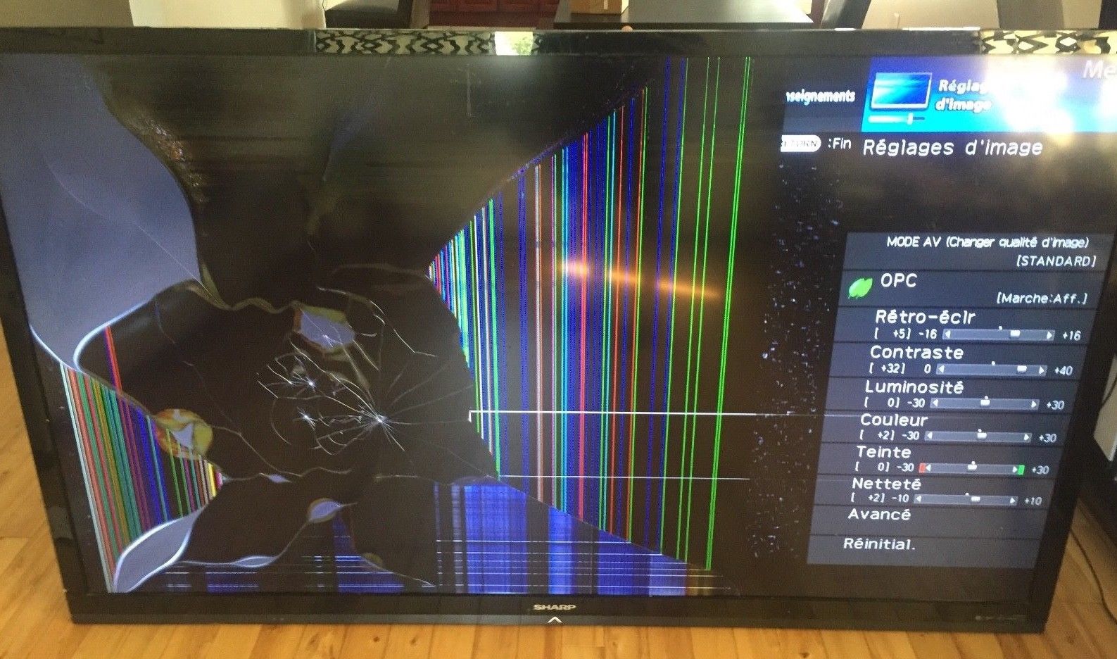

    I would say with certainty that looks like a panel issue. Hopefully not and it happens to be a tcon which it is possible. Sometimes there is a slight possibility that the cracked panel has caused a short on the main processor of the tcon. It has happened but rare

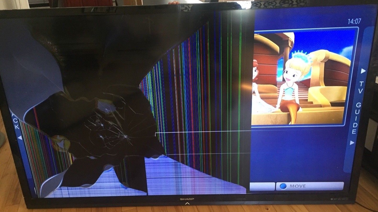

      i am getting a perfect half screen Video on the right and Backlight on the left if I disconnect the Left cable.then after about 30 mins the Icon light stays on steady but the Video and audio goes off also the Remote does not work at this point.I have to pull the plug to turn off the set.

        Let me clarify some information here .The good video picture was taken in December 2017 then I ran into some issues with the two 80 pin Ribbon Cables , where the copper got loose after spraying CRC 226 on the t-con board connector.The damaged of the two t-con and original Main boards resulted from that problem. I obtained the present Main board and the t-com board from the same cracked screen TV where I got the Power Board and lED's with Connectors .I replaced both in January 2018 and this is the picture with the quarter screen missing when I reset the TV with both cables connected to the t-con board. In this condition it goes into 2-3 error code after about two minutes.I will have to re check to verify the code again because it could be a 2-5.

              Please see attached pictures of the TV where I obtained all the present used boards,ribbon cables,Led harness and LED,s from.

                    This new problem with the quarter screen missing is after changing the t-con board and two 80 pin ribbon cables in January.

                      I never got a good whole picture since I install the present t-con board from the cracked screen TV.The good picture was obtained in December 2017 when I had the power supply from the cracked screen TV installed with the original t-con and main board .Then I had the ribbon cable damage with both cables along with the original Main Board and t-con board .
                      They are now replaced with every thing from the cracked screen TV and I am getting the picture with the second quarter screen on the left blank.
