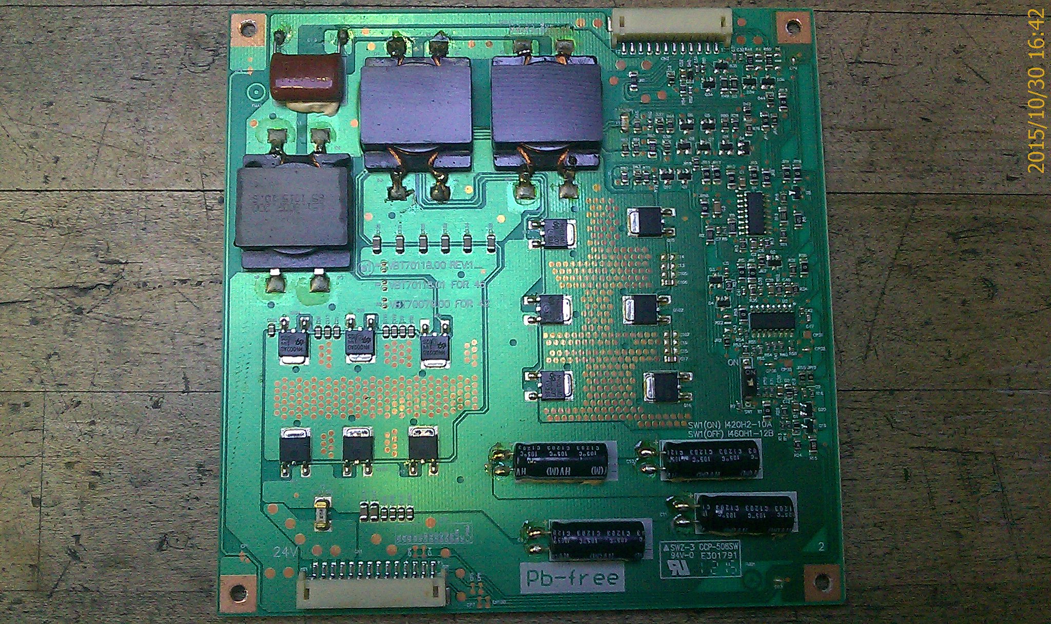

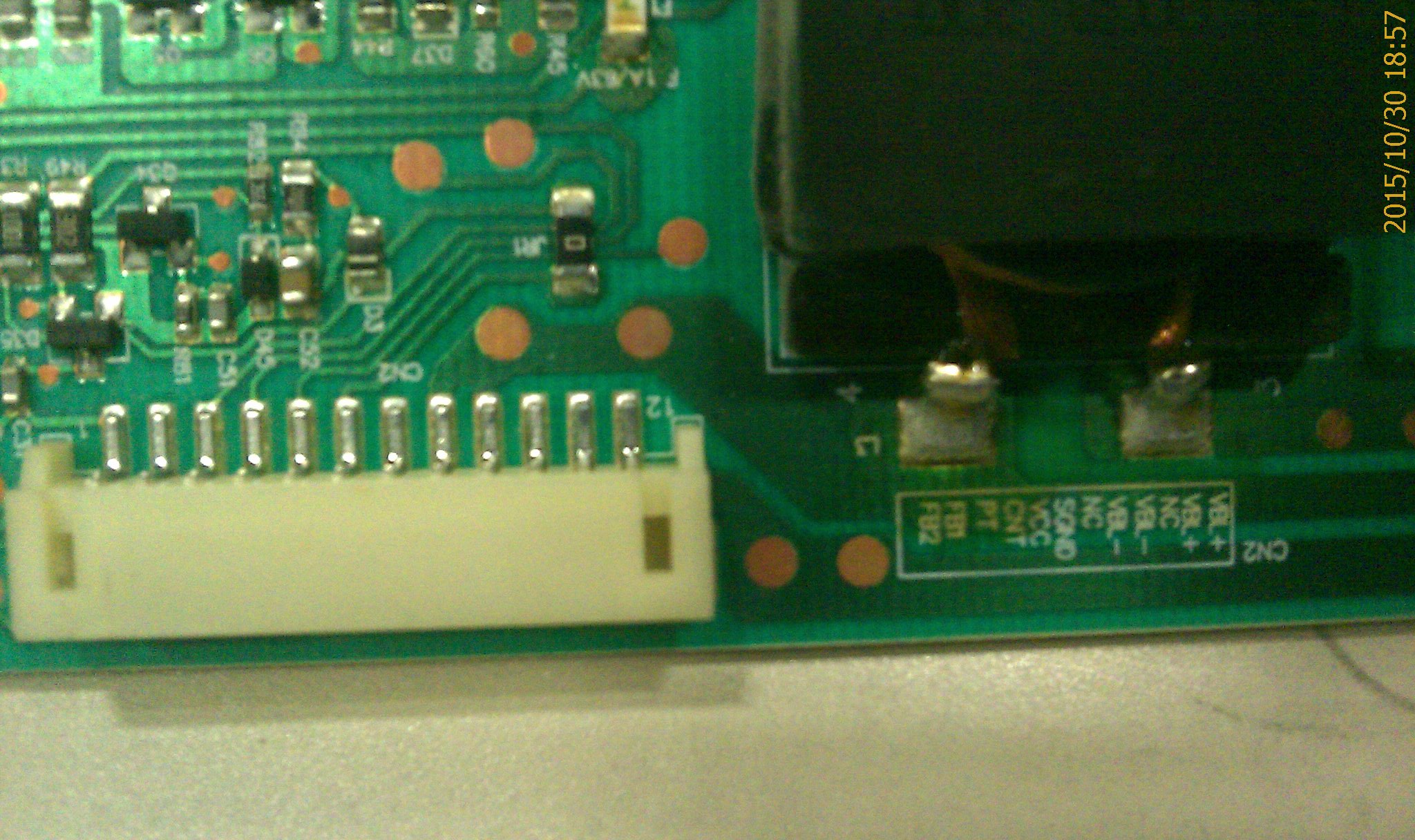

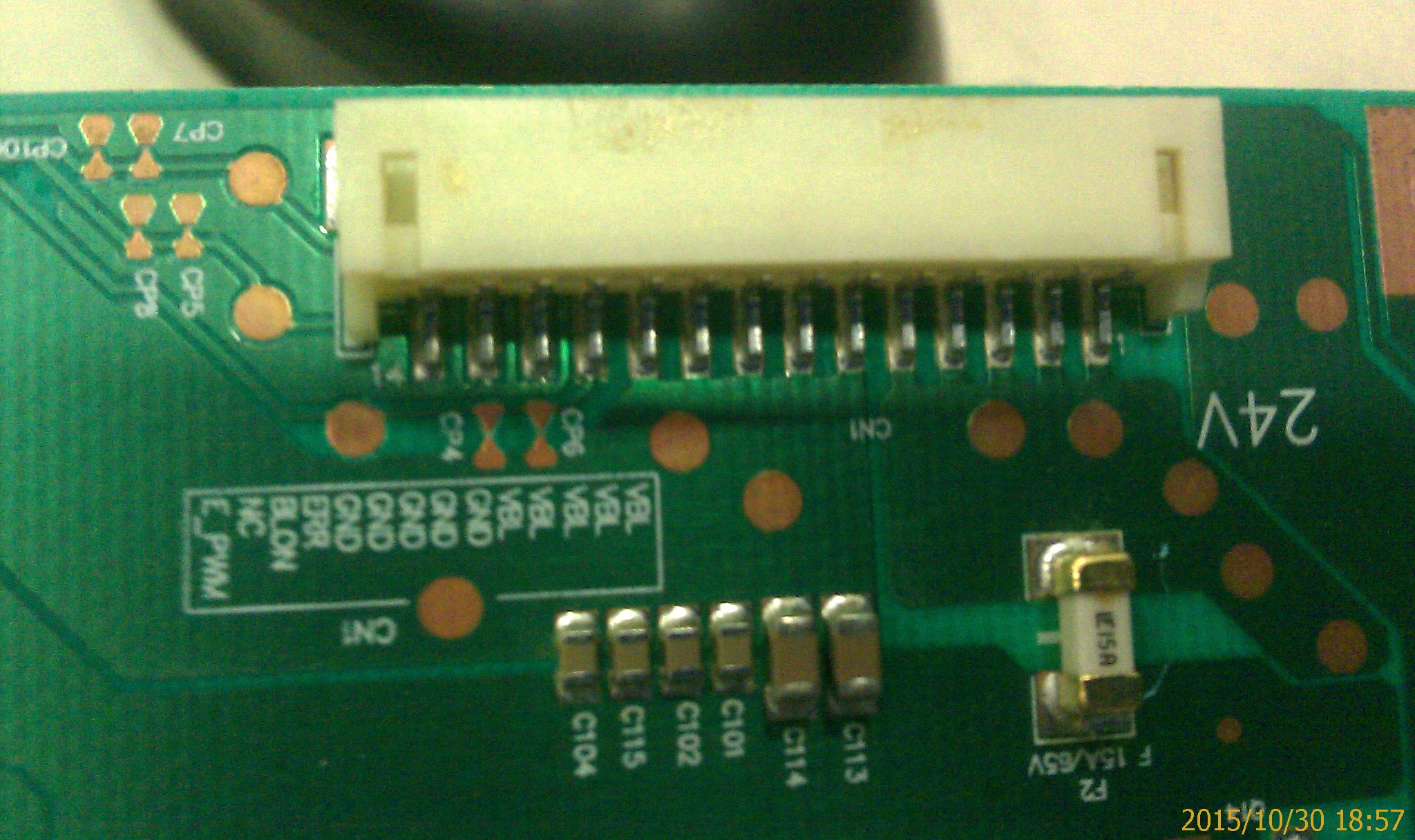

              Re: jvc LT-50A330 ....tv powers on with green light and has sound..no backlight
              and i dont see dim pin here are pics
              of the input and output area on driver board which i do have 24v coming in from ps
                Your dim control is labeled E_Pwm. Do you get 24v at the output plug where the Led plug into ?
                    ok checked output voltages on driver board and get 0v
                            update tv fixed ..bad led driver board
