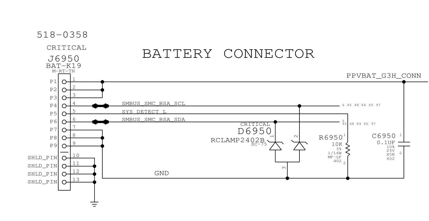

    1) see attached. locate the battery connector @ J6950.
    2) Meter in DC volts (20v or higher scale is ok). Measure the voltage on each battery connector pin with the battery connected & powered by the external adapter.
    So,
    red lead on pin # 1 (J6950) & black meter lead to ground (shield is ok) - post the voltage.
    Repeat for each pin on this connectors.

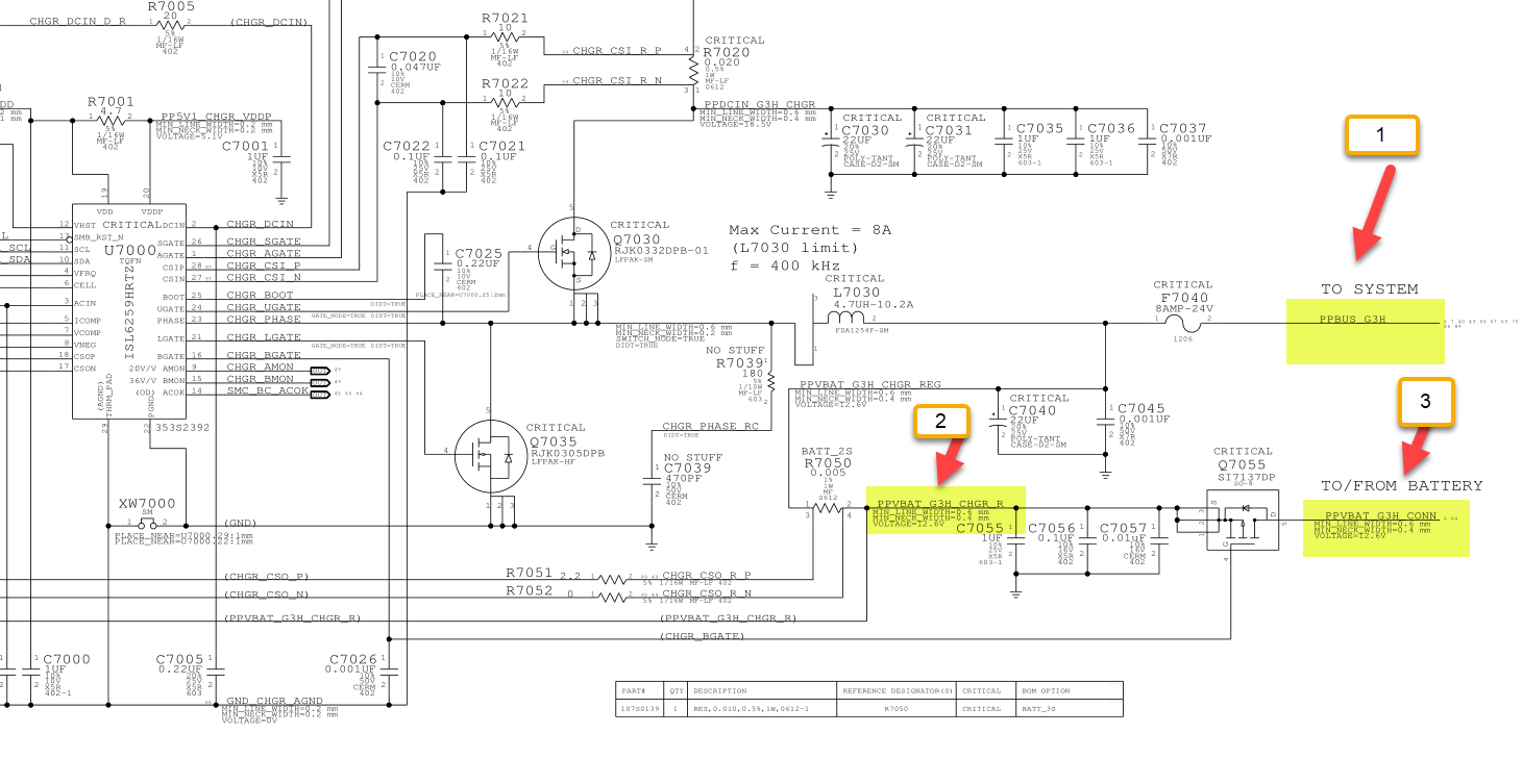

    Measure and post the readings for the points # 1, #2 and # 3.

      Did a quick measurement of the battery connector. A bit too tired to do the full disassembly today.
      Will try tomorrow.
      Pins at power off state with charger connected.
      Black probe at chassis.
      J6950:
      1-3 10.93V
      4 3.4V then fluctuating down to about 2V?, then 3,4 again.
      5 0V
      6 3.4V then fluctuating down to about 2V?, then 3,4 again.
      7-9 0V as expected.

        1. PPBUS_G3H measured on both sides of F7040 (not blown/open):
        10.92
        2. PPVBAT_G3H_CHG_R measured on positive side of C7055:
        10.92
        3. PPVBAT_G3H_CONN meassured on Q7055 pin 5 (Q7055 itself showed no shorts between D, G & S in diode mode and no power. ~0.5Vdrop):
        10.92

          If there is no light on the magsafe power head, then there is no voltage to power the single wire communication of the Dallas / Maxim controller. This controller is chatting with the logic board and is used to select the bicolor led inside the power head.
          Check the 3v42 or 3v3 line for your board..it should be powered by a dual common cathode diode. Fed by ppbus_g3h and the adapter voltage.
          Locate it and post the voltage on this diode to start.

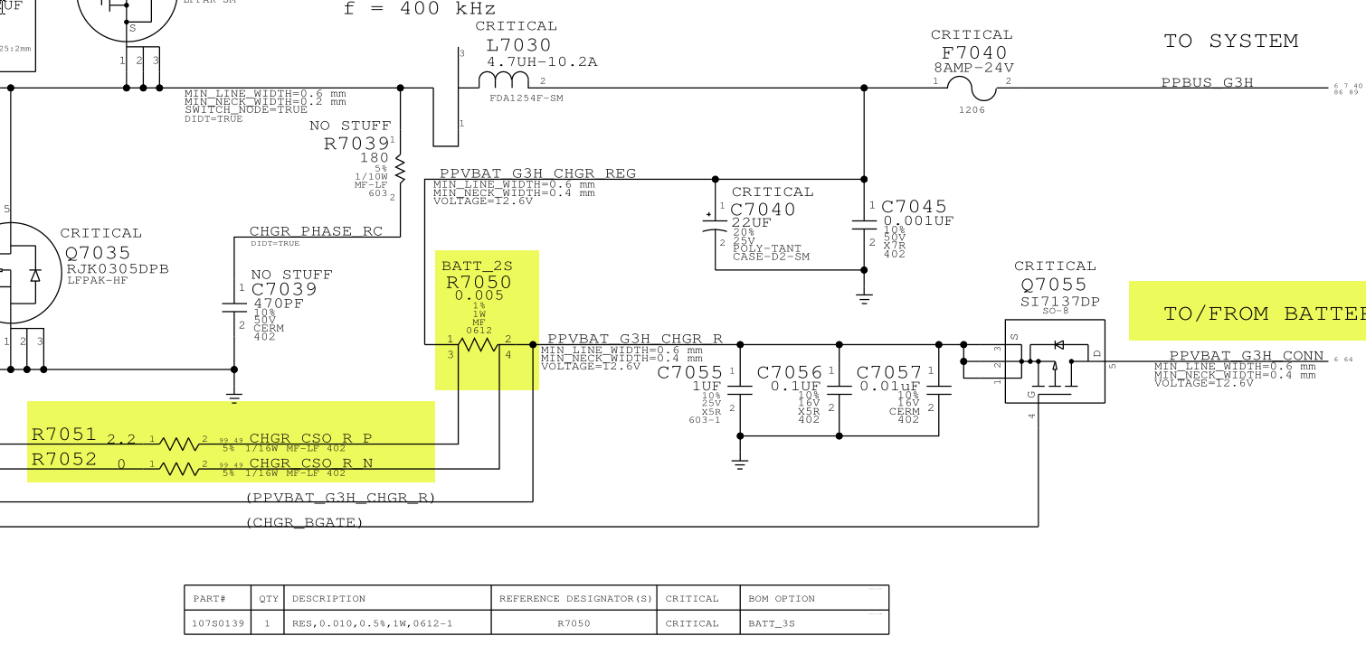

                      See attached. Current sense for the battery charge leg of the circuit = R7050.
                      It is vital that the same resistance is read from each side of R7050. Confirm that you have these connections back to the ISL charger IC.
                      Have seen a case where the PCB trace was broken and had the same symptoms.

                        Traces back via R7050, R7051/R7052, C7050 and at U7000 look good.
                        There is about 3.1ohms over C7050.
                        R7050 has about <2ohm according to my non-Fluke dmm.

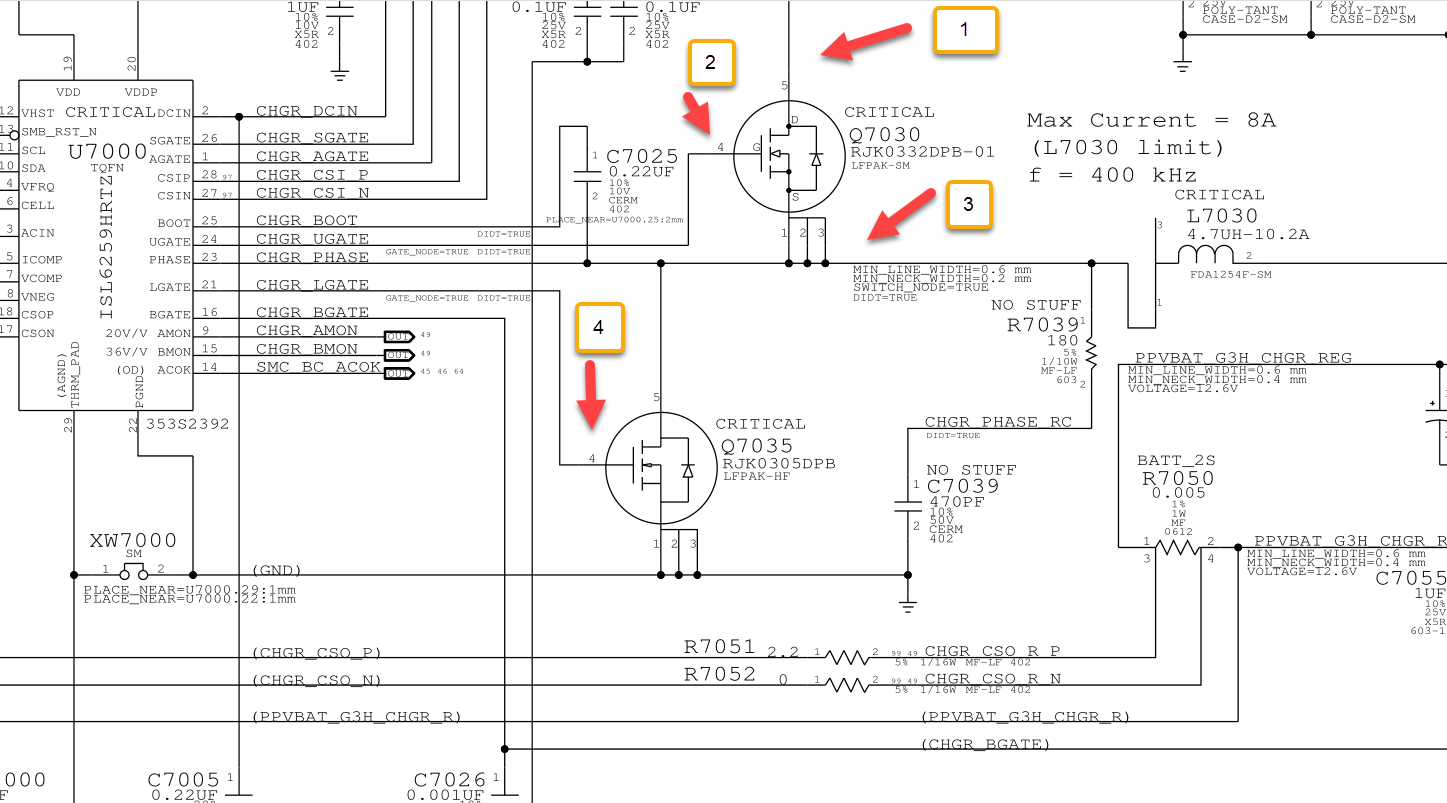

                            Perhaps. See attached.
                            With great care, measure the voltage on each point of interest.
                            We want to know if the high and low side mosfets are working to charge the battery. You can measure where you feel comfortable - if the probes are not suitable, just hold off and can try other measurements.
                            With the adapter and battery connected, you should see the presence of a charge voltage at the drain pins of mosfet Q7055 (pin # 5-6-7-8).
                            What is the voltage you measure at the drain pins of Q7055 ?
                            What voltage do you measure at the GATE pin # 4 of Q7055 ?
                            This is to confirm that the ISL charger IC is attempting to charge the battery pack - the batteries being dead is another story.

                              Re: MacBook Pro 2010 15" 820-2850 no charge, green light, powers on
                              Your attachment asks for Q7030 and Q7035.
                              Q7055 has been measured earlier as I understand it.
                              All ref to shield.
                              Q7030
                              S 12.56V
                              G 16.12V
                              D 16.6V
                              Q7035
                              G 0.96V
                              • mon2

                                Q7030
                                S 12.56V
                                Can you confirm this is the voltage that you see @ fuse F7040, pin #1 ? It should be.
                                Respectively, confirm this same voltage should be @ Q7055, source pins 1-2-3. It should be the same.
                                Yet, Q7055, drain pins (5-6-7-8) are at 10v92 (from an earlier post)? Something wrong here. Either this mosfet is disabled or defective if the gate voltage is high enough. This is the raw battery voltage.
                                Confirm the voltage on mosfet Q7055, gate pin # 4 so we can verify that it is enabled.

                                      I believe we have a smoking gun:
                                      Q7055:
                                      Gate 12.57V, which should according to my humble experience be more than enough to turn it on?
