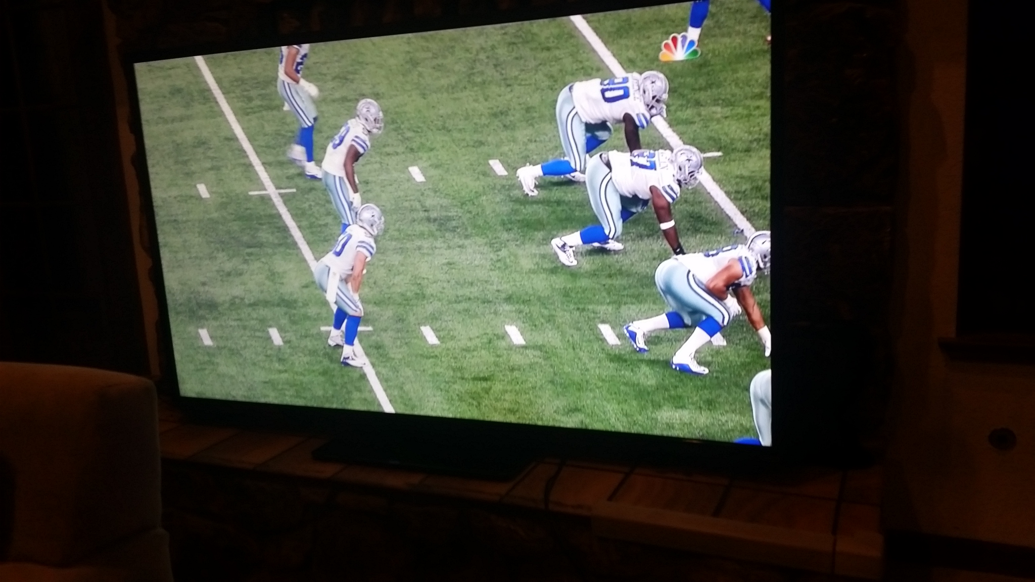

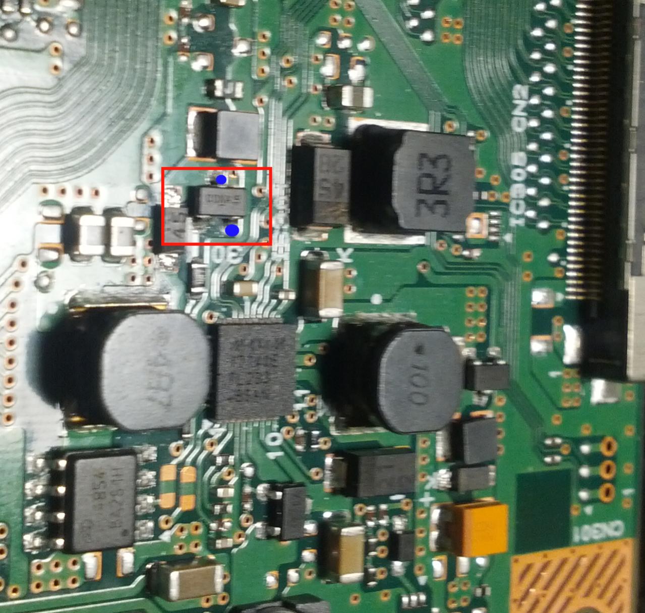

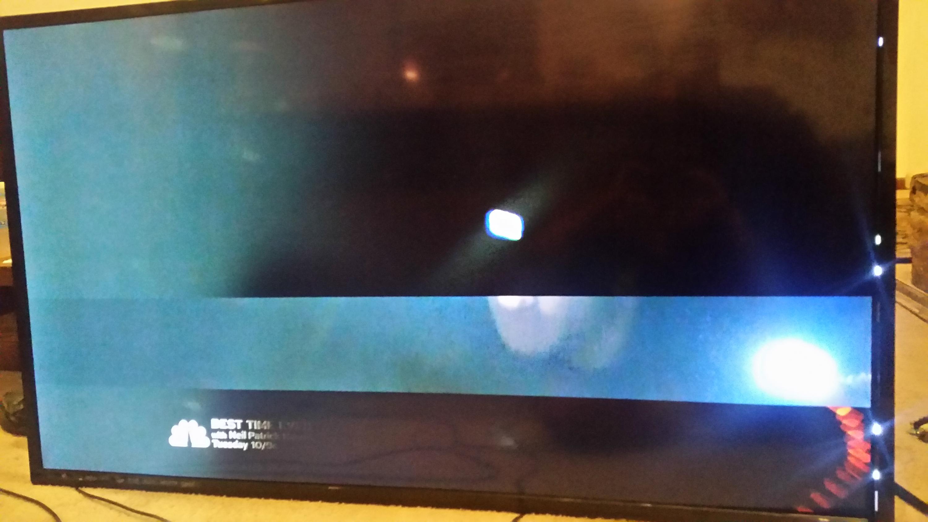

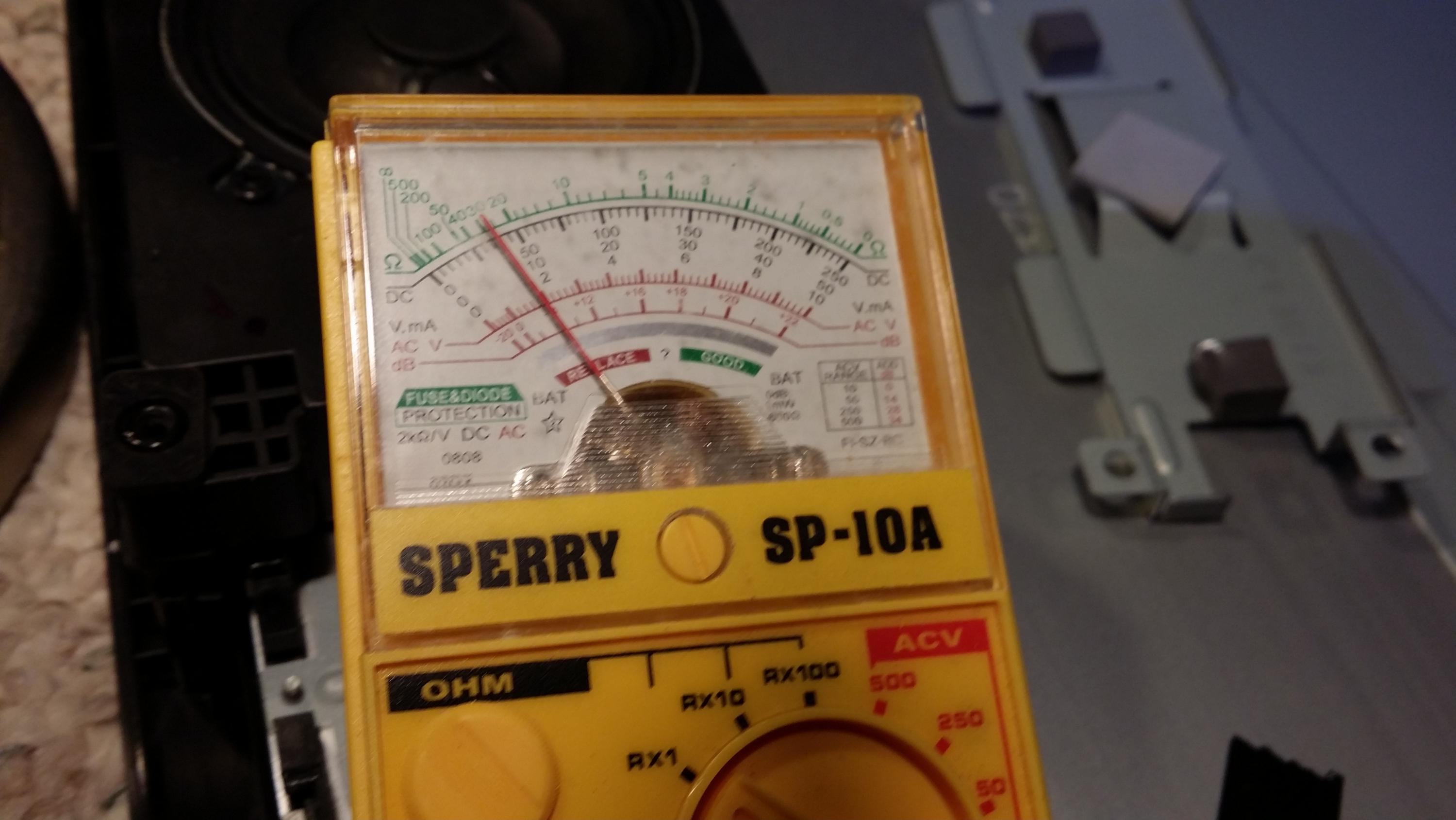

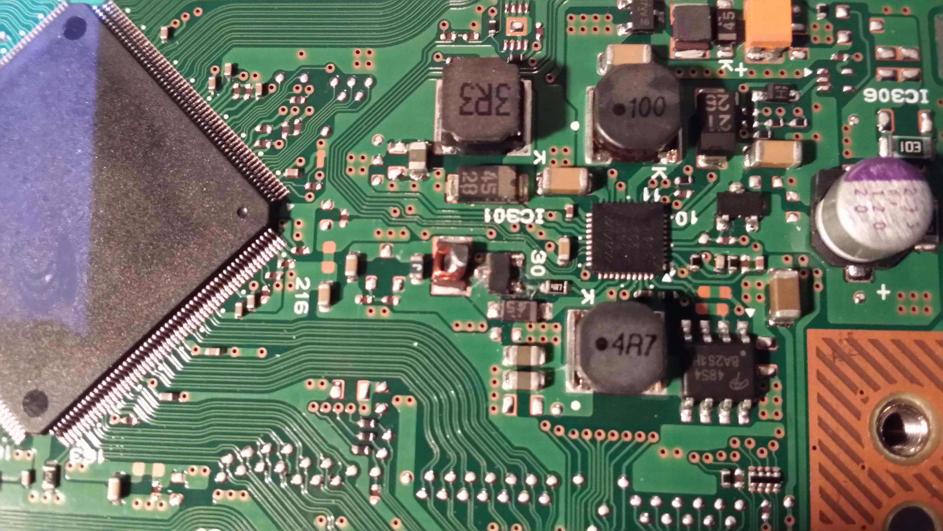

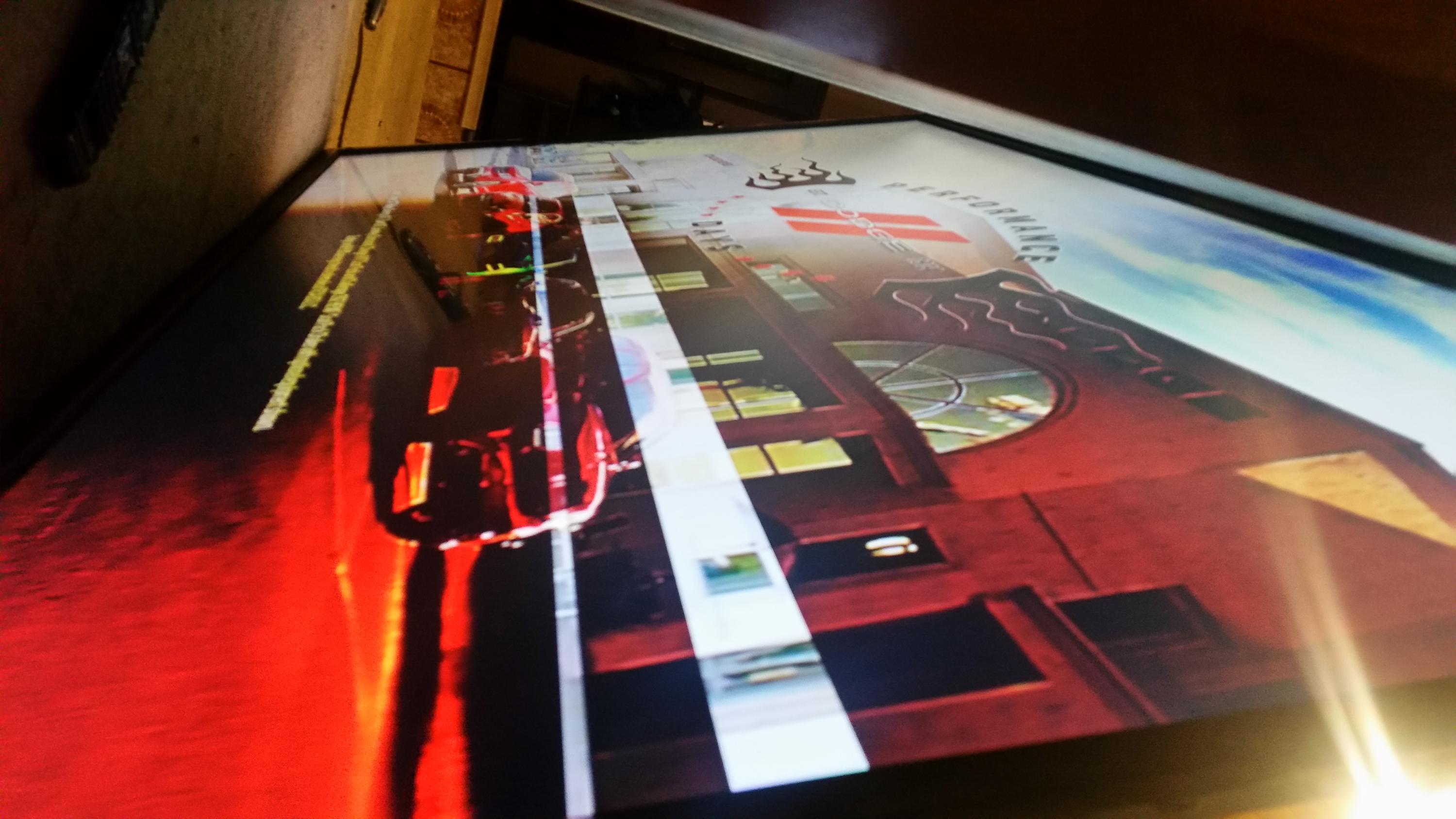

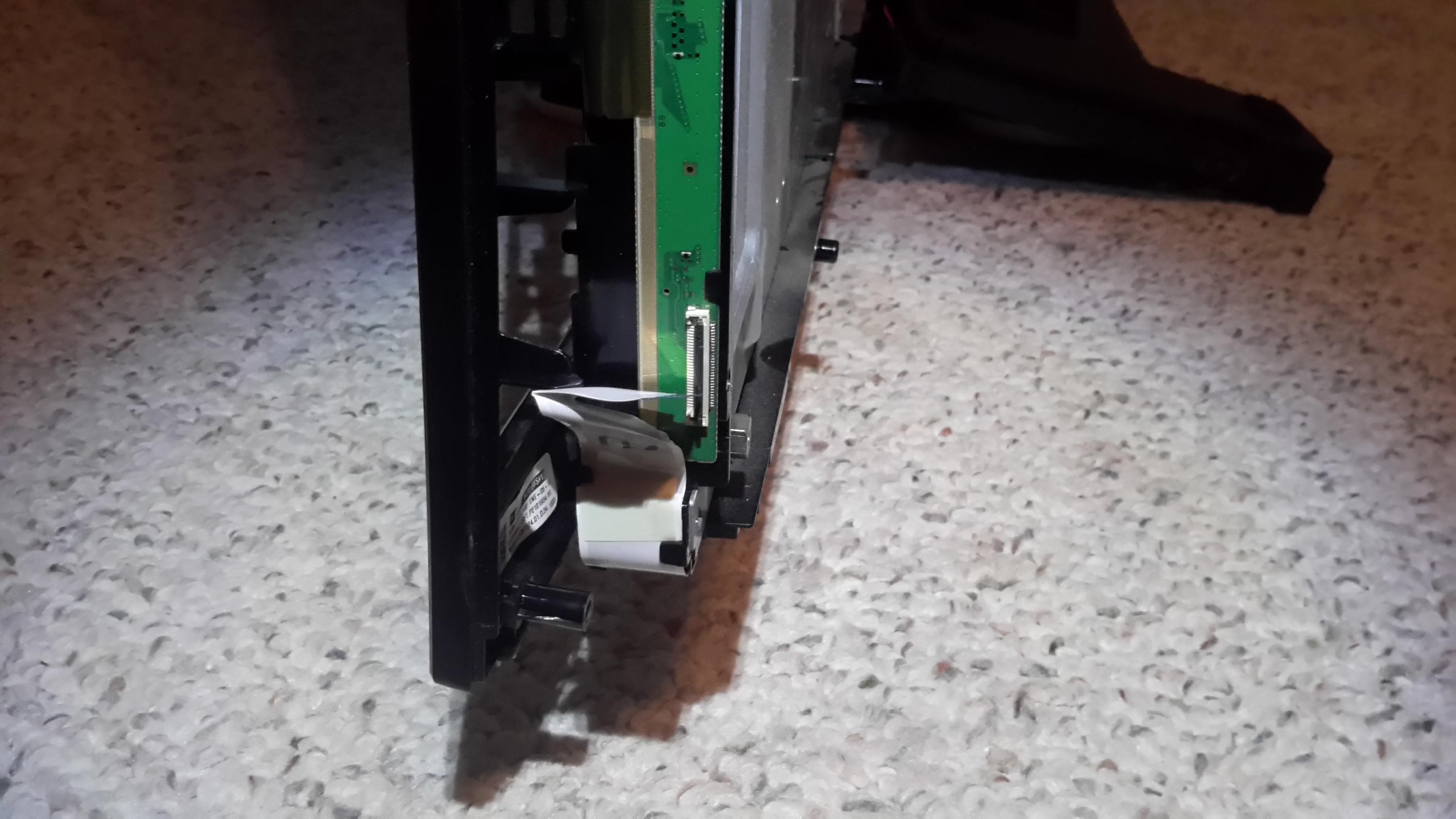

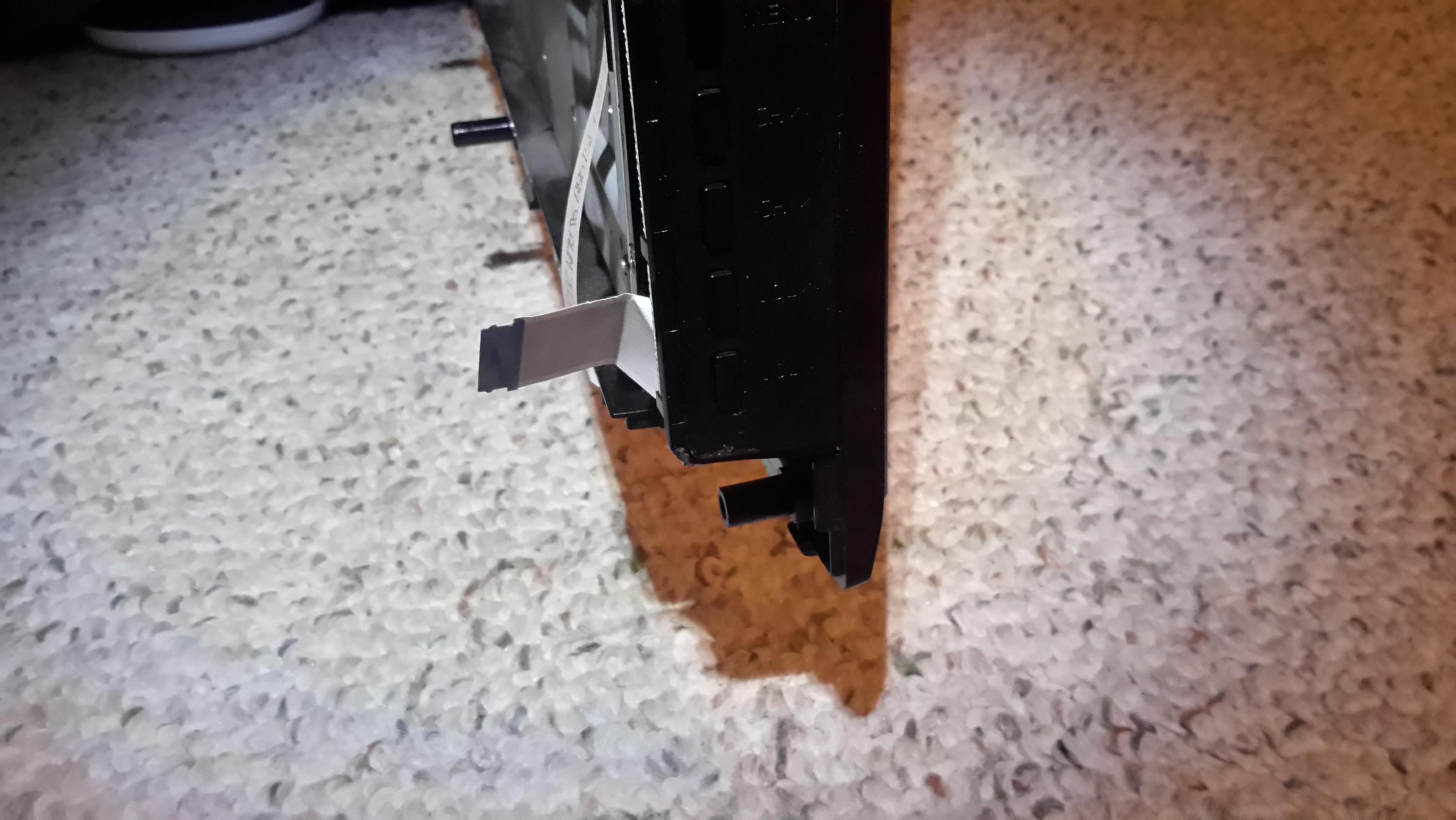

      Ok here's some pictures ranging from the beginning to the end result. The only picture I do not have is disconnecting the flat white ribbon cable from the side boards that connect to the bottom boards of the panel. But if you have the back off and you're looking at the side of the screen at the bottom sandwiched between the metal frame you will see where the white ribbon cable connects to the bottom of the side drivers.
      The first picture shows you what the screen look like after I disconnected the flat white ribbon cable.
      The second picture shows you pulling away the frame to access the side tab driver boards.
      The third picture is showing those driver boards with the tabs pulled off the panel.
      The 4th picture shows you a close up of one of the tabs pulled from the panel but the board still connected to the panel.
      The fifth picture shows you the screenshot of what you're seeing after you remove those defective tab drivers.
      The sixth picture shows you another screenshot of just the fifth driver download from the panel.
      The seventh picture shows you the original problem.
      The 8th picture shows you the defective transistor. The last picture is the end result.

                  Make sure you disconnect this first. This is a picture of the sideboard connected to the panel on the right side of the screen. Make sure you disconnect the flat white ribbon cable that connects the bottom board to the sideboard before you attempt to power up the TV. This flat ribbon cable is only about three quarters of an inch wide. It is located on the bottom of the right side of the panel. & I would like to note that when I say right side that is looking at the TV front if you're behind the TV it is the left side on the lower side of the tv. Near the vizio emblem..

                      With power disconnectwd I disconnected the bottom right white ribbon cable coming up from the panel connecting to the t-con board then powered it on and got all backlights. I shut it down then repeated the test process and got the same thing- no 'V' or any input indication in the upper righthand corner- only backlights. Mind you ths is a supposedly new t-con that I replaced thinking it would fix the problem. I don't know if I did the test correctly or if I did should I move on to the power board?
                      • tjmethod
                        • Jun 2013
                        • 137
                        Re: e701i-a3 no picture but backlights
                        Repeated with the left cable and then the the right

                          You are not disconnecting the proper cables. Re-read the posts / help suggestions, including my most recent one.

                                , ok what you have disconnected in your pictures looks proper. However you need to test your t-con board to make sure that its not failed from the get go. A lot of eBay sellers are selling bunk non functioning tcon boards. You'll notice in my illustrations one picture shows which transistor to check mark with the red box. You need to set your voltmeter to ohms mode and black probe the center pin right probe the right bottom pin in the left bottom pin make sure that neither side is shorted. One side should show roughly 500 ohms and the other side should show almost infinite. If your getting anything other than that your tcon board is toast

                                    Use a sot-23 mosfet labeled QF as equivalent. You can get them in the us. N channel 2 amp 45v.
