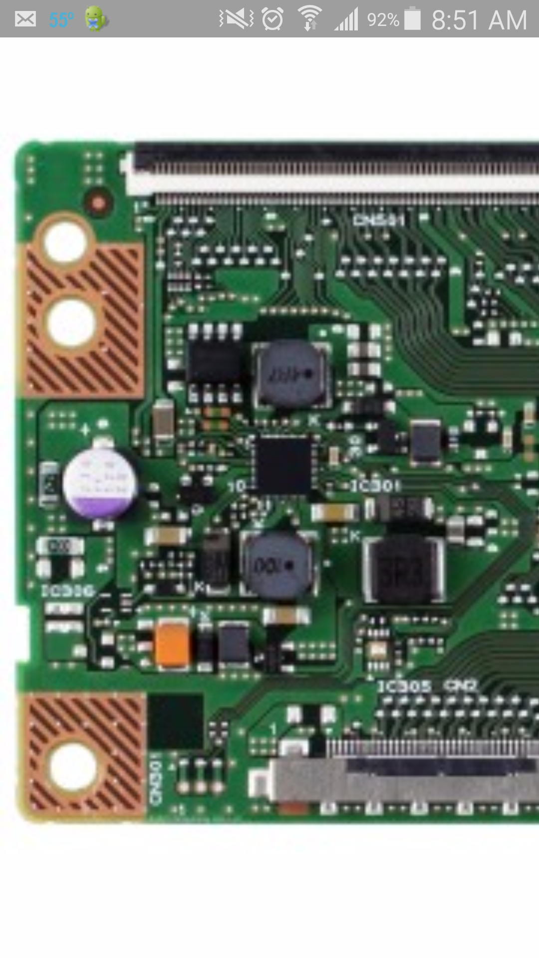

            Ok so your saying that coil that I that I had ripped most of the cover from may be fried? I never broke it away from its solder spots though. What do those readings that I had gotten mean- before the damage was done? Do you think I could have damaged anything else?
            I'll try the voltage test but I dont have a line on getting a cool, transister- I couldn't even find an SOT N channel mosfet with 45 v 2A anywhere. I do have a another t-con coming from encompas.

              I'd just wait for the new tcon to come in. Then make sure the right side drivers are disconnected from the bottom drivers via that white ribbon cable on the right lower side of the screen. It's the one about 3/4 inch wide located on the lower side of the side driver board on the right side of the screen.
              If you get a picture most likely the right side of the screen is going to be dim. but there will probably be some horizontal lines in the picture that don't look dim. Whatever it looks like please post a picture first

                You got it- the newer t-cons not in yet- so undo that low ribbon cable behind lower right then replace the t-con, and I'm safe to plug in and power on. Hopefully before the bedore the end of the week…

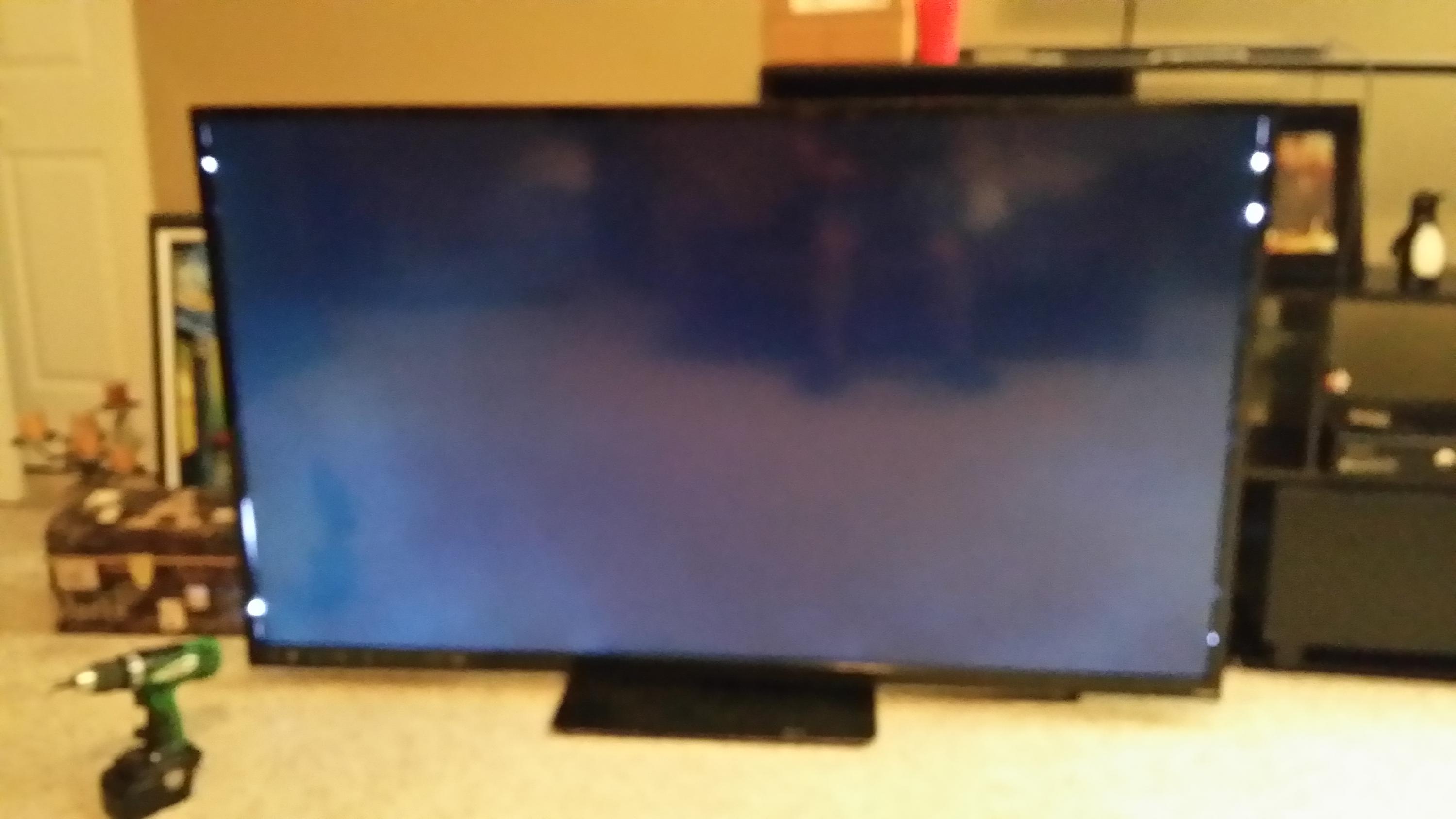

                    Well the t-con came in. I unplugged the lower, right 3/4” ribbon cable. I then installed the new t-con board then plugged in a source- a chromecast dongle. Then the moment of truth… I had my phone ready to take a shot but then plugged in the power cord and turned it on. The screen was somewhat black, then you could see 3,4,5 or 6 thin red lines that were making up the lower, left middle portion of the ‘V' which faded away then the set went into a moderately backlit screen. I tried the menu button which did nothing and turning the set off and on not able to repeat the same thing. The next thing I tried was redoing the whole process reversing the ribbon cables with no repeat of the initial screen. All I would get is the same as before- dim backlights with recognition the backlights are on then brighter or morderate backlights. I don't know if I damaged the t-con. I also am thinking could this be the LED inverter that's located on the power board? I'm not sure what to try and test next?

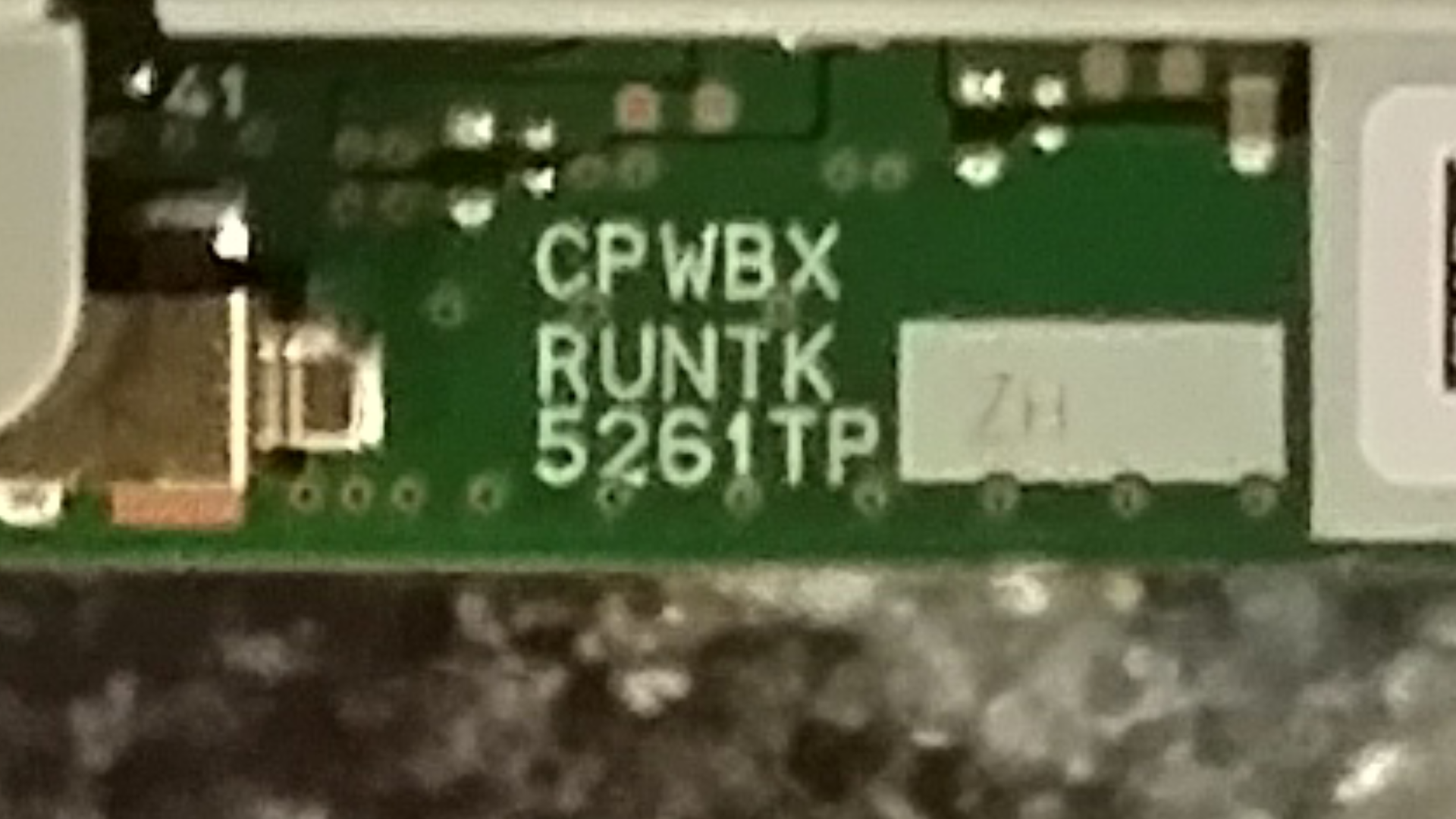

                      Ok. Can you locate the transistor marked COXA or something like that? Middle right side of the board.with the ribbons on the bottom, lvds cable connectors on top.? Need a ohms reading between center pin with black probe and red probe on each other 2 pins. Looking for 500 ohms thereabouts. If 0 ohms then the board shorted.
                      Possibly because the ribbons on the left hand side of the screen may be the shortest one and not the right side

                        Ya the COXA 16...Just a re-cap from before...with the power cord unplugged, 3/4" lower right LED driver cable disconnected and NEW t-con installed, I plugged in and hit powert. This is when I got the brief faintly visible image of a 'V' to show up on the black screen which quickly disappeared. Shutting off and turning on repeatedly didn't bring up again so I dont think shutting off, plugging in the lower right LED cable and unplugging the lower left did anything since I'm convinced the board was blown from only the lower right cable being disconnected. Testing the silver capacitor in DC mode on the meter didn't move the needle and neither did the COXA in ohm mode from your instruction. I also tried and read that with power on and disconnecting/ reconnecting one LVDS cable at a time while watching the screen may show some type of something flash on the screen- it didn't work. All this leads me to think the t-con is clearly blown. I also took out the main board since I was unsure if it could have been damaged not knowing the distribution of power back and forth with all the boards. I took out the main board and put it back in my relatives 60" that I fixed previously since they are the same board which worked fine telling me theres no effect on the main board. Do you know how can I find the source of whats blowing the t-con. Do you know why I had readings on the previous t-con I had in before damaging it?
                        Do you know how to get into the service mode on the tv if there is one and or if theres any type of interface software to troubleshoot the unit from a laptop? If you know of any such software? I do happen to have a contact that can get his hands, that on just about any software out there. If there is and I can get it, I'd be happy to pass it on. Also if not do you know if theres any way of independantly testing the panel to rule it out? Can you pass on where I can purchase the COXA transistor or the SOT N-channel mosfet with the specs you gave me (I could not find it anywhere online) and the silver capacitor?
                        Again, thanks for all your help-

                          I have a question about the red lines you had seen where they spanning vertically or horizontally accross the screen?

                            Hi no the thin red lines were making up part of the 'V' logo. I'm attatching a picture I edited to describe it. The real image I saw on the screen was much more faint and not as pronounced.

                                Ok here is how I found the glitch from the beginning. My TV came in to me with the same typical symptoms. I replaced the tcon board thinking it was an easy fix to find out that the one I got was already failed from eBay so I ordered another one to find out that one was also already failed from eBay. I found out the second one was bad by just connecting the LVDS cable and not connecting the ribbon cables to the panel. I was not able to achieve any voltages from that board studying the board and reading what others have posted about the board I found out that in the component repair kit they offer an EPROM a couple transistors and a four Channel voltage regulator. There were absolutely no problems with any of the components on any of my boards except for the small Coxa transistor shorting. I noticed that the two boards that I received already had a bad Coxa transistor. The way I found that out is using a digital voltmeter in ohms load and probing the black tip to the center pin the red tip to each individual other pin on the other side of that transistor a good transistor should read about 500 ohms between center pin to one of the ending pins. If you're getting near zero on that transistor shorts when there is a panel problem. The reason I found the specs on that transistor by researching it on the internet I came across a suitable replacement that I had mentioned earlier. This replacement I had found was often old tcon board to a Sony. It was the only thing that I had in my stash that was even close to an equivalent transistor and when I replaced that transistor it obviously had a little more meat to it per say it could handle the surge that the panel was giving it for a few more seconds just enough to be able to turn on the TV and see the actual symptom. What I saw was a really messed up right side picture with a lot of lines going through it very dark and flickering like crazy. I instantaneously knew that there was a problem on one of those side tab driver boards on the right side. So to my findings that is when I disconnected the right hand ribbon driver to the right panel driver boards. When I powered it up the next time I no longer had a flickering red right side but a dim and blurry right side which I was pretty sure that that was going to be like that when I powered it up because there's no power going to those tab drivers any longer but also I was presented with some really nice bright horizontal lines in the picture like you saw in my previous post. The next thing I did was remove the metal framing to expose the side tab drivers and when I pushed on the driver in the suspected problem area the lines started disappearing in and getting bigger. That's when I decided that since the screen has two drivers one on each side I had nothing to lose except for to pull those drivers off since they were causing an issue. That's how I got a perfect picture. The dark lines in the Vizio emblem I don't know what to tell you about but you drew those as if they were on the left side of the screen. The only other thing that I could offer as help would be to attempt to either Repair one of your tcon boards because I seriously doubt you want to go buy another one or purchase another one disconnect both side driver cables on each side of the screen and then power it up if you do not blow that t-con board then you know that it obviously is the left side causing the problem not the right. Then I would focus my efforts on those drivers and then reconnect the right side. This is all trial and error and can be a very expensive process. I just took the expense part out of it by finding my own equivalent transistor replacements instead of constantly buying another t-con board to try to find out how to repair the symptoms. If you are in anyway having extra board laying around your house from previous repairs it wouldn't hurt to Google search some of the small transistors on those boards and try to find an equivalent close to the specs that I provided for the transistor if it's somewhere even close you can try soldering one on and giving it a shot.
                                The key to trial and error on this TV is to keep your hand on the power cord if the V emblem doesn't come up with in a few seconds or you see something flickering it doesn't look right immediately unplug it so it doesn't damage the board because if it doesn't look right from the get go then it's not going to be right.
                                This TV uses the Sharp LCD panel. To my knowledge only one other member has been able to successfully repair a sharp model TV the same time I was working on mine.
