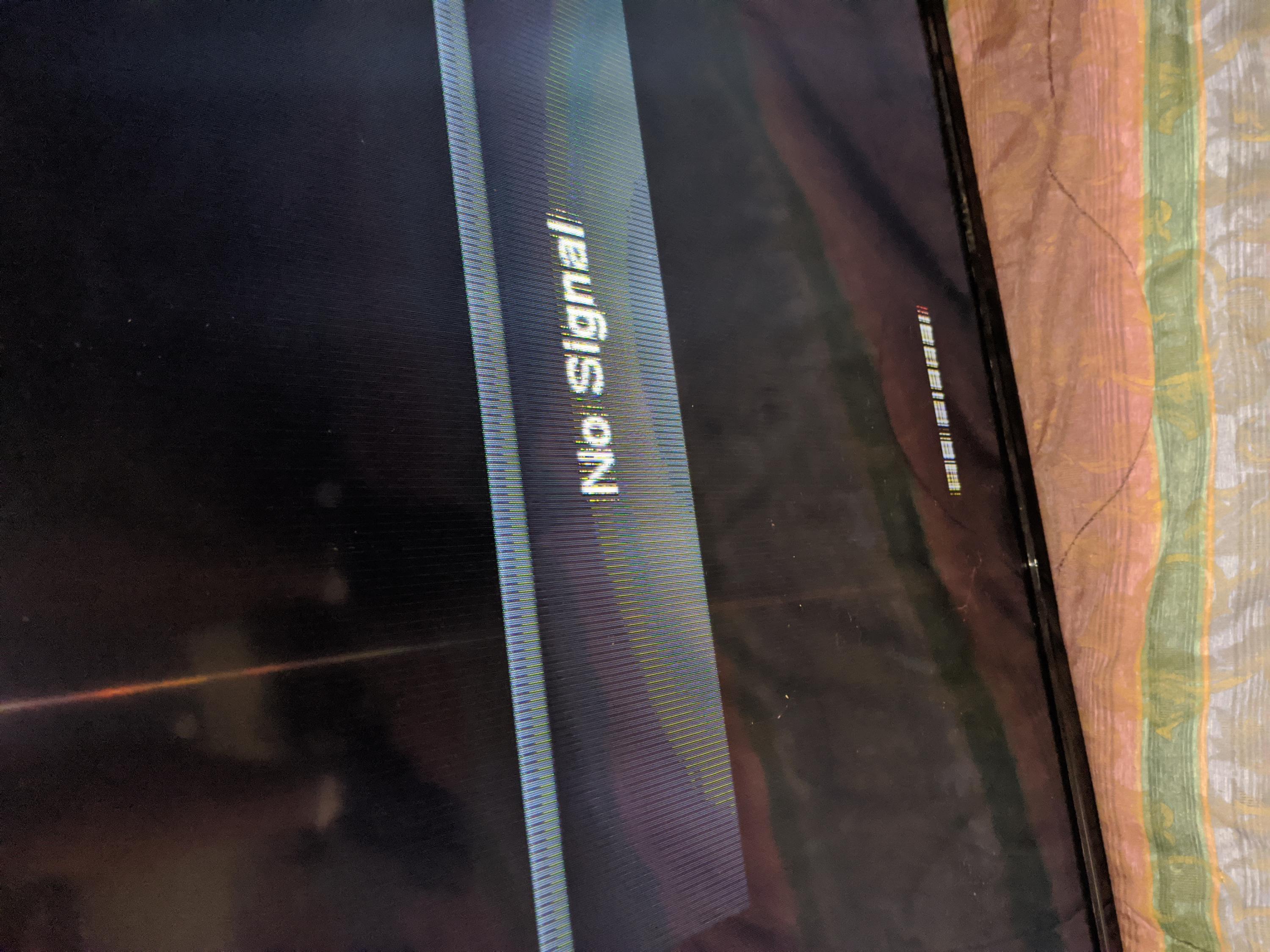

              Removed bottom left ribbon cable to drivers and this is what I have. Anyone know if this is a bad left side driver? Haven't tried other side but can you tell by the picture? Dark pic in middle and I'm not sure if panel is bad.

                #1007
                Re: e701i-a3 no picture but backlights
                I was given a tv with this same problem. I replaced the tcon board and disconnected the ribbon cable connecting the driver board on the right(from the front) side. My results are attached. Going to attemp to remove the right driver tabs. I'll share my results for any still facing the problem.

                  #1008
                  Can't tell from the pictures, what is your result one half good picture and other half distorted or horizontal lines running thru it? and you tried unplugging both ribbon cables from tcon to panel one at a time right? (always with tv unplugged from power) when unhooking cables.

                    #1009
                    Yes. Sorry for the bad pics. Removed the right side driver tabs, but part of it didn't come off cleanly. I'm slowly cleaning the residue off. Currently there is a section in the middle with some short horizontal colored lines,
