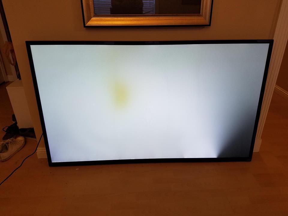

                  Originally posted by Lyle Beach
                  So... I removed the left side drivers from the TV and I have "partial" success.
                  Picture is great on both sides mostly, but there is a big brownish "splotch" towards the right center of the screen. I made darn sure that all the driver ribbons were completely removed from the screen, and tried to make sure that no "remains" of the ribbon was left on the screen. What do you think is causing this defect?
                  I cleaned all the ribbons with 91% alcohol, and reconnected. When I turned the set back on, I was getting all kinds of weird vertical colored lines on the right hand side of the screen. I guess I didnt get the ribbons seated again properly, because when I adjusted them... I finally got back to where I started with the big "blob" on the screen.
                  I have attempted to remove, clean and re-install the LVDS cables too. And tried to take the best care possible to make sure they are re-seated properly.

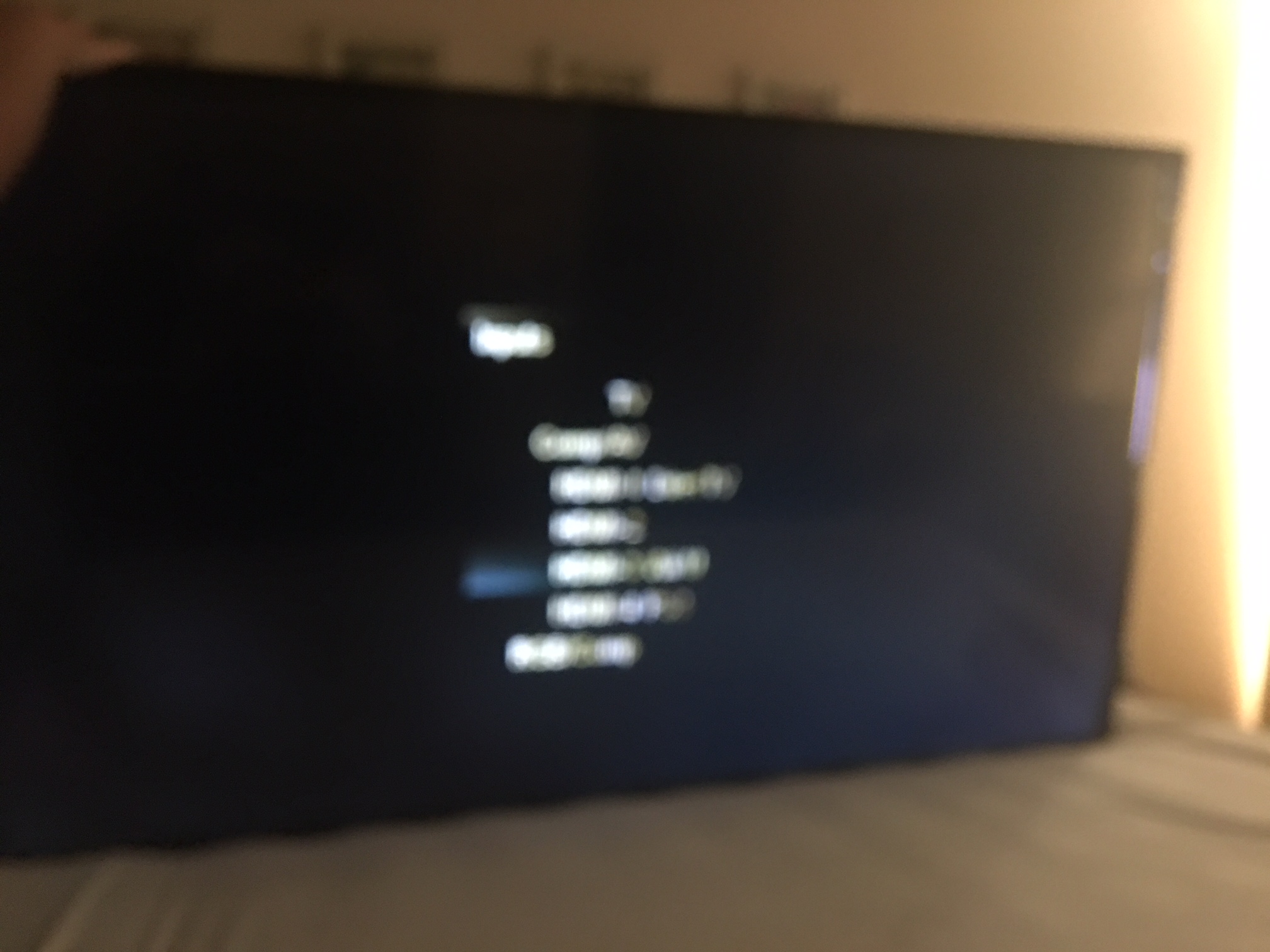

                    Hello Everybody!
                    So, I have one of the fabled e701i-a3s... Almost 2 years ago my wife called (I was on travel) and said it just all of a sudden stopped working. I told her I would check it out when I got home. When I got home, I went down to our rec room and the lights were out, but the TV was on. You could see the screen was on and you could hear noise from the speakers, but it had no picture at all. So, after reading so many threads and videos about this over the last 2 years I'm planning on tearing into this tonight. I know that I won't have a working TV tonight, but at least I'll know what part I need to order. I'm planning on tearing it down and at least determining which version of the T-Con board I need to order. I plan to buy a direct replacement and then follow the steps provided by the OP to see if I can get the TV working again. In the interest of saving time, I plan to buy two boards at once, just in case. haha.. I hope to become a part of the success stories in this post. If anybody has any specific pointers/tips I'm always open to suggestions.
                    TIA!

                      Re: e701i-a3 no picture but backlights
                      So, just an update. I got it all apart, hardest part was removing the back cover. Haha. Located the model # on the T-Con board, it is a cpwbxruntk5261tp I have preferred two “New” replacements. I figure it doesn’t hurt to have a backup in case I mess something up. No way I’m going to replace the bad parts. My soldering skills aren’t that good. I’ll update with my results when the new part arrives. I’m gojng to try and do a visual inspection of the driver boards and see if I can determine the bad side without taking a shot at the t-con board.
                      Wish Me Luck!

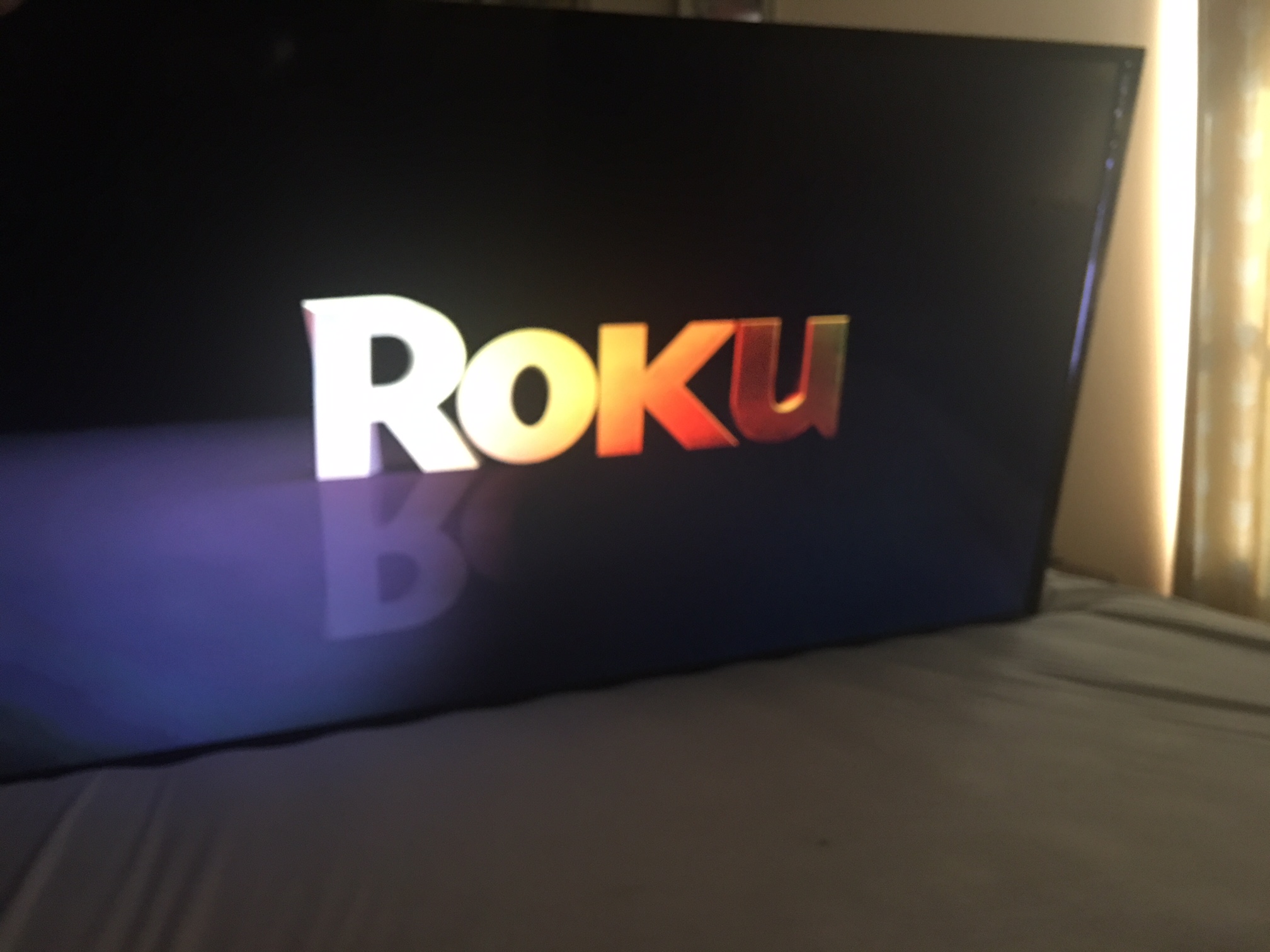

                        So, here's what I have so far.. I replaced the T-Con board and disconnected the right side driver tabs and this is the result (it's a picture!) I'll post another picture in just a second.. I'm afraid to leave it on too long and blow the board if this isn't right.. Any input would be greatly appreciated!! BTW, the picture is sideways.. ;\ So the bottom would be the left side of the screen if you're looking at it from the front.. I'm guessing with this result I just need to make the leap and remove the right side driver tabs?
                        TIA!
                          Update! Looks like the Right side is def. the culprit... Please see below, confirmation would be greatly appreciated, but I'm going to take the leap one way or the other in the next hour or so.. I'm running on borrowed time, my in-laws are returning home tonight and the TV is on their bed.. Don't think they'll want to sleep with it! hahah
                              Yes. Strip off the right side.
