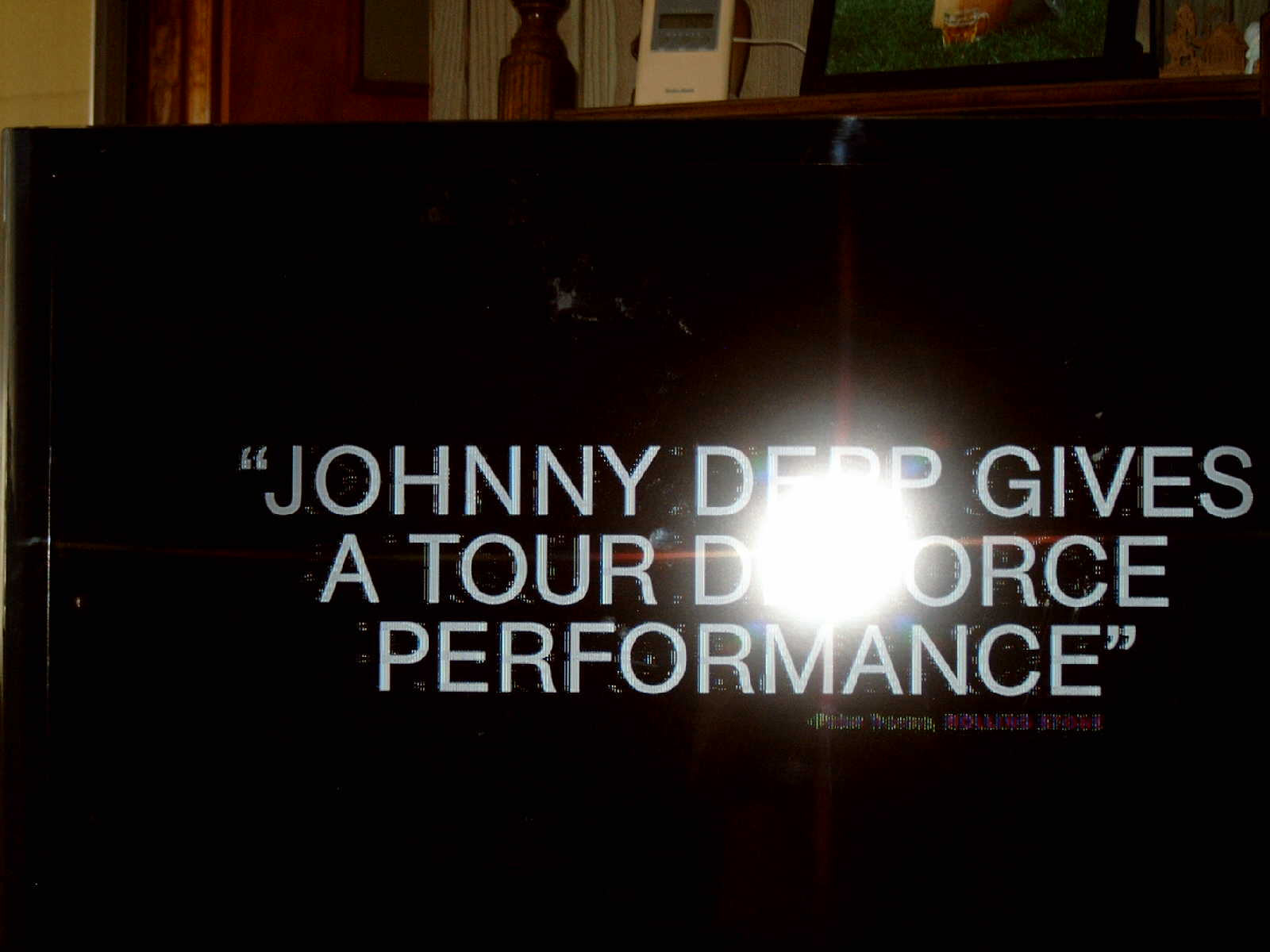

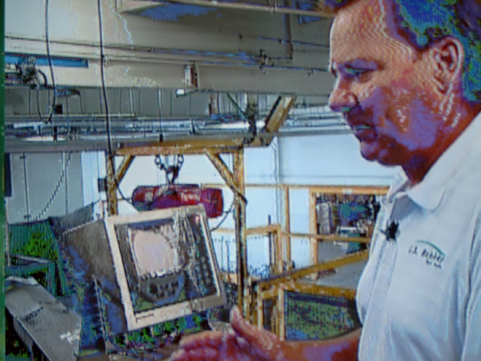

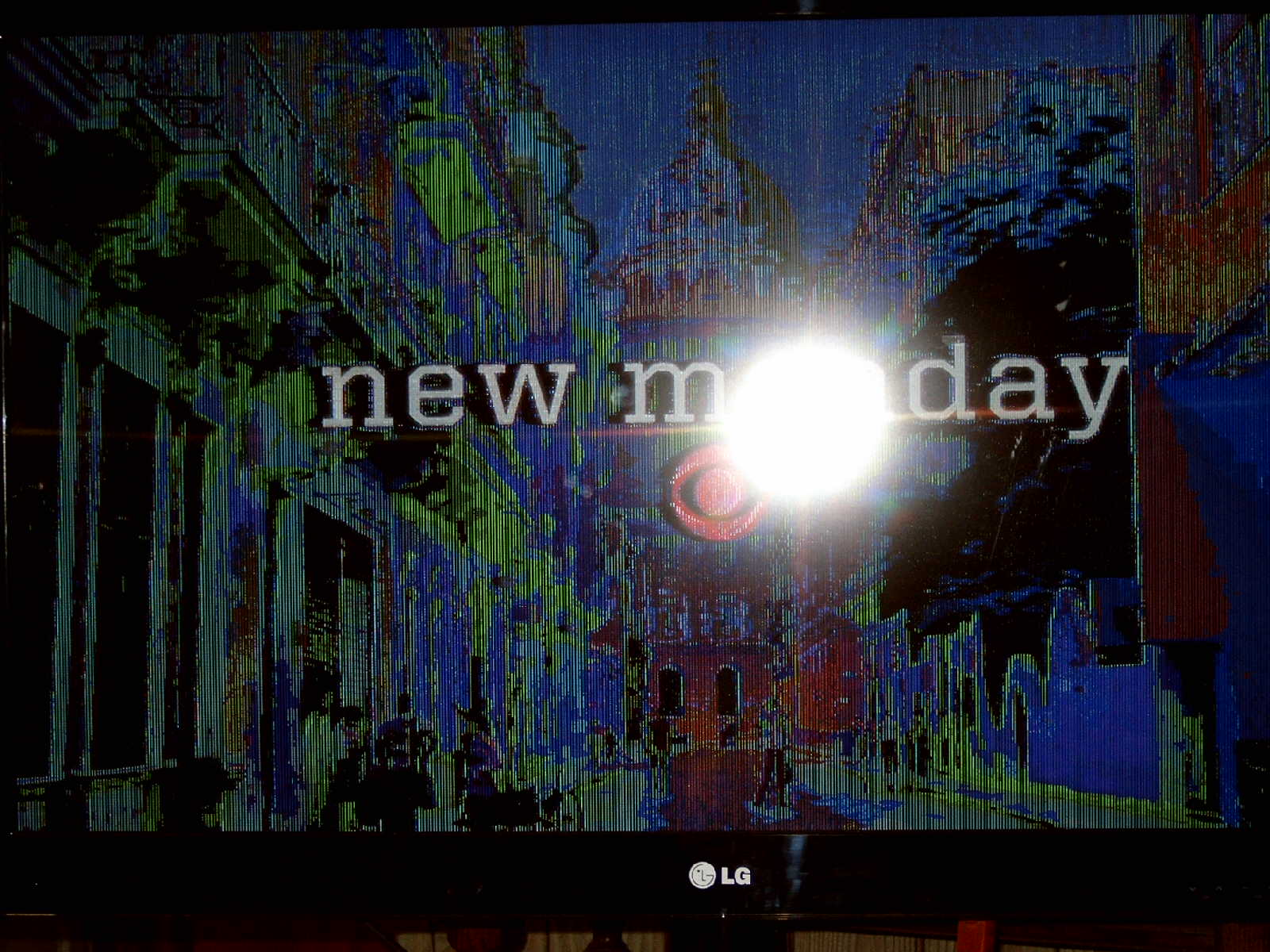

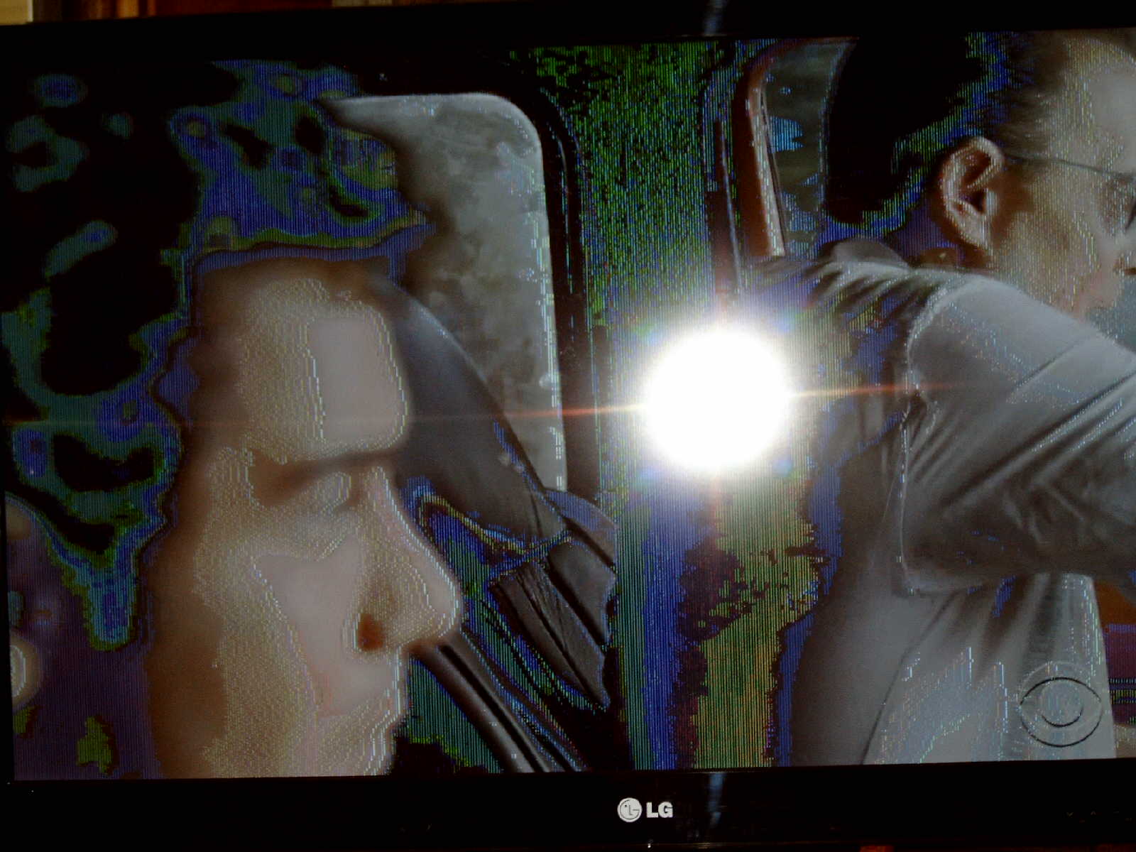

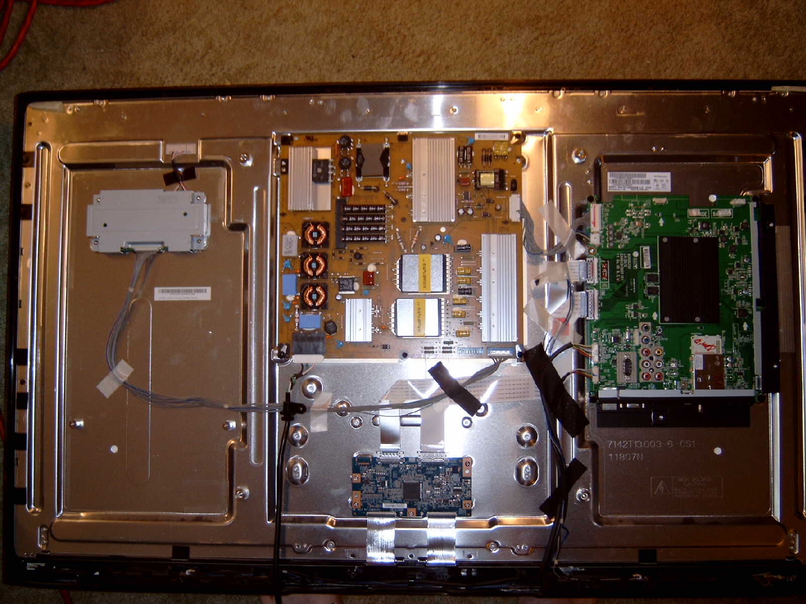

    I have an LG 42LV5500-UA.AUSDLUR with panel T420HW08 and an AU Optronics T-Con T315HW07 V9 31T14-COA (55.42T13.C06)
    I thought that the tv fault was the gamma ic on the t-con board since the symptoms look like the solarization fault. There are some fine vertical lines to the left of the images and the colors are messed up.
    I ordered another t-con board with exactly the same numbers as above and upon installation the fault looked exactly the same. The board was purchased from a reputable supplier of boards (not Ebay). When I contacted them about a return they offered to send out another t-con but did not have it in stock.
    I returned the board.

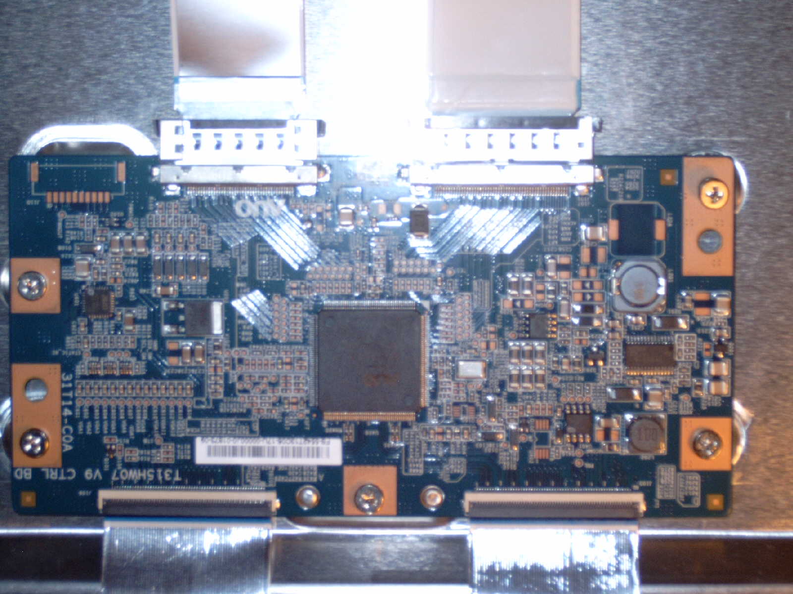

    If you look at photo of the t-con board I think that the gamma ic is on the upper left near the mounting screw - sorry, I know the pic isn't very sharp.
    I believe that the gamma ic is AUO-G1422 and it's a qfn package.
    The voltages on the original board (forgot to measure the replacement) are as follows.
    VGA1-15.08
    VGA2-14.61
    VGA3-12.53
    VGA4-10.88
    VGA5-9.94
    VGA6-8.51
    VGA7-8.46
    VGA8-7.72
    VGA9-7.68
    VGA10-5.24
    VGA11-4.29
    VGA12-2.89
    VGA13-.72
    VGA14-.31
    So the question is do you think that the t-con is bad or is it a bad panel or main board?
    Has anyone seen this issue with this model of LG set or this panel?

      If you stick the values into Tom's T-con check sheet here https://www.badcaps.net/forum/showth...ighlight=gamma then the gamma voltages do look off.
        Re: LG 42LV5500 solarization? - t-con, mainboard or panel?
        VGA6-8.51
        VGA7-8.46
        VGA8-7.72
        VGA9-7.68
        These 4 do not look right, barely difference between each pair.
          This level of solarisation is likely to be a main board issue more than anything else.

            I didn't think that the main board could cause that kind of fault. Any solarization faults I've seen have been t-con related.
            Tom, if it is a main board problem that would certainly explain why the symptom didn't change with a replacement t-con.
            I welcome all the opinions and wish I would have taken gamma voltages on the replacement board I purchased before sending it back.
            Keep in mind that I think the gamma IC is the AUO-G1422 and not the AS-15F that usually fails.
            Do we think that the curves are valid for that chip as well?

              i wonder if its worth heating the mainboard up to see if it makes things better or worse maybe a bga issue? there are some updates on the lg site not sure what there for though

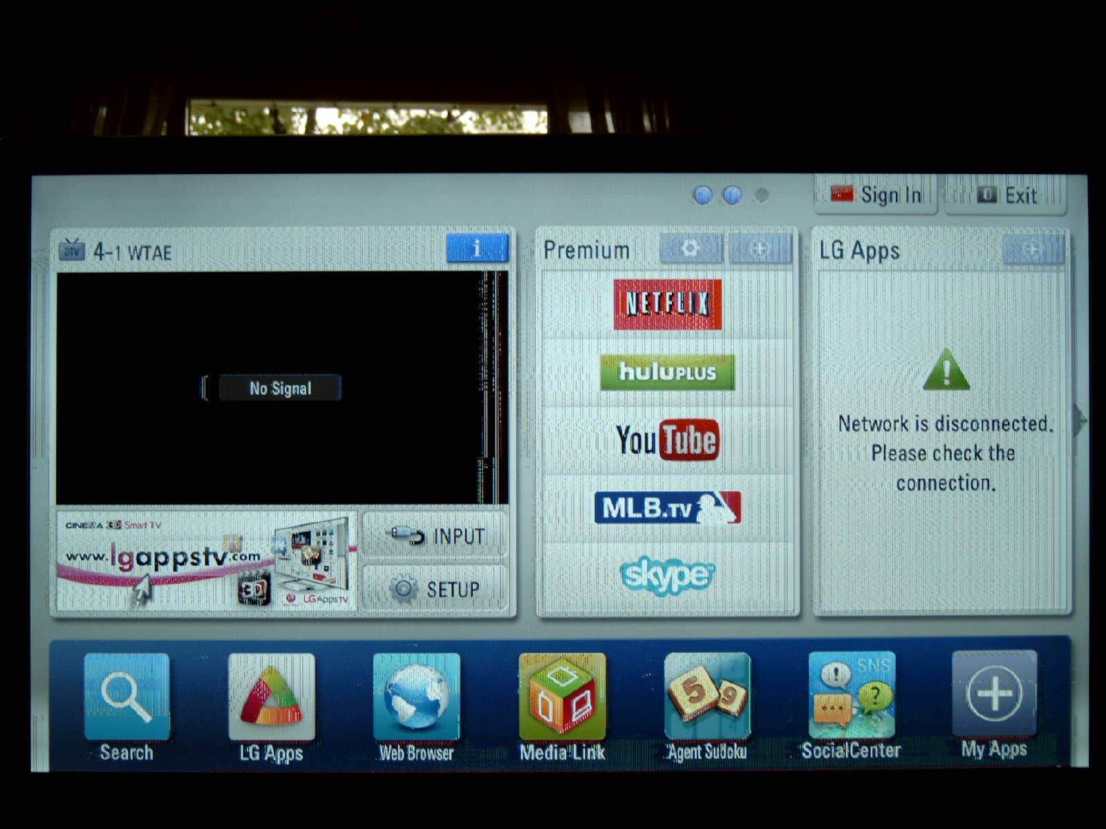

                I took another picture today of the main menu on the LG.
                The solarization isn't really evident but the lines to the left of the images are more clearly shown.
                I upgraded to the most current version of firmware available on the LG website and the symptom is the same. When I checked the firmware previously online it told me the version was the most recent.
                Does the new photo provide help decipher the problem?
                Thanks,
                Mike
                  Definitely a main board fault.

                    Re: LG 42LV5500 solarization? - t-con, mainboard or panel? - Fixed!!
                    Thanks to all that replied.
                    I took a chance and baked the main board last night at 385 F for 10 minutes in my oven.
                    After letting it cool to room temperature with the oven door open - I reinstalled the main board.
                    I watched game 2 of the World Series last night! Picture looked very good.
                    Looks like it was a solder issue - the original t-con board is still in the set.
                    Still have to check the hdmi inputs, etc.
                    Hope it lasts.
                    Mike

                        The reason that I took the chance was that I could not find the main board anywhere. The only possible choice was a board from Israel that made the repair uneconomical.
                        There are several different main boards for this set.
                        I am skeptical about things I see on the internet and frankly did not expect the results that I got.
                        Baking in the oven did verify that the fault was indeed on the mainboard and not the t-con or panel.
                        Will it last? Only time will tell.
                        I just wanted to post my results to give closure to the thread.
                        I would never resell this set based on this kind of fix.
