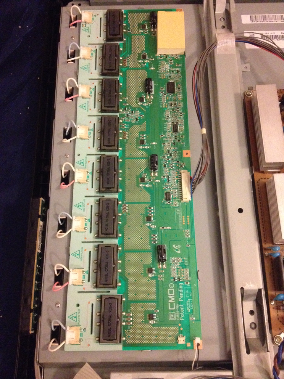

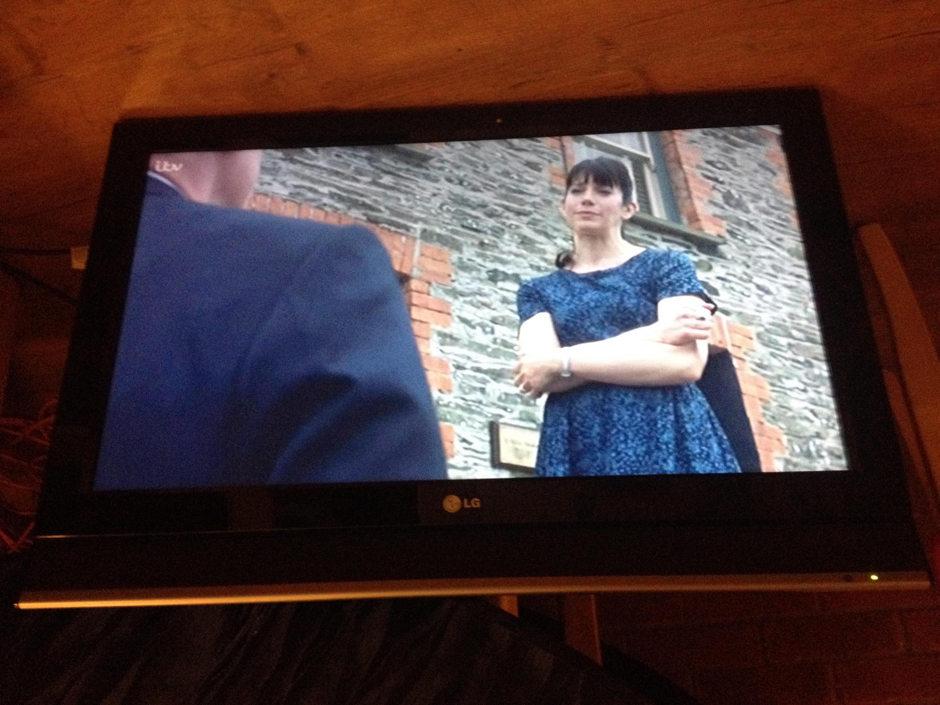

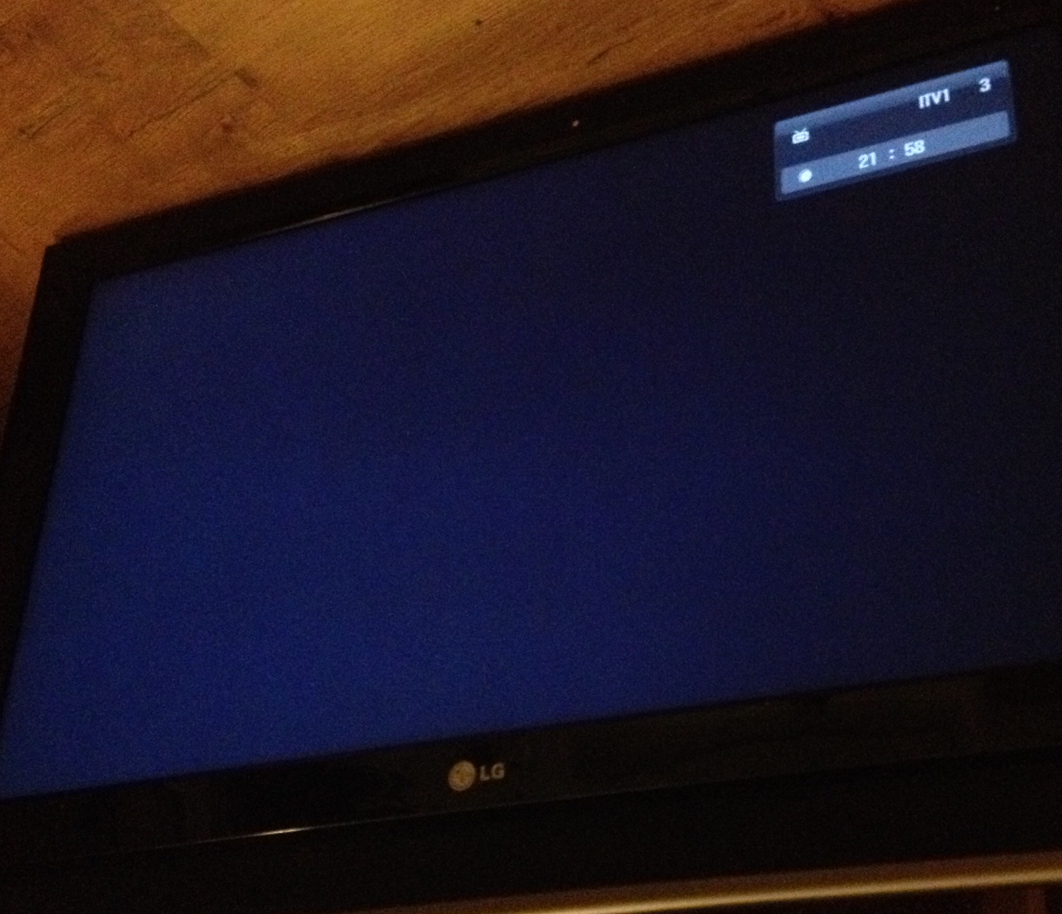

    Hello,I would need some help with my lg 32Lc46 ,when power the unit tv comes on for about 3-4 sec all good picture and sound .
    After 4sec sound stays on but no picture.
    Power board is fine all reading good.
    How I check the backlight invertor ? Could be the ccfl faulty ?

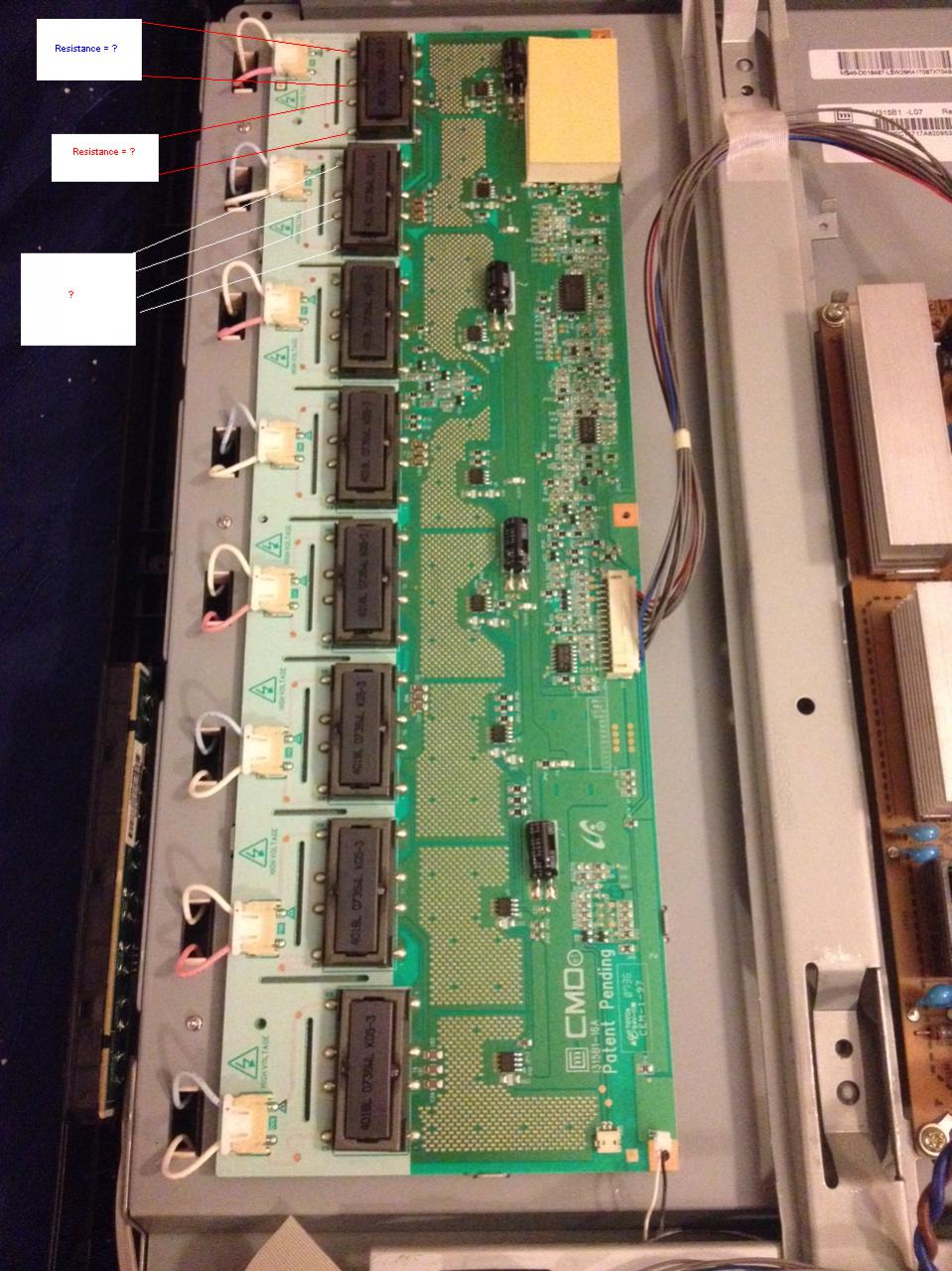

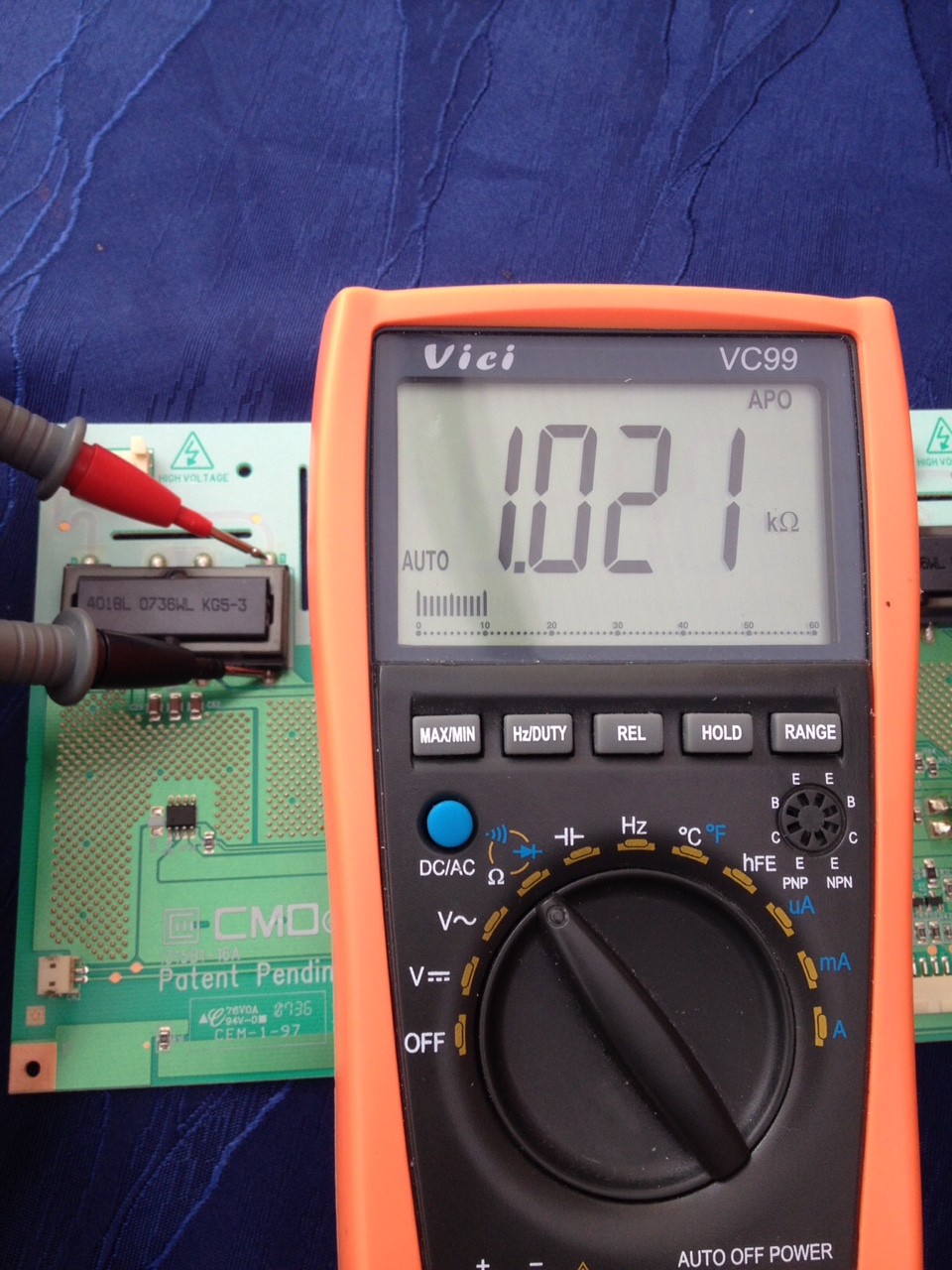

    Re: Lg 32LC46 Backlight cuts out after tv on for 3-4 sec

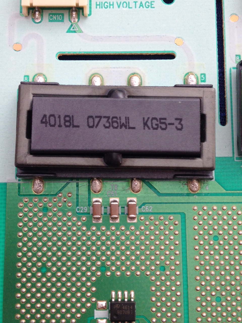

    Сheck resistance on all transformers.
        those transformers should be within 3% of each other.

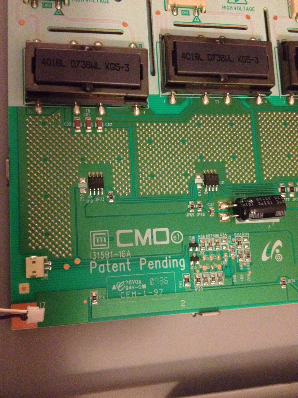

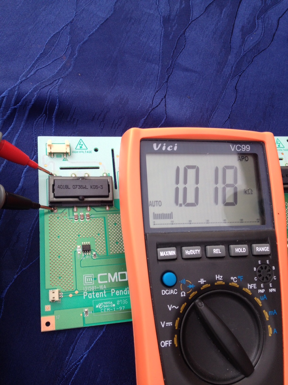

          Hi,I checked all 8 transformers between pin 1 and 8 , pin 4 and 5 and readings are:
          1.021 kohm pin1 and 8
          1018 kohm pin 4 and 5
          Could you let me know if I measuring the right pins ?

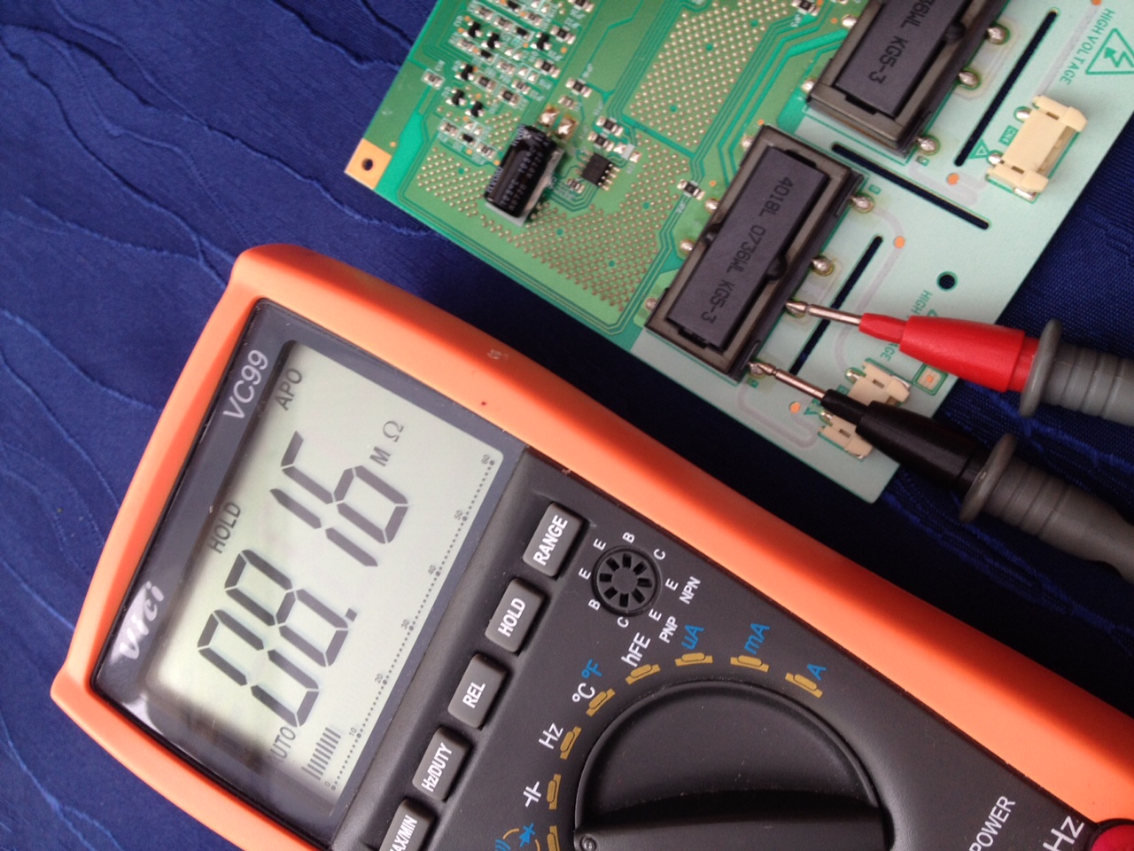

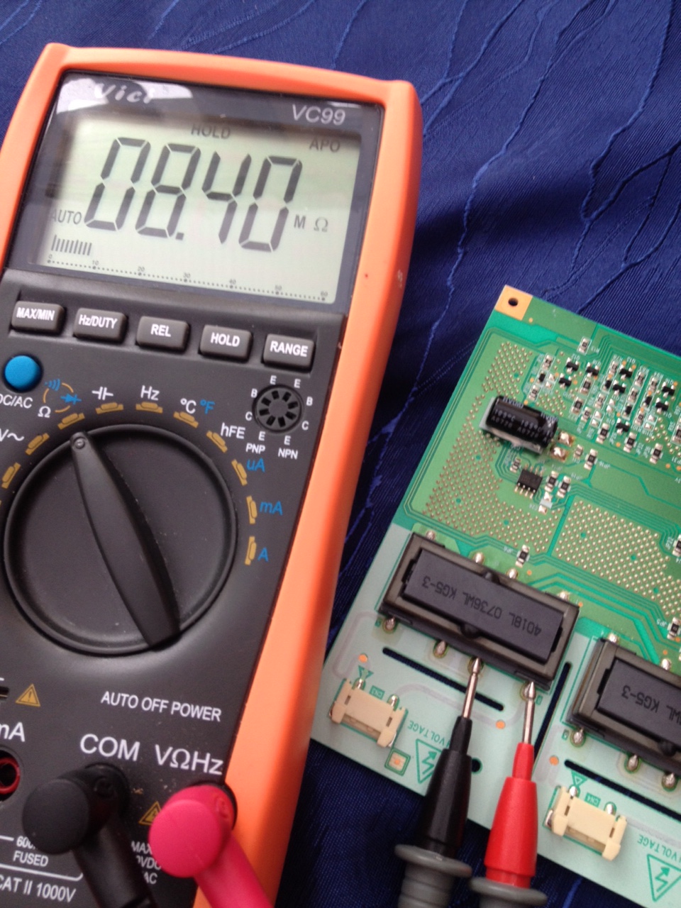

            hello,I just received the photo from Maklaud and the resistance between pin 5-6 is 08.16 mohm and pin 7-8 is 08.40 mohm
            Checked all 8 and they are the same value .
                no caps in series so measure/compare at the ccfl connector.
                very likely you have a bad transformer.common on those inverters.
                could also be a bad lamp.
                    Thanks,already measured that way and I have around 1.068k on all 8 of them.
                    To be honest I don't think are the transformers who have failed on this inverter

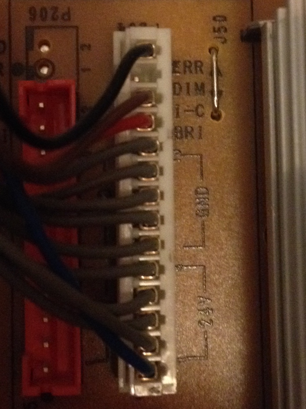

                      what voltages change? on the power supply when the picture goes off.
                        The BL-ON and the Dim control signals are still present when the lights go out?
                          Thank,between the connector the measurements are nearly the same 2.043k

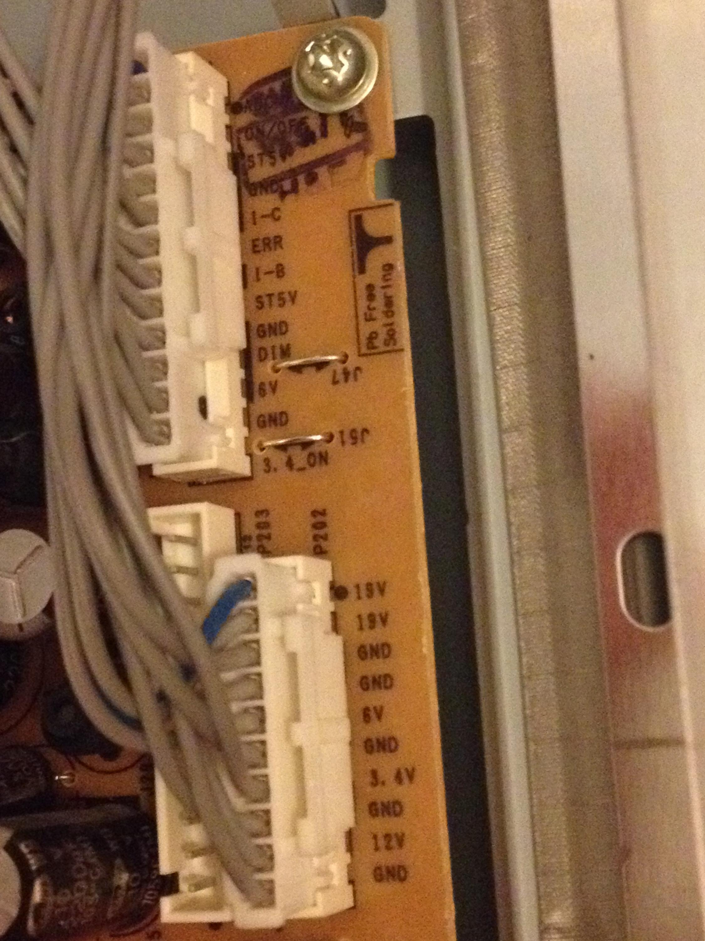

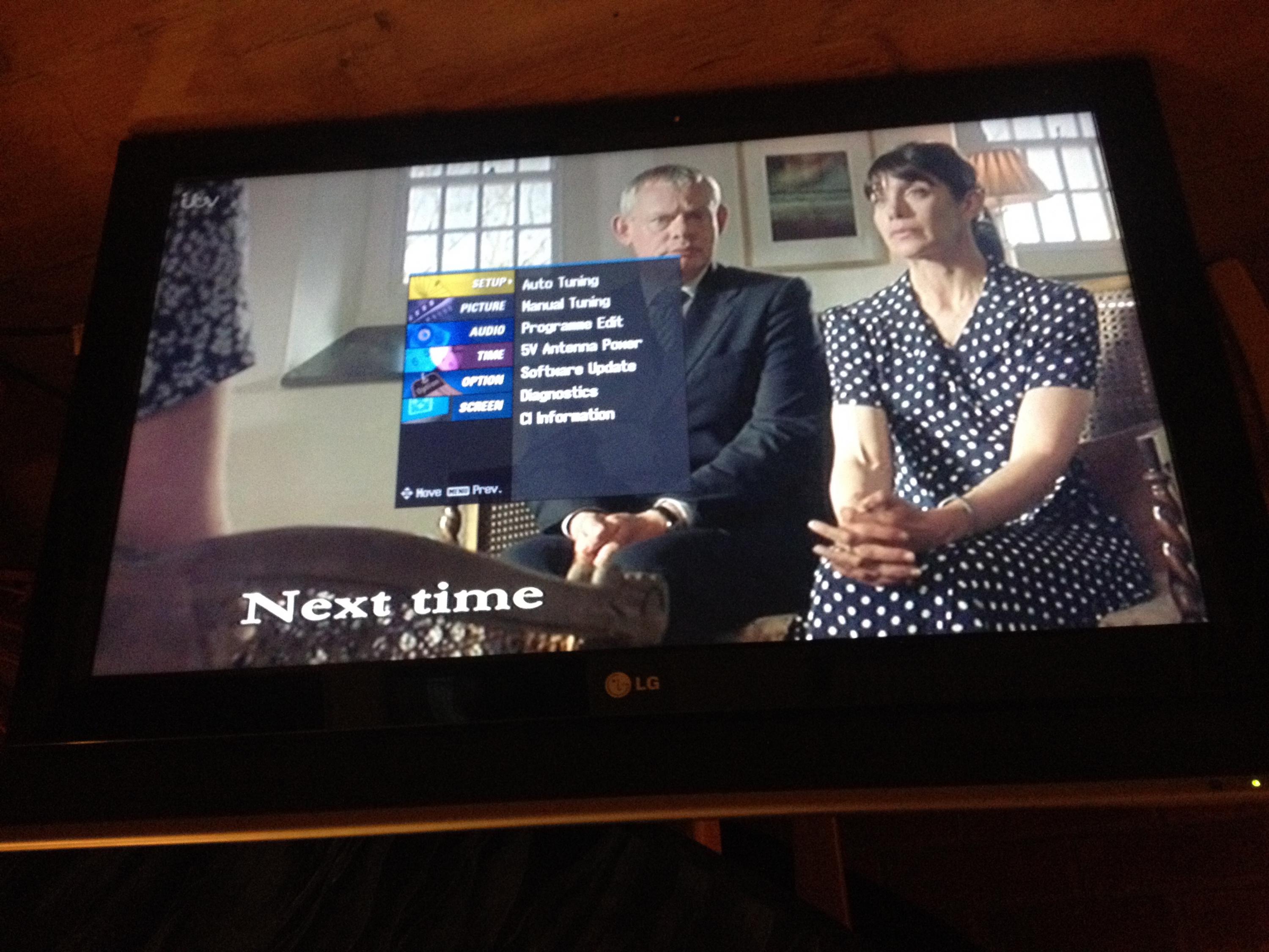

                            Reconnected the inverter to the tv and after reading all values with the picture on and with the picture off all readings from the main board remains the same.
                              BTW, you are running the Inverter board without the shielding in place and do not see any mounting screws for the inverter board to GND the board to the chassis.

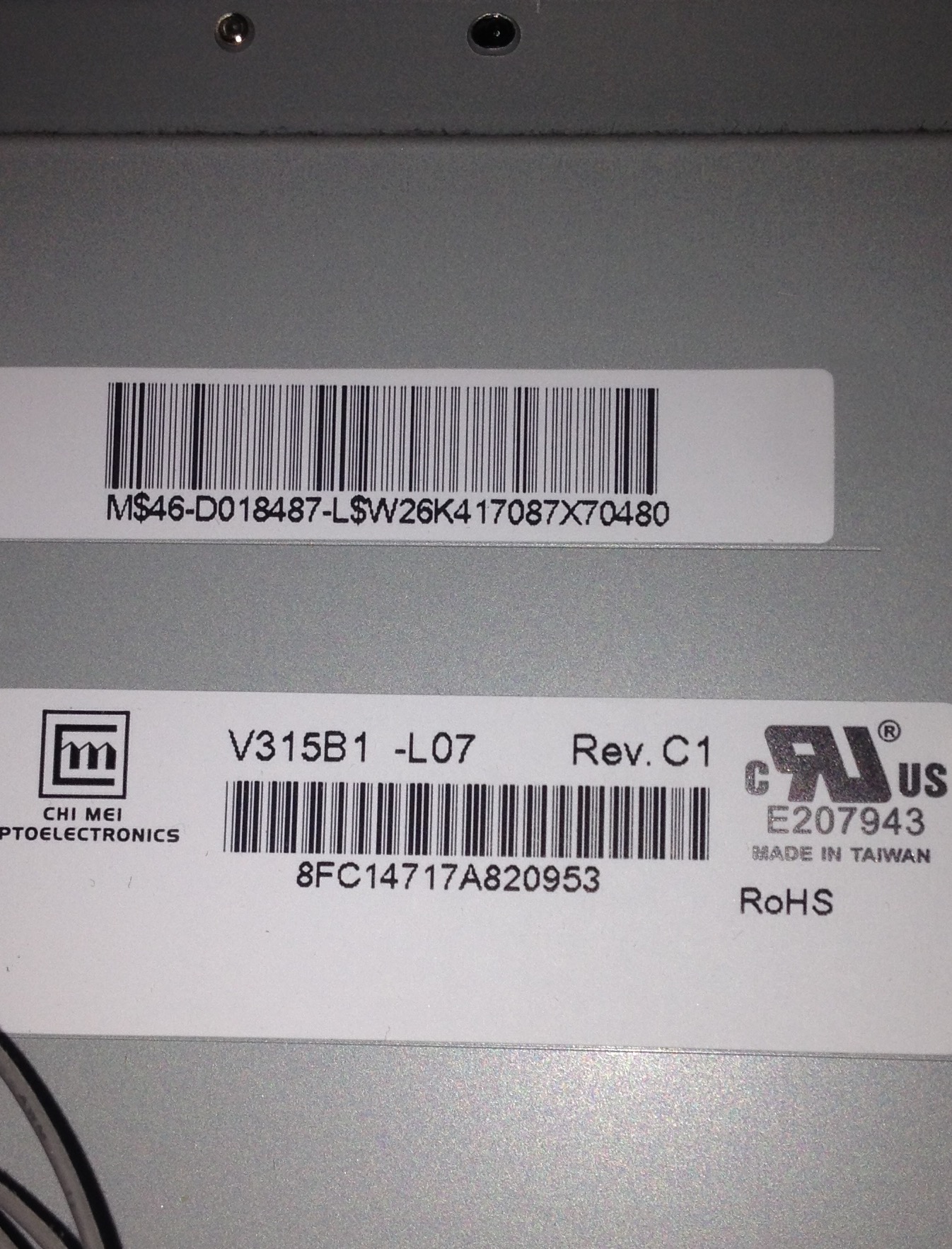

                              Do you have the LCD panel model number?
                              You may have lamps problem at this point if everything checked out fine on the inverter board.

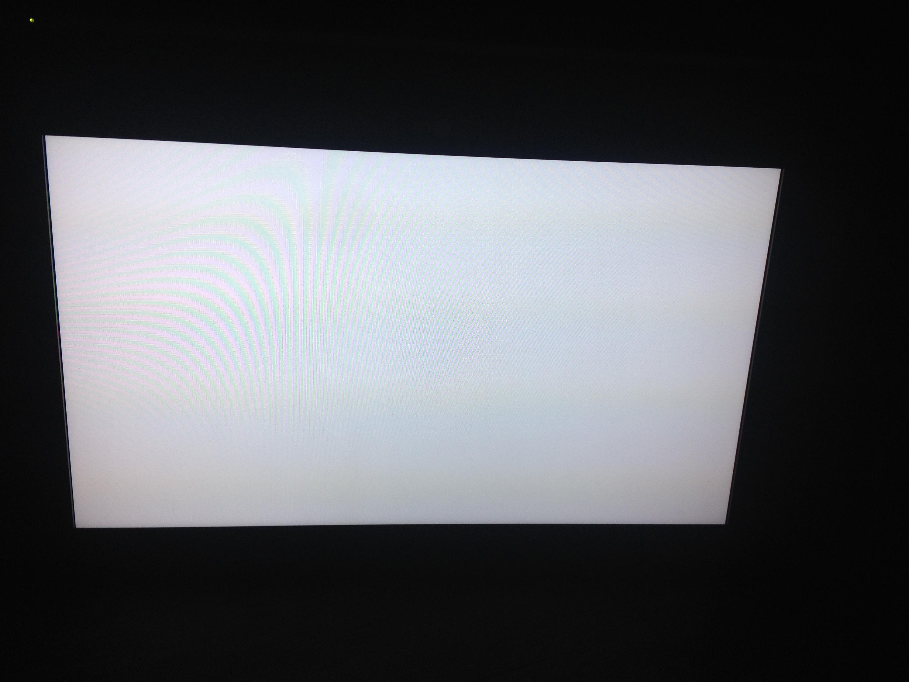

                              May be you can try running video with the white back ground then you may be able to see if one of the lamps is not on, you will see horizontal gray bar where the lamp is not lit.

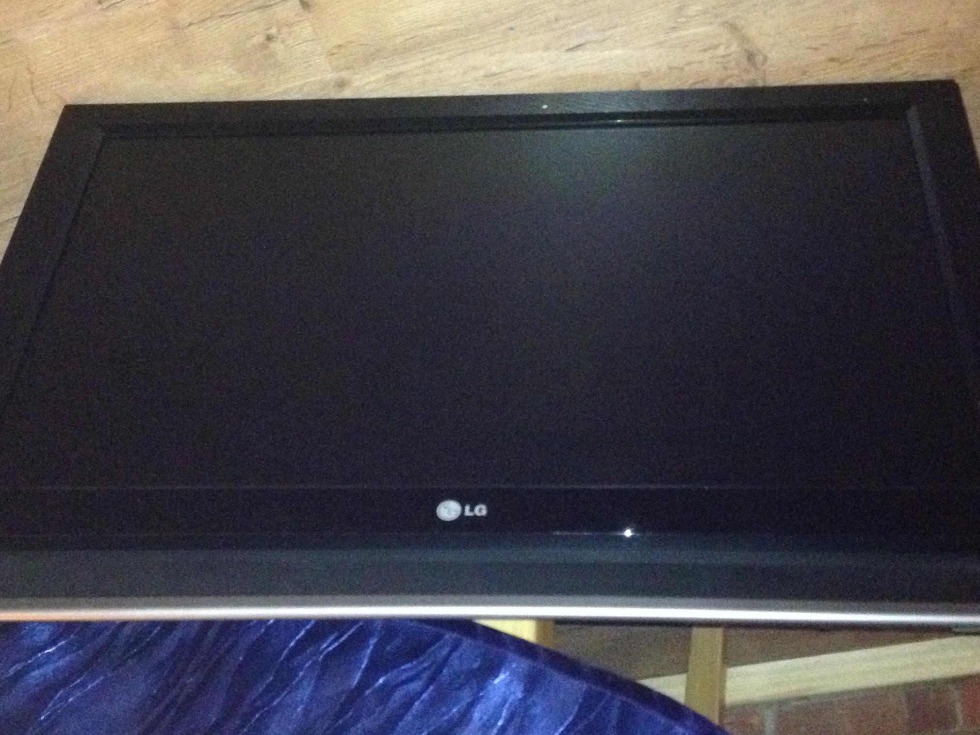

                                  Panel number is V315B1 -L07
                                  When tv go off buzzing noise could be heard from the inverter and the screen is black no light at all.Photos attached when tv working and with the black screen sound fine.
                                    Well, try that white screen test in the darkened room , may be it will be on long enough for you to see if all the lamps are on.
                                      I have tested with the white screen and looks absolute fine with all the ccfl light up.
                                      I will resolder all the transformers pins and see what happens .
                                        Try to block protection OZ964GN. Then try to remove one of eight transformers. And one by one test.
                                        And by the way...
                                        Where's your answer?
                                        Dim Voltage = ?
                                        BL-ON = ?
                                        I had a case when the backlight is blinked and inverter noise due to DIM (The problem was in the EEPROM on the main board)
