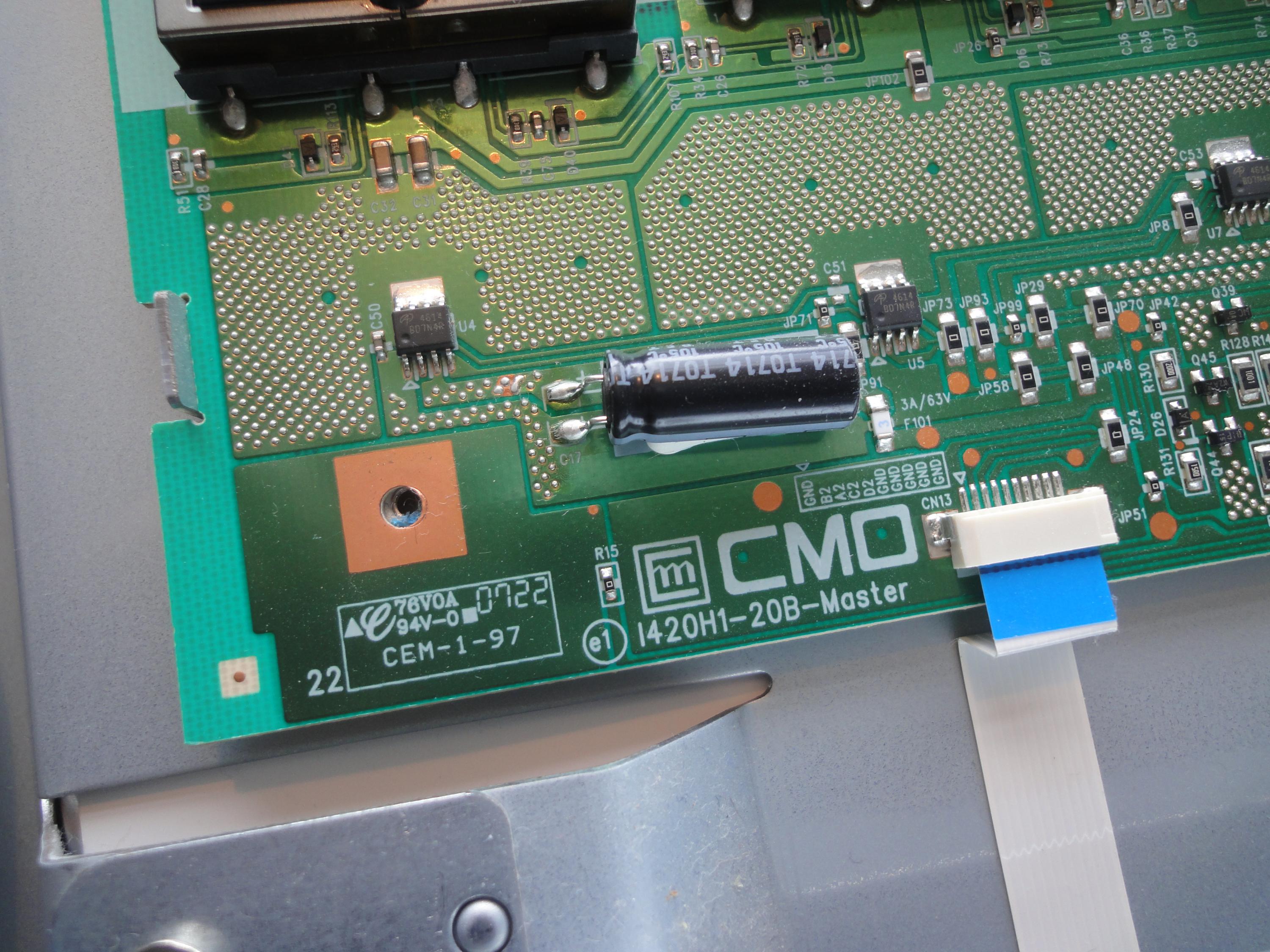

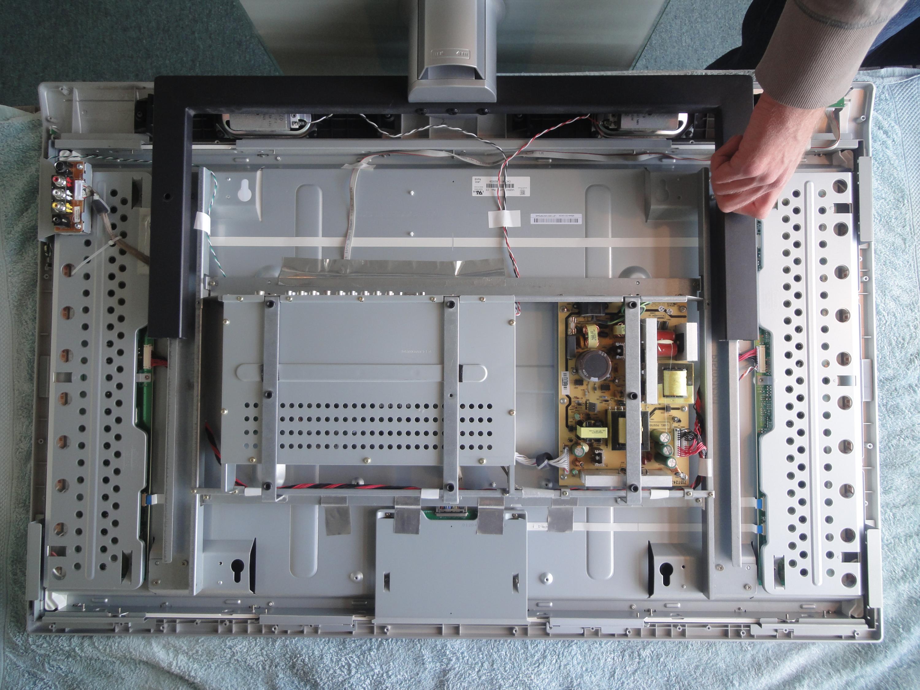

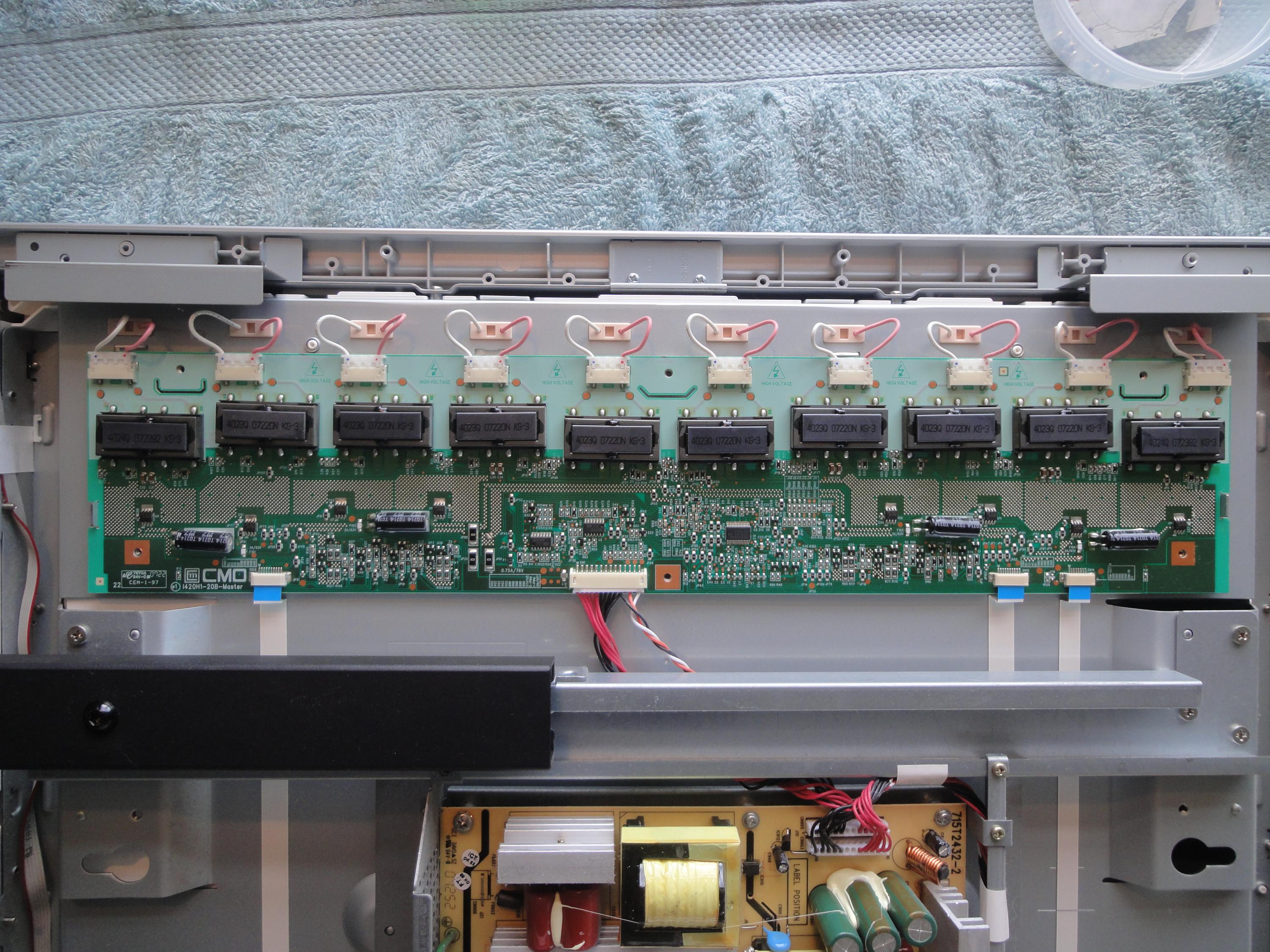

    A friend of mine has a Philips 47PFL7422 LCD TV and it includes some kind of dynamic backlight feature which automatically dims the backlight when the image onscreen is dark, probably to save power.
    Unfortunately, it seems too aggressive and can do it during dark scenes in films which creates a horribly jarring effect when the backlight level changes suddenly.The problem is also described here: http://www.geekzone.co.nz/forums.asp?topicid=22737
    In any case, for this model there is no service menu adjustment to turn the feature off, nor were Philips ever forthcoming with a firmware update, apparently. Which is stupid, since the brightness control in the main user menu doesn't do a thing to adjust the backlights either - it simply adjusts what seems to be the picture gamma. That's two things they should have fixed. Anyway....

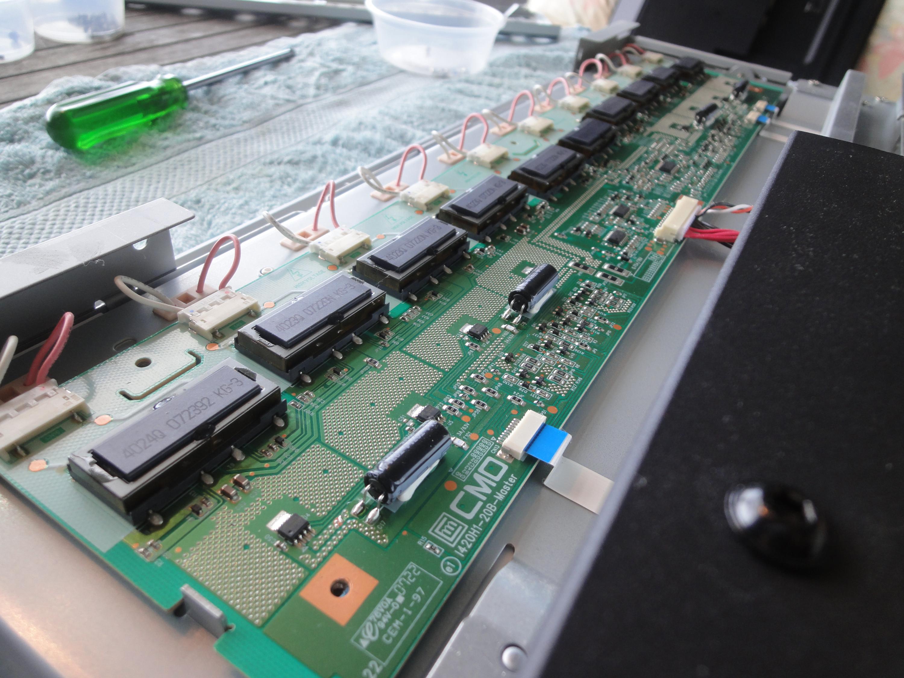

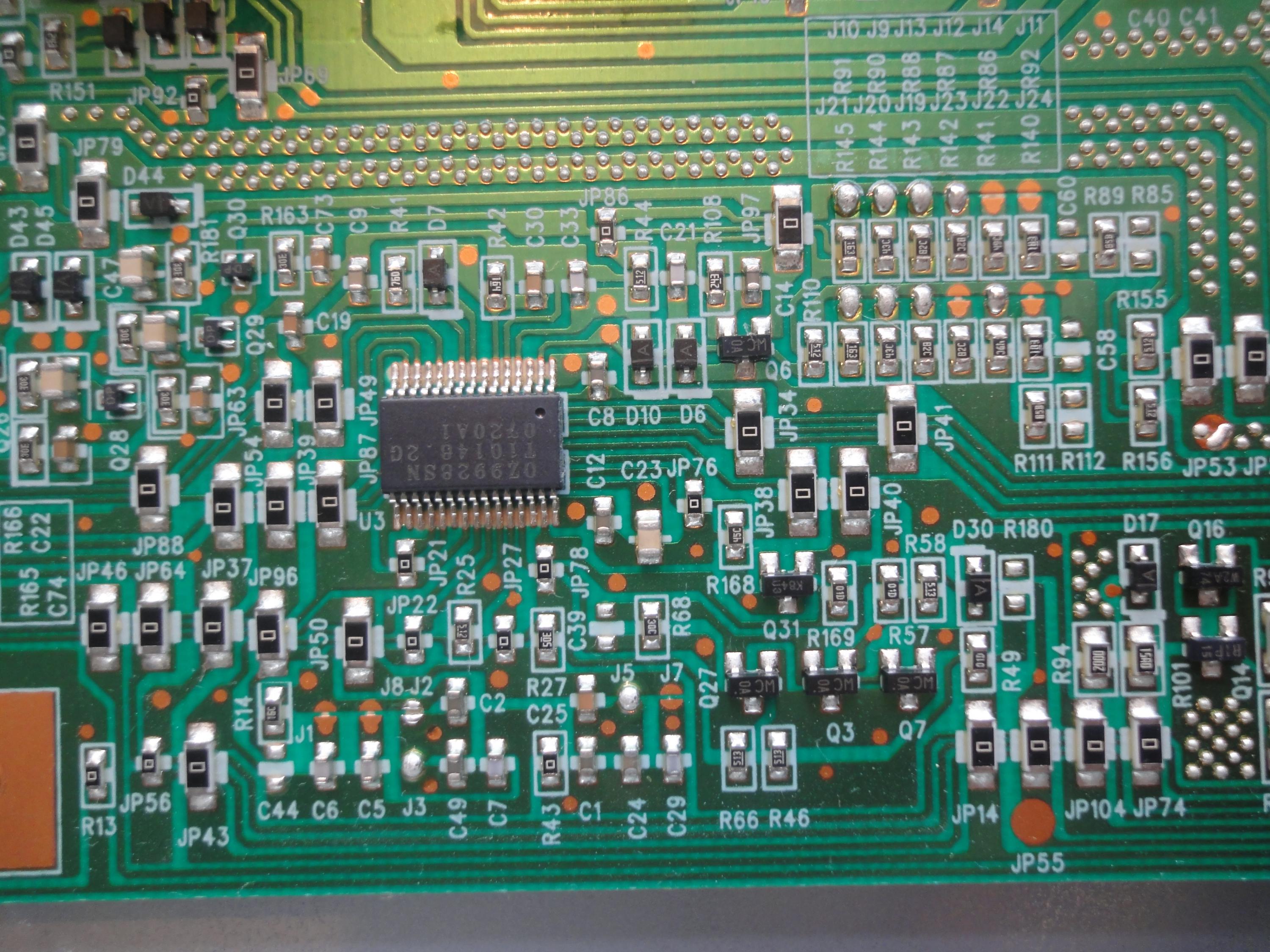

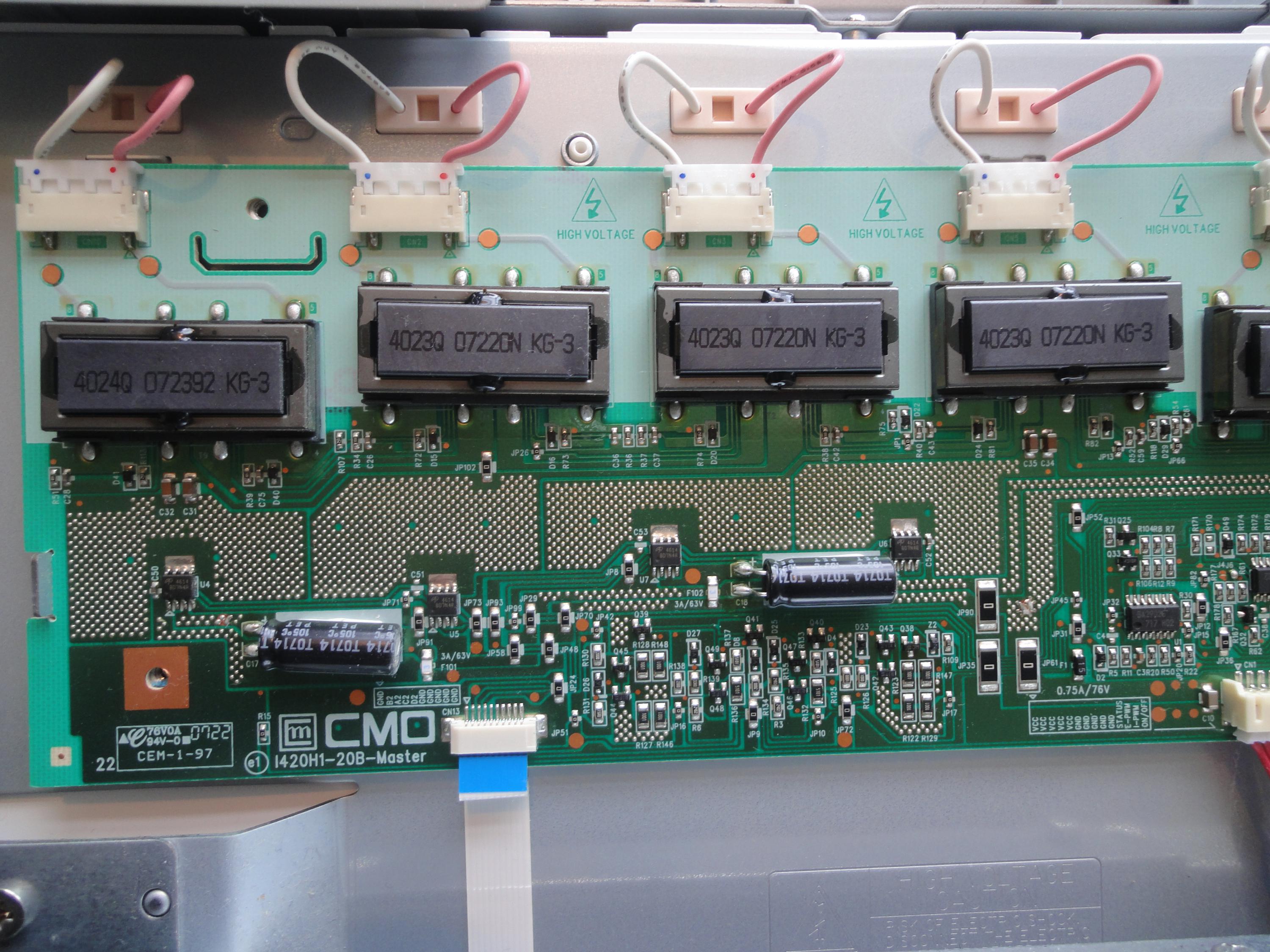

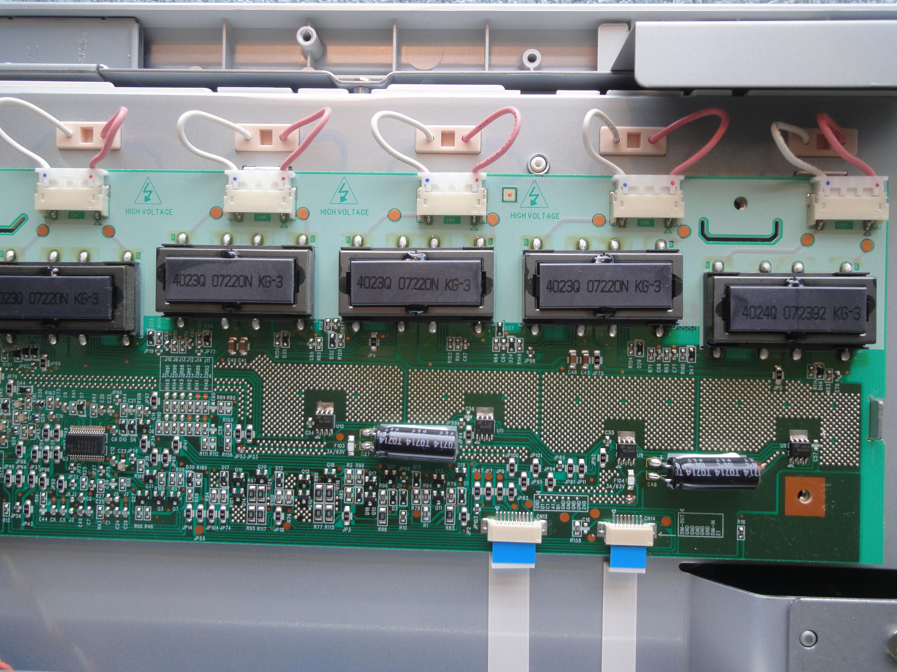

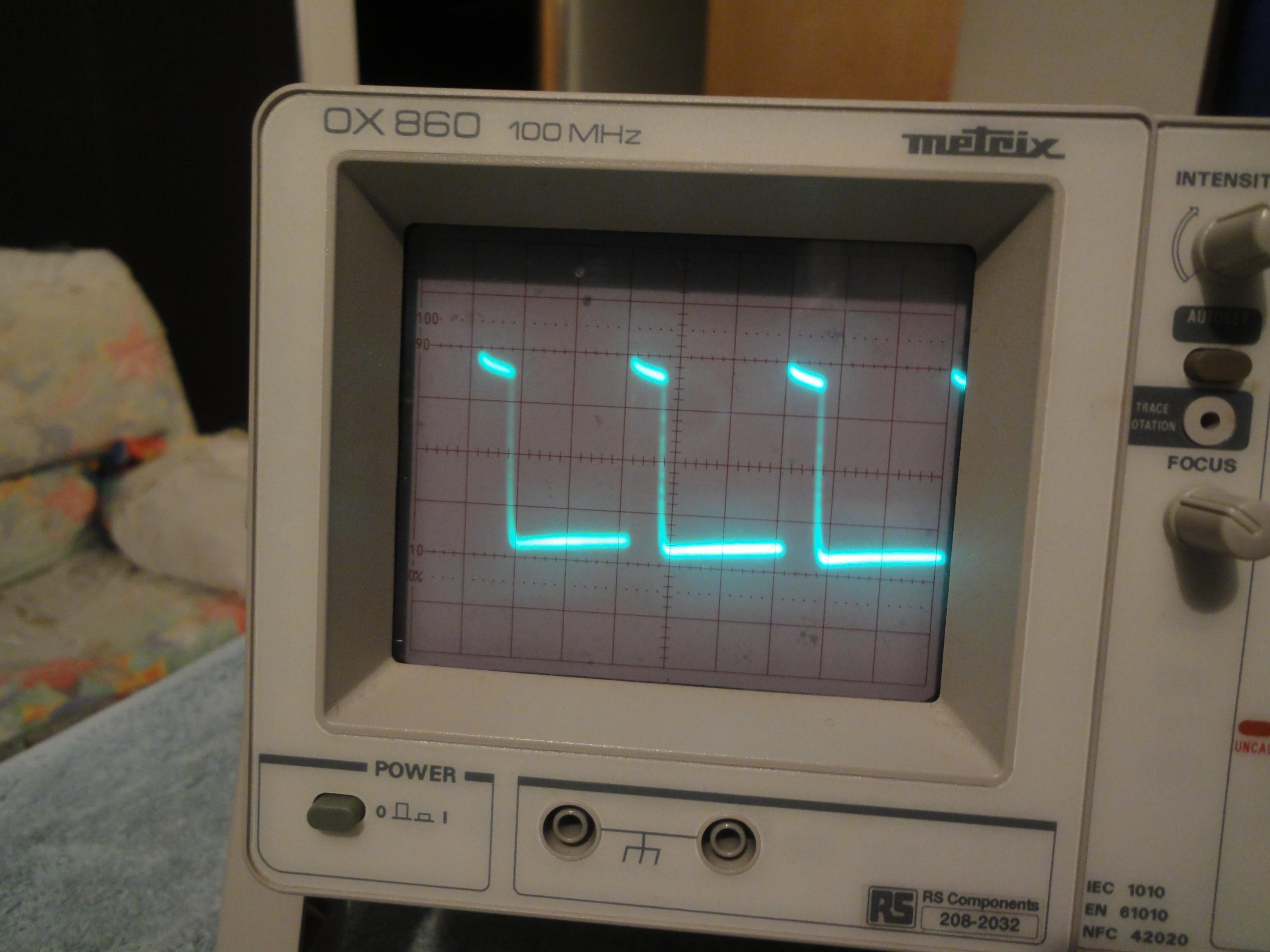

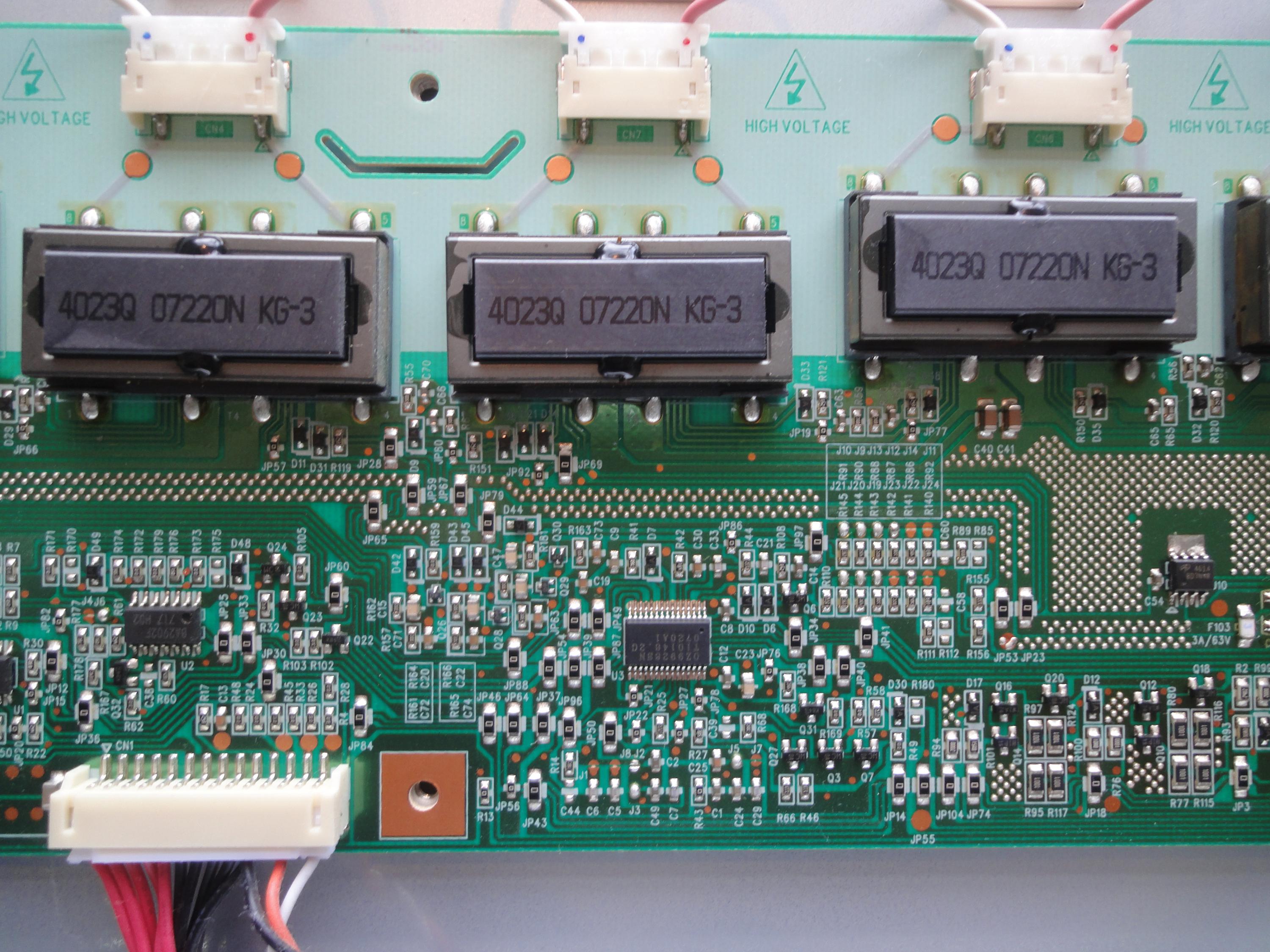

    The TV has two inverter boards, a CMO I420H1-20B-MASTER and a CMO I420H1-20B-SLAVE. Since these aren't made by Philips, they don't appear in the schematic, of course. They're based on the OZ9928SN.

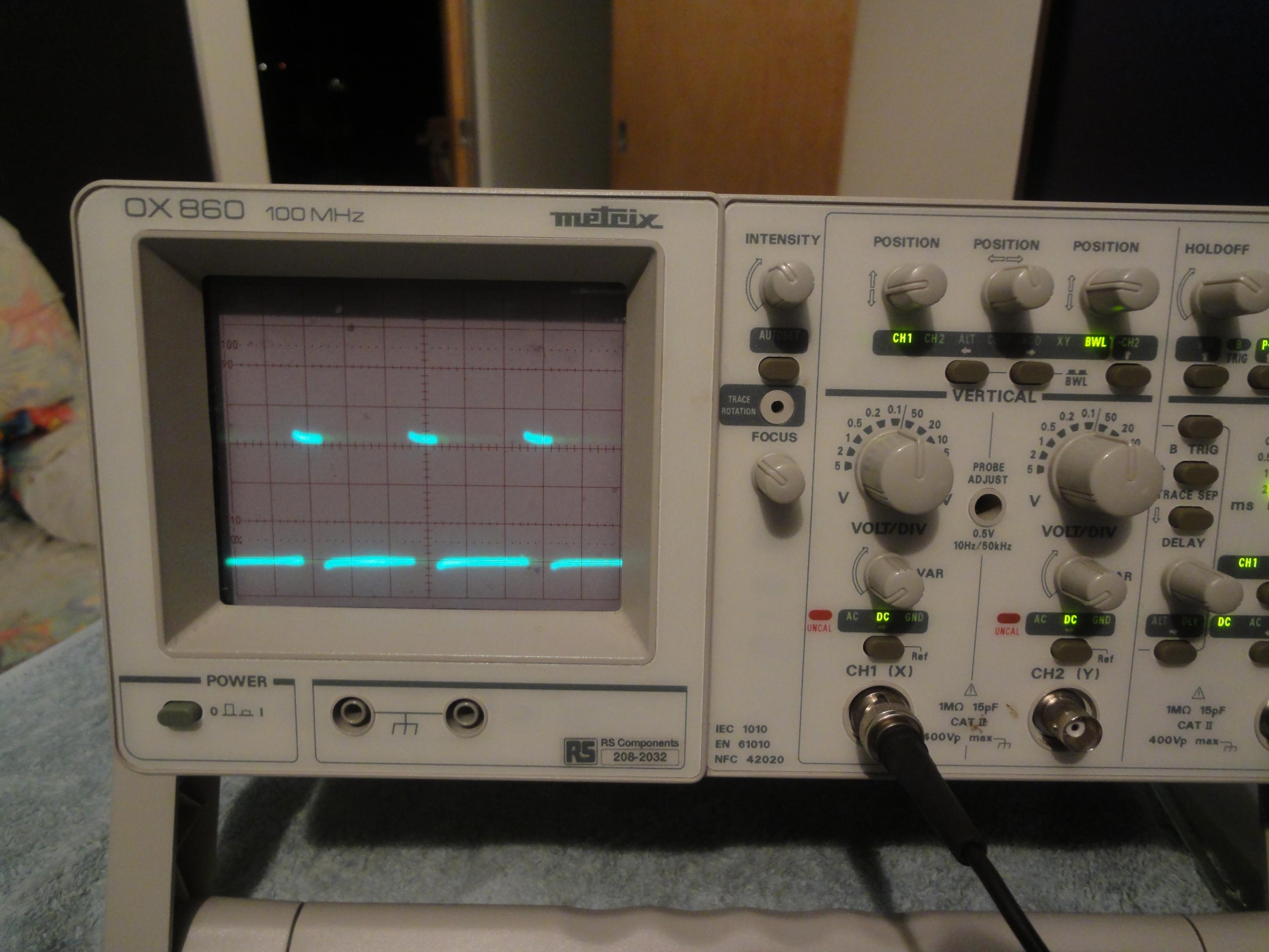

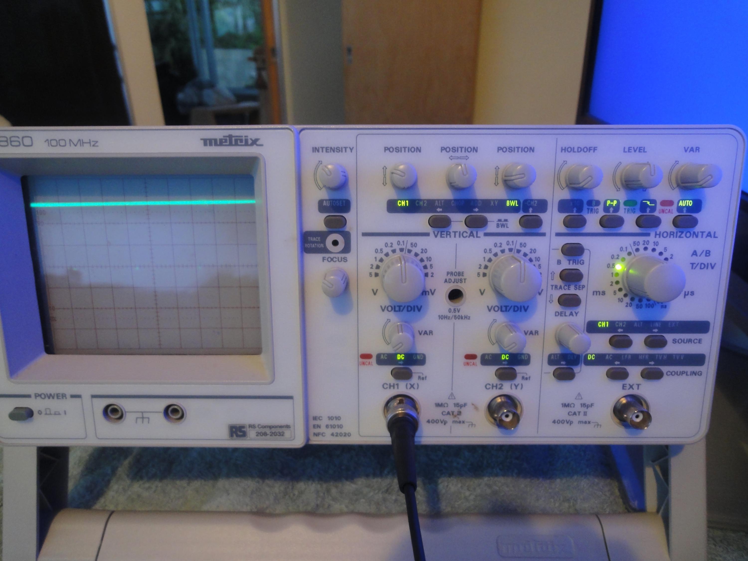

    From what I measured, however, the Master inverter board receives at its "E-PWM" pin, a PWM signal from the mainboard which is about 3.3v p-p and has a duty cycle of I guess about 99% (see first scope shot, DSC02108.JPG). The duty cycle of this signal does NOT change when lowering the "Brightness" control in the main menu, although you can see the image get duller as it appears the gamma or such is changed.
    At ~3 divs and 0.5ms per div, this seems to be about 666Hz.

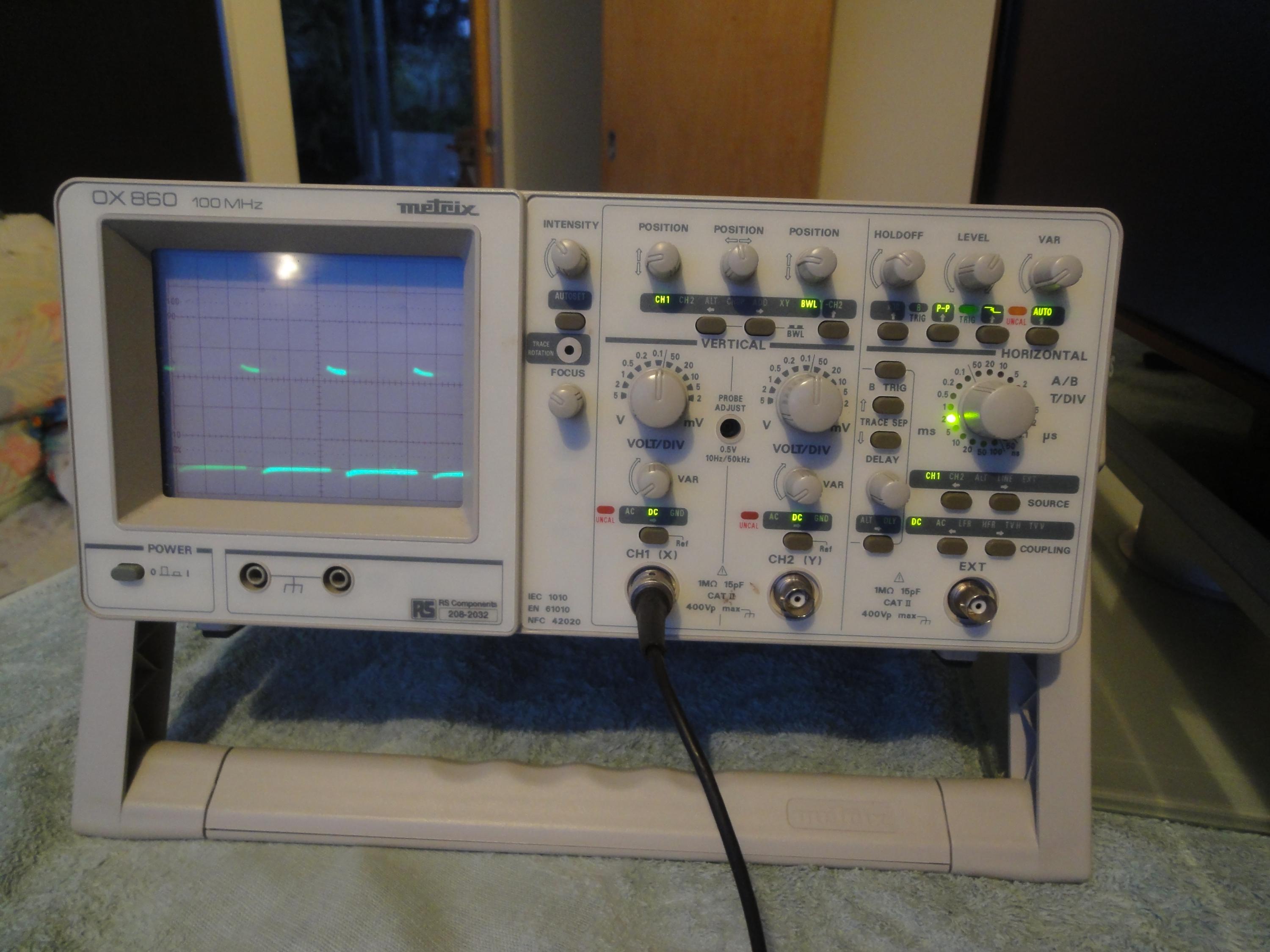

    The inverter also receives 3.3v from the T-CON board, to a pin labelled "DIM-IN", and this appears on the pin "DIM-OUT" as well, which seems to go back to the T-CON board. This signal does not appear to be a PWM signal - if it is, it's at 100% duty cycle or so close to it that I cannot see where it goes to 0v at any point. This signal also does not change when the brightness value in the menu is changed.
    When the backlight dimming feature kicks in, both the "E-PWM" and "DIM-IN" lines change to a square wave with much lower duty cycle, around 30%, and the frequency seems to drop to 166Hz (3 divs at 2ms per div). The "DIM-OUT" line also changes, with a slower falling edge.
    See:
    DSC02108 for E-PWM normal brightness
    DSC02110 E-PWM dimmed
    DSC02111 DIM-IN dimmed
    DSC02112 DIM-OUT dimmed
    My original idea was to disconnect the "E-PWM" line from the mainboard and attach my own PWM generator using a microcontroller to give a constant PWM signal that would not be affected by the TV software. However, this was before I found that the T-CON is also involved. Now I am not so sure what to do.
    I could of course disconnect both E-PWM and DIM-IN, and feed them the same signal (probably from separate pins on the microcontroller or using an optoisolator so they are not tied together directly), but I wonder if the T-CON would not be impressed that the DIM-OUT signal would no longer match up with what DIM-IN was.
    It doesn't help that there seem to be no good datasheets for the OZ9928, and the inverter schematic seems nonexistent (as usual). I did find http://wenku.baidu.com/view/d58277c4...6bcebbc4c.html and a few similar websites which claim to have the schematic but you have to pay to download it and I don't speak Chinese!
    Does anyone have any ideas or experience with this kind of thing?

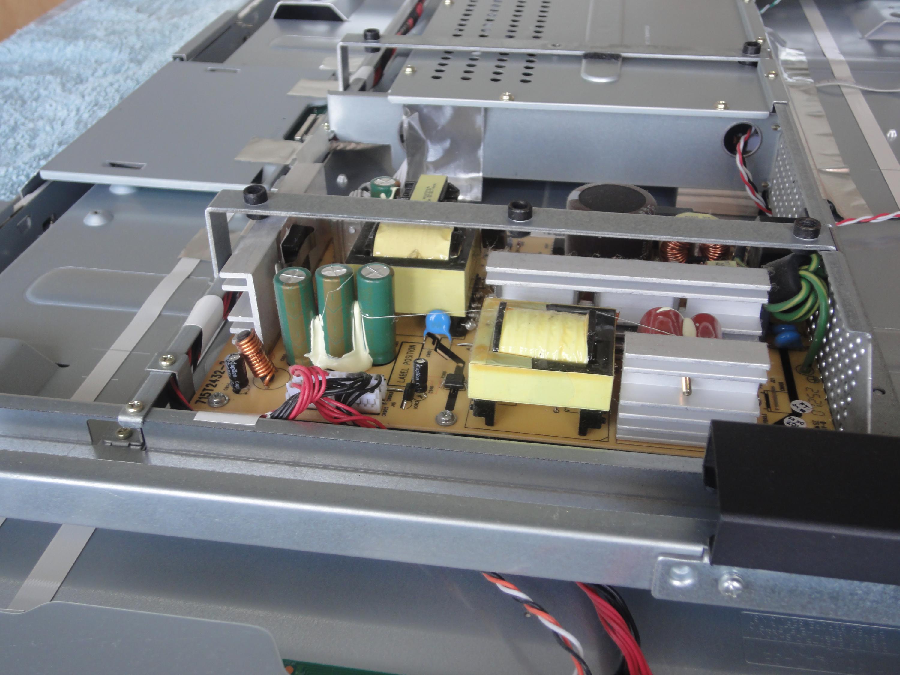

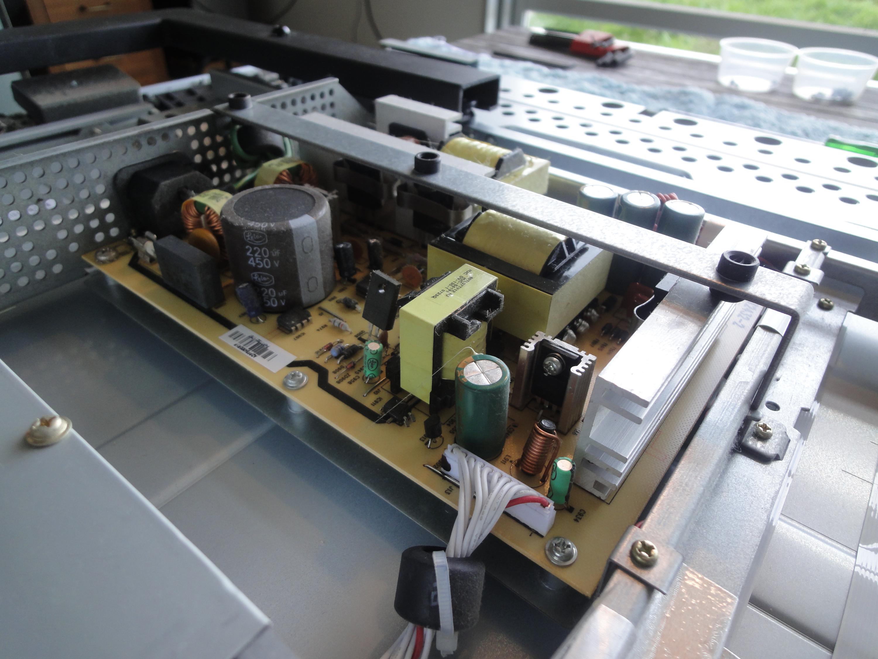

            Also just to 'chirp in' you might want to consider recapping that psu noticed capxons on there, them power boards if the caps fail will kill the Pfc and cause a failure of chirping sound psu which is hard to repair.

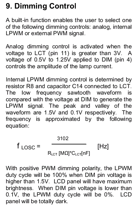

              See page 15, LVDS connector pin 11 (NOTES 6) is for Dynamic contrast, HIGH = ENABLE, LOW = DISABLE.
              So that means you may be able to disable this function in the user setup menu since this pin goes to the main board so it is can be set by the main board to turn it on or off.
              http://assets.shopjimmy.com/media/ca...0223-top_2.jpg
              There is no info of the CON1 of the T-CON board which goes to the Inverter board, you can see the pins DIM_I, and DIM_0.
                According to my friend, and others who posted on Geekzone, there is no option to turn the dynamic backlight control off in software, with either the user or service menu. I can check it out myself but I'm pretty sure that's the case.
                But, I wonder if I could just disconnect Pin 11 to the T-CON from the mainboard and tie it to ground instead? I suspect though that there would also need to be a change in the E-PWM signal from the mainboard as well, unless one can override the other. Perhaps I should try that and see what happens...
                If that doesn't work, I suppose I could float E-PWM and use I-PWM instead (datasheet says to use one, float the other), but it looks like the timing would need to be taken into account. Seems either E\I-PWM signal has to come up before BLON does, go low before BLON goes low, and BLON has to wait at least 1ms after VBL comes up or before power down.
                I'd probably have to use the PWM signal from the mainboard to switch the output to I-PWM via some custom circuitry to keep the timing somewhat correct.
                Or am I over-thinking this?
                  Are they? I didn't notice!

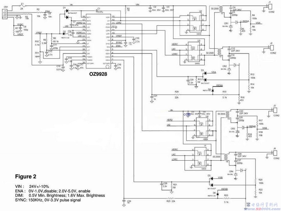

                          Some resources ...
                          OZ9928SN application circuit and datasheet (?):
                          http://www.520101.com/html/circuitry/153257993.html
                          http://www.docin.com/p-259604310.html
                          http://webcache.googleusercontent.co...259604310.html
                          OZ9928SN application circuit (poor quality, but readable):
                          http://www.520101.com/files/otherima...5324052476.jpg
                          OZ9938GN datasheet and application circuit (some similarity to OZ9928SN):
                          Code:
                          OZ9928SN PIN DESCRIPTION
                          Pin Name   Description
                          1  SSTCMP2  Soft start and compensation for controller 2
                          2  ISEN2   Lamp current sense for controller 2
                          3  VSEN2   Transformer output voltage and over-current detection for controller 2
                          4  ISEN1   Lamp current sense input for controller 1
                          5  VSEN1   Transformer output voltage and over-current detection for controller 1
                          6  ENA    OZ9928 on/off control
                          7  SYNC   Operation frequency sync signal input
                          8  VIN    Power
                          9  VREF   Reference voltage
                          10 LDR1   Low side driver for controller 1
                          11 LDRC   Low side driver for controllers 1 and 2
                          12 PGND   Power GND
                          13 LDR2   Low driver for controller 2
                          14 LX1    High side N-Channel power MOSFET source for controller 1
                          15 HDR1   High side power MOSFET driver for controller 1
                          16 BST1   High side driver boost voltage for HDR1
                          17 BST2   High side driver boost voltage for HDR2
                          18 HDR2   High side power MOSFET driver for controller 2
                          19 LX2    High side N-Channel power MOSFET source for controller 2
                          20 BSTC   High side driver boost voltage (HDRC) for controllers 1 and 2
                          21 HDRC   High side power MOSFET driver for controller 1 and 2
                          22 LXC    High side N-Channel power MOSFET source for controllers 1 and 2
                          23 GNDA   Signal GND
                          24 CT    Timing capacitor and resistor setting for operation and striking frequency
                          25 RPT    Sync signal output for master mode. Connect to GND for slave mode.
                          26 LCT    Timing capacitor and resistor setting for low frequency oscillator
                                  or external PWM pulse input.
                          27 DIM    DC voltage for PWM dimming or analog dimming.
                          28 TIMER1  Striking and shutdown delay timer for controller 1
                          29 TIMER2  Striking and shutdown delay timer for controller 2
                          30 SSTCMP1  Soft start and compensation for controller 1
                            Re: Inverter mod for Philips 47PFL7422 to disable dynamic backlight?
