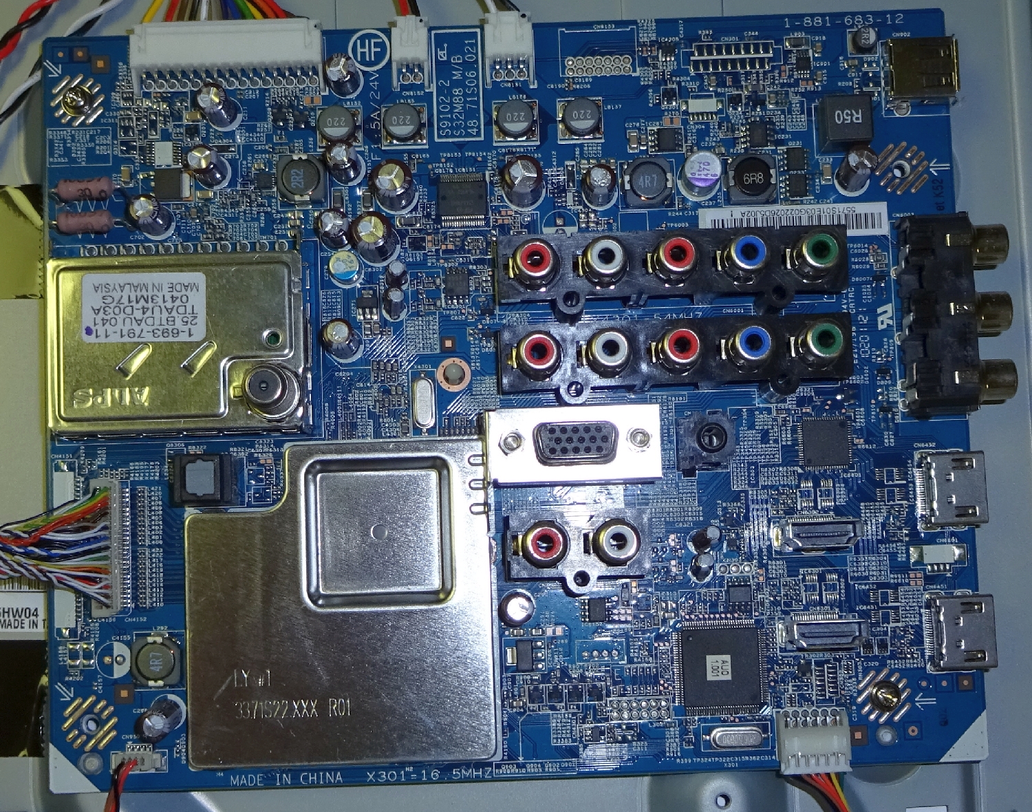

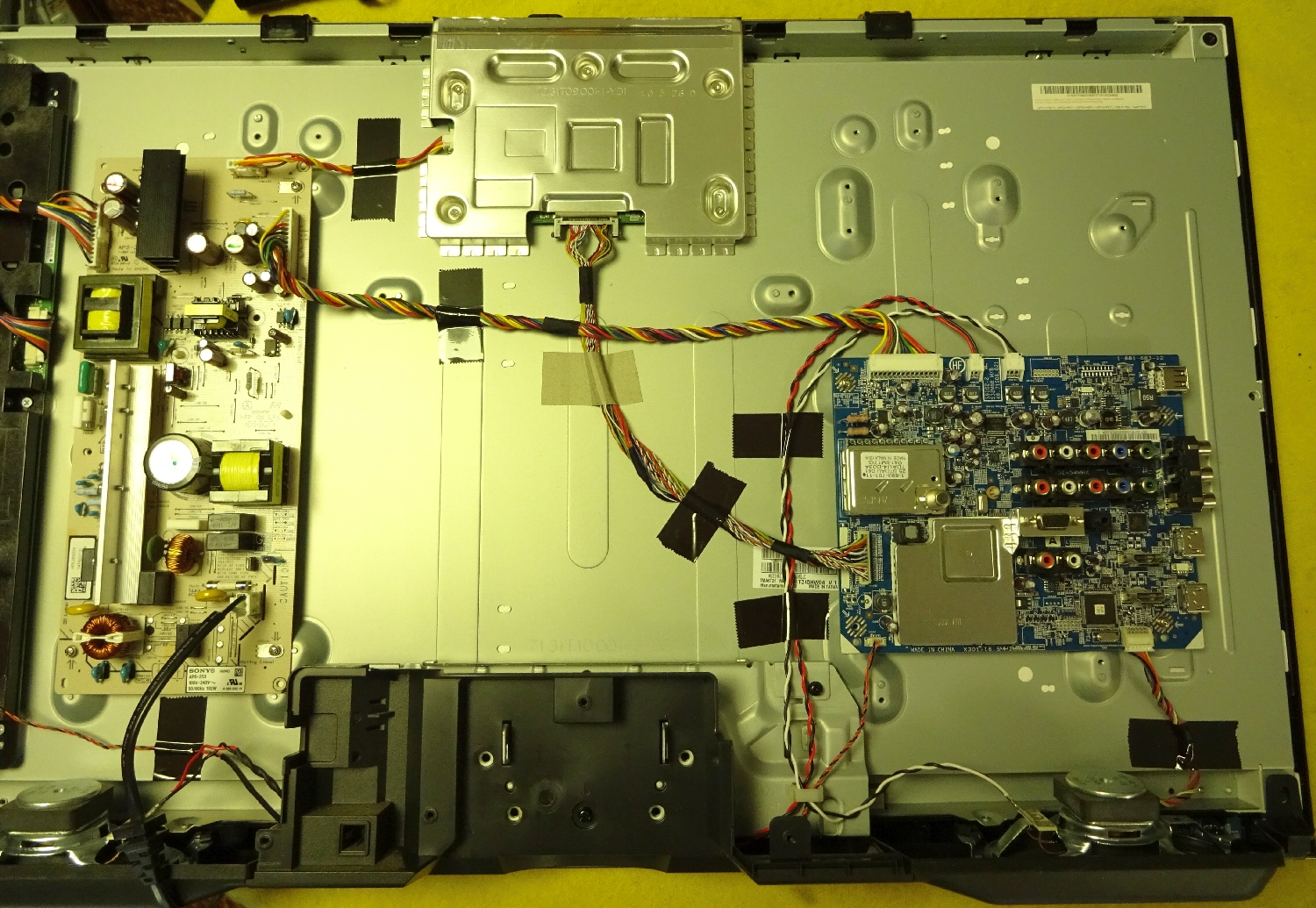

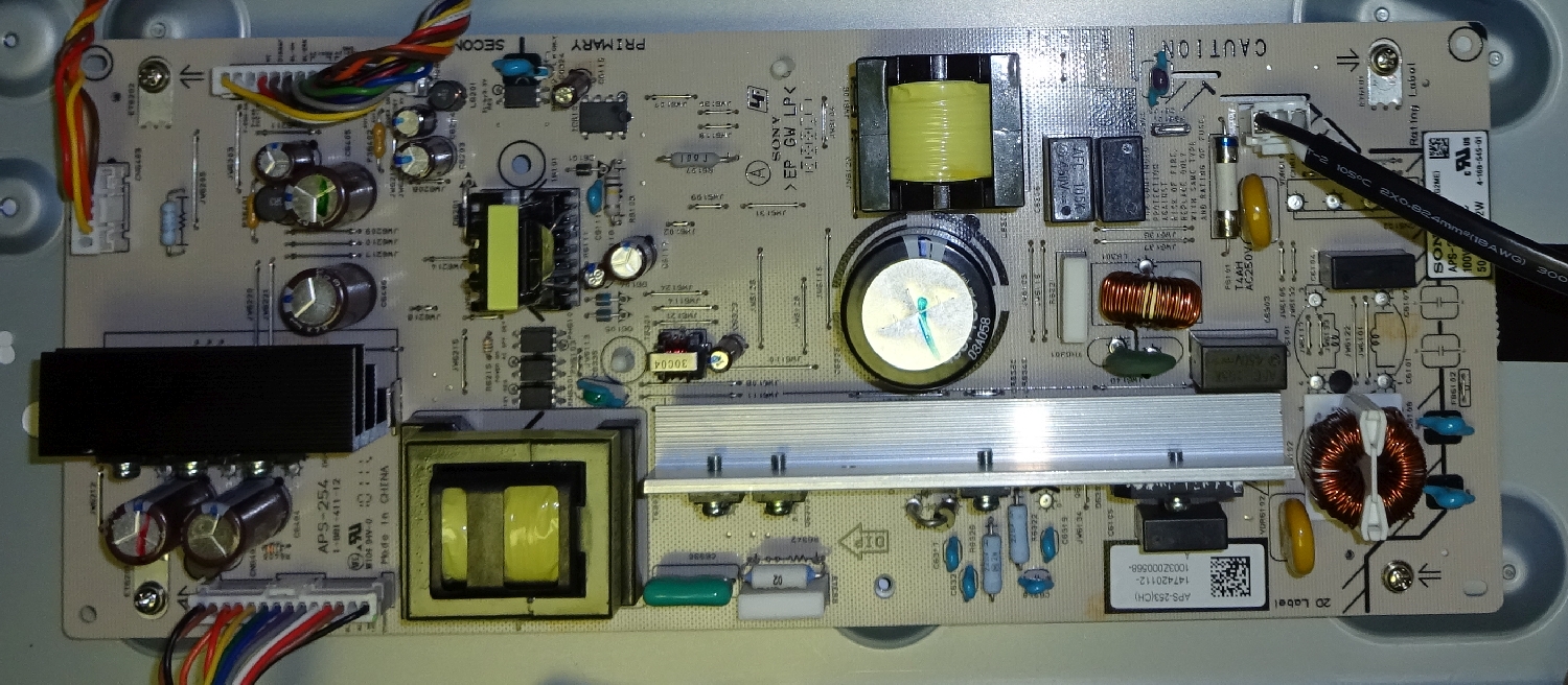

    Sony KDL-32EX500 almost dead
    Sony KDL-32EX500 no lights or sounds when plugged in and turned on. All caps look ok. removed and tested mosfets. The only voltage I have is 3.1v on standby and 1.3v on BL_ERR the rest of the stuff is zero or less than .4v fuses all are good also.
    Re: Sony KDL-32EX500 almost dead
    You do not see blinking LED error codes at all?
    • CraigR
      • Dec 2013
      • 973
      No lights at all.
        download that training manual and take some Voltage readings see page 12.
        • CraigR
          • Dec 2013
          • 973
          Following that I'm to replace the board.
          • CraigR
            • Dec 2013
            • 973
            Any other thoughts before I trash the set?
              • 31289
              replace the small startup caps
              • CraigR
                • Dec 2013
                • 973
                Just replaced the 4 smallest caps and no help.
                • scottmet
                  • Jan 2015
                  • 38
                  If someone else is having this same problem disconnect the IR sensor from main video board and your TV should work. Hope this helps someone out.
