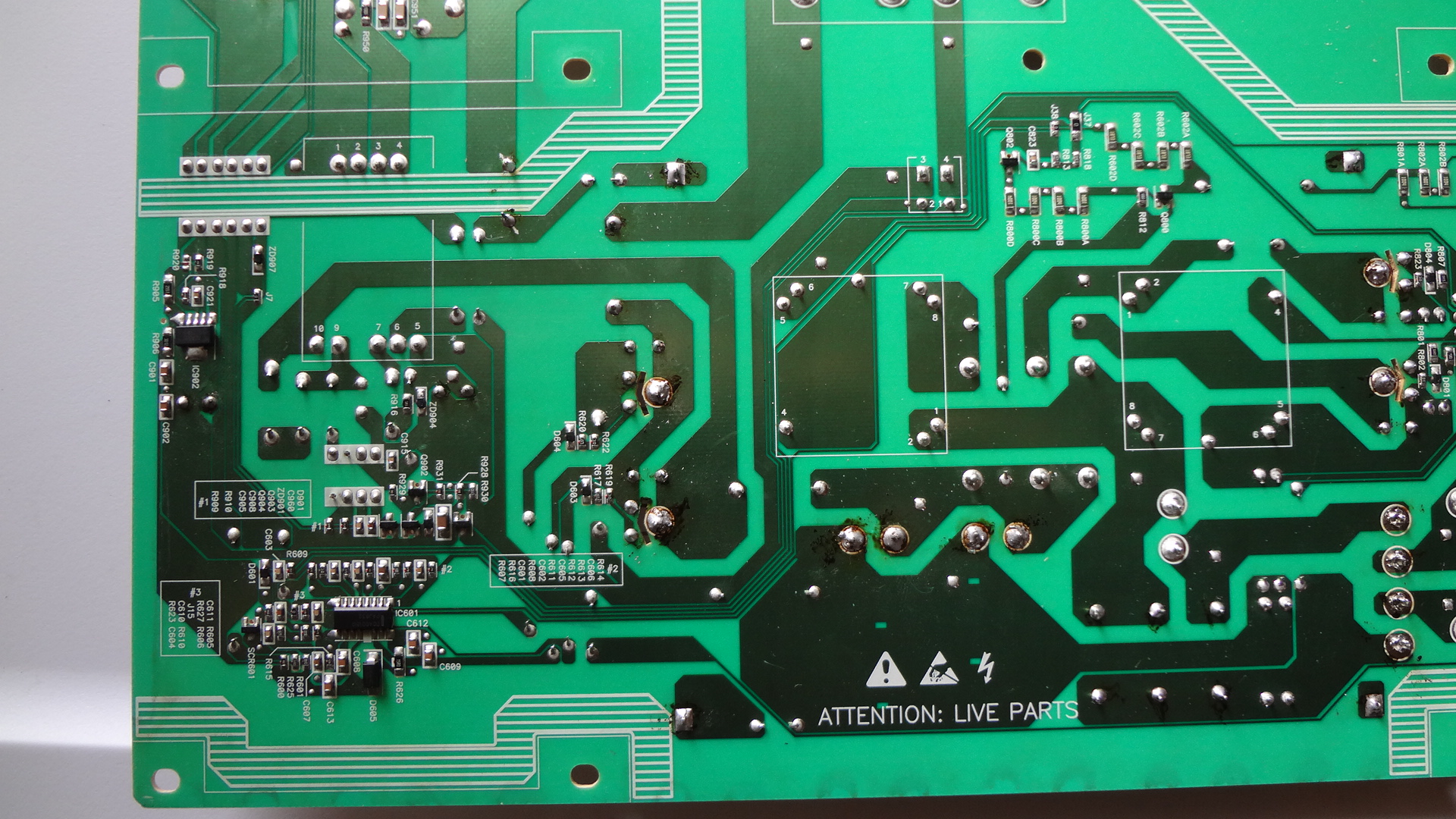

    I've desoldered all the caps and transistors to test and they all tested good.
    The discoloration on the back side of the board is from desoldering not leaky caps.

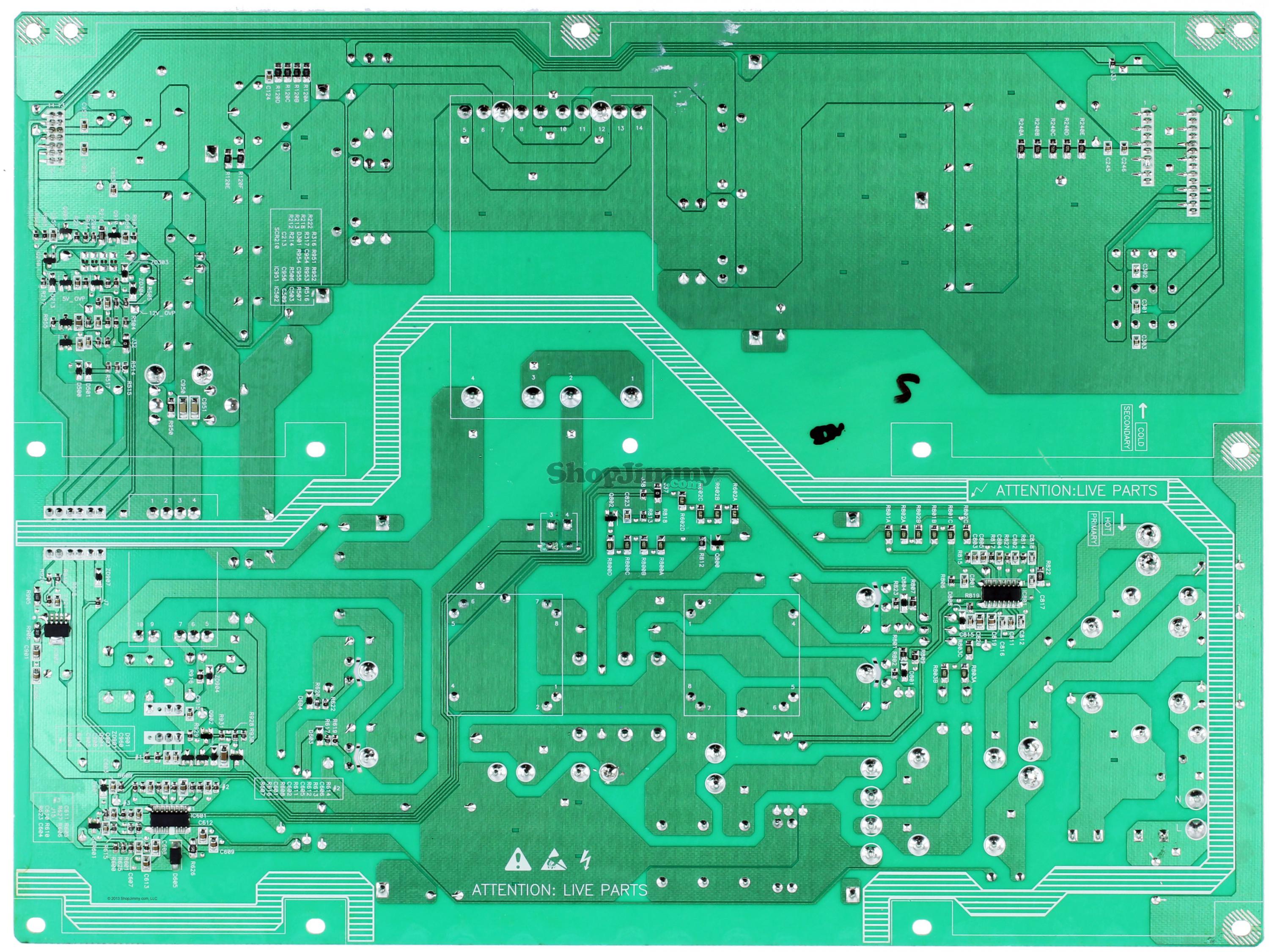

            There's a service manual which looks as though it has the power supply at:
            http://tinyurl.com/o9jdbkh

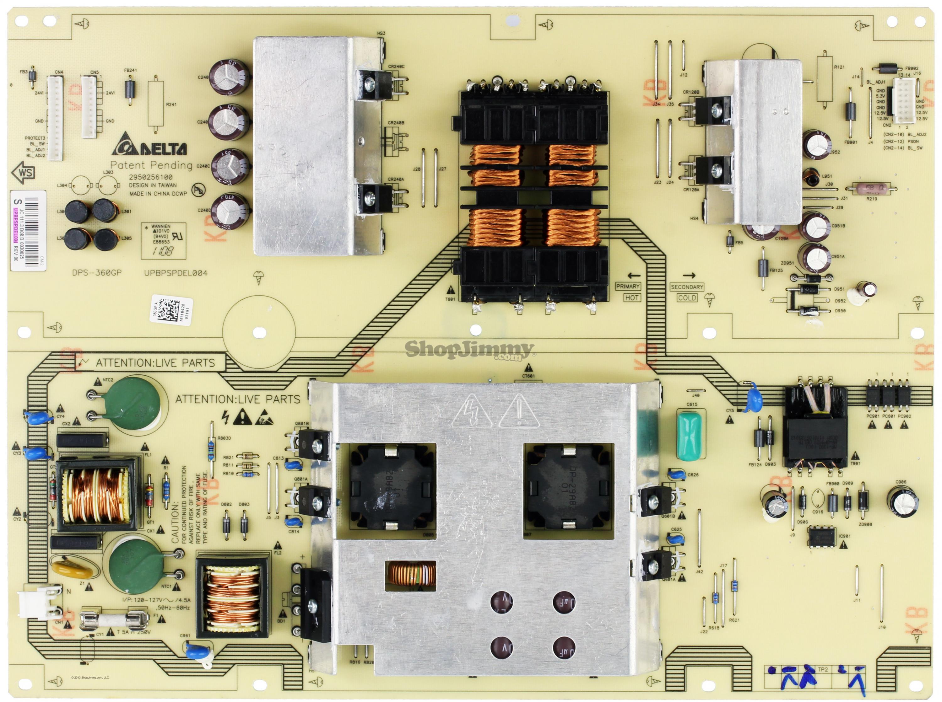

              Re: Philips 46pfl5505d/f7
              So you do have main DC to run the STBY power supply section.
              You board is Delta model DPS-360GP.
              We do not have the diagram for the board so we will have to trace out the circuit manually.
              So how much times and patients do you have to troubleshoot down to component level?
              The STBY section has IC901 for the SMPS, Power transformer T901, startup/running caps c906, the other cap is cover by the white glue so I cannot tell what that C is.
              Disconnect the cable to that connector which goes to the main board to see if the 5V will be present, if not then unplug the AC thenyou can try heating those two caps with hair dryer for a few minutes and then reapply the power to see if the 5V will be present.
              We will also need the P/N as printed on top of the IC901.
              Thanks for the diagram DICKBARTON.
              See if the P/N matches the IC901.
              Pictures provided by SHOPJIMMY.

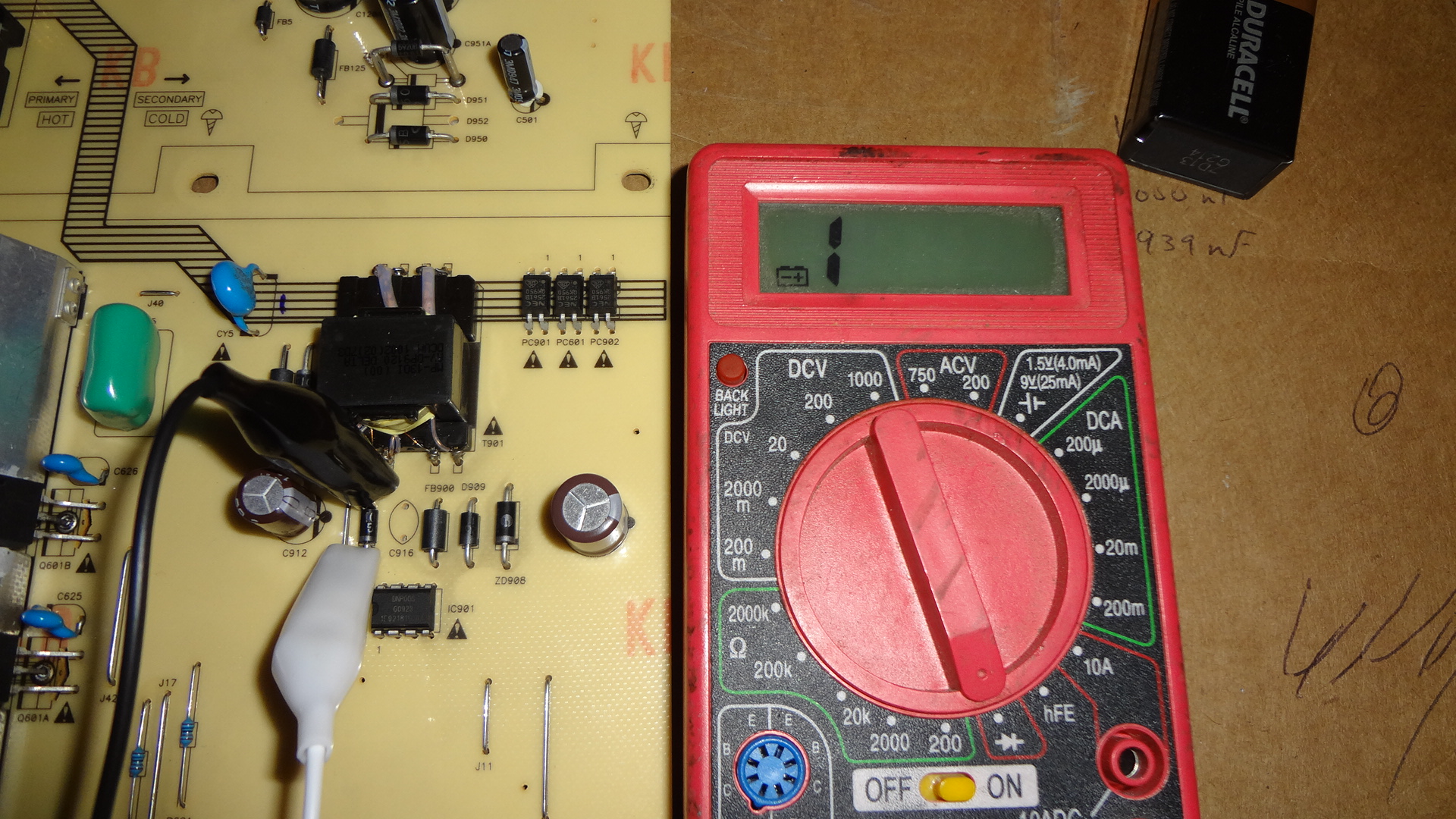

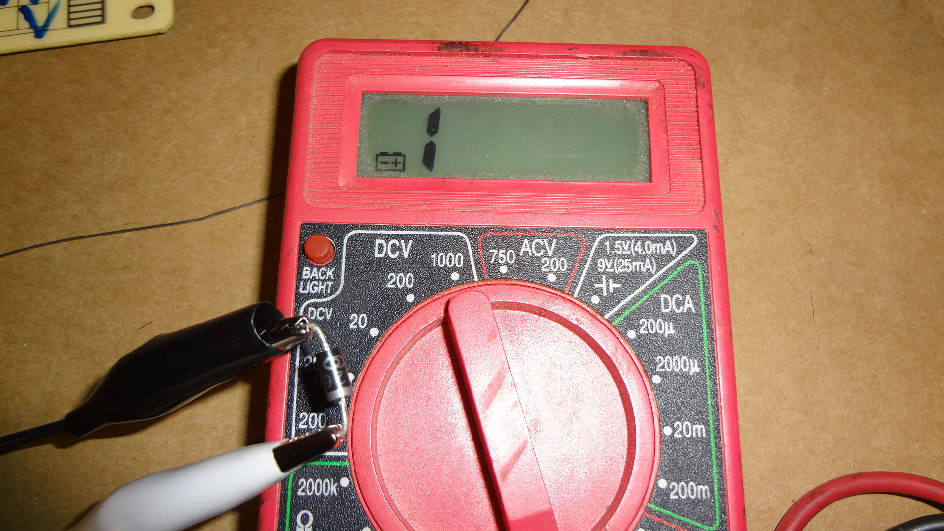

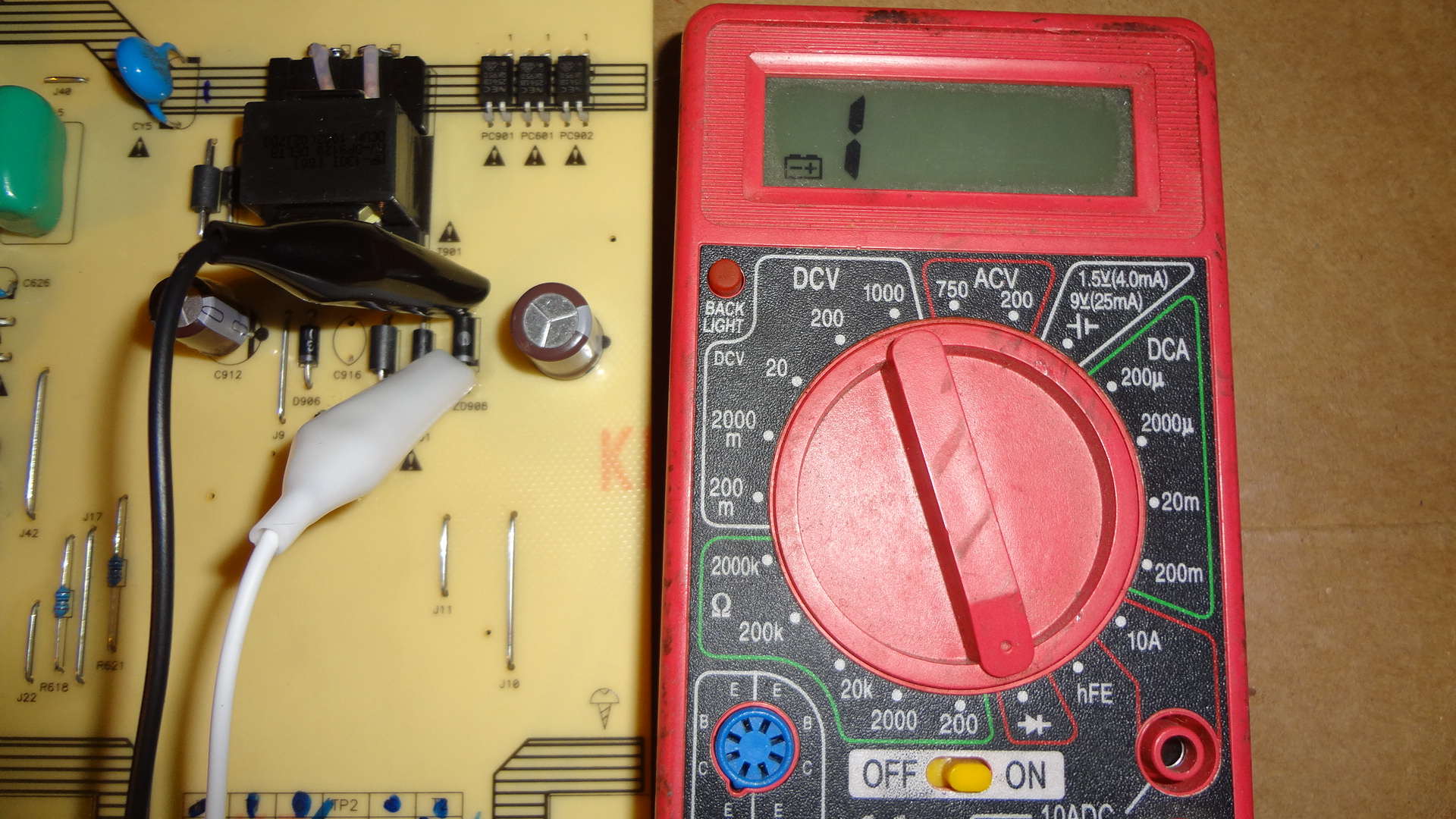

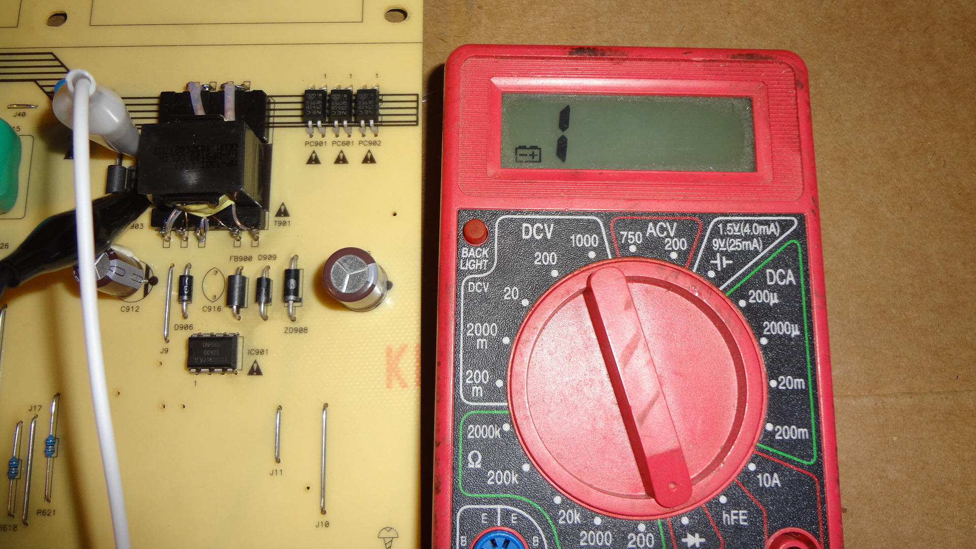

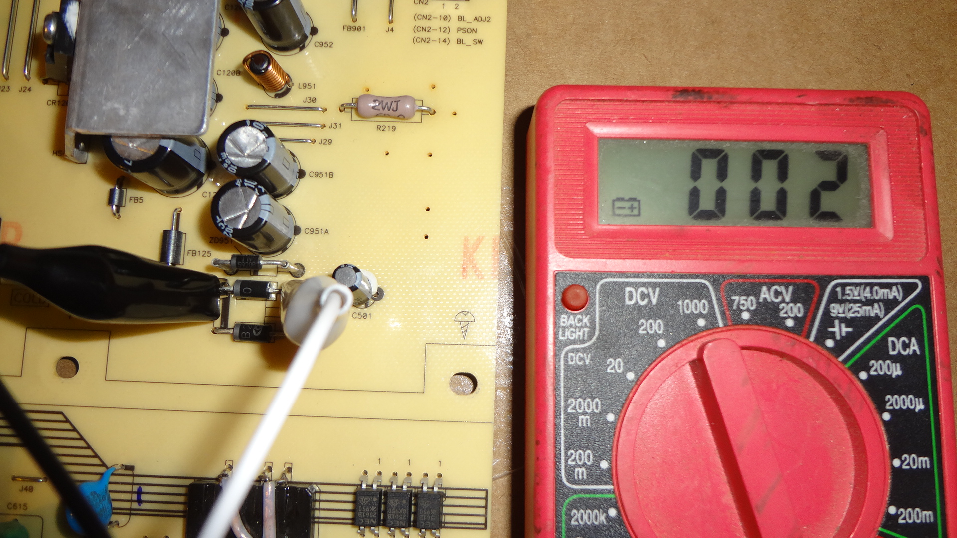

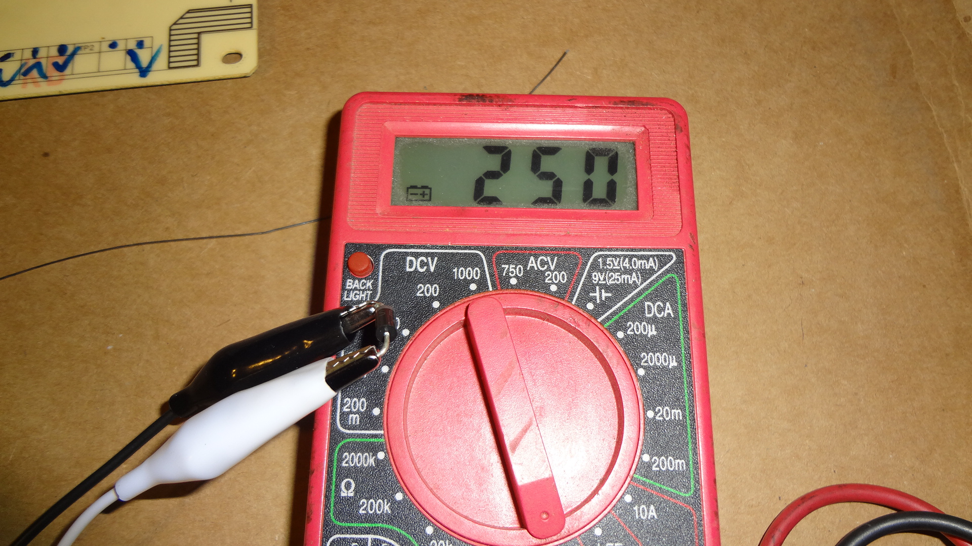

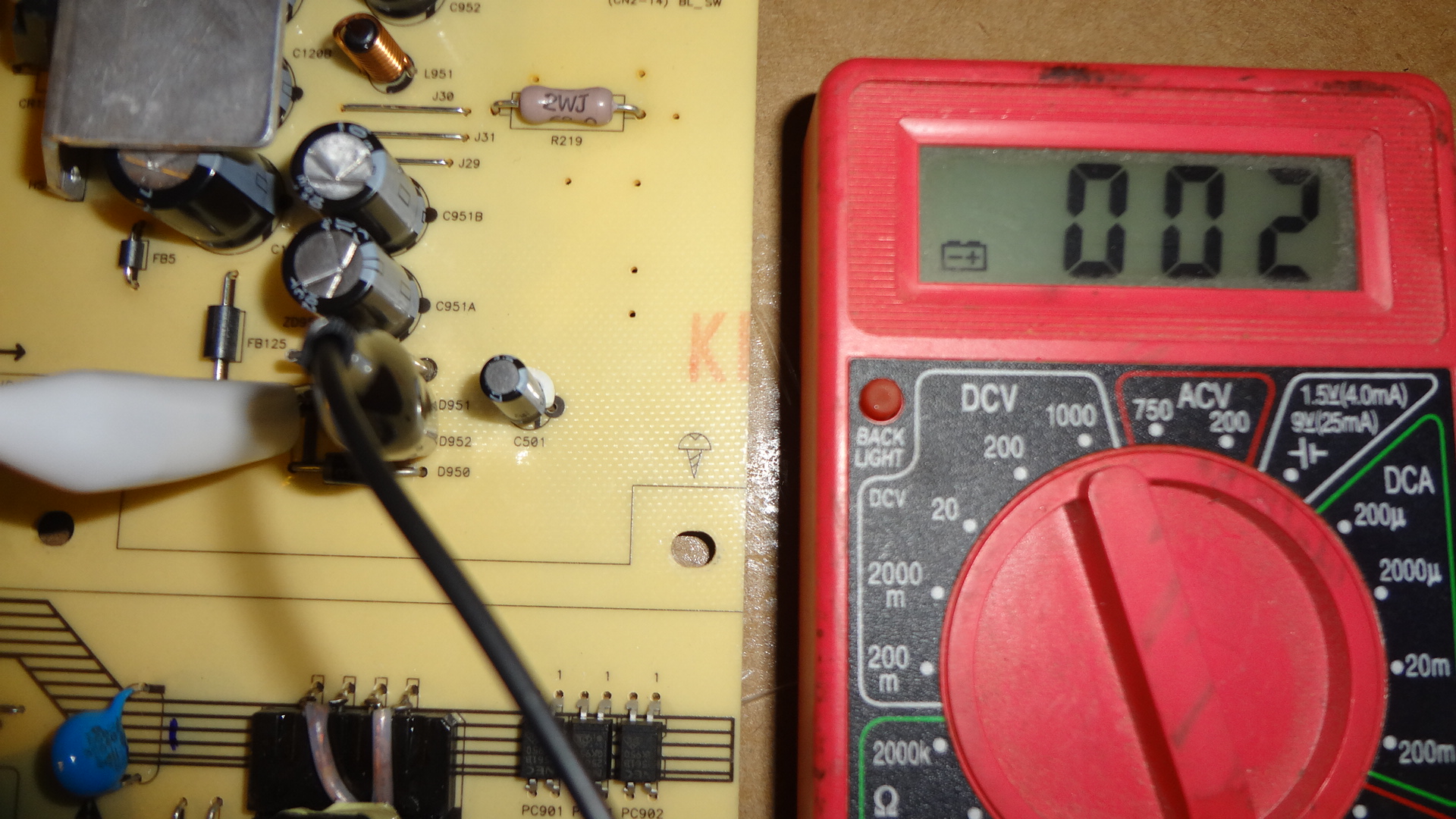

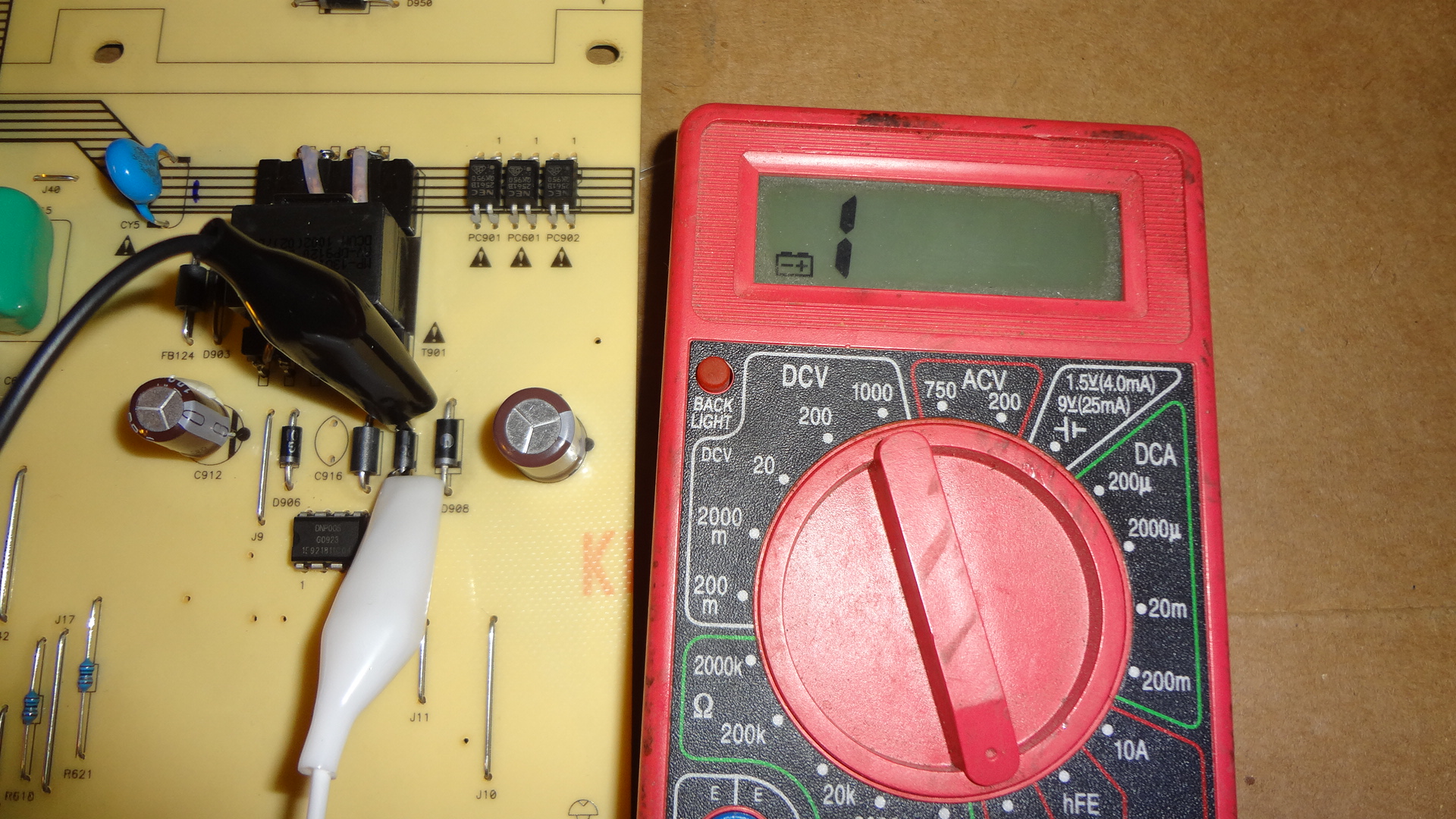

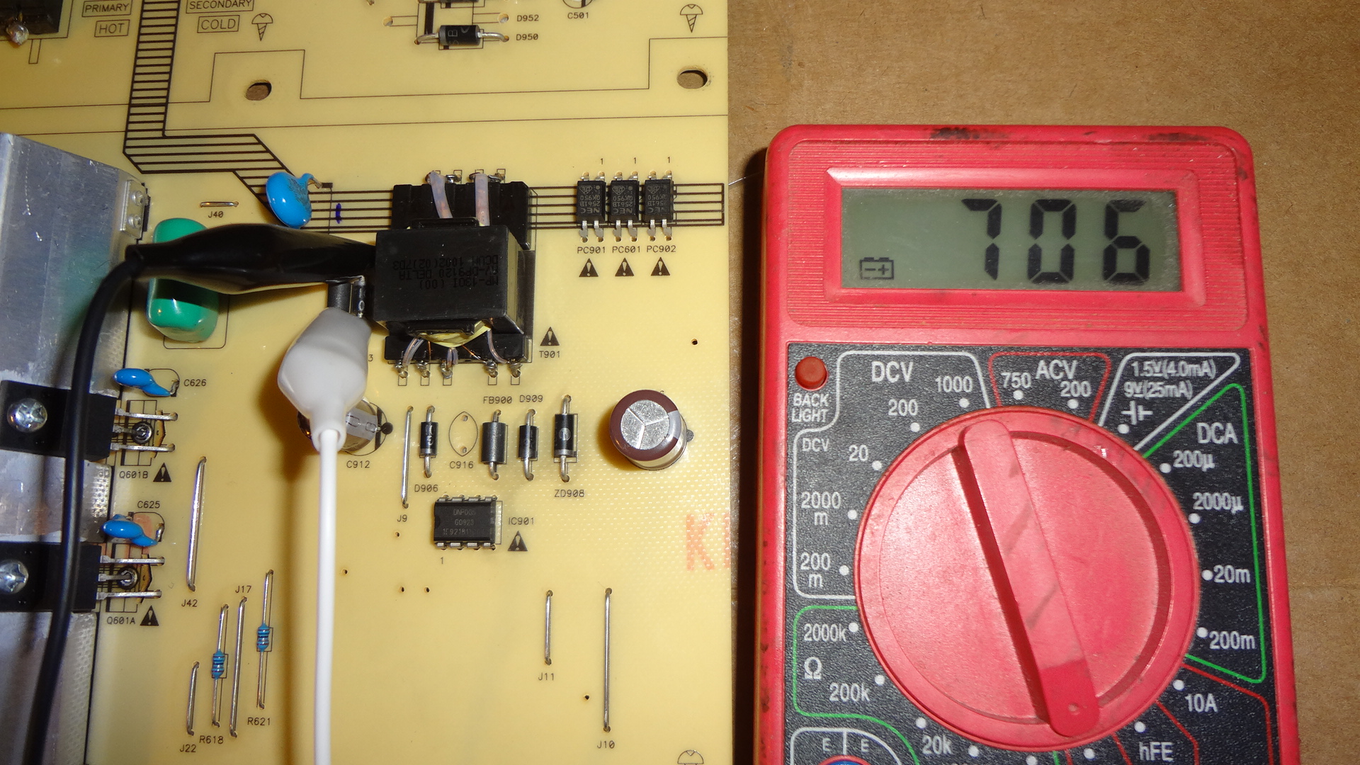

                        I'm unsure if I'm testing the diodes correctly so I took pictures of each diode while I tested them.

                          Last two diodes
                            D906 is OK, ZD908 is OK, D903 is OK, D909 is OK
                            D950, D951 and ZD951 show as shorted, possibly they are in parallel so maybe only one of them is bad.
                            Your meter needs a new battery too.
                              Okay, let me go ahead and remove D950 and D951 so that I can test them and then I can also test ZD951 while still on the board because that one is a PITA to desolder.
                                D950 is connected in parallel with D951, the Zener ZD951 (1N5920, 6.2V 1.5W) is for clamping the output of the D950/951.
