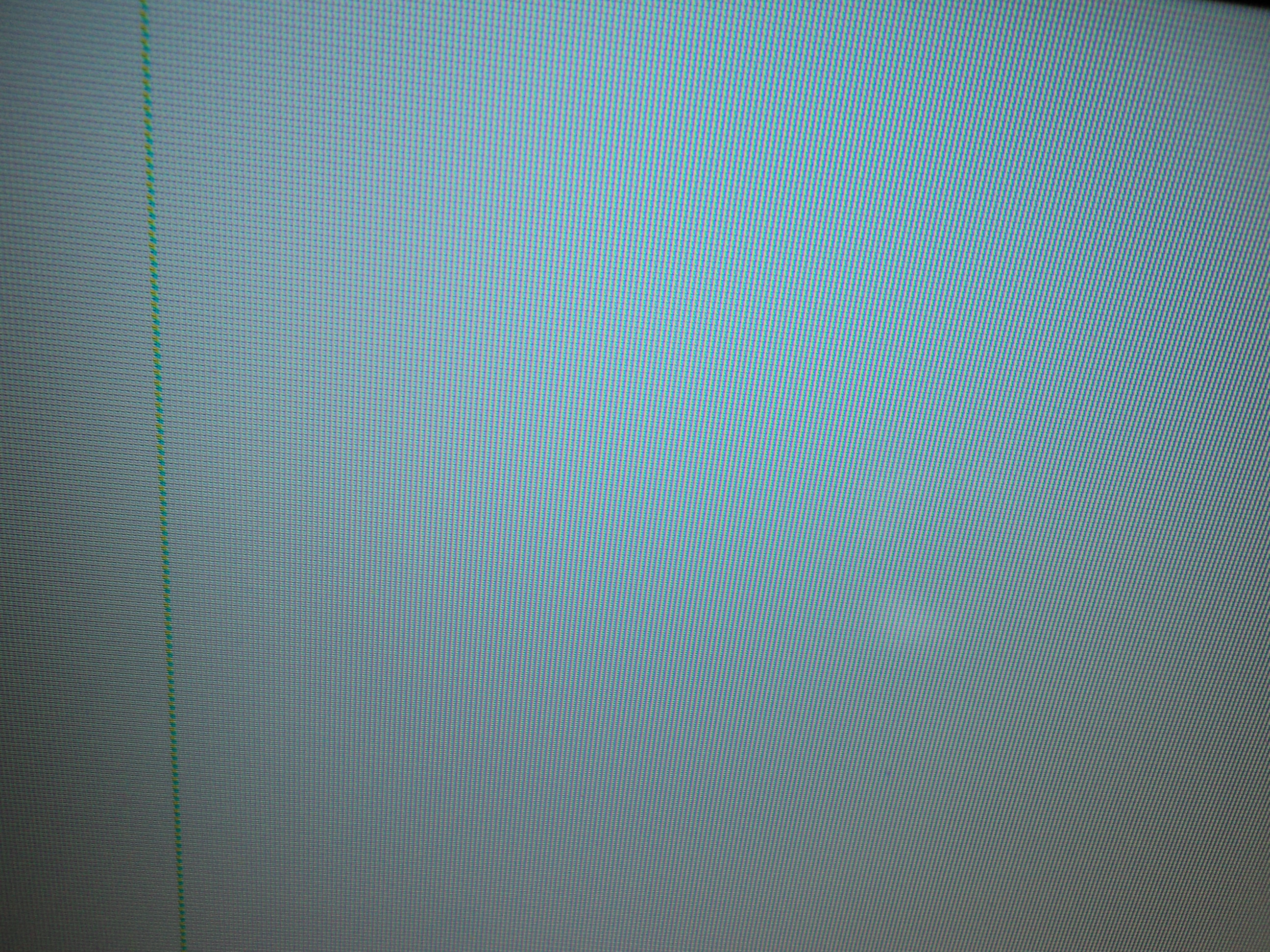

    Philips 46PFL5505D/F7 thin green line?
    Hi guys i have this Philips 46PFL5505D/F7 that has a thin green line in the corner almost unnoticeable ,this probably has been here for a long time,and it more noticeable when watching regular tv entertainment,since i mostly watch soccer on this tv because of the green field ,it's probably i never noticed it ,do you guys think this might be the ribon cables , tcon board or main board ?
  • Diah
    • Feb 2013
    • 6602
    Re: Philips 46PFL5505D/F7 thin green line?
    its blue & yellow pixel issue line on the LCD. from far will look green line.. you cant do any about it ... it could clear it self or getting wide by time. (watch & wait )
    • ivtec
      • Dec 2008
      • 1967
      Thanks, oh there is also a red line on the right, strange, can't see it on the tv,but i guess the camera got it. well i can live with it ,almost unnoticeable when watching soccer because of the green field,i found this tv in the trash 2 years ago and never noticed it, have a nice happy Christmas.
