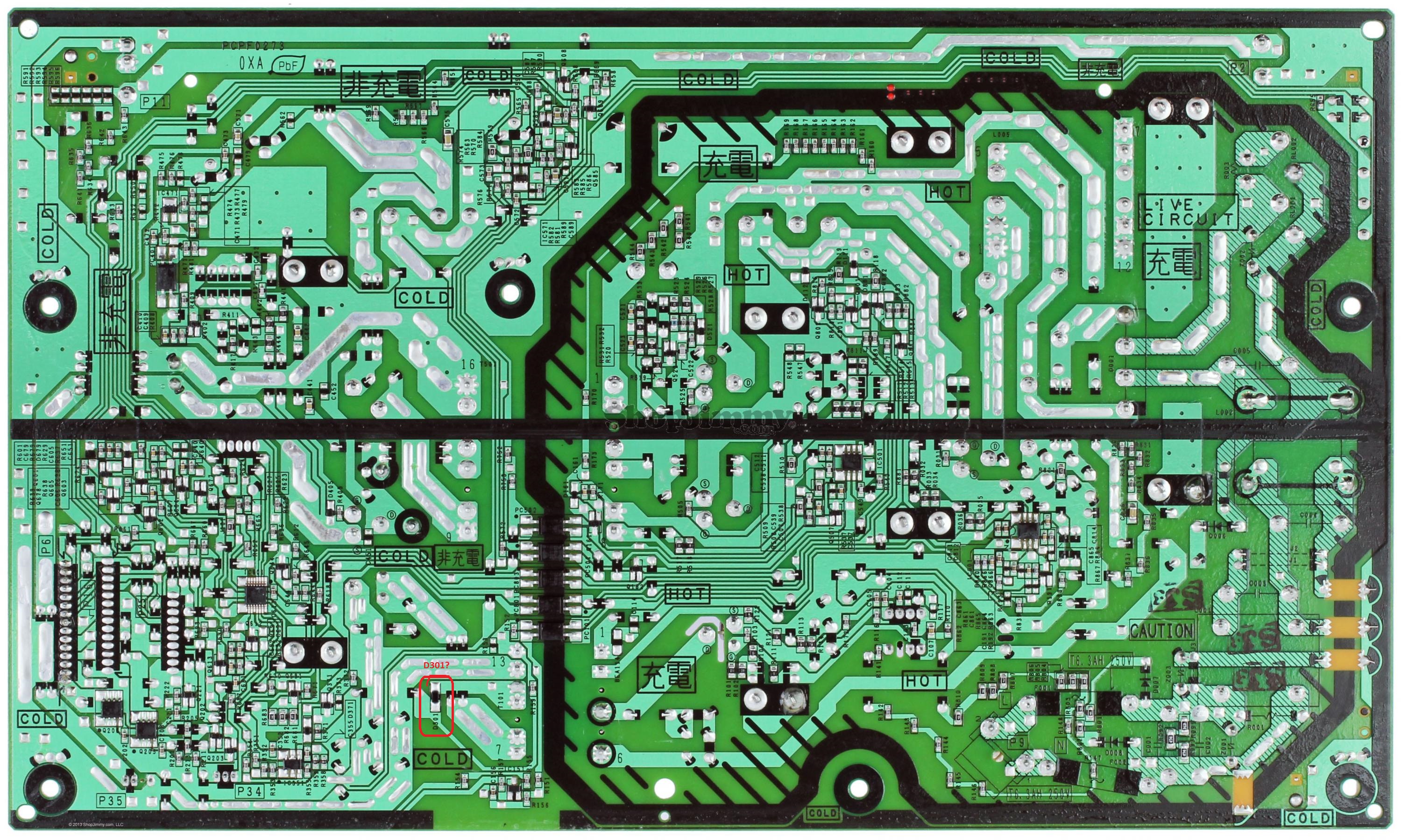

      Re: MPF6908 No 5V on pin 6 to A Board
      4.80K Ohms one way ad open the other other way, if we are talking about this chip, Is this a digital Mosfet?
      39 Soldering Iron burns And Counting
        #63
        It is just a diode for the negative power supply section. So it is OK.
        You should try new startup/running cap I mention in the earlier post next.
            replaced C117 cap today, still same erradic reading on all pins of IC101, thinking bad IC101? won't start? what do you think next step is. Thank you

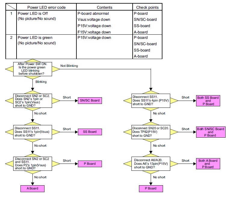

                Fa5528.
                You need to check the resistance between GND pin 4 against all other pins to see what you get and report the reading.
                Then you will take the DCV reding between GND Ppin 4 and the VCC pin 6 to see what you get.
                the IC needs VCC 15VDC typ Voltage for it to start (range is 13.2~16.8VDC).
                Too low to start, see post 44.
                That means it is trying to run, so it can be due to bad start up cap, or there is problem in the secondary side so it is in start/stop mode. I would verify that the rectifier in the secondary side are good, you also try putting in new start up/running cap.
                In the datasheet I see it says recommended Vcc is 10V min, Typ 18V, max 28V
                Is this TV being tested with the Sc and SS boards connected? either of those shorted can may present a No LED, No blink. Might be worth checking just in case
                I'm not sure if this info applies to US models, you don't have green LED on start up, just red.
