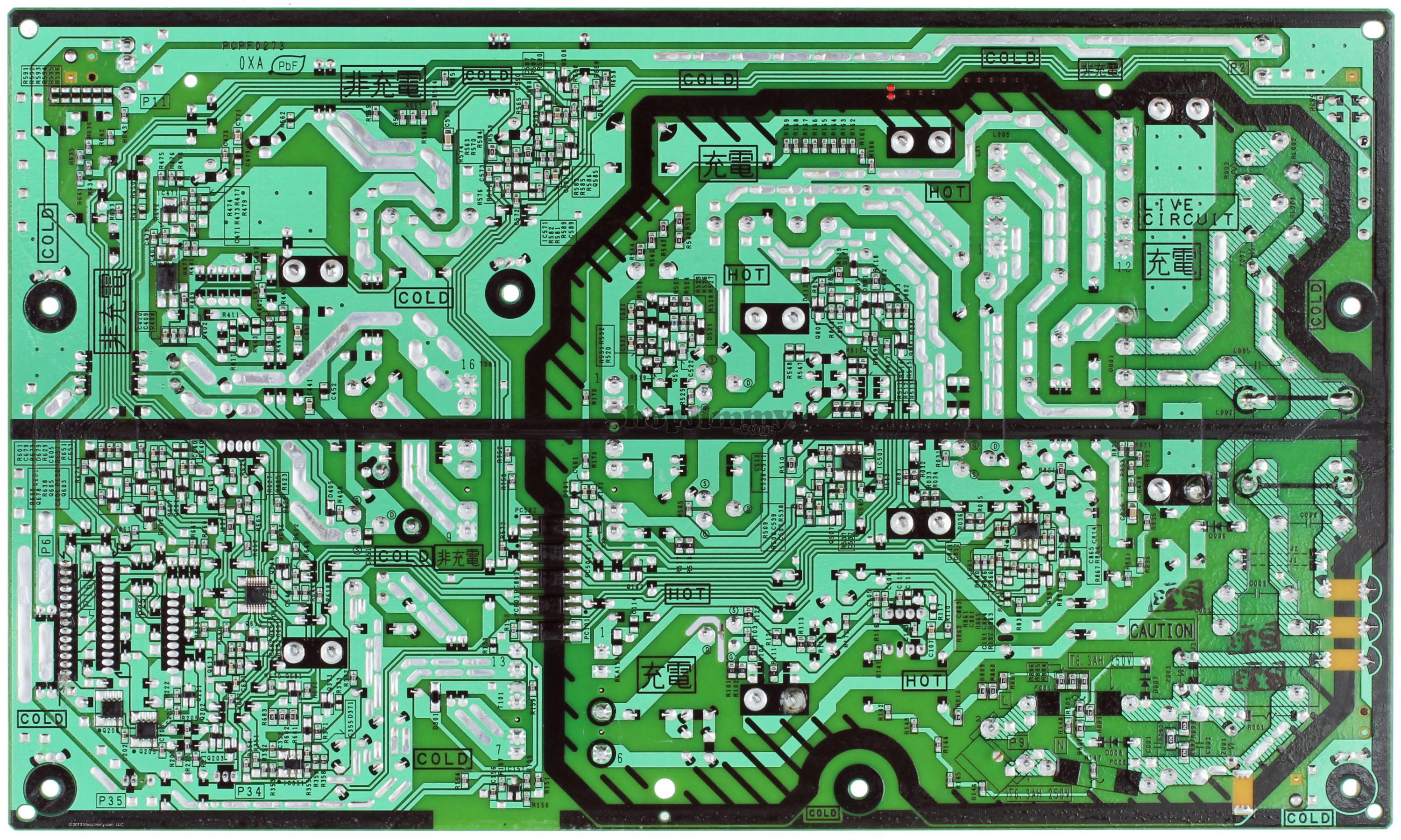

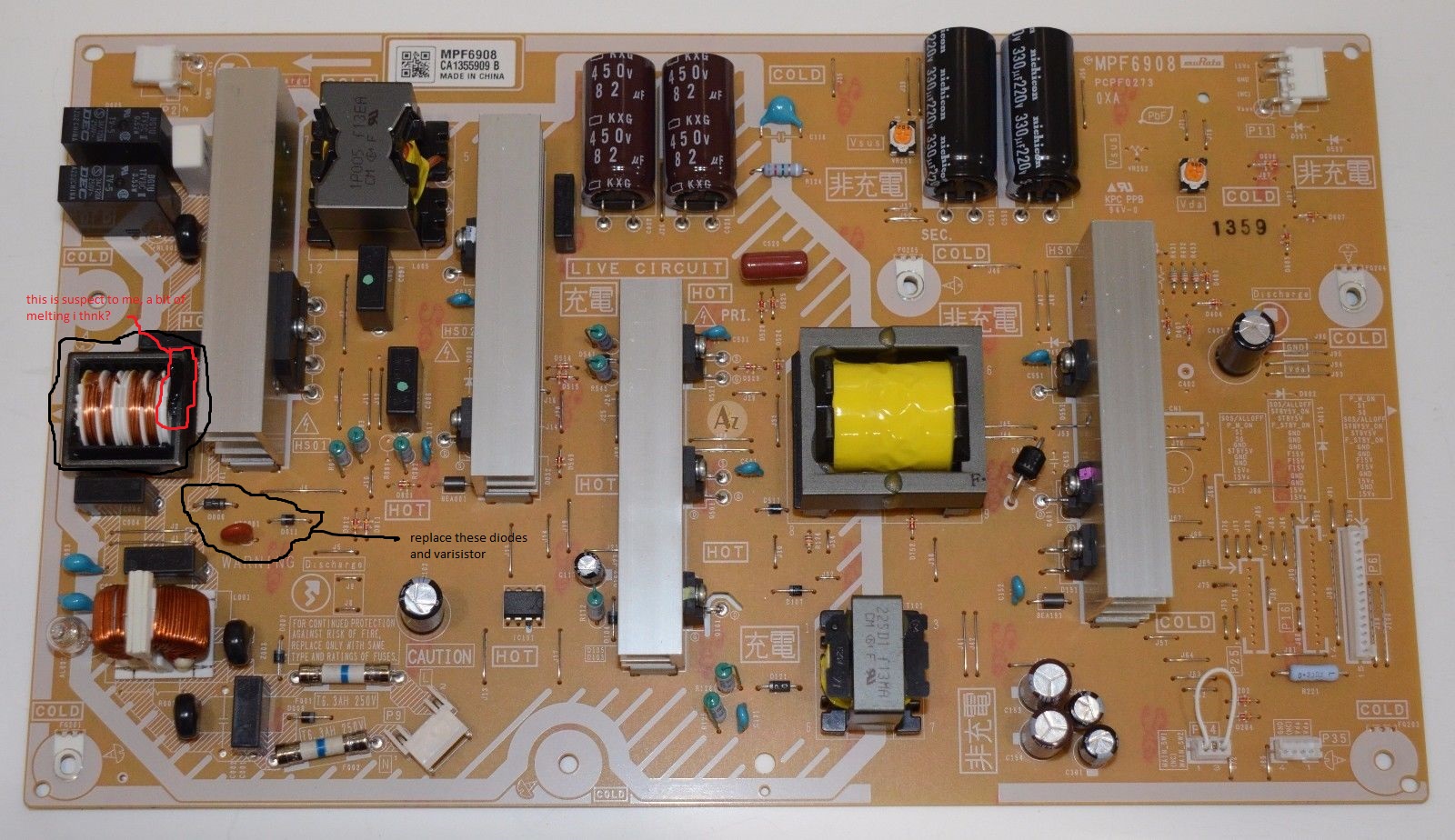

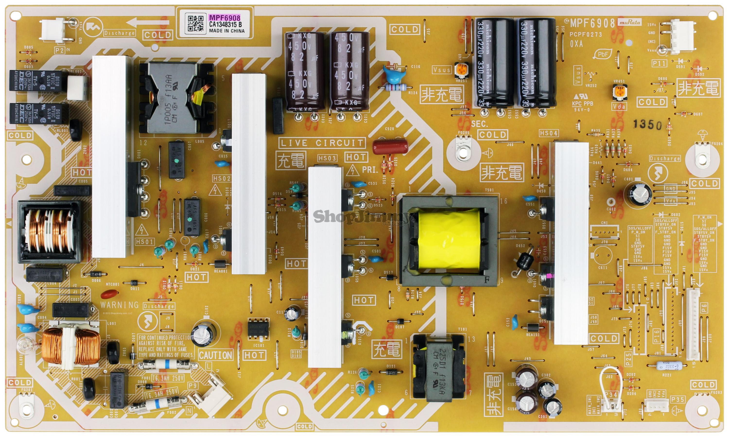

    hello all, need some help with this issue TV Model is TC-50PX34 Manufactured in 2011, this unit used the Power supply MPF6908 stock image included, My issue is dead, no power, no standby lights, nothing, No click and powering up power supply, no 5V out to pin 6 of the A board. Took some readings and only getting 1.2V AC into the bridge rectifier, any help on where to test next would be very helpful, Thank you very much .

        I would check the fuses and then check the standby circuit, thats where your standby voltage comes from, if you post a good picture of the back of the board that would help in troubleshooting

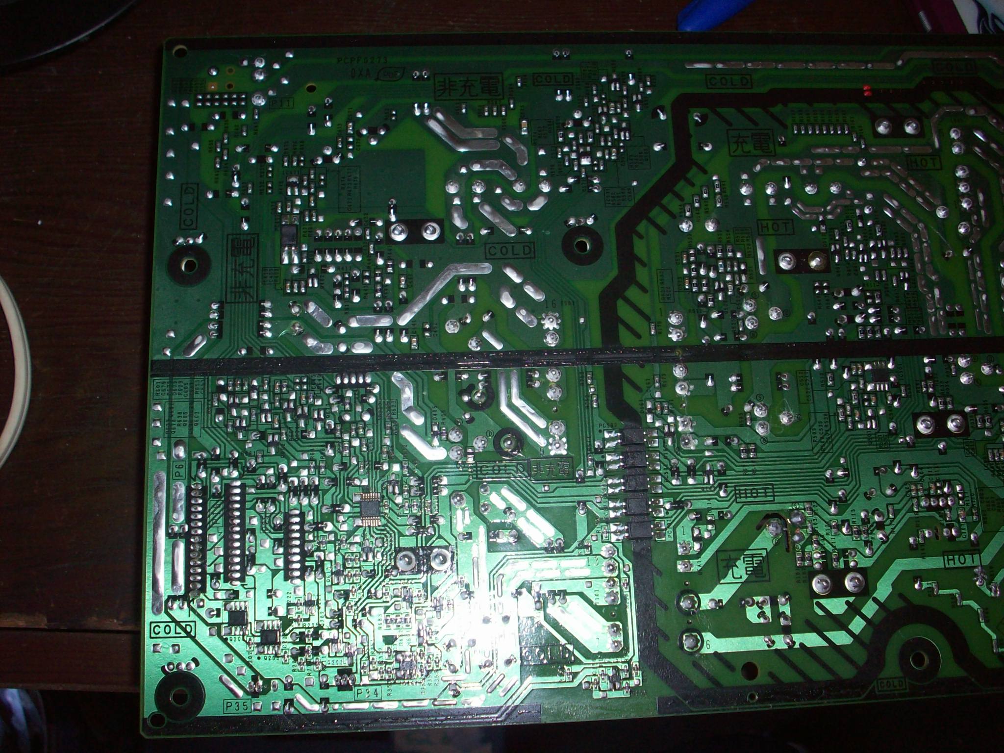

          Thank you, fuses are good, here is some pictures of the back of the board

            I see there is a ceramic resistor (tall white). Have you checked that. If the fuses are not blown then there is every likelihood you have an open circuit somewhere along the path from the mains input connector to the bridge rectifier. The dc voltage written on the side of the capacitors is a good indication of what voltage you should read across it.

                    You are not not going to get any AC at the two inner pin of the main bridge until the main board sends out the relay signal to turn on the power relay RL001, 002.
                    The STBY SMPS is running off the half wave rectifier D006 (WHEN tv IS IN STANDBY MODE), the B+ output (Cathode) is fed through the Thermistor NTC001, the out put of the thermistor is then feed the filter cap C102, so you should have about 160`170VDC bteween the two legs of the C102.
                    SMSP IC101 is for driving the power MOSFET Q101 which drives the standby power supply transformer T101 primary winding pin 5 & 6.
                    You need to check the fusible resistor R112, 125, 126. Check thermsitor NTC001 and the D006 if you do not have DCV on C102.
                    BTW: Incidentally i did find a blown fuse, I see now that it is blowing the outer most fuse when i power it on, that condition must have been present when i posted this issue. You mean the 6.3A main fuse is blown the minute you apply the AC to the board?If that is the case, then you need to check the resistance of the MOV Z001, 002, and 003.
