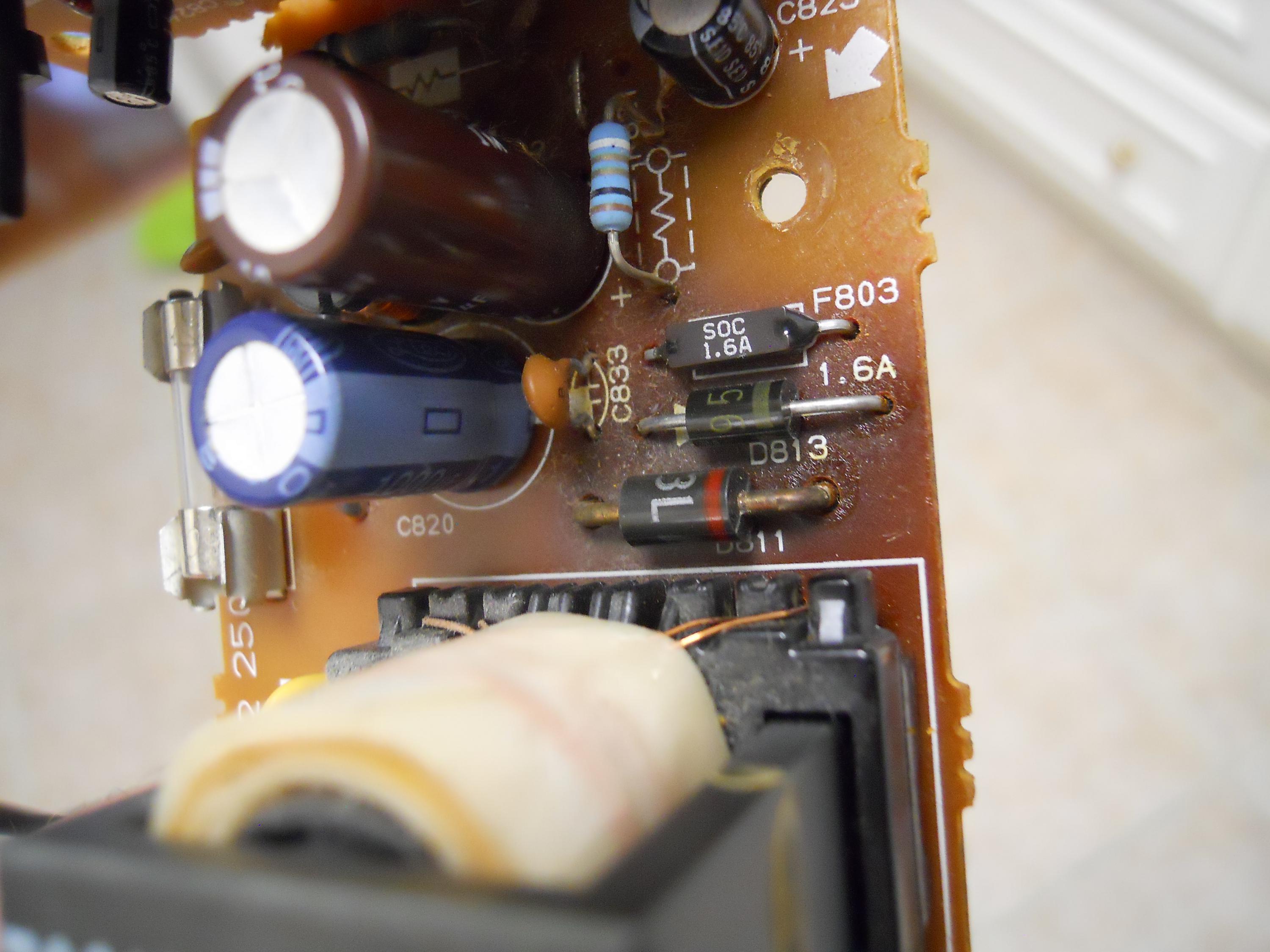

    cap exploded in a vintage VCR
    I procrastinated with transferring my old family recordings on DVD. finally i plugged in the circa 1993 multisystem VCR and heard a pop and saw a flame. the VCR was last used several years ago, could this be a factor?
    A small electrolyte cap blew in the power supply. i have no idea what value and voltage. i searched the web for schematics and nothing showed up (toshiba V-880ms). what would you put in?

    At you need to show us the location of the caps so we can see what the function of that cap is. Any pictures of the old caps and the board?

          what do you mean? i replaced the exploded cap and plugged the (disconnected from vcr) power supply in. the 1.6A fuse started glowing and another big cap (1000 uf/25V) got hot and swollen.
          another bad cap or f....ed up power supply?
          edit: power supply was not screwed to the metal cage when i tried. maybe that was a mistake.
            Re: cap exploded in a vintage VCR
            Fuse glowed, or blew? Most fuses are about to blow when they start glowing.
            I suspect the power board has a problem with output regulation, maybe the output voltages are too high.
            If it's an old VCR, it's probably a first-generation self-oscillating SMPS, possibly based on a ringing-choke converter. They are known to blow a load of parts when they go bad, so repair can be very difficult.

              yeah, i pulled the power when i saw the glowing. i put a new 1000 uf cap and the same problem, the power supply is toast. weird, it worked fine last time i used it.

                  Those caps are getting too much voltage, I suspect the str-d1706 not operating properly, I would change the caps C812, C813 & C809
                  Then check the dc voltage accross c820, It should be around +15 volts
                  Its possible the regulator ic Q801 is also bad.

                    if the str hybrid is suspect, then you need to replace all the caps - because one probably killed it to begin with,
                    and you need to meter all the resistors, and check all the soldering because anything stuck to a heatsink probably has cracked joints.
                    when we did beltkit&pinchroller jobs, we always replaced the caps simply because once these things blow, it's a much bigger job than a pre-emptive re-cap.

                      i measured the voltage. it goes from 28 to 32V in the few seconds before i disconnect power. no wonder the caps blow.
                      looks like i'll be replacing the strd1706 and the related caps.
                      i also noticed the board near d811, d813, and f803 is discolored, probably heat. could bad diodes cause the problem too or be faulty in addition?
                      i have to admit i don't understand how that power supply works at all.

                          one more question. there is a piece of wire short (from the factory) in the place of C813. should i leave this in place or replace with a real cap?

                            Leave it be. A capacitor is an open circuit to DC, short only to AC. If there is a wire bridge in that place it means it was never supposed to have a capacitor there in the first place.

                                It looks like c812 & c813 are in series each is marked as 120uf @25v. I bet the factory installed a 47-100uf@50v in c812 location and jumperd c813.
                                Whats the value of the cap. in c812 location?

                                  100/25. you think it should be 50V?

                                    i think i fixed it. replaced C812 with another good 100uF/25V and got 15.5V in the output. the old C812 worked, but with decreased capacity. every other component i checked was fine.

                                      If the original was 25volt you will be ok. If you have a 50 volt one you could use it instead but its not necessary.

                                        i thought about why there were 2 caps in series. then i thought it's a safety issue in case one of them shorts. somehow the factory ignored it. the irony is the mode of failure was the opposite, loss of capacity and that produced quite dramatic effects, cap fireworks and busted components on the control board that i'm trying to fix. goggling for this shows a common problem in toshiba VCRs of that age. looks like the cap plague existed for a long time before the recent pandemic.
