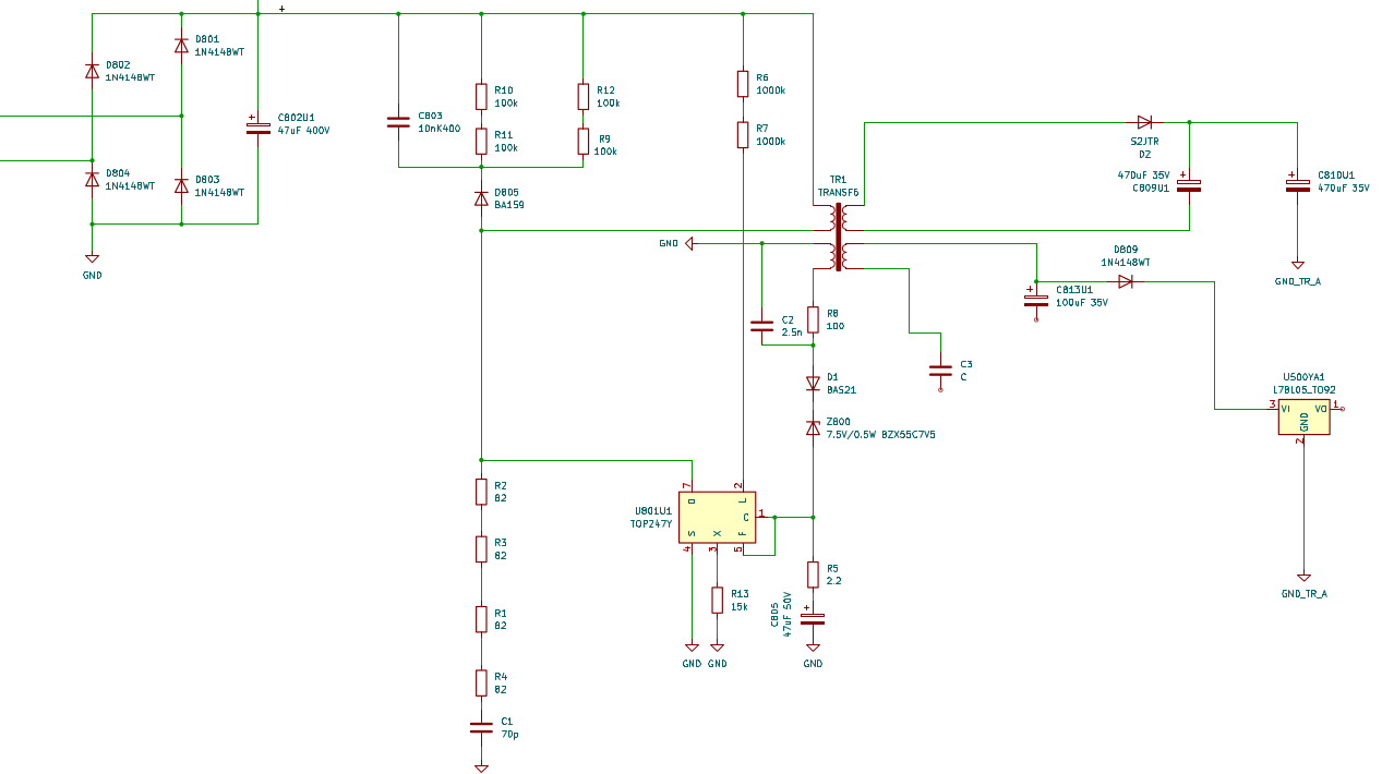

    Hello, I have a SYMSI70 gas heater board, which has issues with its primary side power supply, controlled by TOP247Y chip.
    When I replace a TOP247Y it explode in 1 second. I have desoldered transformer and measured a winding ratio, so transformer looks like OK.
    Transformer:
    |Info| Primary | Aux | AB | CD|
    |Ratio|1|25|40|12|
    |Voltage AC|230V|9.2V|5.8V|19V|
    |Voltage DC (*1.41)|230V|13V|8.1V|27V|
    I have disabled a undervoltage protection of TOP247Y, disconnected secondaries and tried to power it up with voltage from 50 to 150V DC (I have connected in series multiple 32V DC printer power supplies).
    When I connected all secondaries, all voltages were correct, display was showing an error "F10" as nothing was connected and "some relays" on board were switching. So board works correctly on 150V DC.
    A Drain-Source current(on primary side) was about 50mA, power consumption about 8W. On the board, nothing is hot, so there are no hot components.
    But when I connected it to 230V AC, which is about 325V DC, TOP247Y exploaded. This happen everytime. I have another older board which has some "logic issues" and chip TOP247Y works correctly in this old board, so the chip TOP247Y is not broken.
    I have transformer out of the board on about 30cm wires.
    It means that error must be in a snubber network, there are two, one around a transformer and the second around a Drain-Source of TOP247Y chip. I do not have ESR meter or oscilloscope, I have only simple "Non-True RMS multimeter".
    I have even tried to put a P6KE300A tvs diode to primary snubber network,
    Diode BA159 was OK, but I have replaced that with UF4007.
    Snubber capacitor C803 (10n) I have replaced with two 6.3nF 400v capacitors
    Second snubber capacitor C1, about 70pF was "white SMD ceramic MLCC" I have replaced with "simple ceramic" which is probably for low voltage only.
    When I'm measuring voltages even with 50V DC power supply, snubber voltages are high, about 200-500 V on multiple places.
    I have some P6KE130A (tvs diode), should I use it?
    How can I check it safety? I wanted to use a tyristor dimmer to slowly rise a voltage (I do not have a variac), but it is just cutting some pieces of waves and does not limit max voltage, so TOP247Y exploded too. So I'm thinking of using some "capacitive divider" to make a lower voltage.
    So there is no overcurrent, just an overvoltage caused by a snubber network malfunction. Please what can I do with that? Everything looks like correct

                              - power supply is using a TOP247Y chip which has a feedback from AUX winding, so windings secondaryA, secondaryB are without feedback
                              - when I replaced a smoothing capacitor (47uF/400V) after a (4-diodes bridge rectifier), TOP247Y is not exploding anymore ;-)
                              - I have disabled under voltage protection (again) and tested it on 60V, 90V, 120V DC
                              - based on https://www.onsemi.com/pub/collateral/and8461-d.pdf, it is better to use a slower snubber network diodes
                              - the issue is too high voltage on secondaryB, about 42V, but capacitors there are rated to 35V and LM317 here is just to 40V
                              - I have just a simple non-true RMS multimeter with capacitance meter; no ESR meter, no oscilloscope, no inductance meter
                              - I have connected that through a 25W light bulb (but of course it did not prevent explosions of former TOP247Y chips)
                              - I have removed a transformer from the board (so it is on 30cm long wires) and removed both secondaries from it, just primary and AUX is connected as it should be
                              - I made a "test load" on secondaryB which consist of: diode, smoothing capacitor (22uF) and parallel resistive load
                              | Resistor on secondaryB | Voltage on this resistor |
                              | 1K | 51.5V |
                              |3K3 |64.3V|
                              |5K6 |67.8V|
                              - when I doubled a capacitor value (2x 22uF) on "test load" values were the same
                              So I think it works as expected, with a higher current/power, there is a lower voltage on secondary side. So maybe if I use a "very high load", then voltage will lower to 30V as expected.
                              There was a zener diode Z800, 7.5V; voltage on AUX, after a diode D1-BAS21 was about 11.4 - 11.7 V
                              When I replaced a zener diode with 3.9V diode, then that voltage was about 7.43V, but output voltage on secondaryB was the same!!! So I think this is the issue.
                              From my point of view as AUX voltage is lower then secondaryB voltage should be lower too.

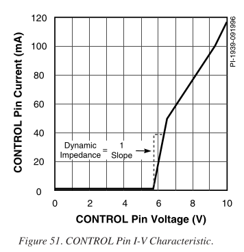

                              I have tried about 10 different capacitors on position C805 (47uF, 50V), which is a capacitor connected to Control pin of TOP247Y.
                              Voltage on TOP247Y Control pin is 5.8V as expected, I think it fluctuates little bit (5.7-5.8V), but never under 4.8V which should be interal under voltage protection, which cause a restart cycle.
                              What is measuring a non-true rms multimeter on 66 kHz rectangular signal?
                              As AUX voltage is always a constant (even under lower voltages and different secondary load) does it mean that TOP247Y is working correctly even it is from China for a few cents?

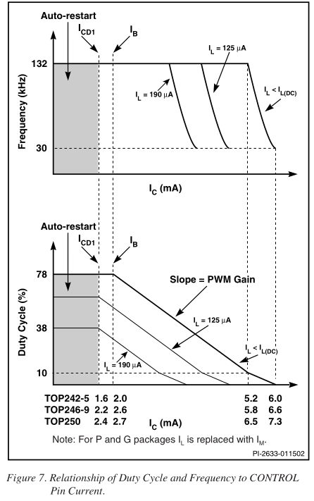

                              How TOP247Y works?
                              - at start Control pin capacitor is charged to 5.8V
                              - switching start from 0 to max duty cycle (it takes max 10ms)
                              - current flowing into a Control pin is changing a duty cycle, more current -> less duty
                              So it must be changing its internal resistivity on Control pin based on flowing current (this is probably that Shunt regulator/error amplifier).
                              It means what is controlling a duty cycle is just a current into Control pin.
                              What can cause a broken capacitor into a Control pin? Less current, it means higher duty cycle and more voltage on secondaries?

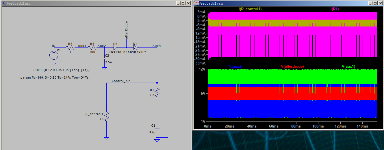

                              What I'm measuring on AUX (11.5V) is just a voltage drop on zener diode (opened in reverse), 2R2 resistor and capacitor in 66kHz by simple multimeter.

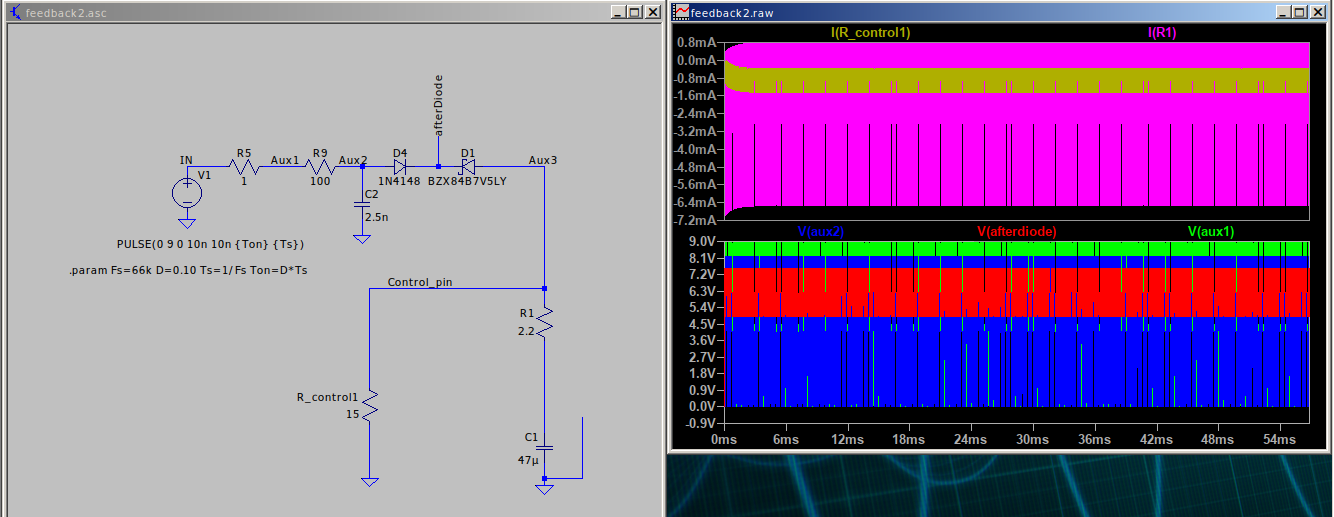

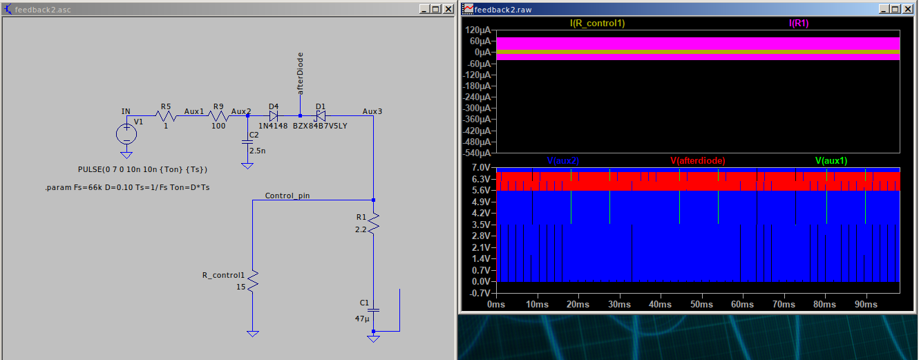

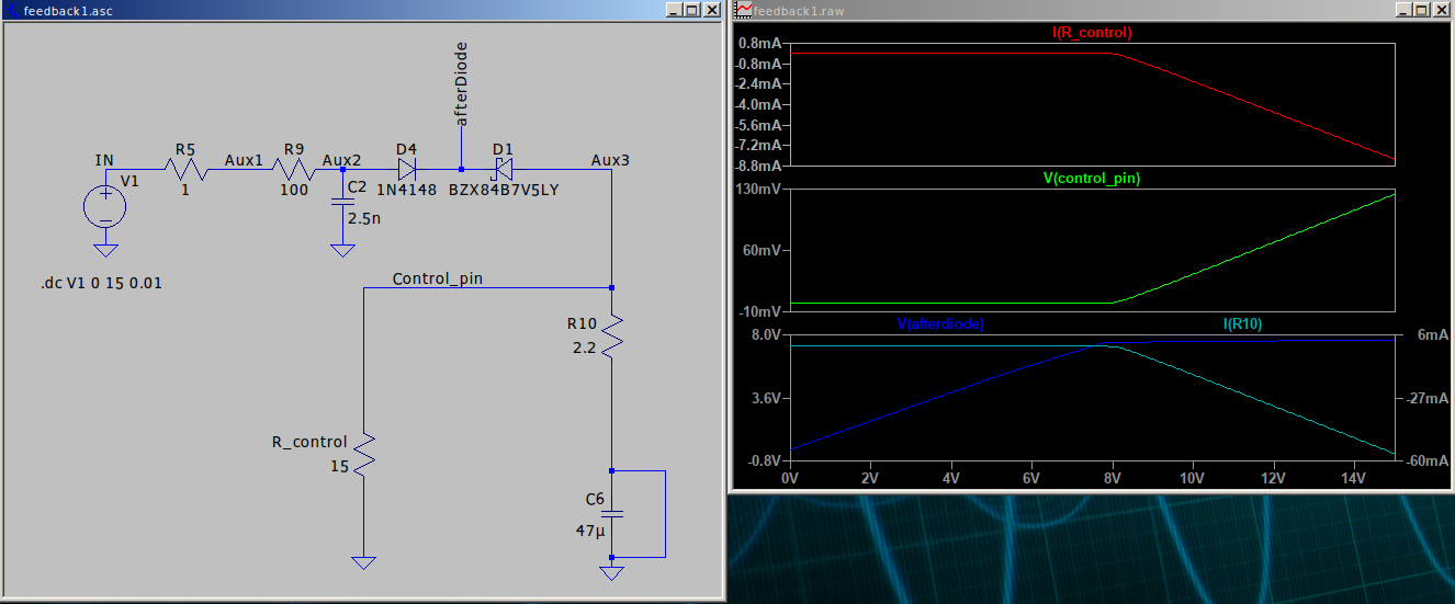

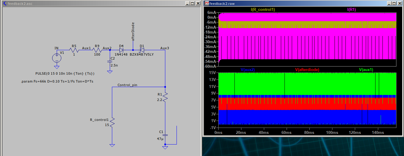

                              I'm trying to simulate a LTSpice model of that...
                              Why other winding voltage is not based on transformer ratio?
                              But I'm just a simple person with minimal electronics skills, so I'm asking for a help.

                                  https://piexpertonline.power.com/piexpert/design/index#
                                  You can design your power supply here, changing parameters, changing types of circuits. You can even specify you want a "zener based AUX feedback". Based on this you can see that snubber network in "my power supply" is not well designed.
                                  Based on that I found that output voltages depends only on transformer winding ratio (as I always thought). So it does not depends on zener diode. So it transformer windings are not shorted, voltages should be correct.
                                  Transformer design
                                  https://www.thierry-lequeu.fr/data/TOPSWITCH/AN32.pdf
                                  When I lowered a capacitance of C2 from 2.5nF to 0.5nF, then secondaryB voltage was lower. I think R8 and C2 should be just low pass filter or something like that.
                                  Attached "example power supply.pdf" has AUX voltage 27V, so for that reason there is a 22V zener diode. So difference is 27-22=> 5Volts
                                  So as Control pin current is limiting a duty cycle and voltage, "something is consuming a current" and there is not enough current to flow into a Control pin. So maybe C805 is leaking current.
                                  Diode D1 and Z800 (Zener) are OK.
                                  I have tried about 10 different 47uF capacitors on position C805 (of course all of them was from trash and they are old, but have the right capacitance). I hope at least one was good.
                                  How to measure an output secondaryB voltage if with increasing resistive load, that voltage is lower? Should I completely disconnect an output resistor? Voltage on output capacitor should be "the right" as it is already rectified and smoothed.
                                  Do you have idea what can be wrong or what I can try?

                                    I was thinking about AUX circuit here and I did some simulations:
                                    What is controlling a duty cycle is just a current into a Control pin. So more current, less duty cycle.
                                    At "Rising AUX DC voltage.png" is it showing that current into Control pin starter to rise just after a Zener voltage of Z800 diode.
                                    Another pictures are just simulation which describe, that with higher input amplitude (7, 9, 12, 15 V) you have higher current in Control pin.
                                    Then you can clearly see range of fluctuation of voltages based on a measuring position (giant fluctuation).

                                    I understand it this way:
                                    - on primary TOP247Y is generating a PWM signal which is opening/closing its internal transistor
                                    - primary and secondaries are in opposite phase (transformer windings dots)
                                    - all secondaries have a diodes which flows only in one direction
                                    - when transistor is open, a power is putting into a magnetic field of the core
                                    - when transistor close, then giant current change happen in primary and giant current peak is made
                                    - that peak goes through a "fast" snubber network diode and consume in its RC filter
                                    - this operation can possibly influence a power in a transformer core
                                    - when transistor is closed, then secondary diodes are open and they "consume a power" stored in the transformer core
                                    - that power is regulated by PWM signal duty cycle
                                    - TOP247Y starting from 0 to its max duty cycle and negative influence a duty cycle based on its Control pin current
                                    So primary windings count is responsible only for a magnetic power stored in a transformer core, it does not control a secondary voltages.
                                    Snubber network should not influence secondary voltages too.
                                    Secondary voltages depends on its winding ratio. So as AUX and secondaryB has ratio of 1:2, so when an AUX has 15 volts, then secondaryB must have 30 volts.
                                    Rising a voltage on AUX side will stop after enough current in Control pin (it will lower a duty cycle, or stop rising it).
                                    What is telling a TOP247Y how much Control current is enough? I guess Control voltage must not fall to 4.8V, so should be in range of 4.8-5.8V.
                                    Please check "Control current, duty cycle.png". It is showing that 2.2 - 6.6mA are enough to control a duty cycle.
                                    And finally please check "Control pin voltage.png", this show that 5.8V of Control voltage is a threshold value to rise a Control current.
                                    It means at external 5.8V it will start to rise current in Control pin to lower a duty cycle.
                                    It means as there is a diode (0.7V) + zener diode (7.5V)+ threshold voltage 5.8V => 0.7+7.5+5.8=14V, this should be AUX voltage, and secondaryB​ should be 28V.
                                    Any differences can be caused by a leaking a current on C805 (47uF/50V) or somewhere else.
                                    Please correct me if I'm wrong.
