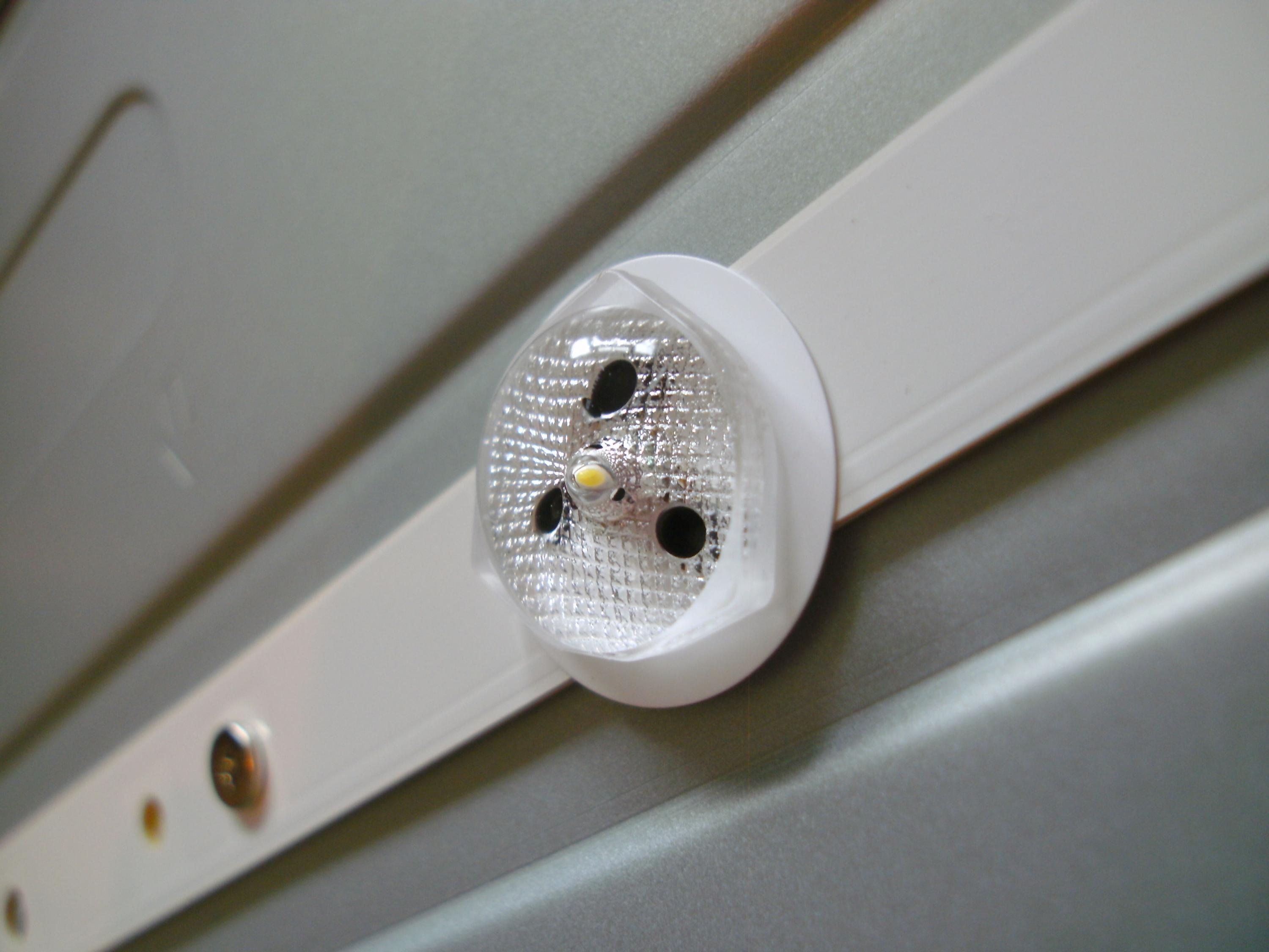

    How do I spot a blown LED?
    I have the notorious Toshiba/Vestel LED Tv with what I suspect is a blown LED, two actually, compared to the rest these two have a crack appearing across the middle, one worse than the other, I presume this means they are blown? there's no blackening that I can see, thanks.

          Re: How do I spot a blown LED?
          Do you mean the plastic cover is cracked?
          The plastic is irrelevant and only there to disperse the light.
          You can snap the plastic off and they LED underneath will still work.
            you will need to remove the clear white dome, and a visual inspection can be done. then you can use your multimeter set in diode mode to test each led.
            When you touch the probes to the led its should light up a little bit.

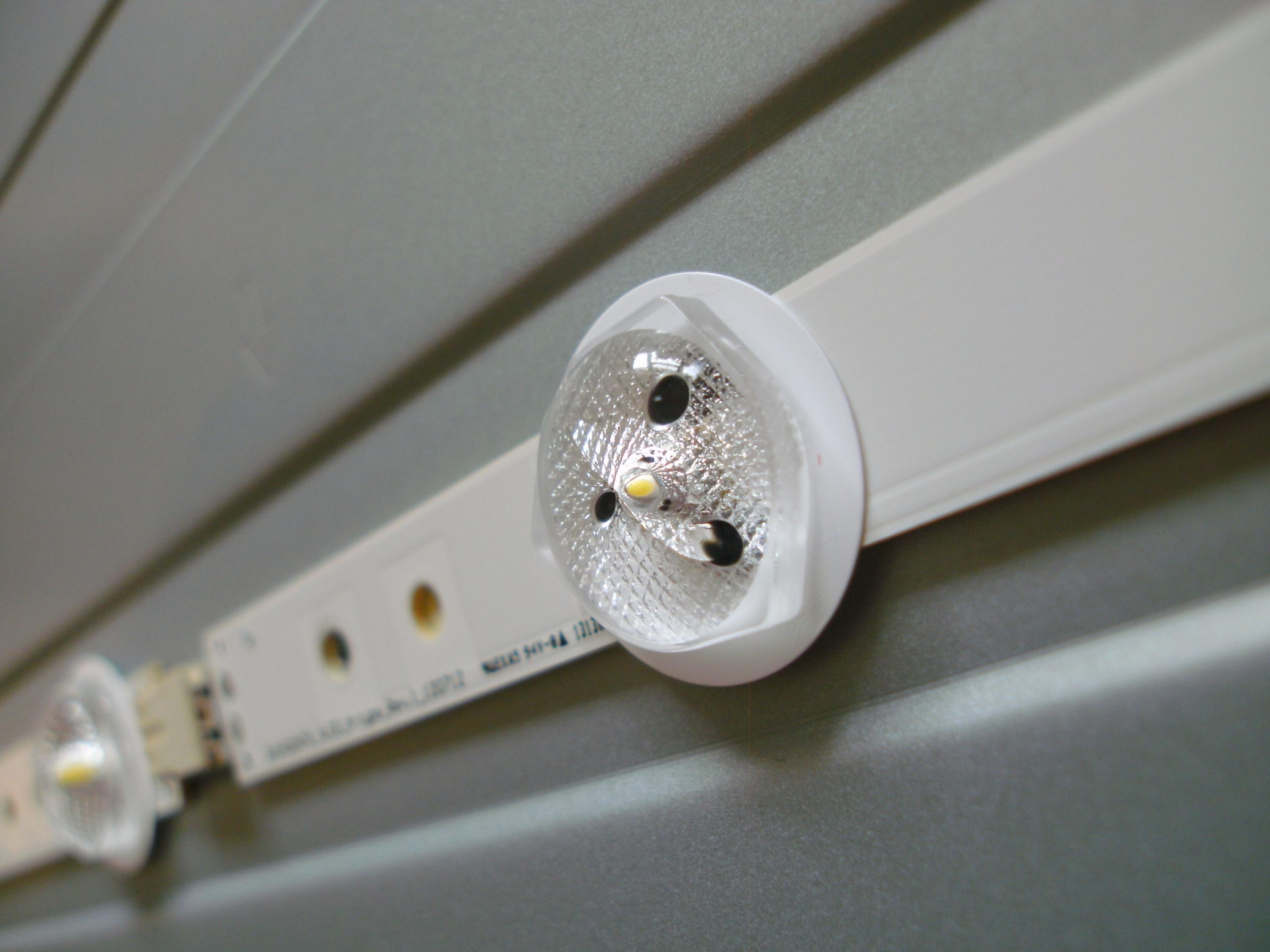

                  Link up 3 x 9 volt batteries in series to the + and - marked at the start of the led strips.
                  Once you've found out what strip/s are not lighting up, before you crack off the plastic domes check the leads for corrosion bad contacts etc.
                  If they all look fine you'll need to remove the plastic domes from each LED and use the diode test.
                    No ! Turn the tv on go to the top strips of led find the negative terminal on the strip use the pliers to bridge that NEGATIVE terminal to the chassis that will fire on the booster for the top row and they should light if not then the top row is out. Next if the top row lights turn the tv off remove the top row of strips then the next row of leds and put them in the top position and repeat the same method if they turn on then they are good if they don't then they are bad. This saves doing all the other time wasting nonsense.
