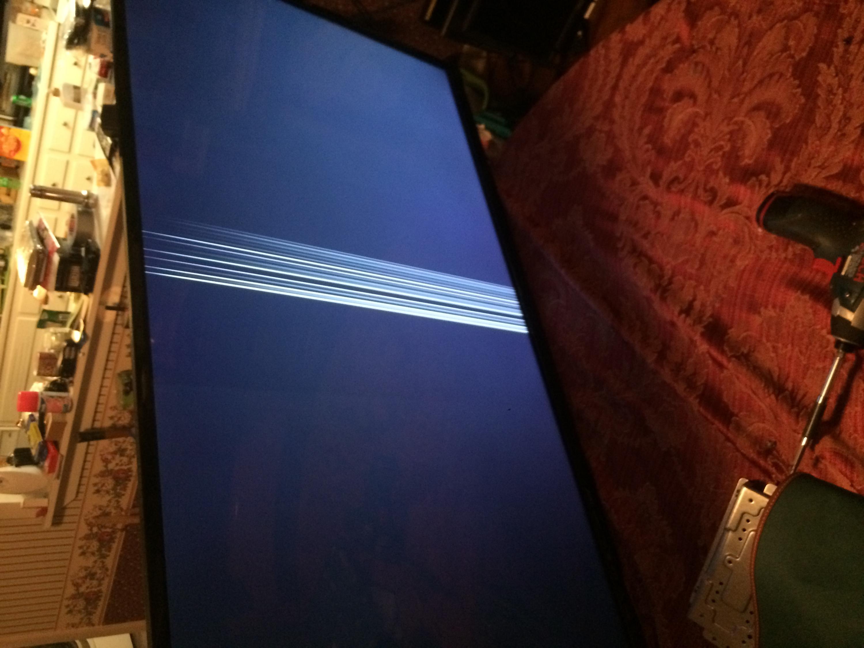

            I just replaced the full set of led strips in one of these being very careful with the screen disassembly and reassembly. I was not able to verify anything on this set except that voltage was being supplied to the backlights and they were not coming on. Feeling confident that this would be the only problem I proceeded with the replacement of the LEDs. Gonna attach a pic of what I have now and ask you what you think?
              Re: Help with how to replace LED's
              Looks like tab bonding is damaged.
