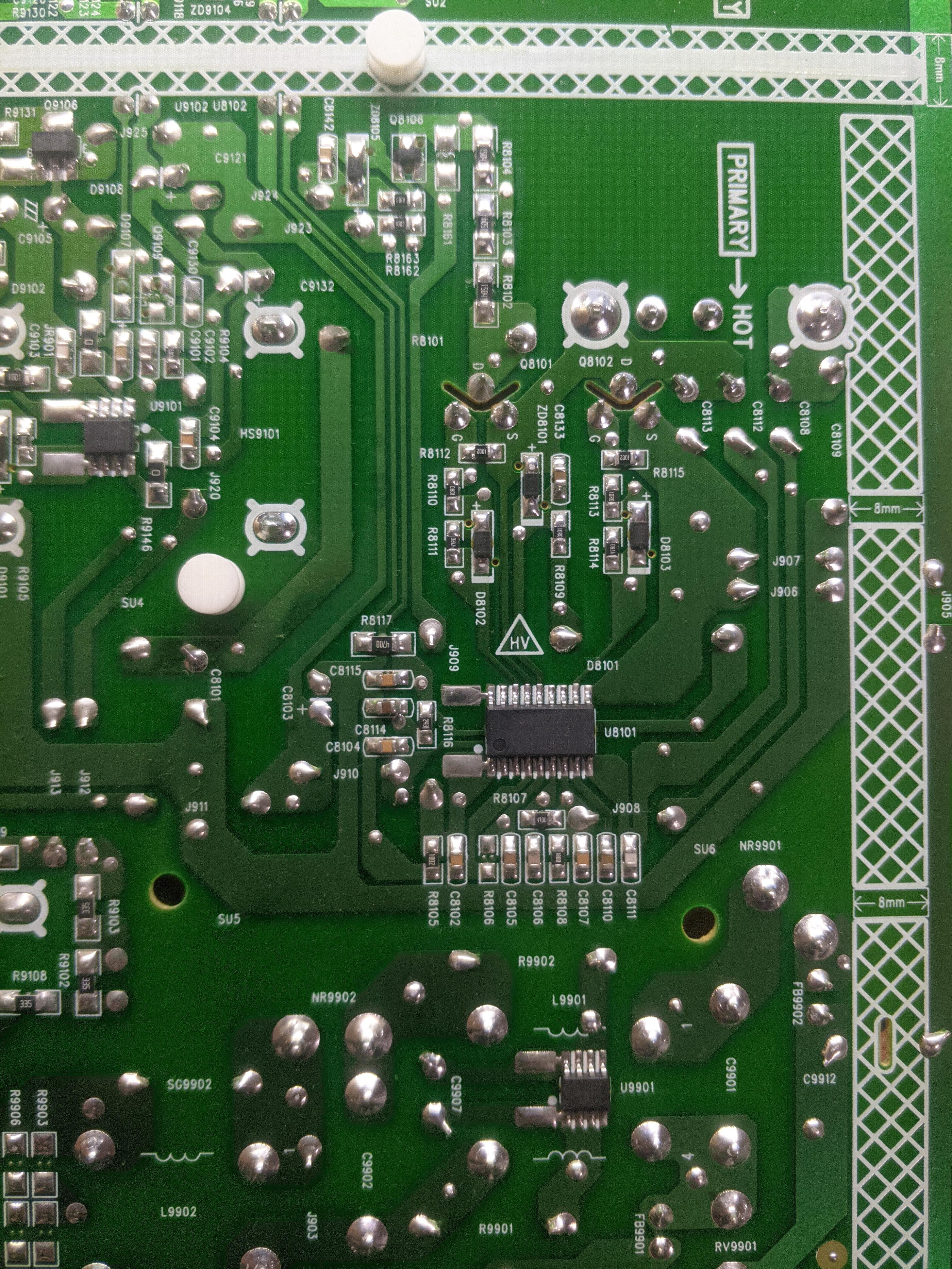

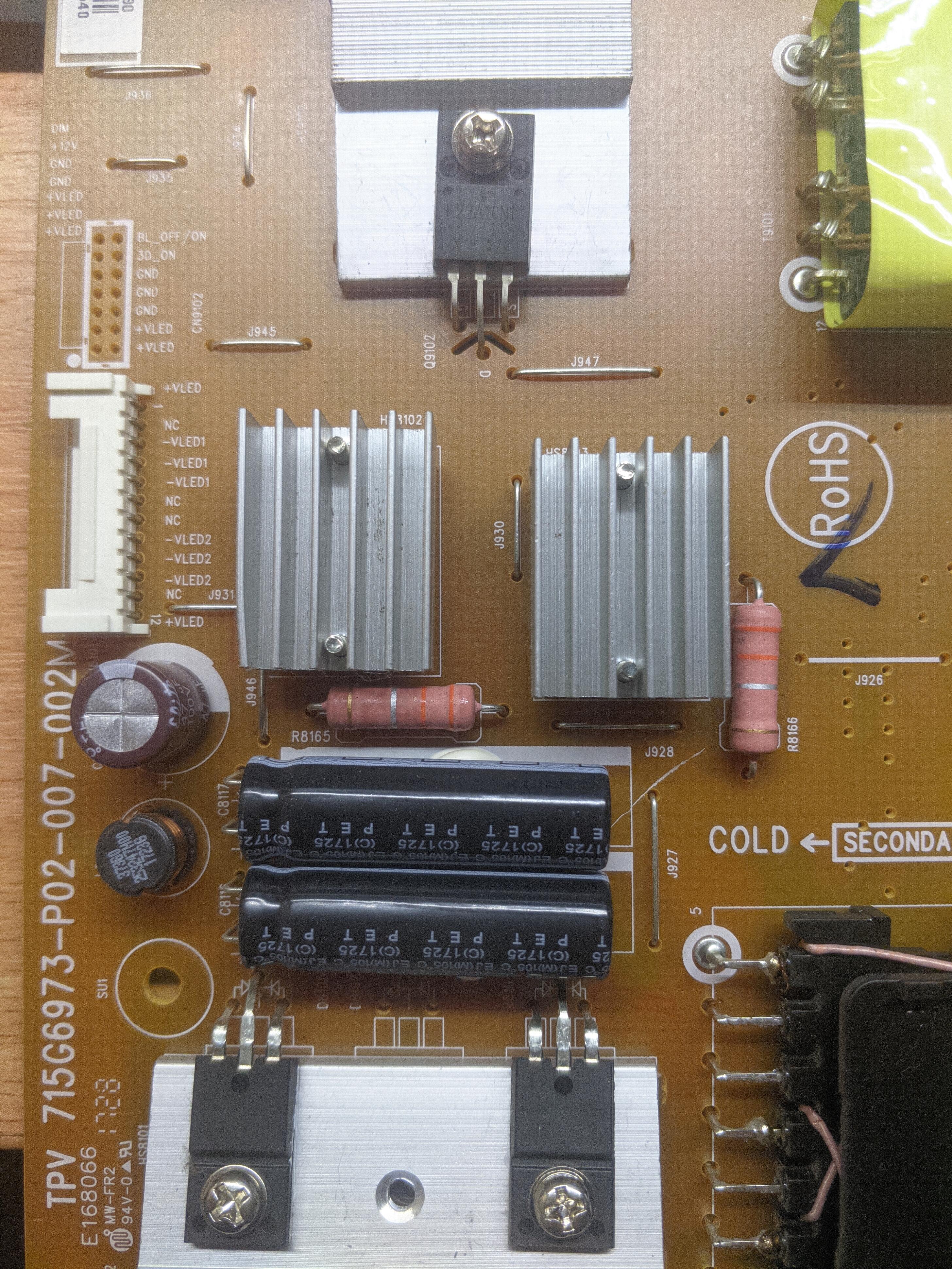

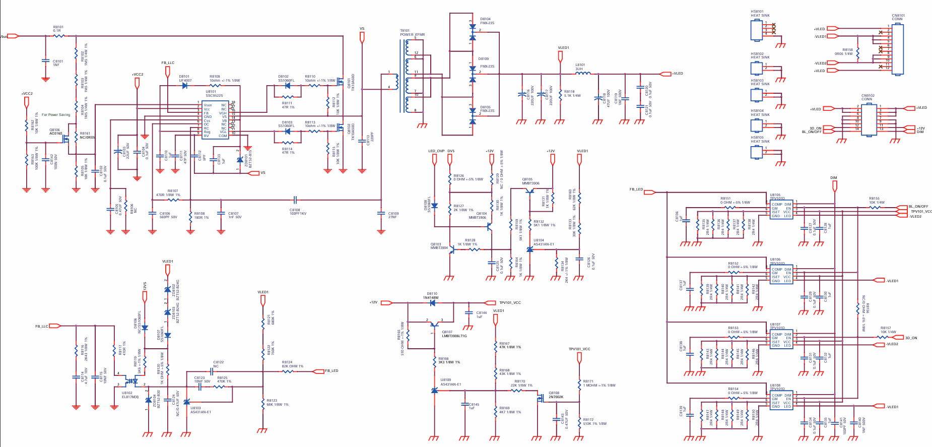

    Dear community, I want to increase the lifespan of my backlight led in my TV by decreasing the current.
    However I need some help identifying the resistor I need to replace to achieve this.
    Thank you!

    Why don’t you just turn the backlight setting in the OSD down?
      Good idea, but the tv doesn't have a setting for backlight brightness, only eco mode. 😅

        What is the TV brand and model?
        Look at the DIM pins on the schematic. Funny thing… the TV is capable of dimming the backlights but the firmware doesn’t include that setting.

          It's a Phillips 49PUS6550. The mainboard is 715G6973
            turn off the ECO mode....you will be able to adjust
              https://www.manua.ls/philips/49pus6551/manual?p=50
              Also shows how to adjust the brightness.
