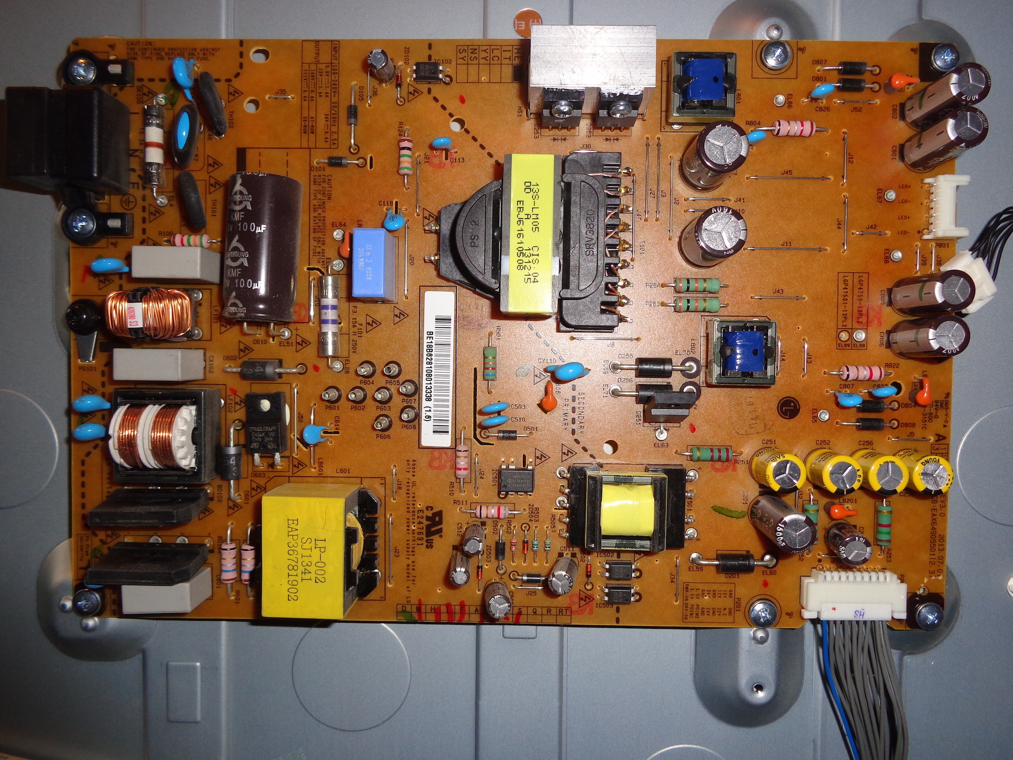

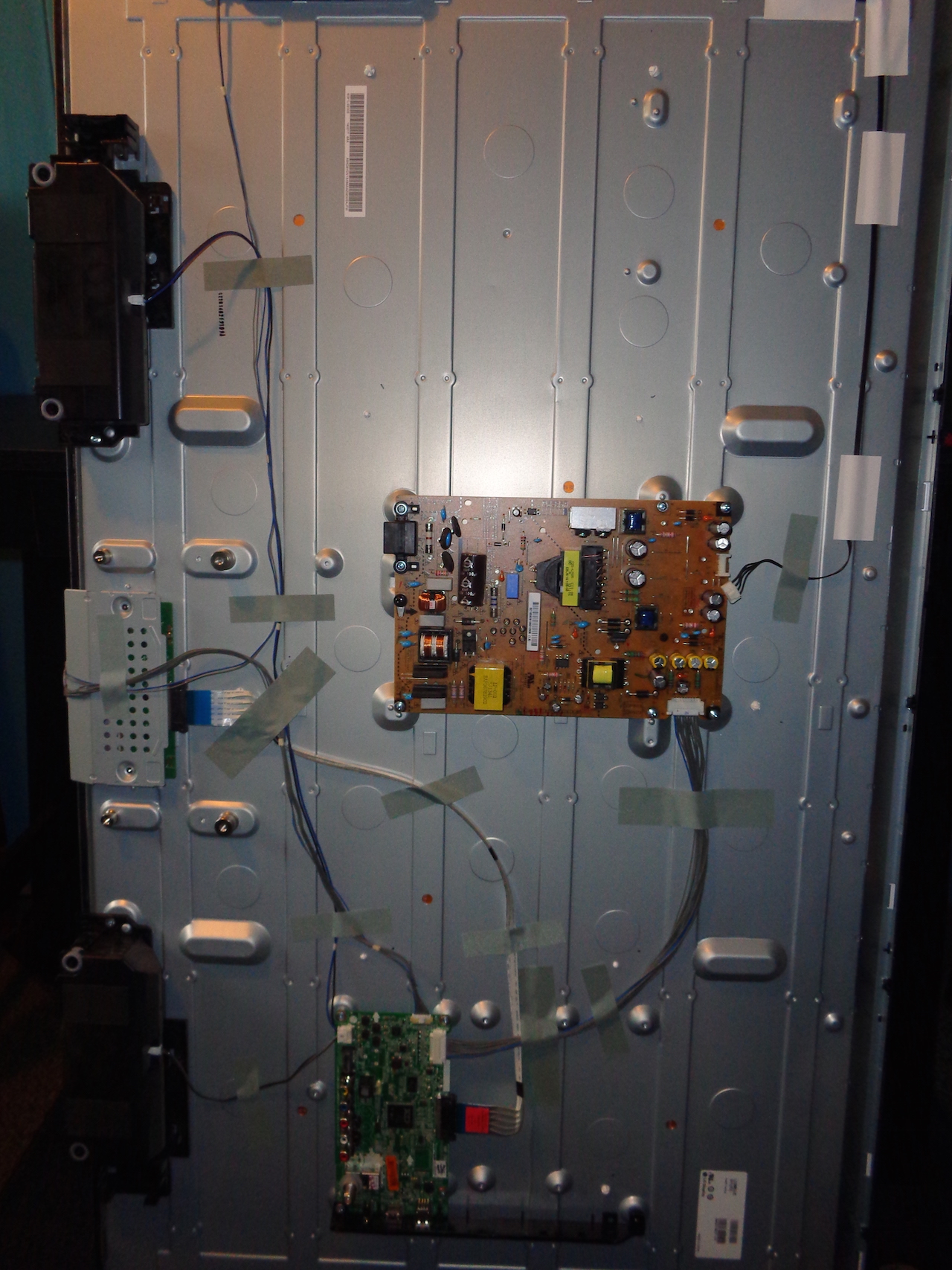

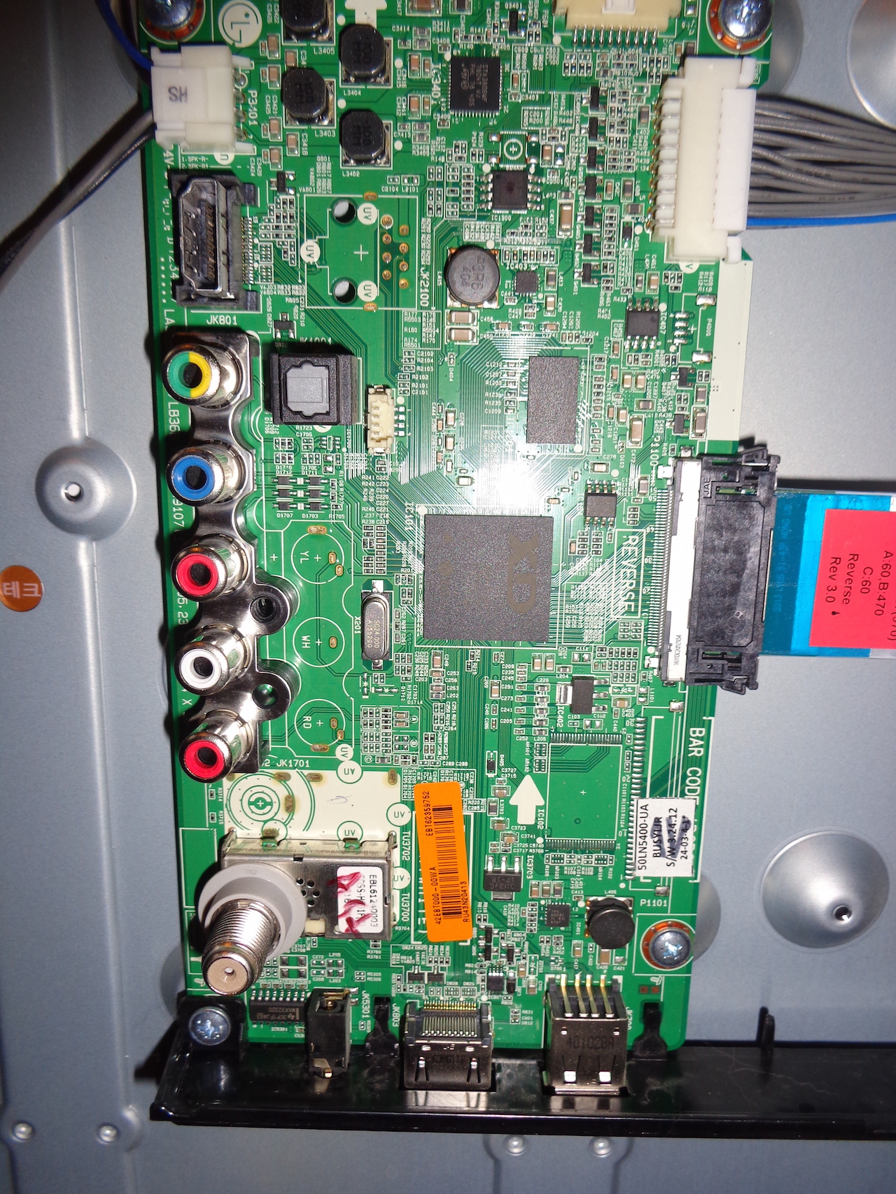

    Re: LG 50LN5400 Screen Flash Standby Go's Out
    As promised here are some photos, the diodes appear to check out ok, I get infinite reading on the output of power supply to the screen LED's, R804 in the upper right side of the power supply is wide open, with LED's plugged in or not! Caps appear ok, I see northing that screams bad!
      When you say R804 is wide open do you mean if a resistance check is made you get no reading? I would pull one end off the board and check the resistance again. If 'open' I'd check both points on the board for short cct with respect to the chassis ground. If nothing show I'll replace the R804 with a 1.2ohm resistor first and give it a try.
        Yes wide open is 000 same as touching leads together, one leg of r263 r264 and read 1 and other read 0 (by the trans) R251-R253 all read 000 one leg and level off in the 900's on the other leg. R822 R804 both pinkish in color read open to ground on both sides. This is all done with my black probe on the screw holding the power supply, and red taking readings. Let me know if I still have to remove the one leg and test again!
            "Yes wide open is 000 same as touching leads together" That does not make sense to me, when the probes of the meter are touch together, it will show <1 Ohm (000 Ohm as you indicated) so if the resistance between the two legs of the resistor show the same as the reading when the two probes of the meter touching together, then the resistor is not open.
            R804 has Brown, Red, silver, gold = 0.12 Ohm
            BTW, R804 is the resistor for the SOURCE pin of the power MOSFET Q801 which is for the boost converter circuit to produce the Voltage for driving the backlights LEDs. I doubt that the resistor is bad.
            You will not get anything at the screen LED connector until you have BL-ON signal from the main board.
            At this point you need to report the DCV of each pin of the connector of the power supply board that goes to the main board, you MUST provide the name of each pin also. Report the readings when TV is plugged in and when the power switch is activated.
