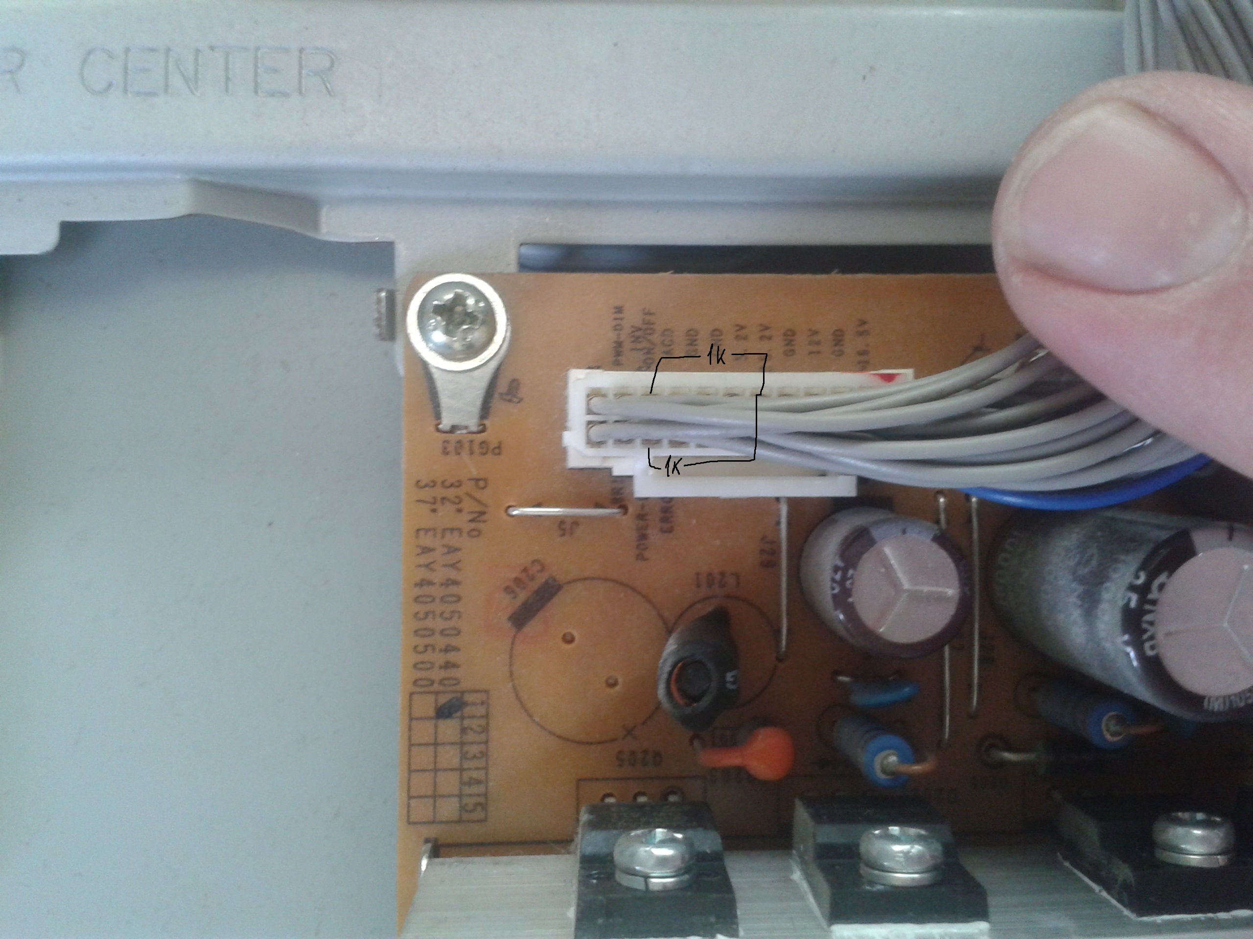

    i added a picture of what i did:
    1k resistor ( rated 1/4w hope its ok) from the 5.2v to pin - inverter on/off
    1k resistor from the same 5.2v to pin - power_on
    with the a/c plugged in and the main board disconnected
    the power_on cam up to2.9v but still no other voltage beside the 5v
    am i doing it right?
    the board model: EAY4050440
    thank you guys

      Re: LG 32 lcd not always turning ON
      so... does it mean the pson voltage is correct ?
      and the power board is at fault
      should i replace the capacitors or there is furhter checking to do?
        With jumpers in place check one of the main caps voltage with meter set to 600VAC, Careful HOT side of board. Take note of polarity
          just to make sure ... i'm testing the two large capacitors marked c608 and c609
          and i still get 330v dc
            Do you want to repair the boards or replace them?
            Your PSU is faulty BTW

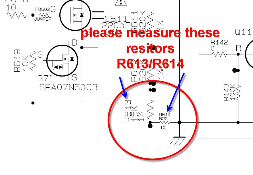

                                  Same EAY4050440 from 32LG2000 with PFC low, caused by R609, R610, R611, R612 620K ohms resistor.

                                    #37
                                    Hallo every one
                                    please measure r613(15k)/r614(820ohm)
                                    thanks
