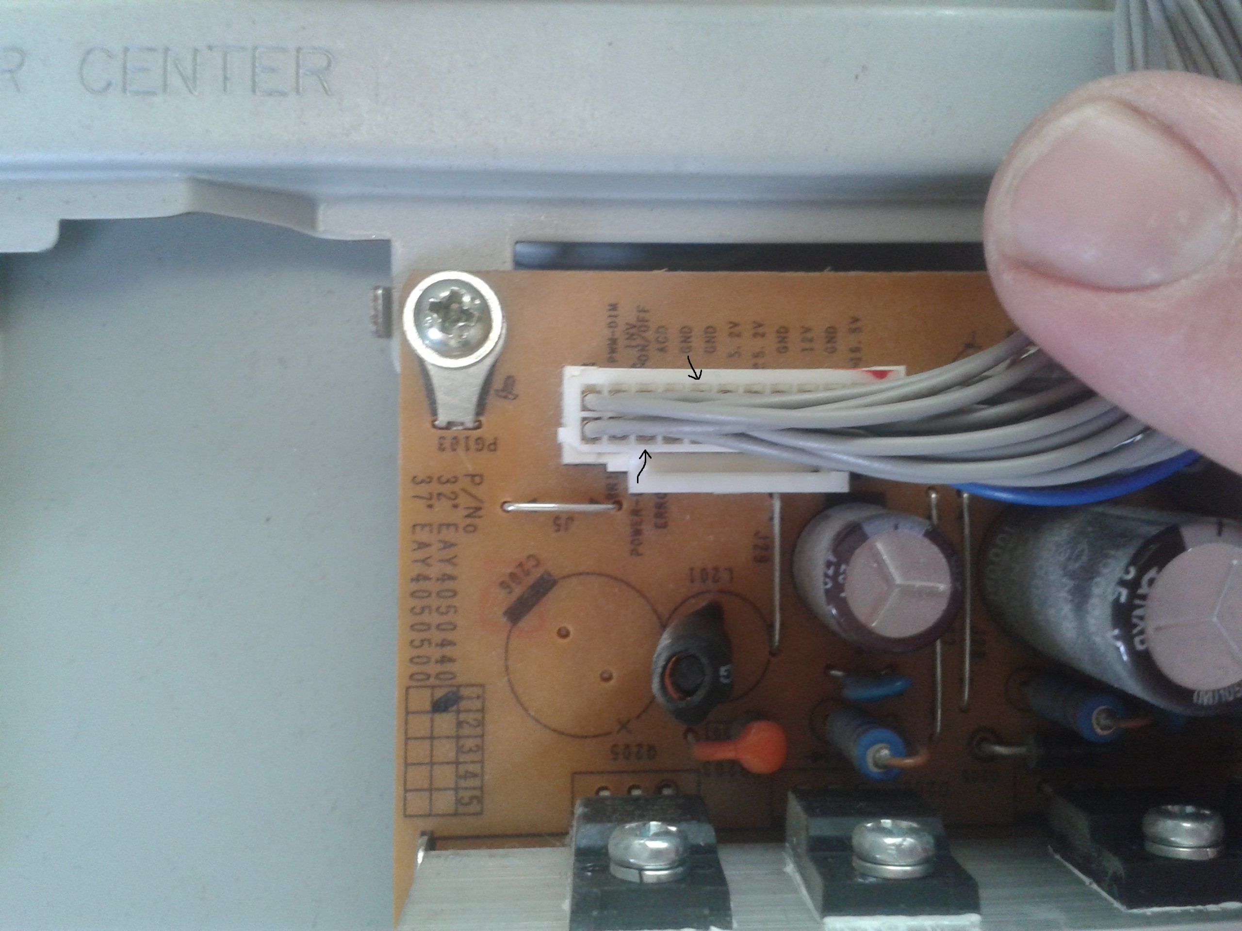

      i just tested what i think is PSON
      i get 1.5v when on 0v when off (while still dont have picture)
      is it ok?

        Re: LG 32 lcd not always turning ON
        Check 12V, 16,5V, 25,2V when PSon is 1,5V. Check at C609 PFC status.

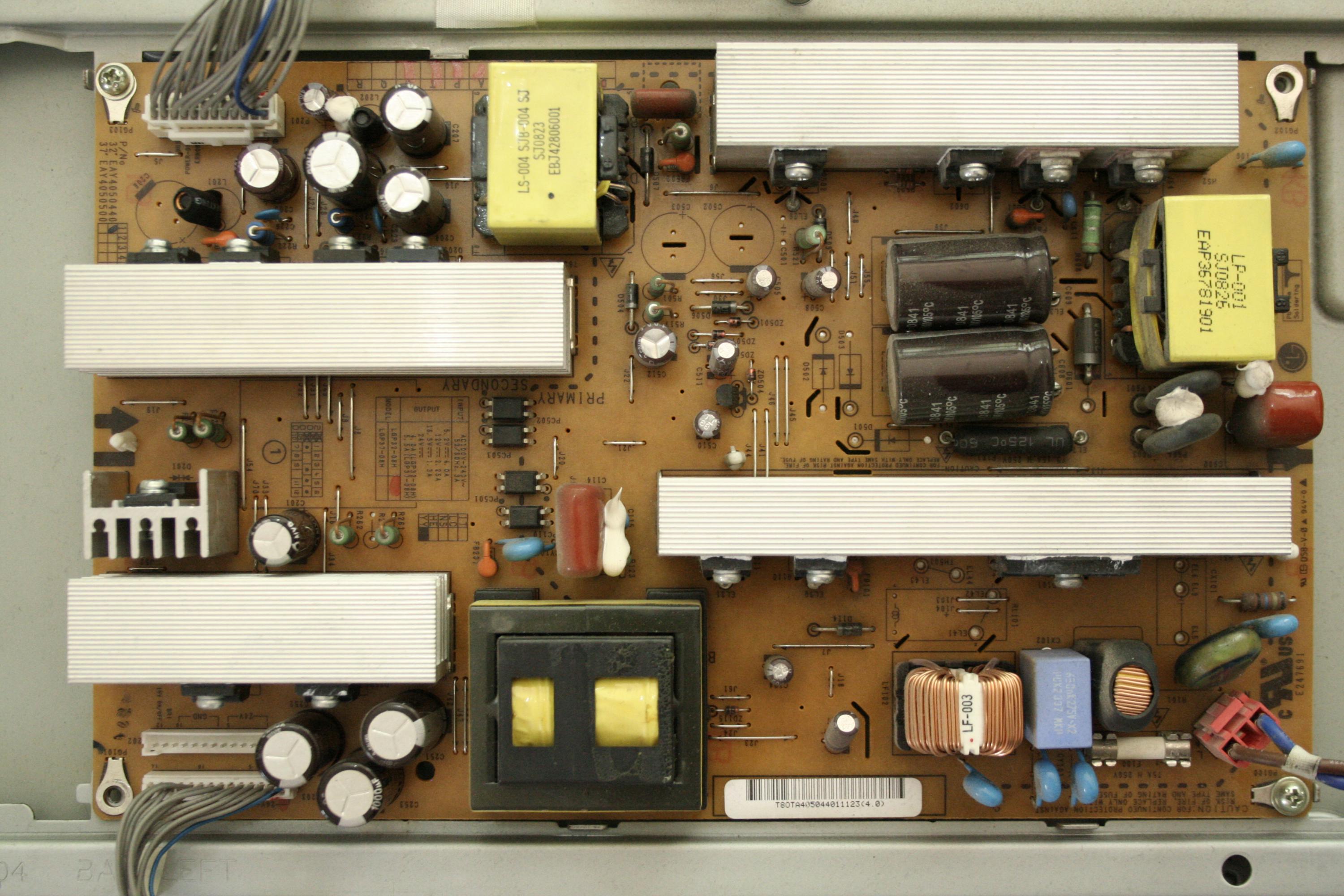

              i'm get this resaults:
              1.5v - power_on
              5.2v- to logic board
              no 16.5v to " "
              no 12v " " "
              no 24v " inverter board
              i hope i get lucky tomorrow so i can test and compare
              when it does go on.
              victor sorry i don't know what PFC status mean or how to test it.
              *excuse me for my poor knowlege in electronics , but i'm learning quickly
              thank you all for your patience
                Voltage at main filter cap (The big cap rated 450v) .. Red to + and Black to - : Meter at 600VDC. Careful as working on HOT side of the board.
                What reading do you get when attempting to power the set on?

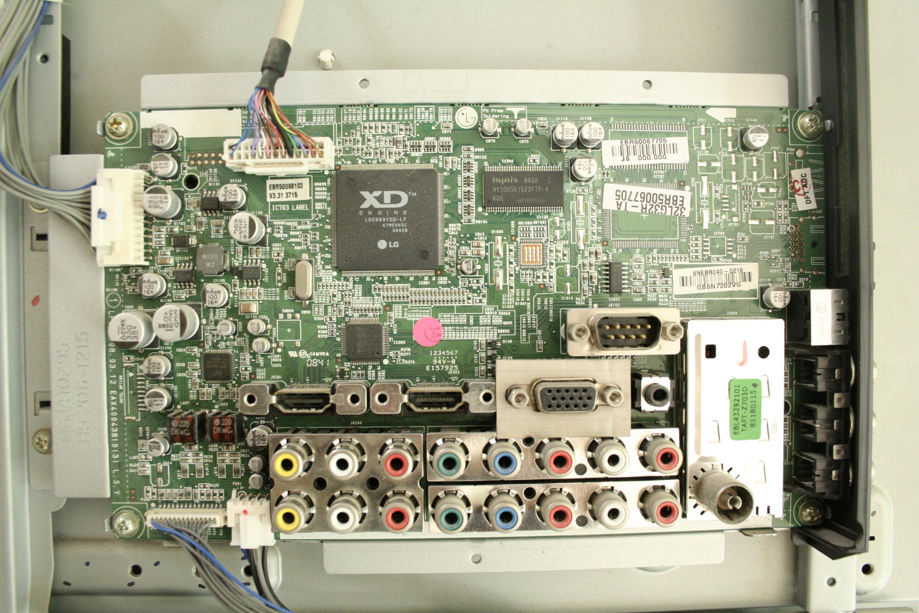

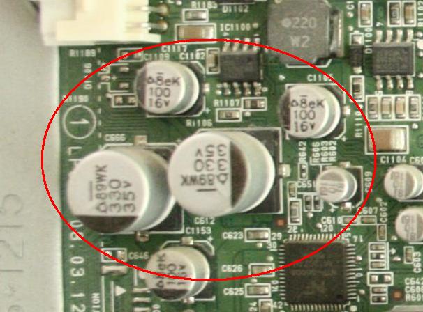

                  If you have replaced the caps on the secondary side of the P/S, I'd check the values of the capacitors around the regulators on the mainboard. Also the two diodes around the switcher, D1100 and D1102.
                  I've seen the mainboard sit and play dumb when the standby circuits could not startup the main processor because of odd waves coming out of the mainboard switchers. Leaky blocking diodes caused the voltage wave to rise but then fall back again, unsuccessful starting the switch mode off. Cooling the parts with freeze spray identified the faulty circuit area (lowered the threshold to maintain pulsing), but not the exact parts.
                    update:
                    the set turned on today and i get this readings:
                    power_on is 1.5v as when not turning on
                    but then i get all the other 12v , 16.5v and 24v
                    at the big caps i get 329v when on and 310v when off
                    is the problem in the power board ?
                    * i do not have a capacitance test on my multimeter

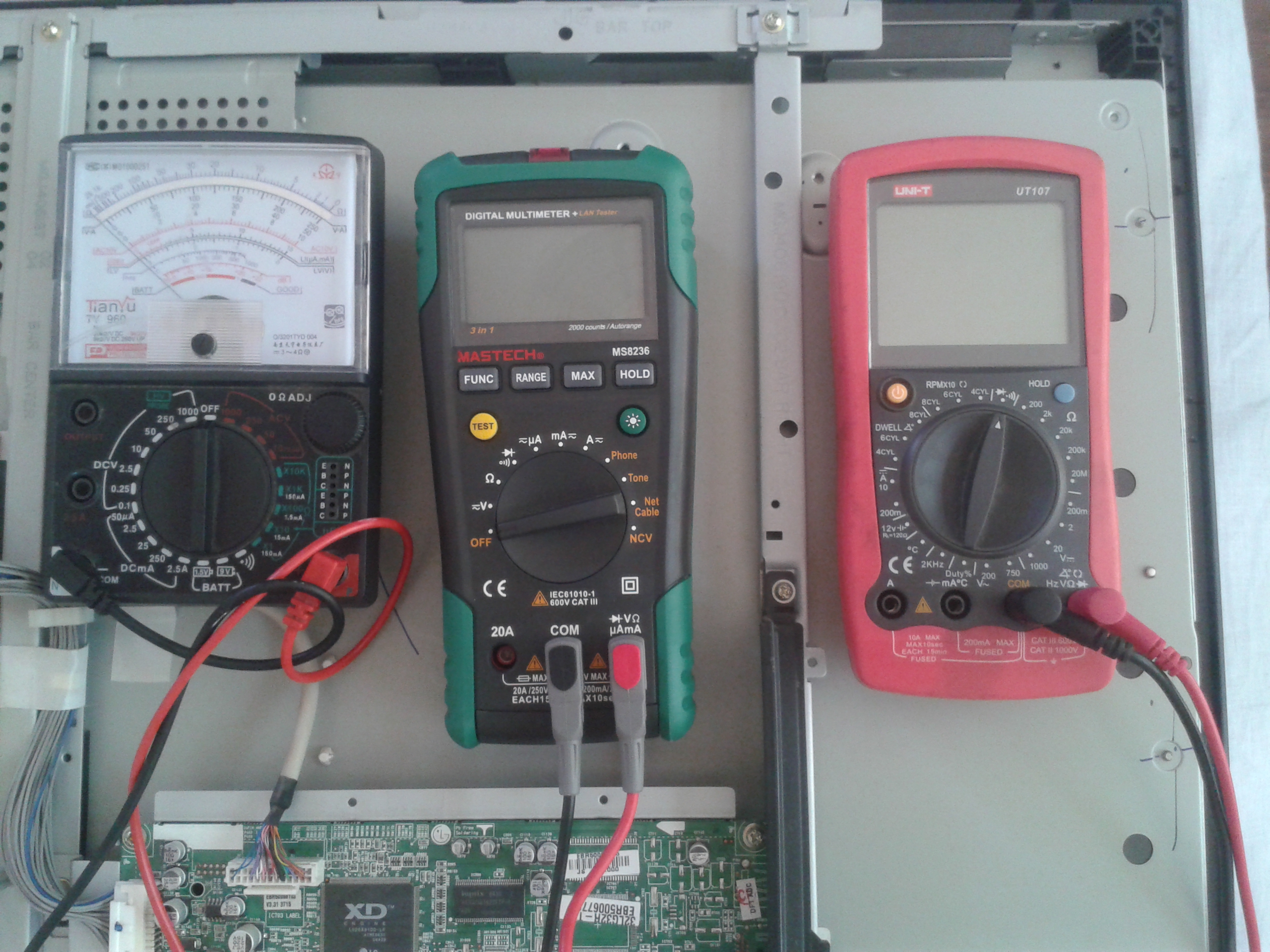

                        i believe the battery is fine (i normally get a battery icon when low)
                        i tested with another one i got - the cap read 333v and 1.52v at power_on
                        * this is the equipment i've got:

                              Can you take a picture of what setting you are testing on the meter please
