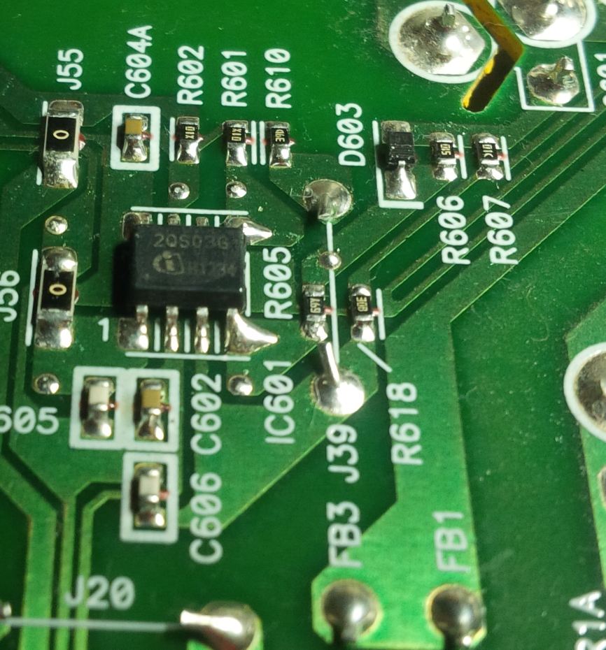

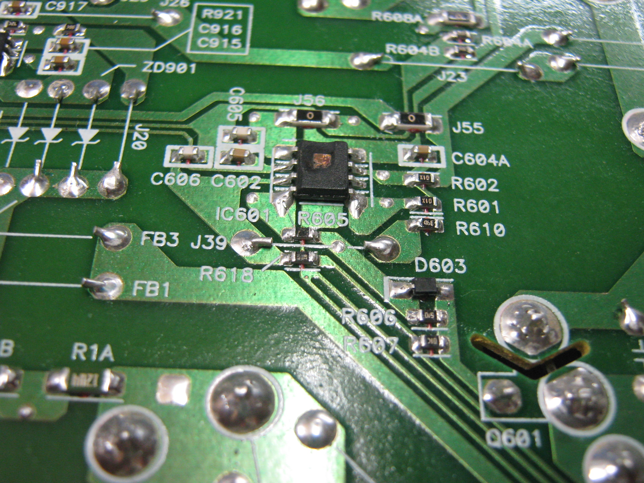

                    #69
                    Re: Sony KDL-55EX640 (630) DEAD SET
                    I have a DPS-195AP with damaged parts.
                    I need help with identifying IC601, R606, R605 and R618 please.
                    • t4796
                      • Feb 2015
                      • 79
                      #70
                      Hi Mate,
                      Best I can do tonight.
                      IC601 = ICE2QS03G - Infineon
                      R605 = 69Y 5.11 ohm
                      R606 = 51D? 332k ohm?
                      R618 = 30B 2k ohm
                      • rievax_60
                        • May 2012
                        • 897
                        • australia
                        #71
                        That gives me a better idea.
                        R606 looks like 01S 10 ohm
                        R605 69Y 5 ohm
                        R618 30B 3K
                        It is a bit odd that other 10 ohm resistors are marked 01X like R601.
                        • rievax_60
                          • May 2012
                          • 897
                          • australia
                          #72
                          R605 69Y 5 ohm
                          R618 30B 3K
                          My mistake, R618 30B would be 2K.
                          R606 still bothers me. 10 ohms seems right for the Gate drive circuit. The puzzle is that other 10 ohm resistors are marked 01X
                          instead of 01S.
                          Extra: Maybe R606 should read 510 which would mean 51 ohms. This would make sense also because it is the ON drive current that usually becomes much higher that OFF drive current and needs to be scaled back. The Gate current tends to become asymmetrical when the the drive voltage is more that double the Gate plateau voltage.
                          • t4796
                            • Feb 2015
                            • 79
                            #73
                            I'm pretty sure of the values in my initial post apart from r606. I'll measure across those two parallel resistors/diode. The parallel figure of those two should confirm if it's 51D or 510.
                            • t4796
                              • Feb 2015
                              • 79
                              #74
                              It's 510 = 51 ohms.
                              • rievax_60
                                • May 2012
                                • 897
                                • australia
                                #75
                                Ok, thanks for confirming that. Ill order some bits now.

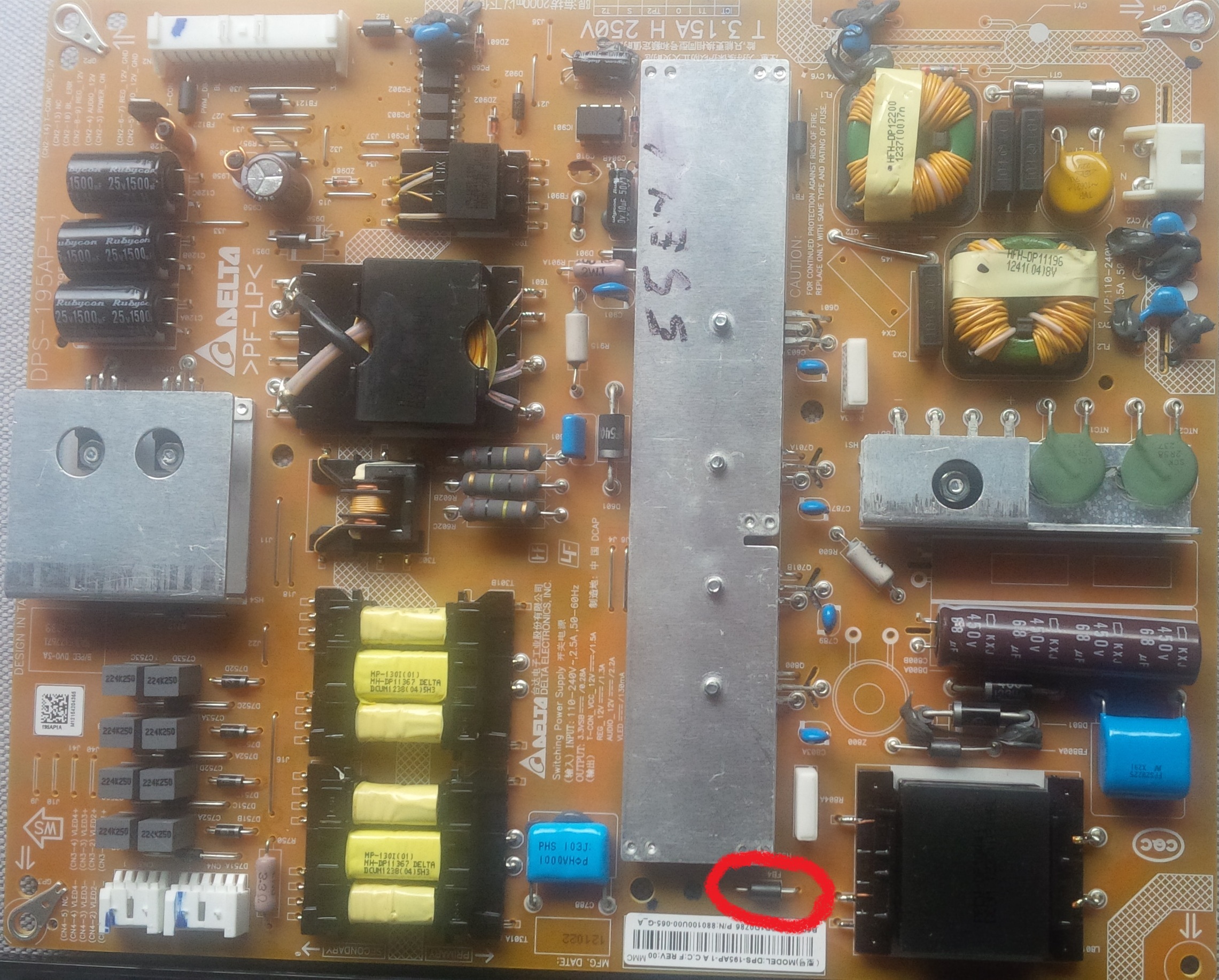

                                      Hi guys,
                                      can anyone tell me about this component circled.?
                                      I just managed to fix one these boards that had power surge but theres a hum when tv is on.
                                      This component is short and need to replace it but there are no markings..thnx alot.
                                      • vinceroger69
                                        • Mar 2012
                                        • 6714
                                        • uk
                                        #79
                                        Originally posted by vikivng
                                        Hi guys,
                                        The part marked is a ferrite bead it will read short circuit
                                        • vikivng
                                          • Feb 2019
                                          • 228
                                          • uk
                                          #80
                                          Yes thank you.
                                          My further research alerted me to this.
                                          The buzzing seems to be only audible when very close to the tv and the back is open.
                                          So is it a fact that this buzzing is normal.?
                                          Very happy with this one.
                                          Awesome forum guys.
