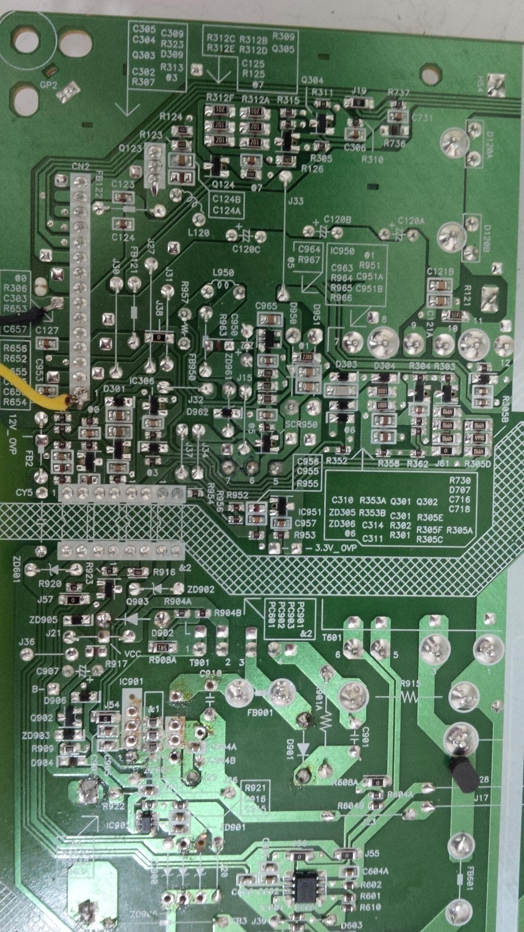

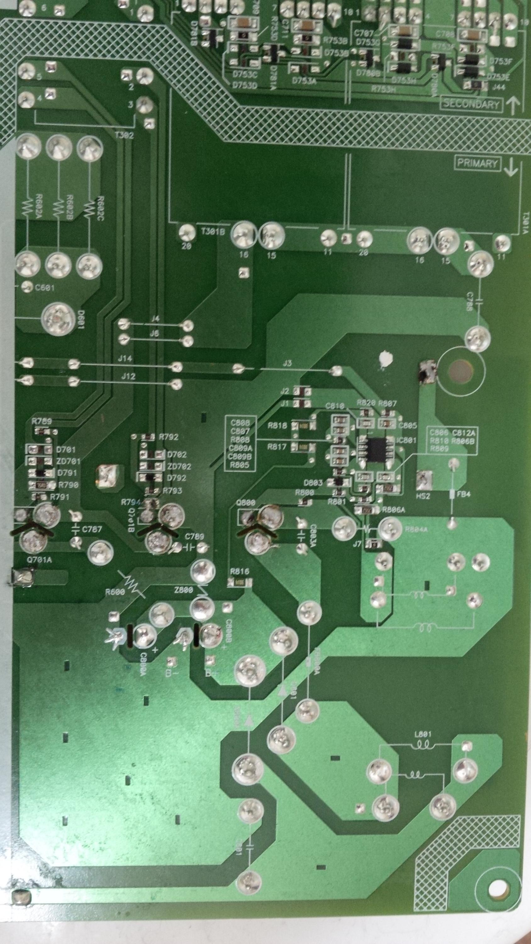

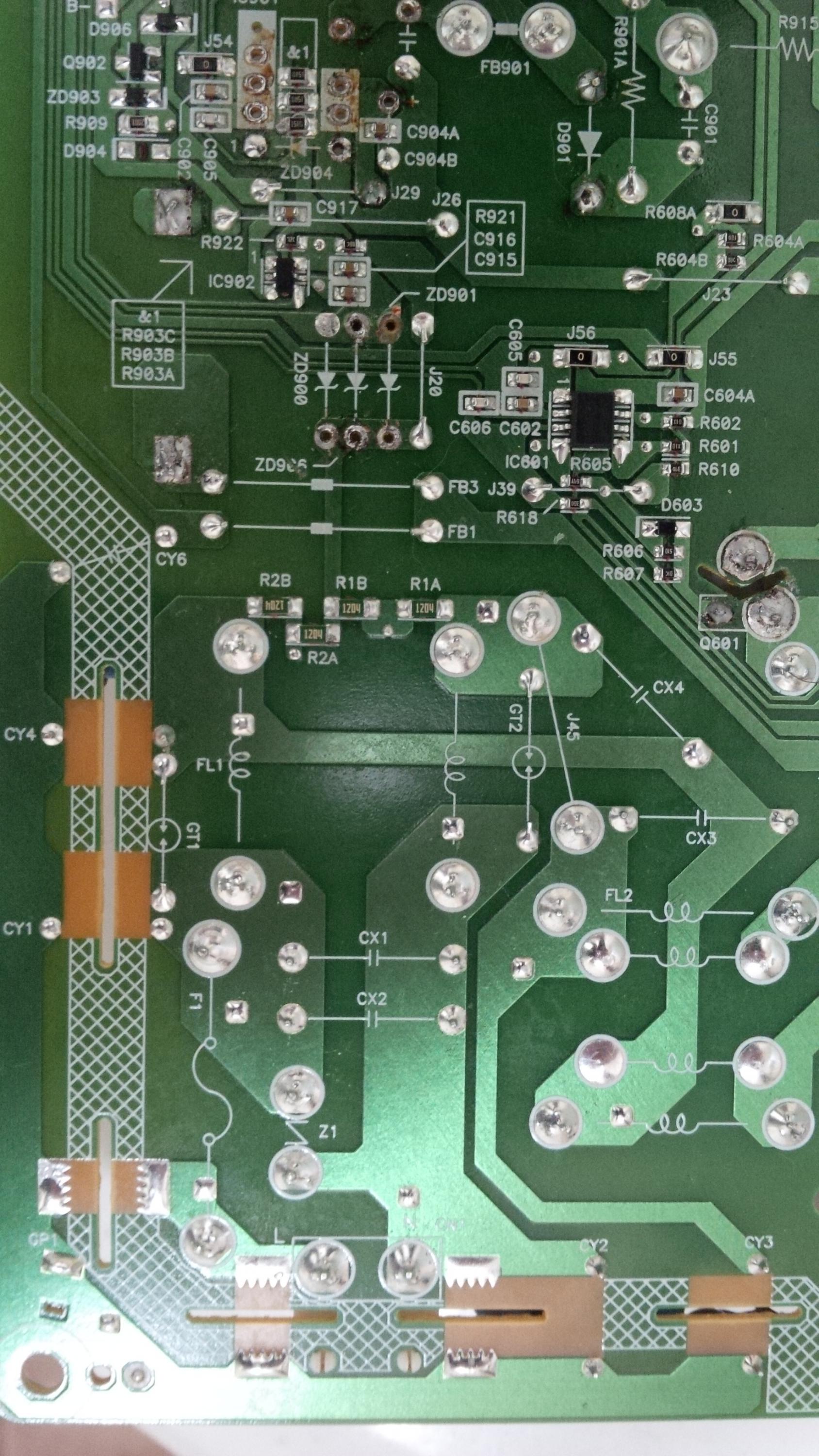

        I will need really hi-res pictures of the bottom side of the board to trace out the STBY section.
        Looking the top side of the board, it looks like IC901, T901 are for the STBY power supply section.
        Please try to read the P/N as printed on the IC901 so we can check and see if the IC is getting the B+ to run it.

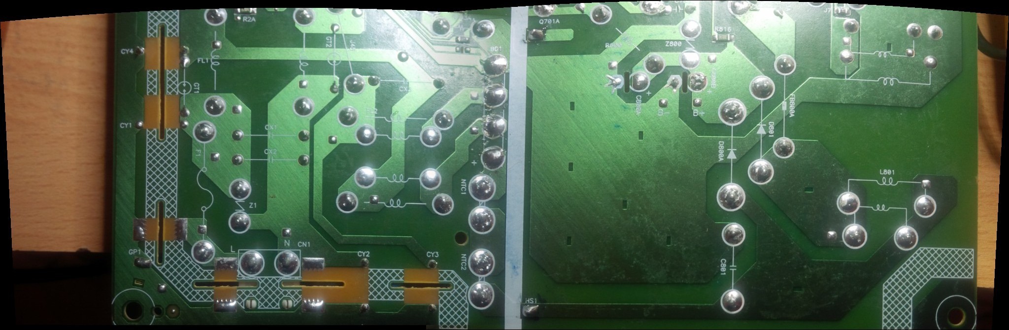

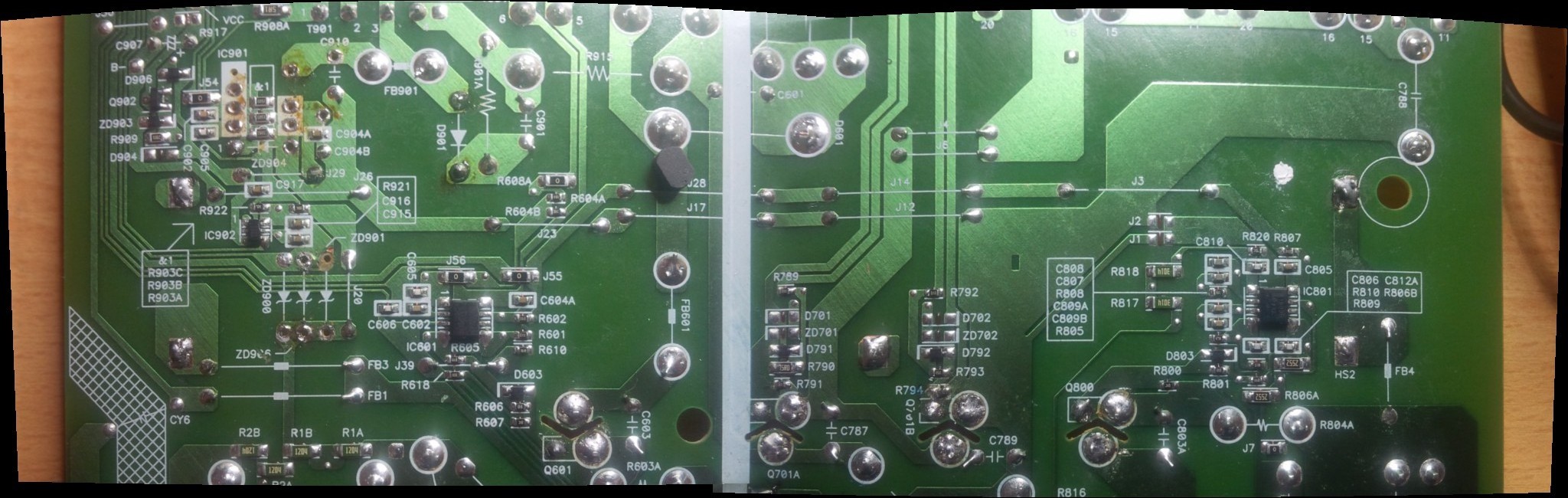

                I'm going to have to come up with a better way of getting these images. I've done the best I can by stitching them together.
                  Re: Sony KDL-55EX640 (630) DEAD SET

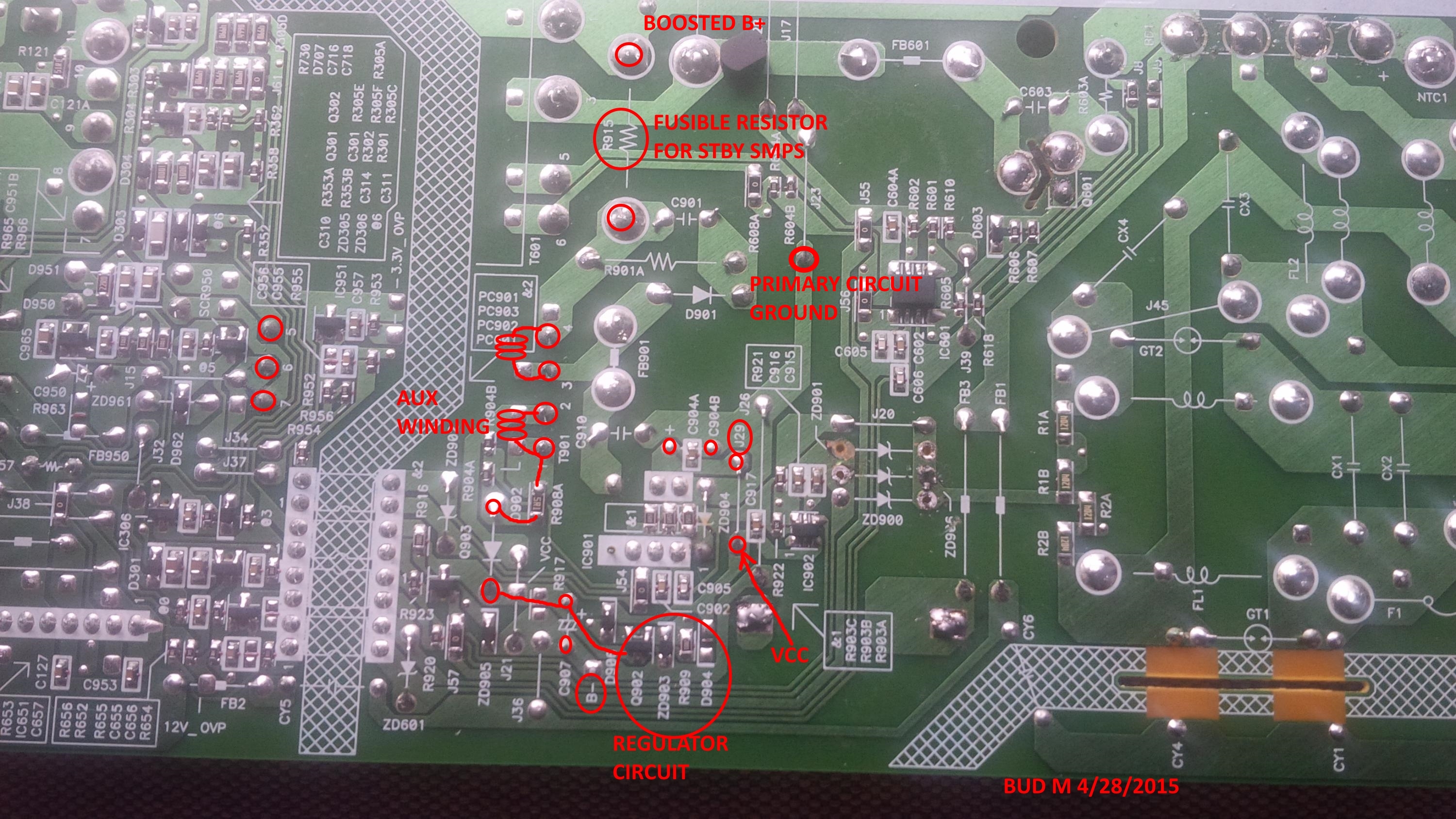

                  OK, there is no open connection for B+ of the main filter cap to feed to the SMPS IC DRAIN pin.
                  I forget to ask you if you do have 335VDC between the two legs of the main filter cap, if you do, ten you should have the same DCV on the Drain pin.
                  I do need better pictures of the whole bottom side.

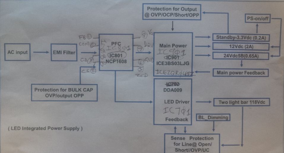

                        Do you think this layout is similar to my board?
                          #32
                          I do not know about that block diagram, I think it may have Zener Diode connected to the VCC pin to clamp down the VCC Voltage in case of spike or surge, you may look for that.
                          But I need the pictures to trace out the circuit of the board.

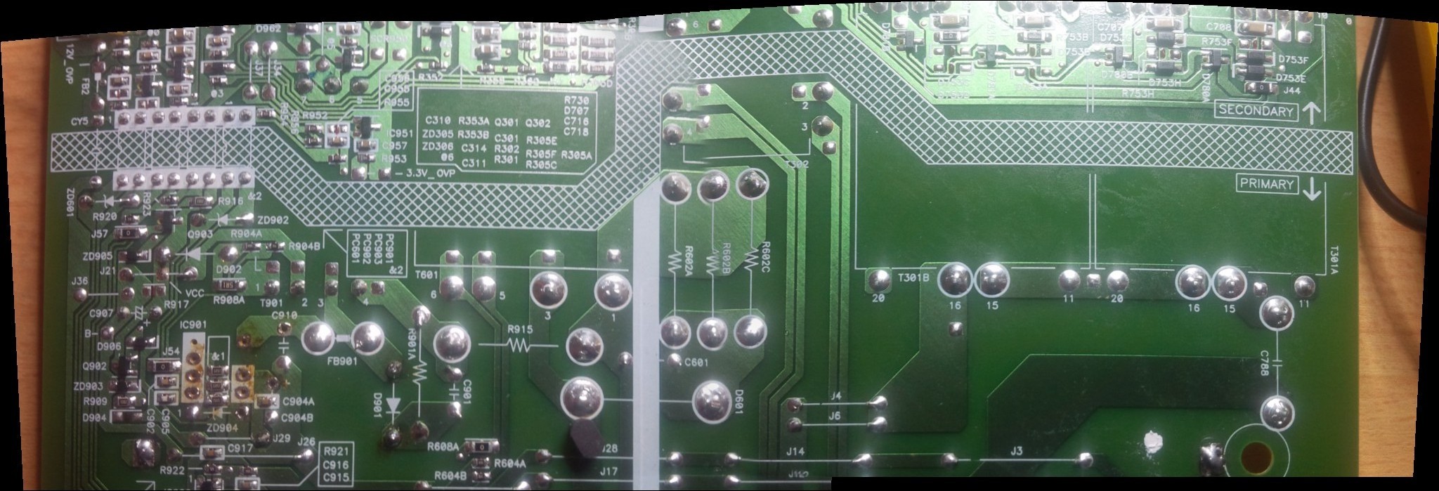

                            #33

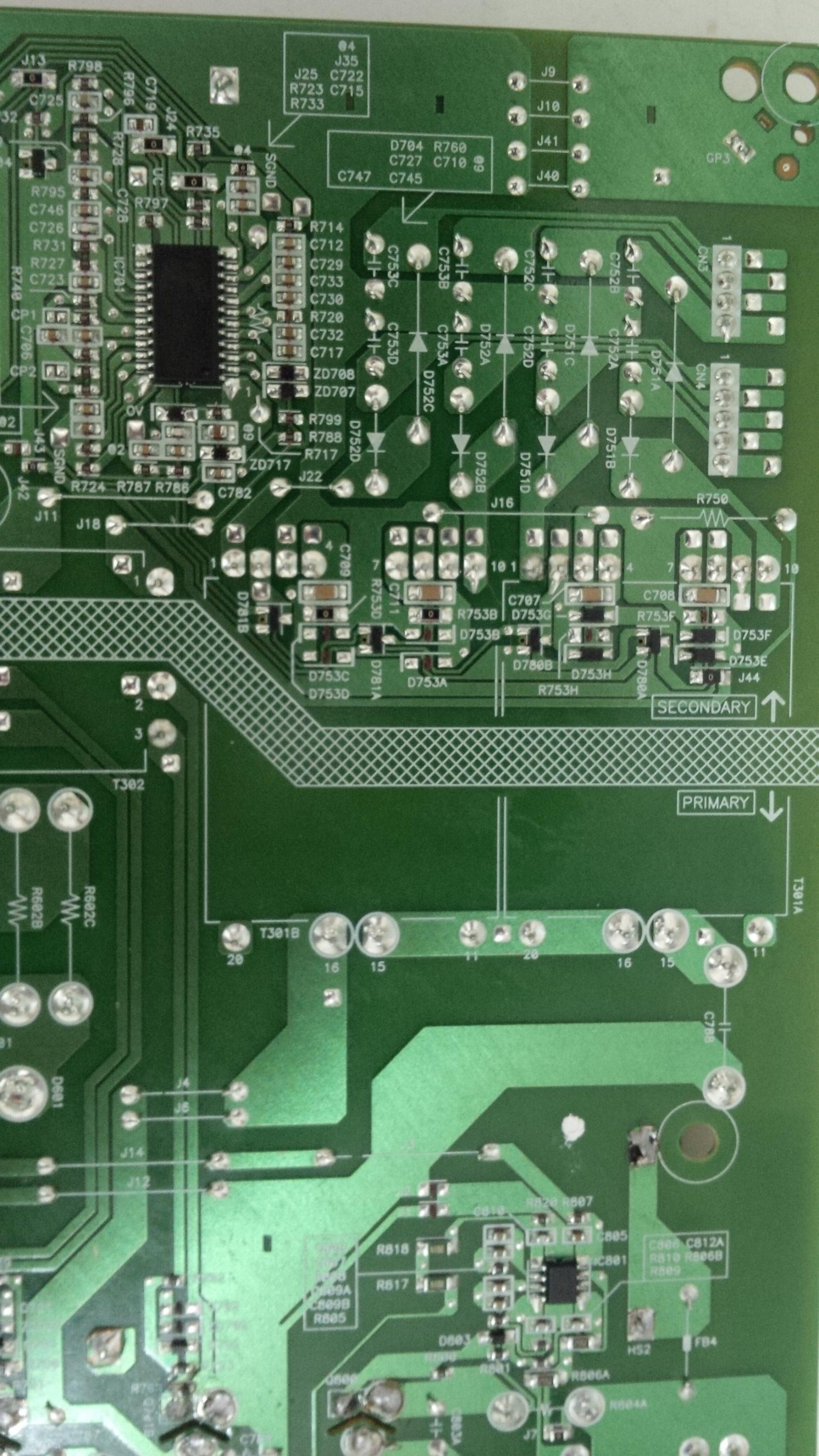

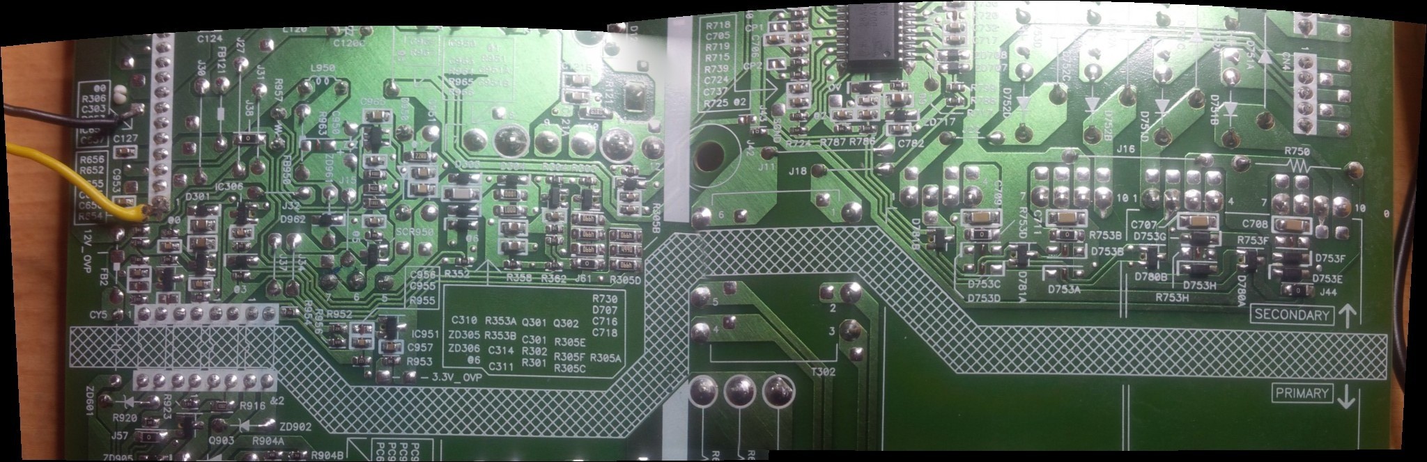

                            Ok, I've tried again. It looks a bit better bit still spanned across 4 images unfortunately to try and get some detail.

                                So you still have low 6.6 Ohms on the pad, that is where you have to find out why.
                                  #36
                                  Lift one leg of the jumper J29 and read the resistance between VCC pad and GND pad to see if the 6.6 Ohms reading goes away.

                                    i lifted the leg of J29 and the 6.6ohms is gone. i might try lift legs or remove IC902 to see if that makes a difference.
                                    i removed IC902. now i've got 17volts at IC901 primary side and 3.343 standby on the secondary side
                                      #38
                                      I see that IC 902 uses the VCC that is used by the ICE. so now you need to get the new IC902.
                                      So what happen now when you try to turn on the TV? We may be able to fool the circuit to make it thinks that IC 902 is working.

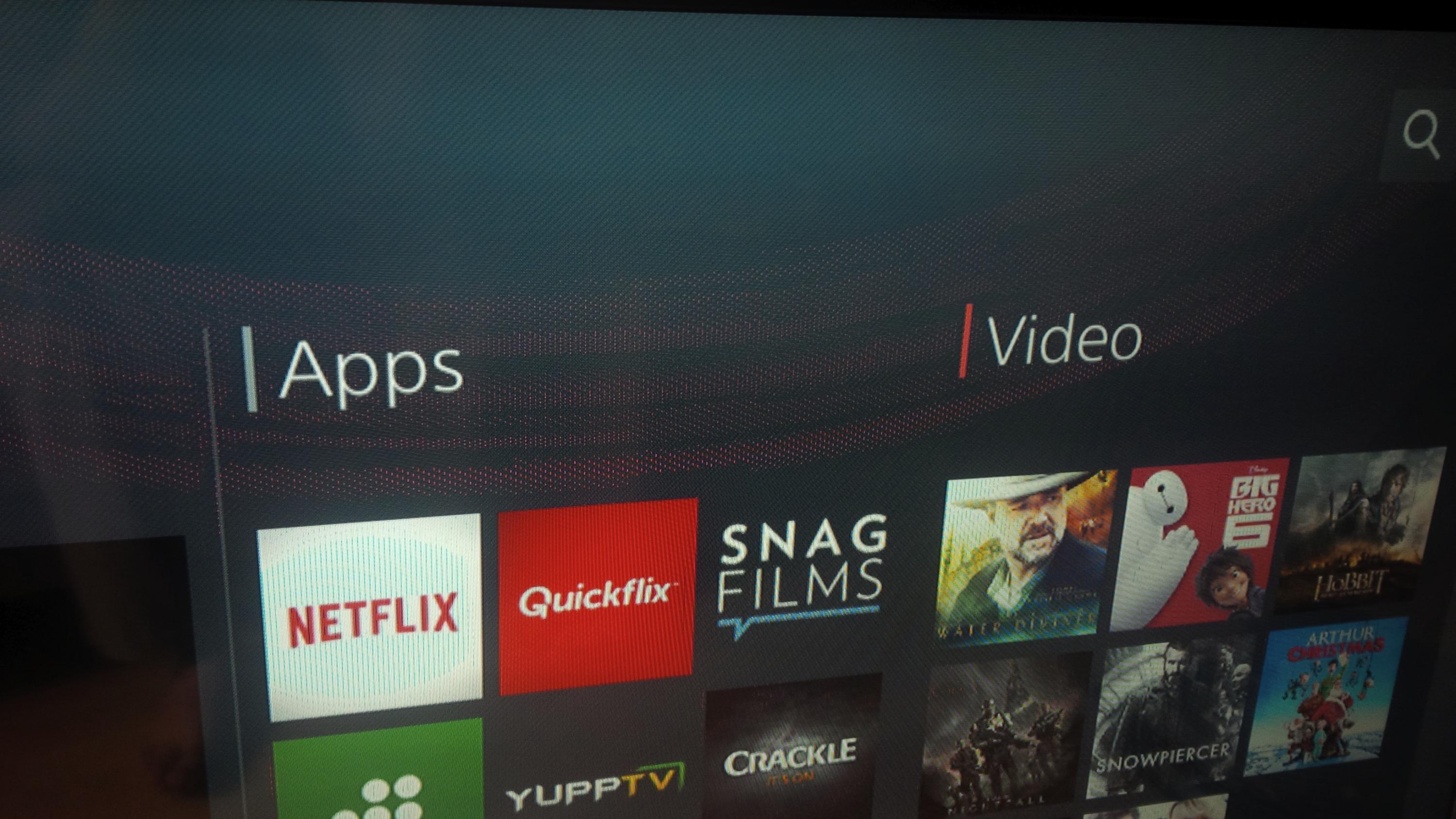

                                        hi mate,
                                        the tv turns on now, although initially it had a 5 blink error.
                                        i pulled the tcon board and found some of the pins on the biggest chip were bent. i straightened them out with a razor blade as best i could. i tried powering the tv on without the tcon and it was late but i think it was still blinking but i was able to turn it on with the tv remote and the light changed to green and the backlight came on.
                                        reconnected the tcon and it is working but with red dots. the photo makes it look much worse than it is. its not super noticeable when watching the tv.
                                        at this point i wouldn't be surprised by anything. the guy i got it from said it worked then he went to bed, woke up and it didn't turn on.
                                        the boards inside were all marked with the model number in marker, like you see them for sale used on ebay, held in by minimal screws, and the t-con has clearly been roughed up a bit.
                                        Last edited by t4796; 04-29-2015, 09:25 PM. Reason: photo was upside down miss jane
                                          #40
                                          At this point I wonder if the correct boards/board versions are installed. It is tough when someone messed with it before you.
                                          At least now you are getting the pictures on the screen, more progress at least.
