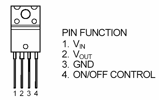

    This guy seems to have it , looks like it is a KIA78R12API, also KA78R12 (case TO-220F-4L) lift your heat sink and read the number

          After re-reading the problem. Your problem is that there is no voltage to turn the q7120 on, correct? that would mean the regulator is not necessarily bad. but you are just bypassing it to make the tv work.
          I suspect this ic is installed with the back facing the heatsink and the front (with the number) is facing the board, so you have 13.3 on the Vin and 0 on Vout and pin 4 control only has .13 so the problem is why there is no control voltage to turn on the ic not that the ic is bad
          It looks like you need at least + 2 volts on pin 4 to turn on the ic.

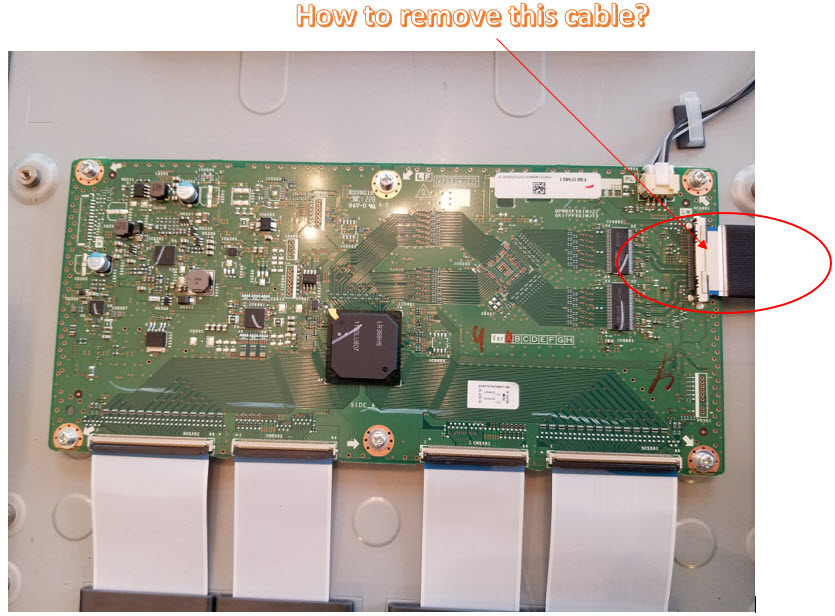

                      Hi, my first post. Found this thread. I have Sharp 70" TV, model LC-70LE847U. I believe the tcon board is defective based on what I've read here, research, and testing you suggested in this thread. My tcon board is model DUNTKF961FM01, it has 4 ribbons to the panel which I found easy to remove. There is one other cable however, I believe called LVDS, which I can't figure out how to get loose. Attached is a picture. Any help is greatly appreciated, thanks!

                        Before trying to remove the cable, what DC Voltages do you have on that PL connector of the T-CON board?
                        What Voltage testing have you to done so far?
                        BTW, the cause of the problem in this thread is due to the main board not sending the PL_ON signal to turn on the SWITCHED LDO regulator to supply the 12V to the PL connector on the T-CON board to run the T-CON.
                          In my case I replaced the PD unit to fix the problems.

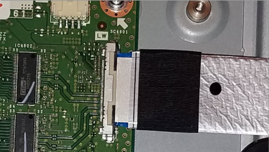

                                      My Sharp LC-70UD1U Screen is black and flashing, "I attached the video"
                                      Well, I opened the back cover and as you can see in the picture, I detached 2 [L] Ribbon then TV turned ON, but detached side is white and attached side is normal
                                      * When I attached [L] side Is goes to error code 2-5 blinking.
                                      * I attached two [R] ribbon alone, but it goes to error code 2-5 blinking.
                                      Does anyone have any solution?

                                        Try the "tape cutoff" method, can put it in the search box above to find threads.
