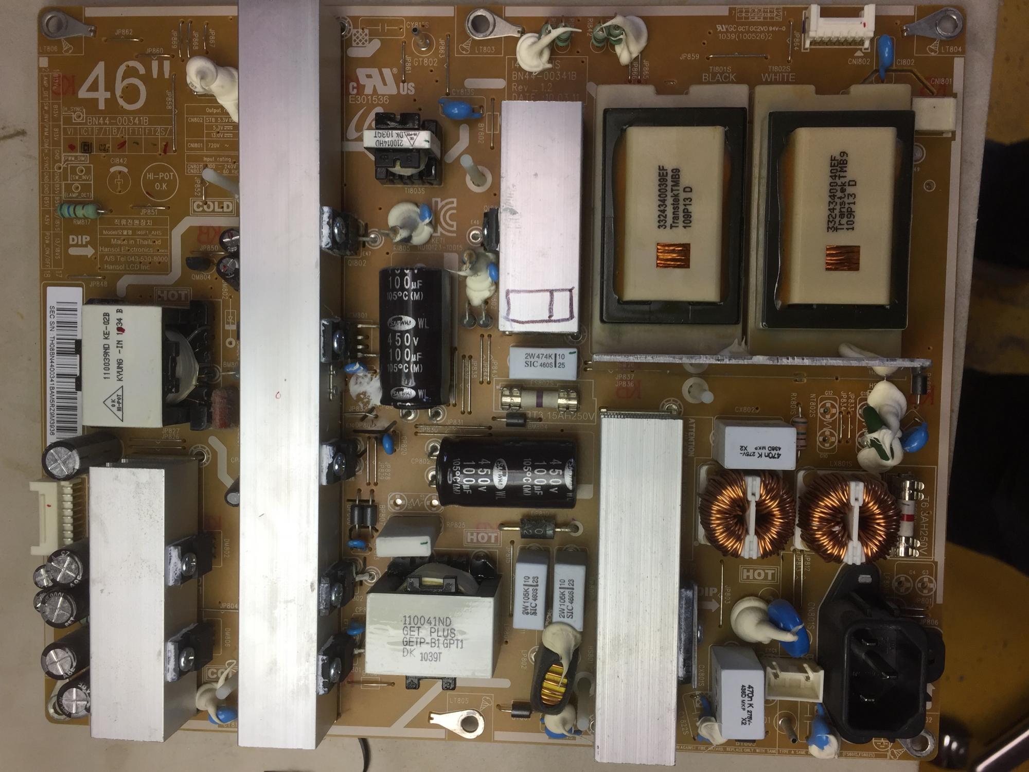

Is this the power supply/inverter board used in your TV?

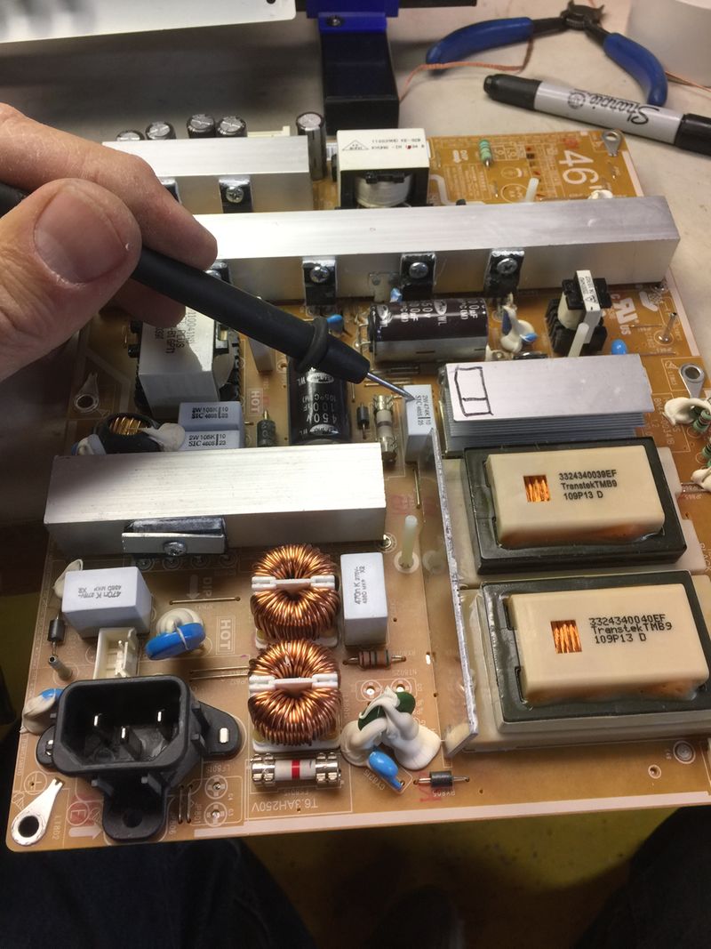

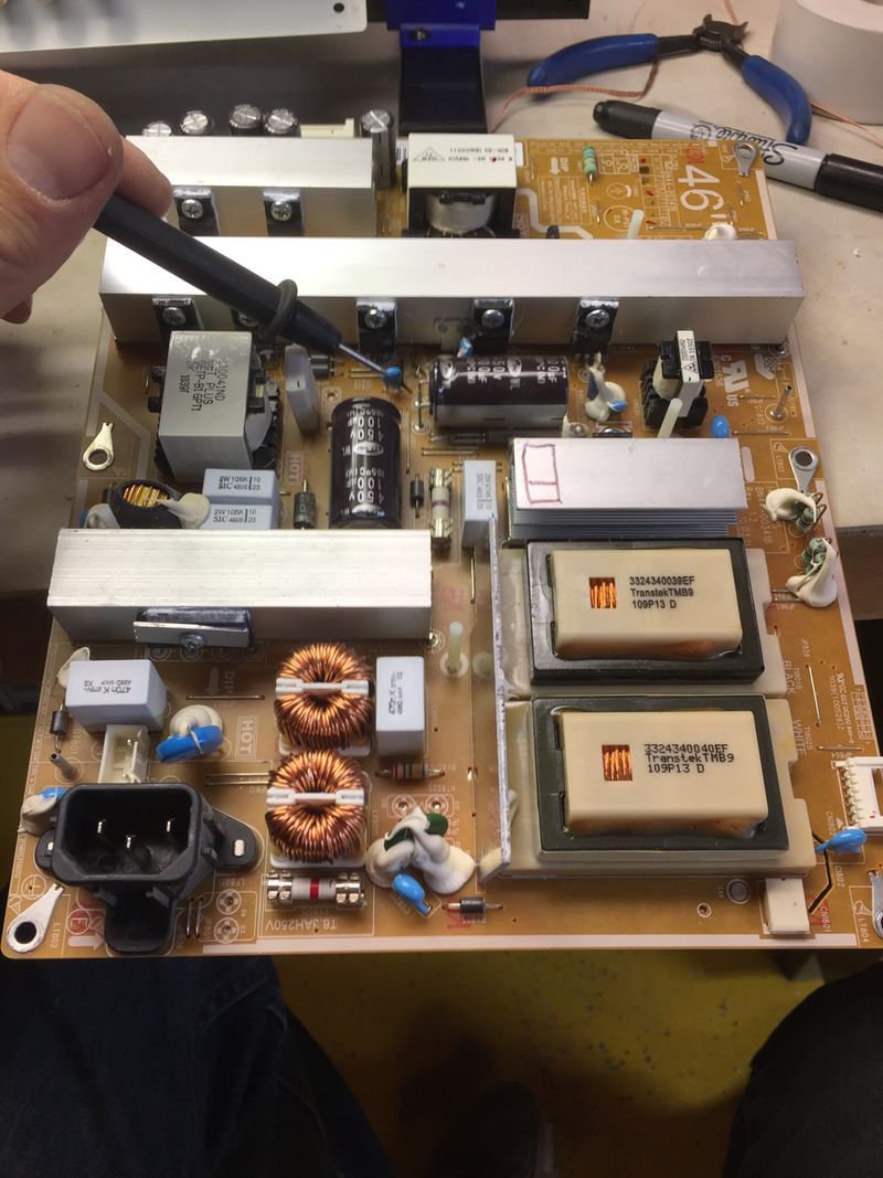

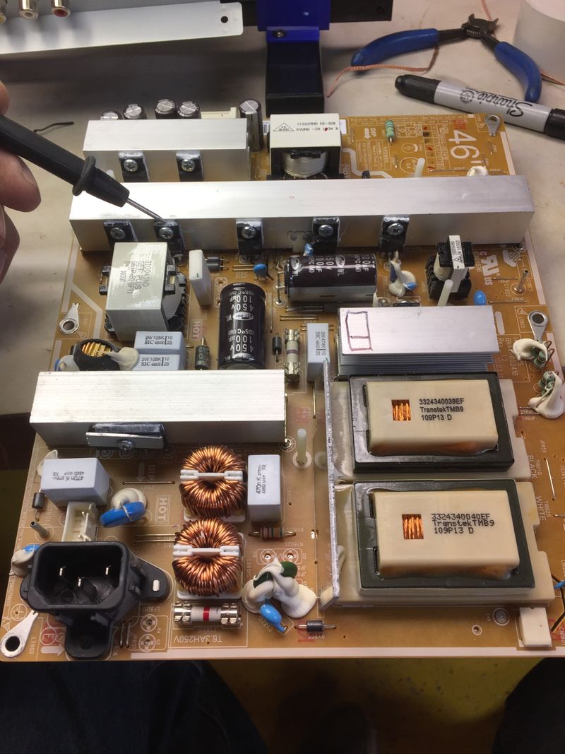

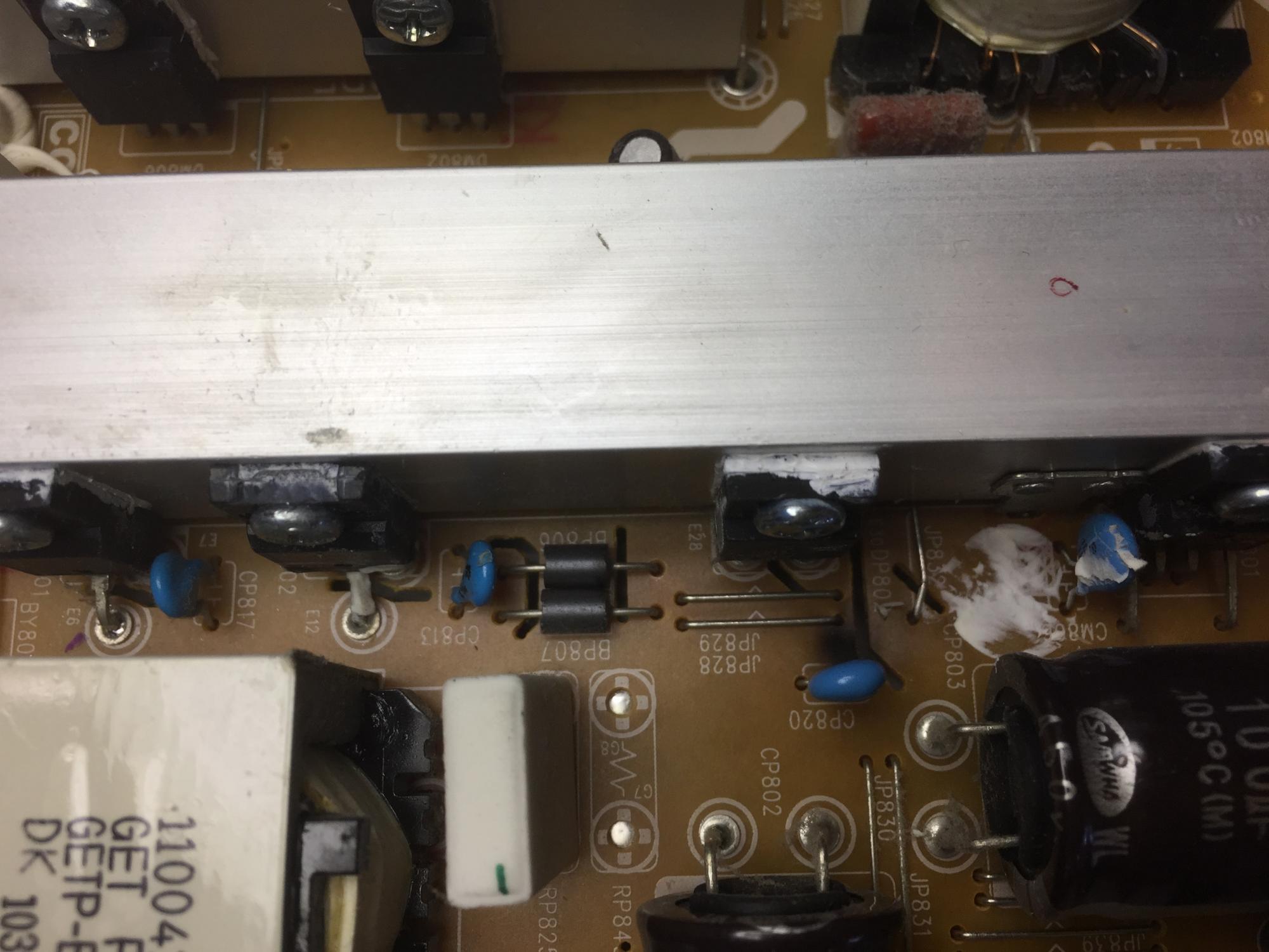

I have similar issue with this tv .I had main fuse blown.After replacing one of those blue caps blown apart(Probe pic indicates which one) and shorted mosfet 13mn60n(Probe pic)
The backlight come on for a second or so and goes off.Attached Filesif you find these attachements useful please consider making a small donation to the site

So the parts in the PFC Voltage booster blew up and you replaced the blown parts, but are you now getting 380 ~ 400 VDC between the two legs of the main filter cap when the TV is turned on?
Power supply/inverter board: BN44-00341B.
This board is know for having low PFC Voltage and causes the backlights to flicker, the problem is caused by bad resistor network int he PFC Voltage feedback, but some people fix it the wrong by by cutting jumper J852 which defeat the LOW PFC Voltage shutdown protection circuit.
CI818 also goes bad and will have low capacitance and some time you can see it bulging on its side.

If your voltage isn't getting the 380-400 or so, try replacing those four resistors that nelic6 did, with same value ones he used, it's post #22 of the link budm gives in post #14, looks like that fixed it.Comment
