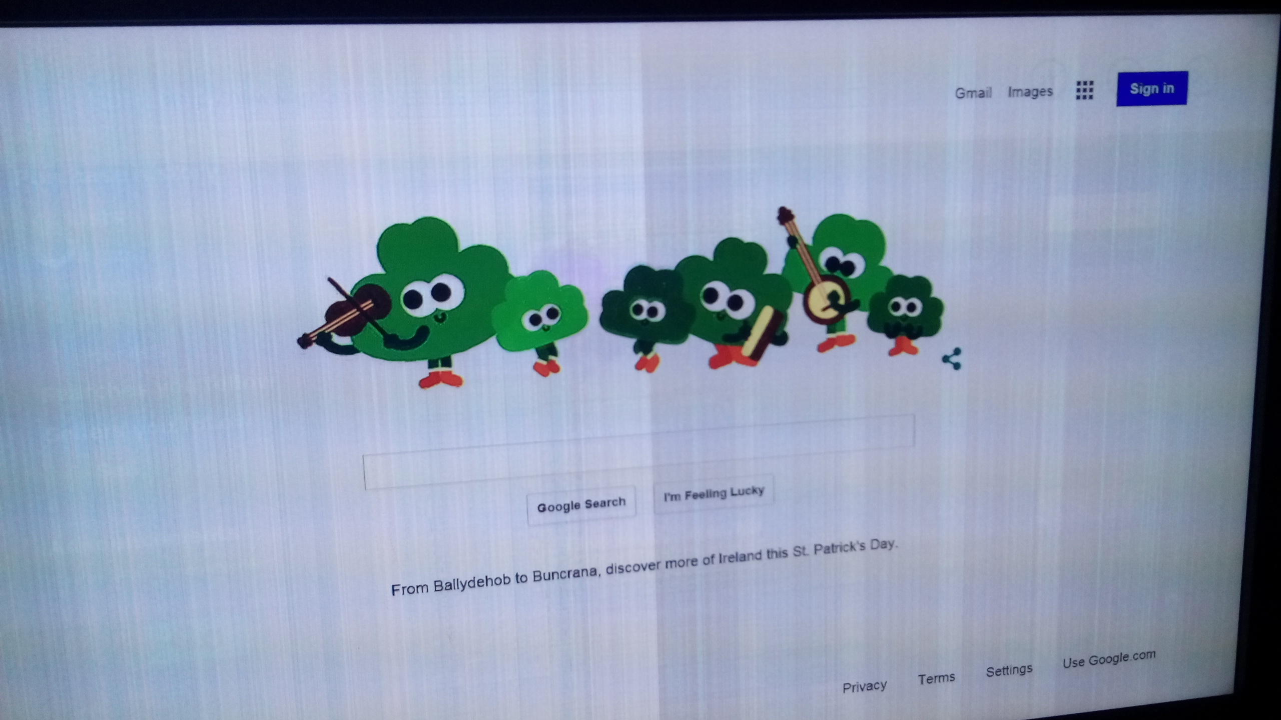

    Hi guys so I contacted emos TV
    And they are trying to say its a tab bond issue
    Now I've tried pressing on the tab bonds gently and the screen don't change in anyway
    Does anyone think this is a tcon issue PIC attached

      Another update guys
      As I've not got a voltmeter at the moment I disconnected half the tcon board from the screen by removing the left side ribbon cable and the right side of the image is good and the left goes black
      When I do the same with the right side I get a negative image on the left and a black half on the right
      Is this the as15-f chip ?
      As emos want me to return the replacement tcon for troubleshooting
