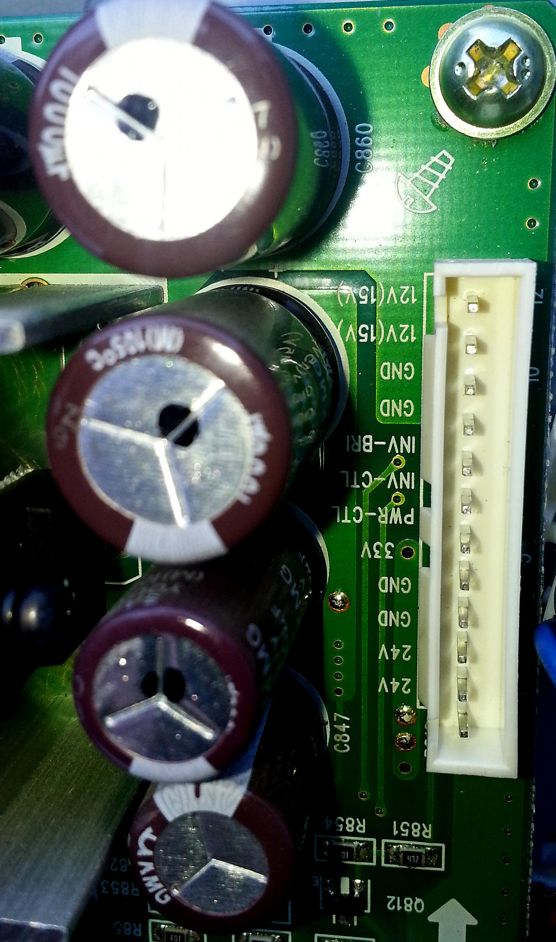

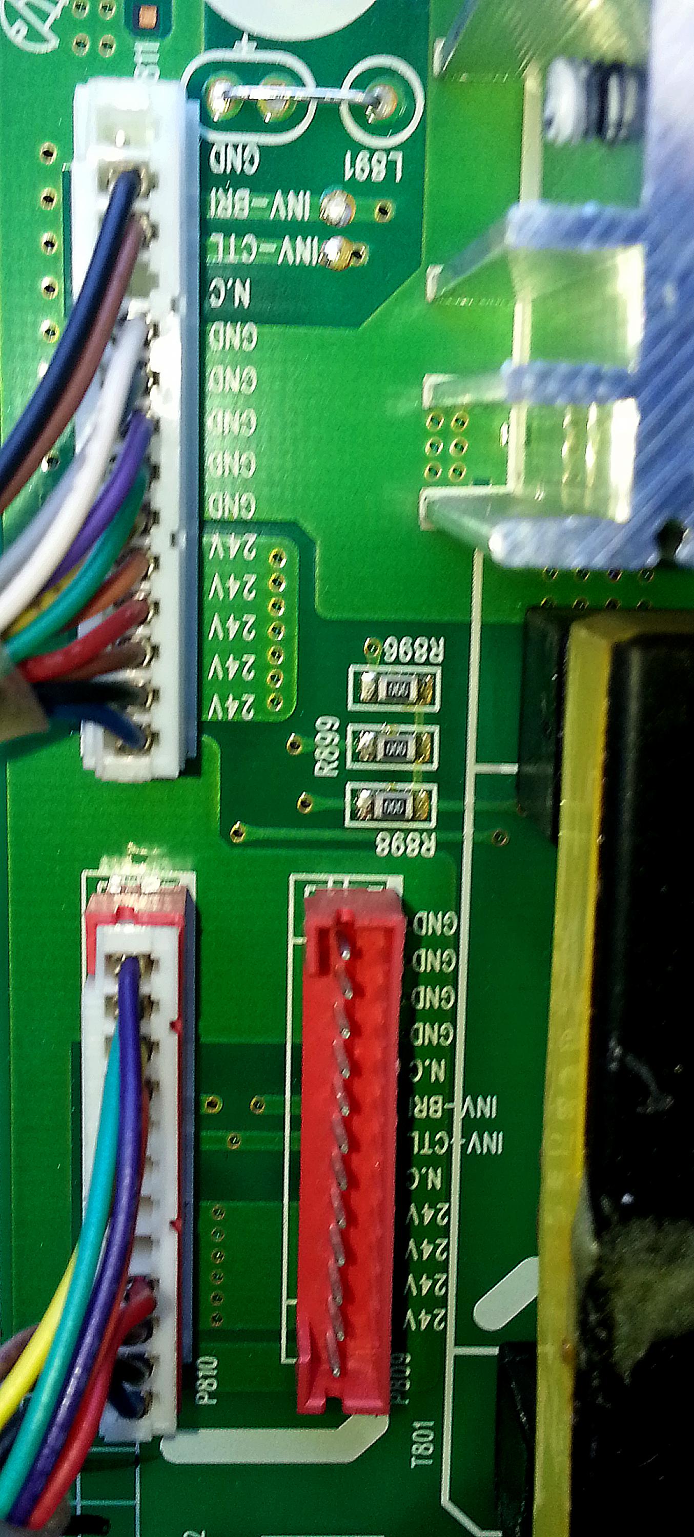

                  Re: LG RZ-27LZ55 momentary backlight
                  Hi Guys,
                  I've just uploaded some close up pictures of the connectors on the power supply and a connector going to the main board. The connectors have different labelling compared to Capseek's instructions. No STBY or PSON labels. Would someone be kind enough to point out which points I should connect the 1k resistors in my particular case? I will be removing the main board connector and use that side of the connecters to push the resistors into. Is it ok to do so?
                  Does the wattage of the resistors matter ? I don't have any !k resistors and will have to pick some up locally.
                  Why does the power supply have 33v ? is it really 33v or is it 3.3v.
                    PWR-CTL (Power Control) = PS-ON (Power supply ON)
                    INV-CTL (Inverter Control) = BL-ON (Backlights ON)
                    INV-BRI (Backlights Brightness) = Backlights Dimming Controll, Note: there is no indication to tell us if it is PWM-Dimmimg (Pulse Width Modulation) or A-Dimming (Analog)
                        The 33V may be for the electronic tuner, if it is 3.3V it would have been labeled with 3V3 not 3.3 since sometime the DOT can be hard to see.
                        1/4W is more than big enough, just be sure to remove the wire/s going back to the main board before forcing on since we do not want to back feed the force on signal back to the main board.

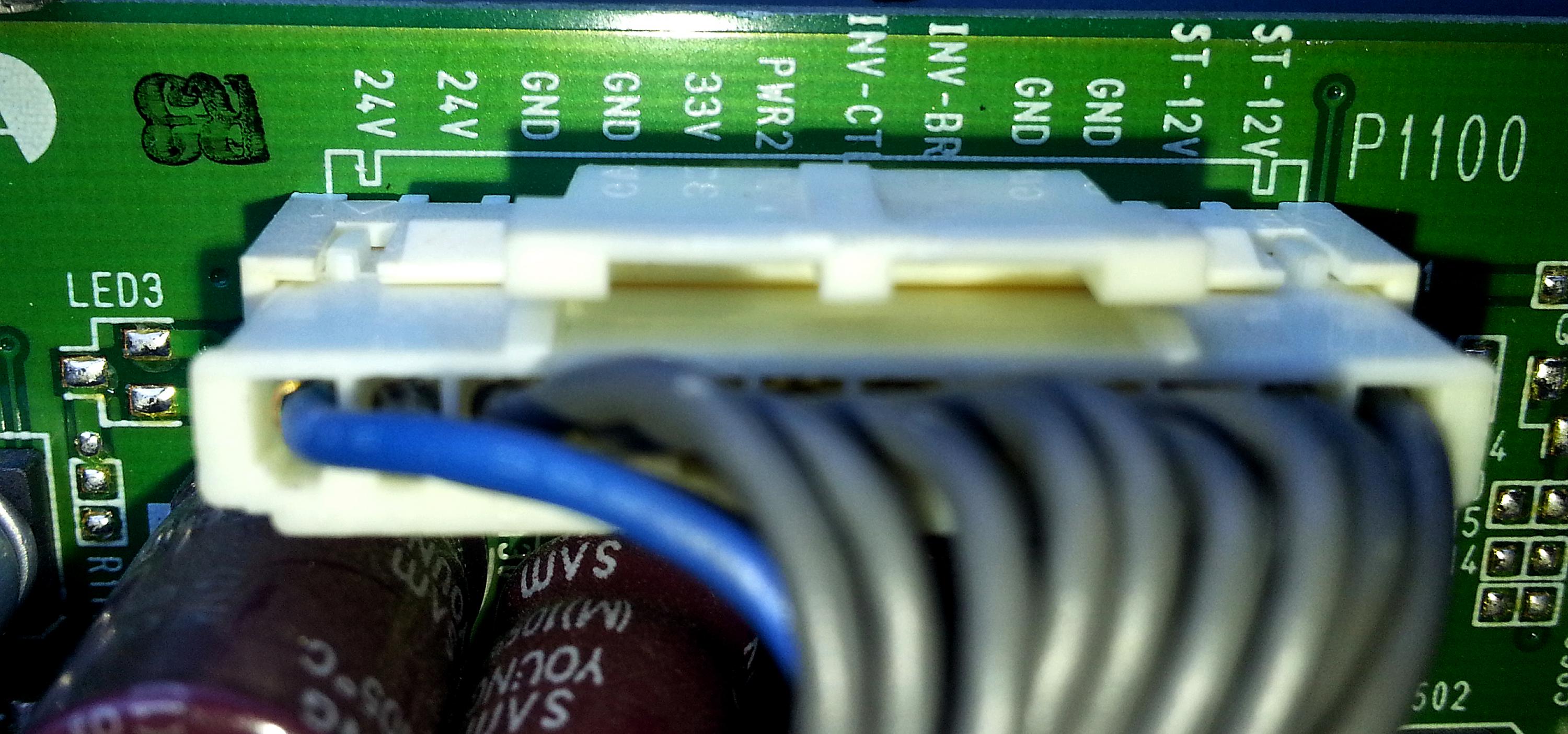

                            I have got a couple of resistors ready to go now. But I am confused where my standby is.
                            The connector does not show Stby? Or 5v stby.
                            There is another connector on the main board that shows ST 5V if I follow that connector back to the power supply it goes to an area near the primary side of the power supply where there is an IR jack and rs232 port. There is a printed white divider line that may be indicating that it is on the cold side of the power supply.
                            I'm a little confused and thought it best to seek advice before I blow anything up.

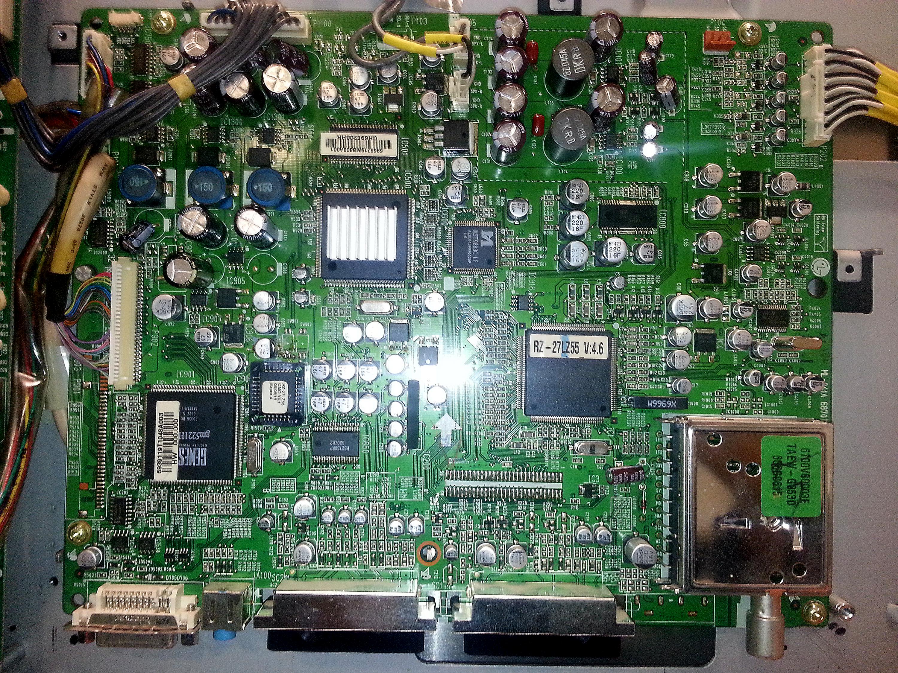

                                OK, before doing the force on, we need the pictures of the whole back side of the TV.
                                I see that it has read connector and white connector with 24V and inv control lines, also other two connectors with PWR-CTL and PWR2, so I need to see which connector goes to the main board and which connector is not used.
                                  https://www.badcaps.net/forum/attach...5&d=1426004736
                                  Is this the connector on the power supply board or on the main board?
                                  If is on the main board then what DCV do get on all those pin when TV is OFF and when power switch is activated?
