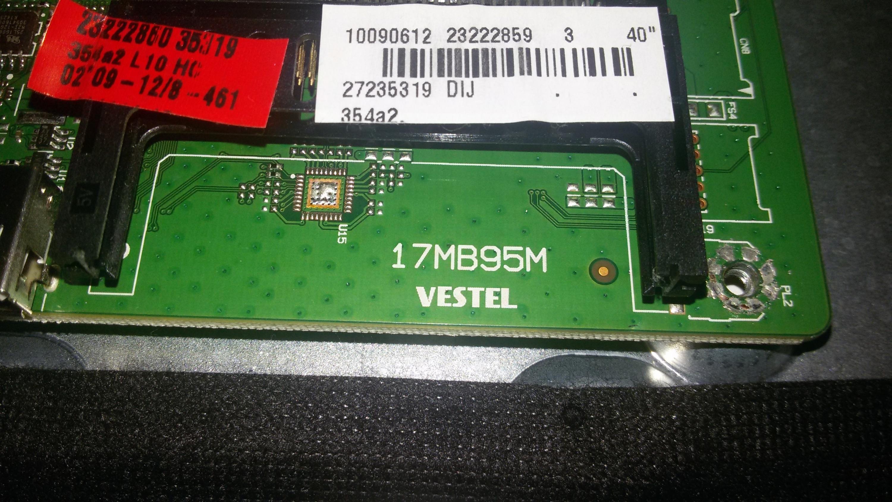

                      Re: Bush (Vestel) led40127fhdcntd - turns off and on repeatedly
                      Hello!
                      I have TV POLAROID 3-40 LED 14 with VESTEL 17MB95M
                      After connecting to ethernet and Runing NETFLIX it was crashed..
                      TV not power on. only the power LED flashing continuously. remote control not reaction, picture is black (only every 30 second period switch ON backlight for 5 second). sound is epsent.
                      I download firmwire from BADCAPS.net FAQ
                      1. usb_auto_update_A1.txt
                      2. mboot.bin
                      3. mb90_en.bin
                      Write to USB Flash FAT32
                      insert to Upper USB in TV
                      Press OK on remote control and switch ON TV
                      after this TV is black all time without backlight.
                      Can you help me to find firmwire for it ?
                      and how can i flash it ?

                            Are you sure it a firmware fault ? Have you checked your Psu voltages ? The firmware will normally never crash while the set is on.
                              Pretty sure this is a software fault. These sets run Linux and could easily corrupt and crash while on and accessing interactive stuff like Netflix.
                              I've got some mb95 software but not one that will match your panel lsvserg83. Hopefully someone else on the forum can provide one that matches.
