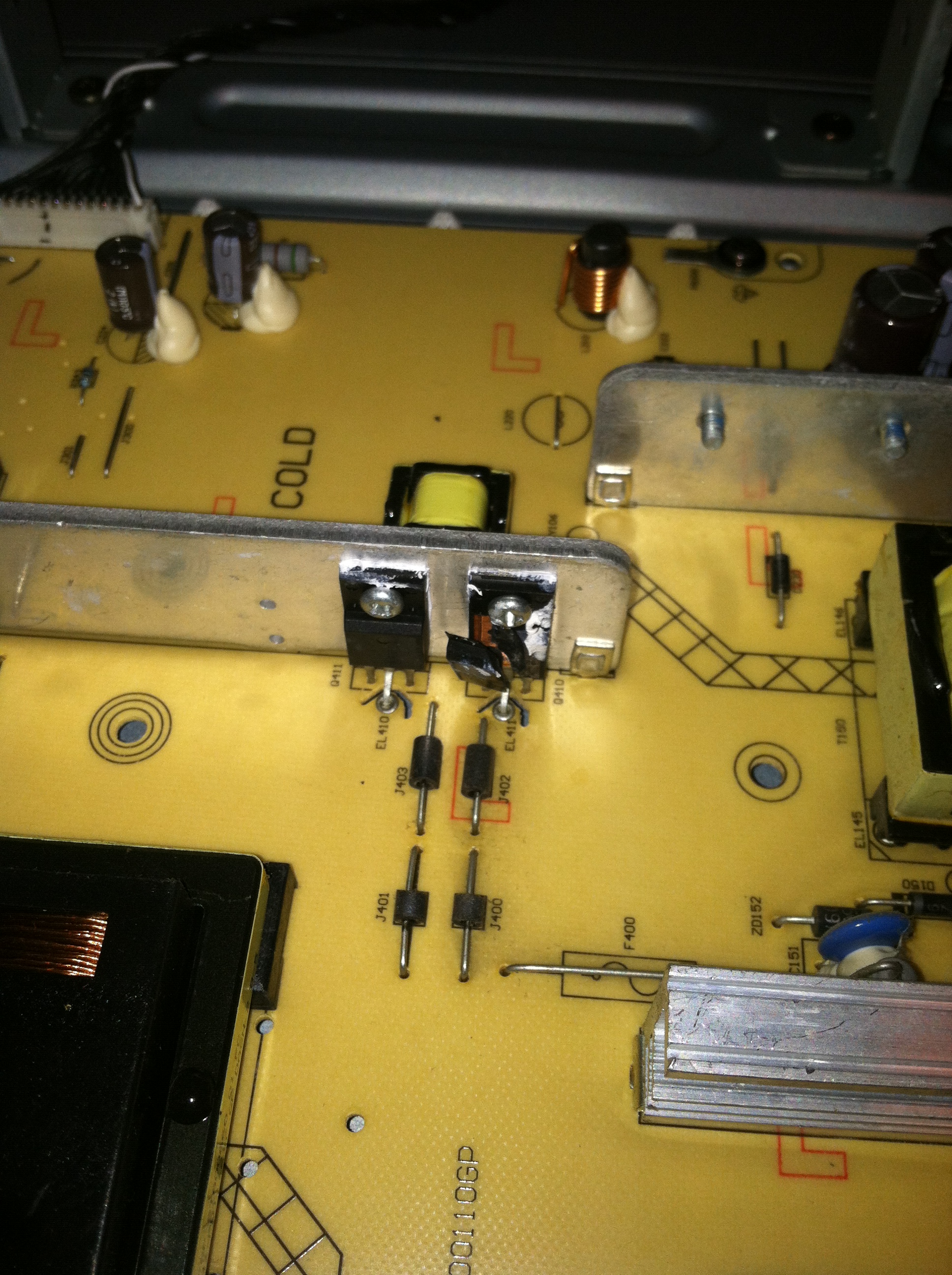

    Picked up a Vizio E3D470VX and the guy said he heard a pop and that was it. Well when I push the power button the Vizio logo will come up and go right back off. Can still turn it off and on with power button. Took the back off and this is what I found. The mosfet is popped open and apart. Could this be the problem? The number on the mosfet is NDF05N50ZG. I looked the part number up and this is what I found that it is a MOSFET NFET T0220FP 500V 5A 1.5R. Can someone search on radioshack.com for mosfet 500v and see if what they have will work. Please reply soon.
  • MagicSmoke
    • Feb 2011
    • 275
    Re: Need help with Vizio E3D470VX
    Digikey has the exact part you need. http://www.digikey.com/product-searc...GOS-ND&stock=1
    .94$ for one.
      You need to find out if the Gate drive circuit is direct drive to those two MOSFETs, if it is, then you will need to replace the driver IC and the Gate drive components.
      You need to check them out real well otherwise you will blow up your new parts.

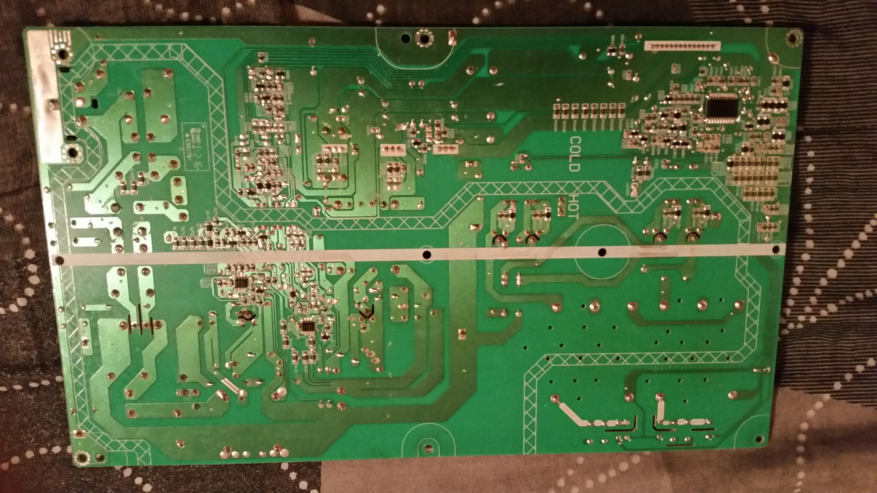

          post a pic of the back side of your board.
            Good clear straight shot pictures of the whole board, both sides.
            • joeshannallie
              • Dec 2013
              • 103
              • usa
              Here is the pic, best I could do. No burnt marks or anything on the back side of the board.

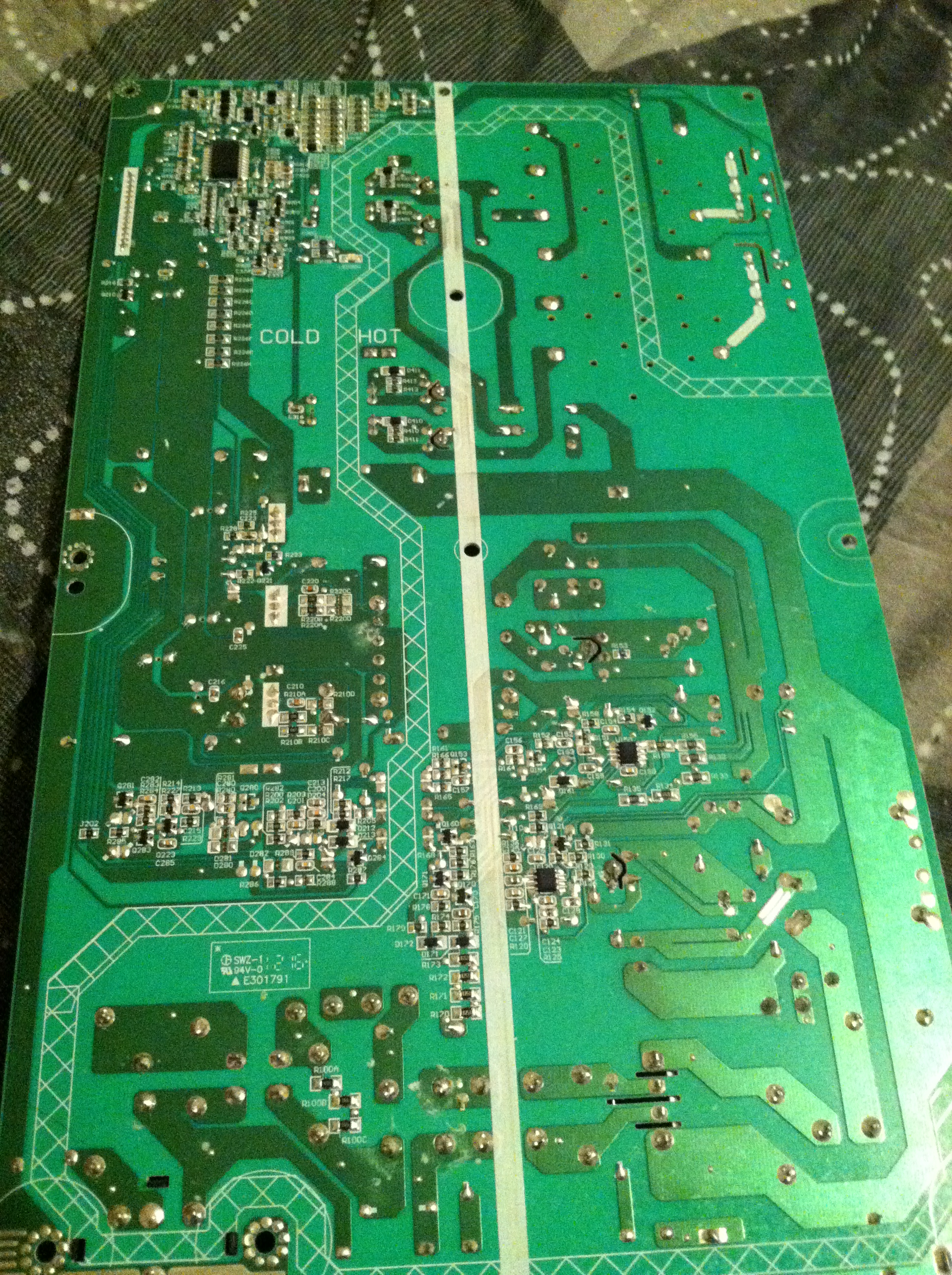

                Lets try again.
                  My post #6 "Good clear straight shot pictures of the whole board, both sides."
                  I need to be able to see the traces so I can trace the connections from point A to point B,
                  I do not have the board in front of me to see.
                  What can be done when good clear pictures are provided:
                  https://www.badcaps.net/forum/showpo...5&postcount=35
                  https://www.badcaps.net/forum/showpo...9&postcount=12

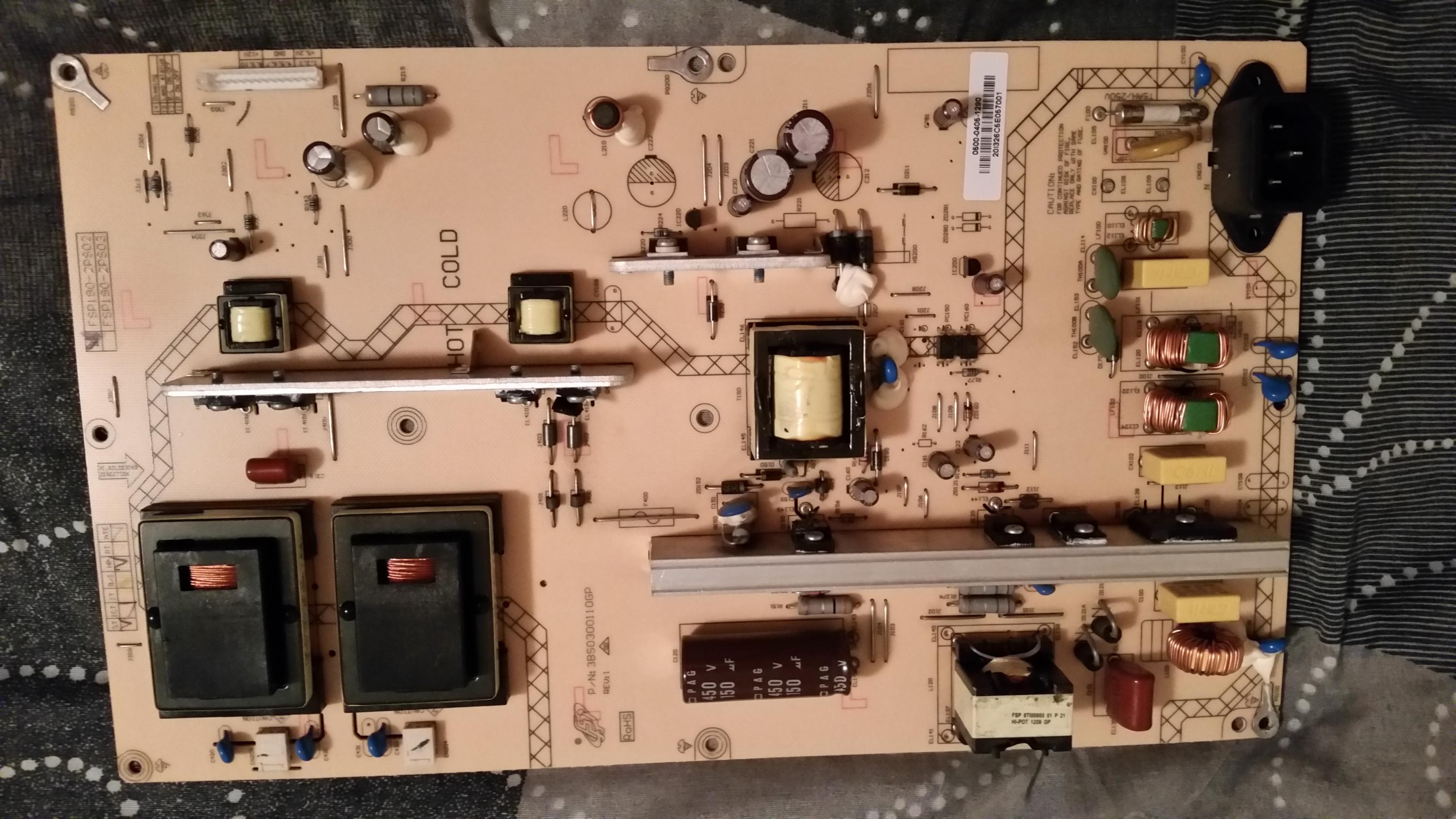

                    I will upload some better ones in a few minutes.
                    • joeshannallie
                      • Dec 2013
                      • 103
                      • usa
                      This the best I can get, I really appreciate you Bud
                        OK, it is transformer coupling for driving the MOSFETs, on the GATE pin, there are 3 components (2 resistors, 1 diode)connected to it, check them out.
                        Look up the spec of the MOSFET to get the pinout.
                        BTW, there are FOUR MOSFETs,
                        Too bad they install a jumper wire in place of the fuse F400 which feeds B+ to that inverter circuit.
