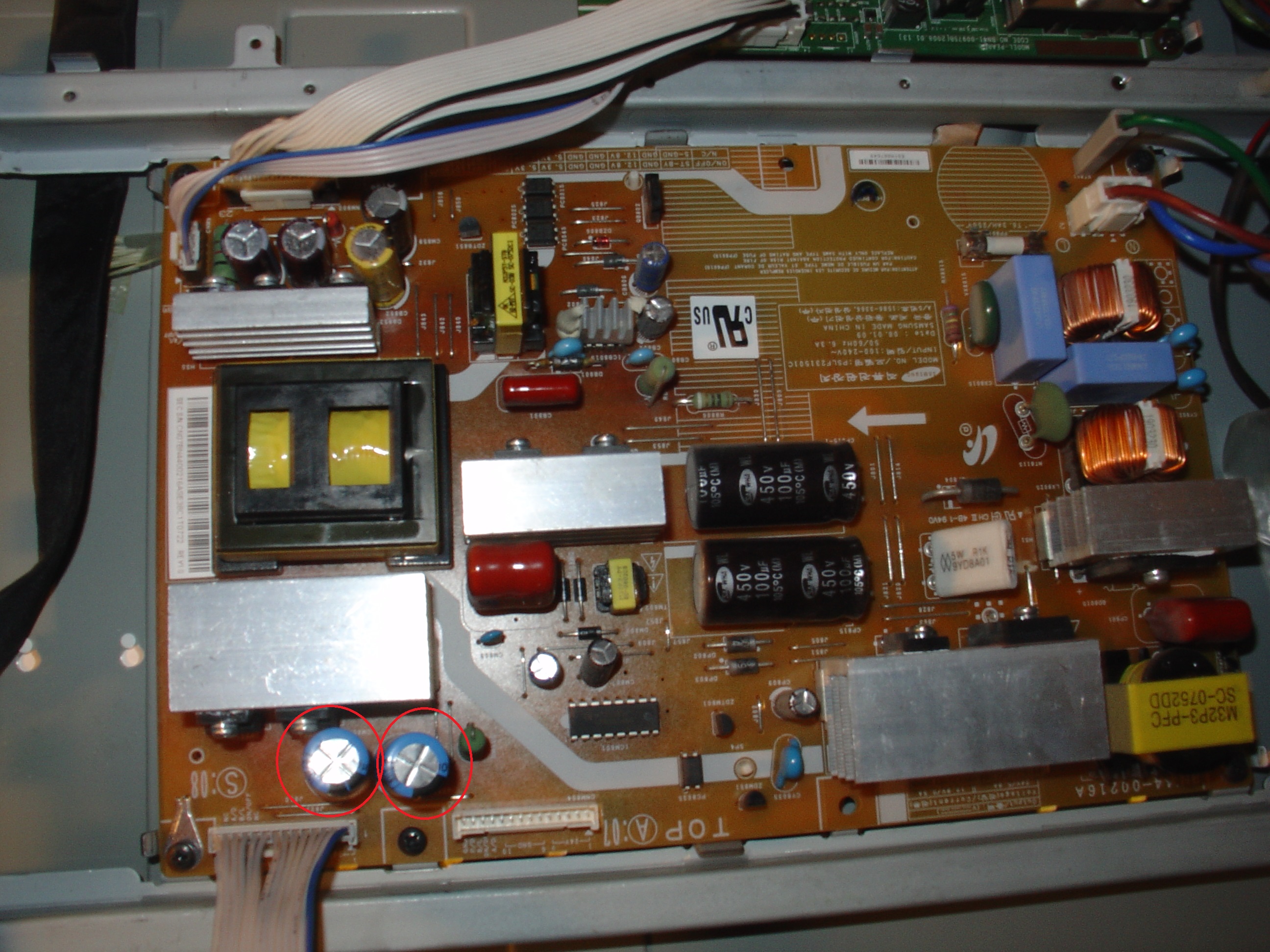

    Samsung LN37A550P3F replaced Caps, white screen only
    replaced 2 Caps that were bulging and screen is steady but only displays a White screen in all modes
    any advice on what to check and replace next?
    1st pic circled in red are the 2 bulging Caps i replaced
    as always, any help is greatly appreciated

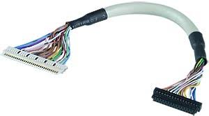

            Re: Samsung LN37A550P3F replaced Caps, white screen only
            White parts of LVDS cable clean with alcohol
            Cable from main board to T-con
            https://encrypted-tbn2.gstatic.com/i...zgDJyp4WHLrwyQ

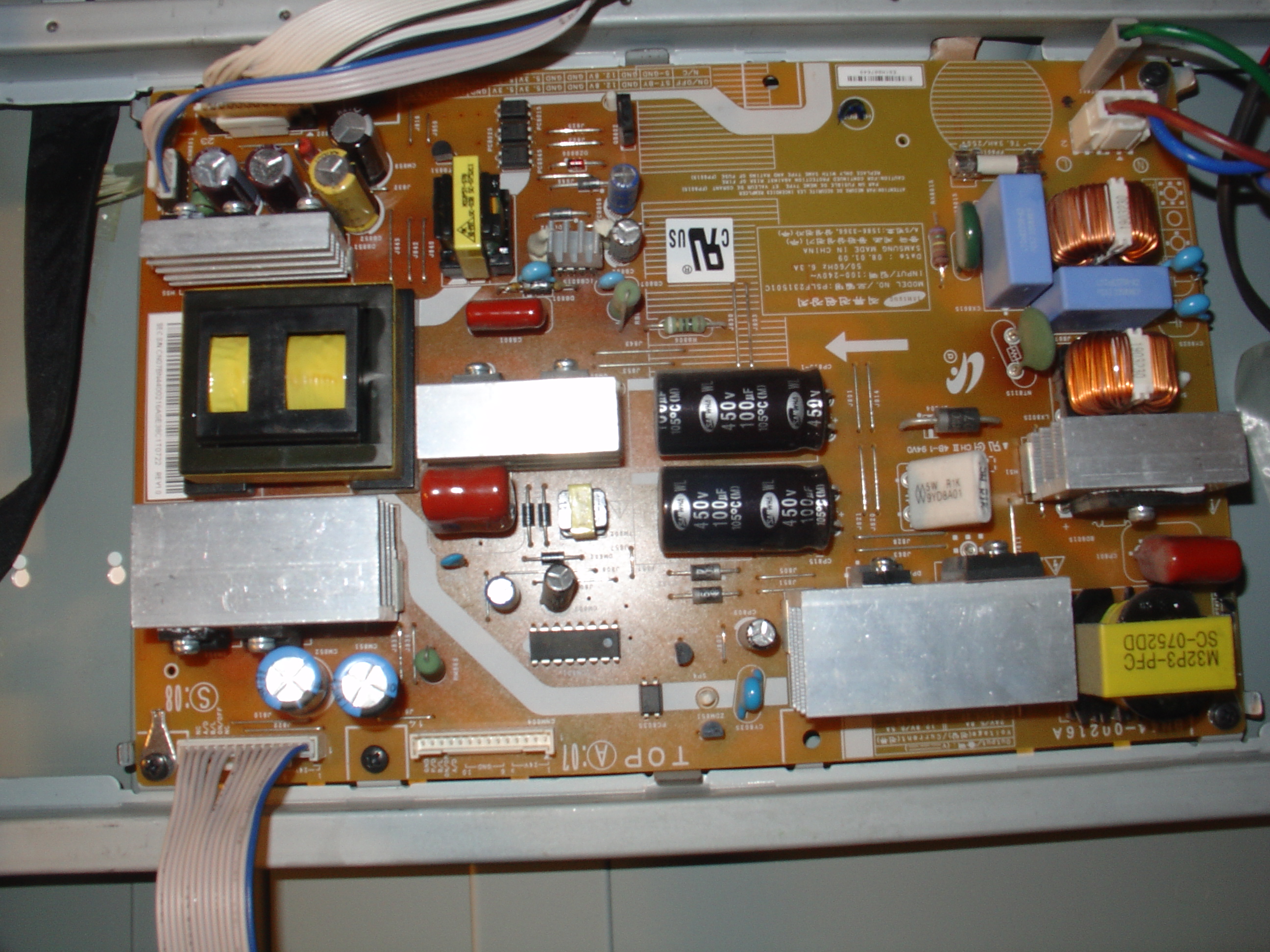

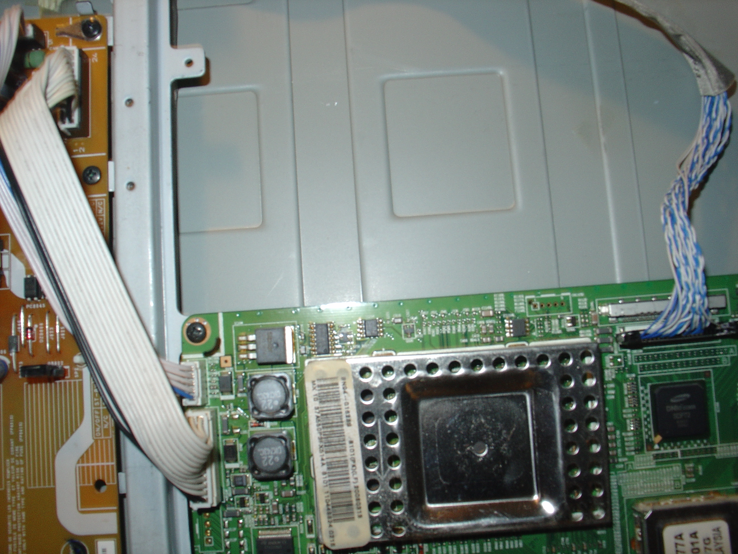

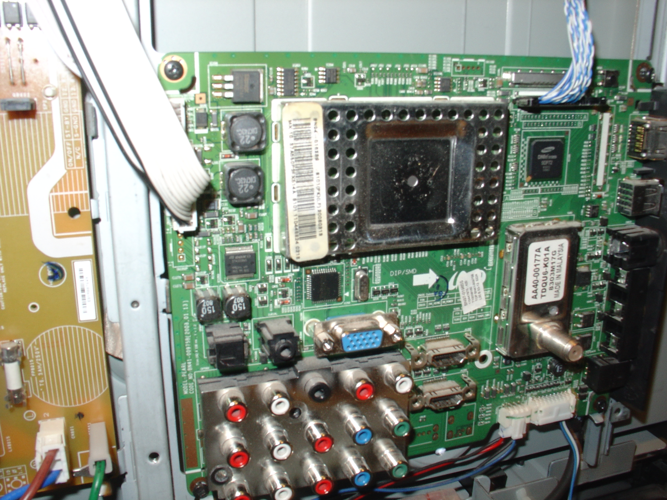

                      Can you get a good clear pic of the T-con board?
                      • GR3Y5H3ART
                        • Jan 2011
                        • 146
                        update, finally had some time and got my digi cam fixed to take some clear pics of the Boards
                              sorry for not responding sooner
                              long story short, camera broke, had to save for new one
                              1. what it looks like on start up:
                              2. after a while, exactly half of the screen is white and the other side black
                              3. any ideas what else i should check or if its even fixable?
                                I would say that is a bad LCD panel - unfortunately it will not be possible to fix.
