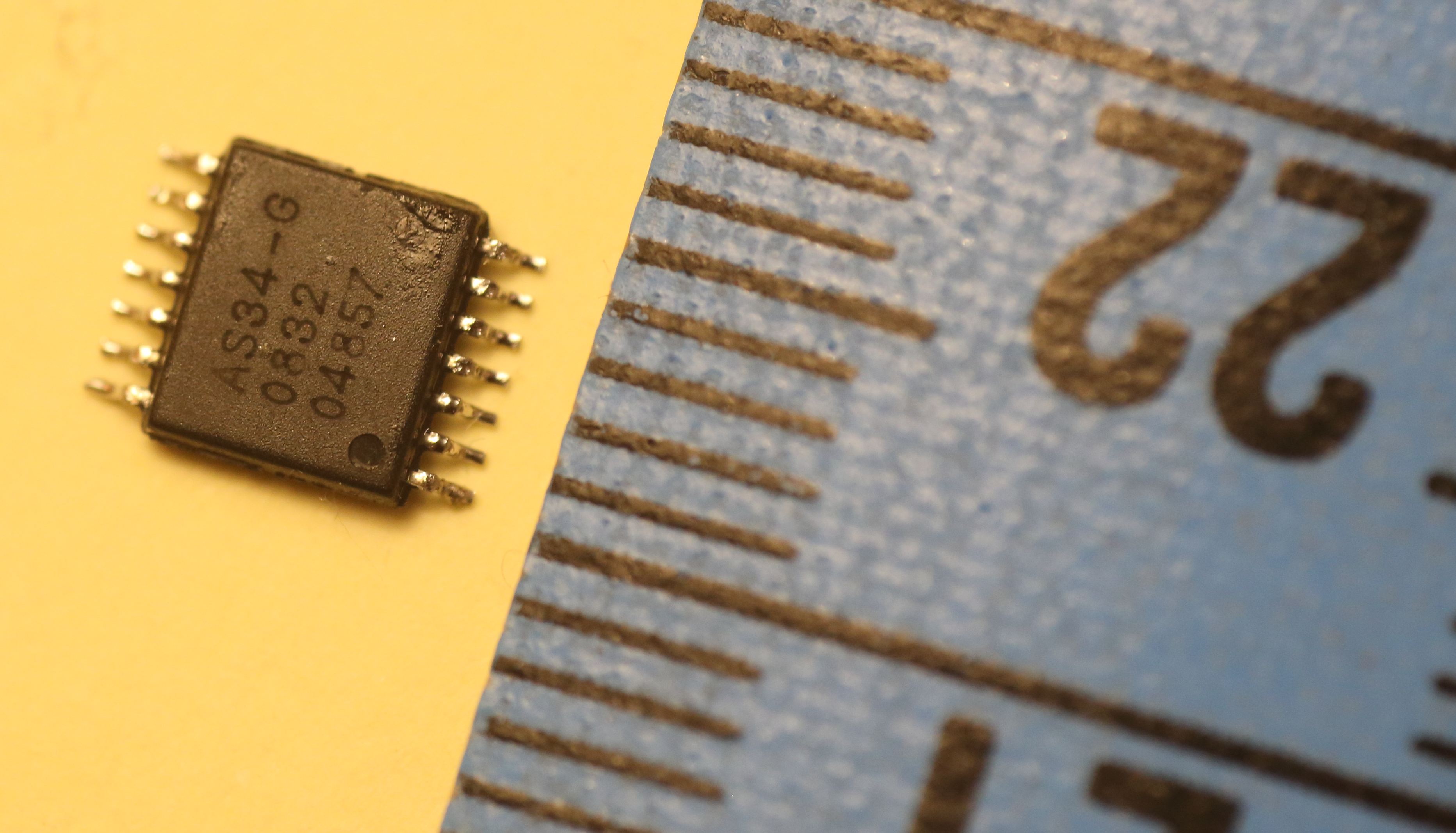

                      Just thought I would share the details of the successful repair. I took the TV today to a local service facility. The guy told me that the issue with the TV is a very rare one. Still, maybe it helps someone.
                      What did NOT fix the issue
                      • Replace the AS15 chip on the tcon board
                      • Swapping the full tcon board (or any other board) with another one
                      • Replacing cables
                      So now, let's skip to the chase: what DID FIX it. Both of the aforementioned "long boards" had an operational amplifier on them each (looks just another IC to me, see images). One of them turned out to be bad. The guy simply unsoldered it from the board and the TV immediately started to work perfectly.
                      I was shocked to see how removing something and not putting it back can solve things, but the guy said that actually there's quite a few things he could remove from the TV set and it would still operate perfectly.
                      He removed the chip on a hunch btw, so there were no measurements that could have indicated that it was bad. He just tried and bingo!
                      Hope this helps someone.

                          Interesting. Appears to be a Gamma correction IC fitted on the narrow panel pcb strip
                            Re: Samsung LE37B650 white screen
                            I cannot see how Gamma Voltage reference IC (AS34-G) can be removed and still getting correct color gamut.

                              We went with the replacement tcon in the end, because the guy ruined the original one in his attempts to replace the AS15 chip on it. So, while I cannot state 100% that the original tcon was not bad, I am pretty sure it wasn't.
                              There was two of these AS34-G chips, one on each side. He removed just one, and told me that the other one will take over.
                              I cannot understand it either. I asked whether there will now be double stress on the single chip, he said no, as it only handles digital signals and not big currents.
                              If anyone knows the answer, please share it here for everyone's benefit

                                Perfect thread, have fixed my 37 Samsung as well.
                                Firstly have seen on youtube a guy saying the problem is on tcon, bought one but the problem remains the same..
                                Only after find this thread and changed one of the as34-g the problem has gone.

                                    Another case of white screen here, succesful case of repair by removing AS34-G. The question was which of them is bad, I desoldered first one and unfortunately it was good, therefore second disassembly and soldering first and desoldering second chip (with front view on the left) led to success. Thanks for THE ADVISE!!!

                                      Thank you,fixed my samsung 37" by removing this ic (as34-g)
