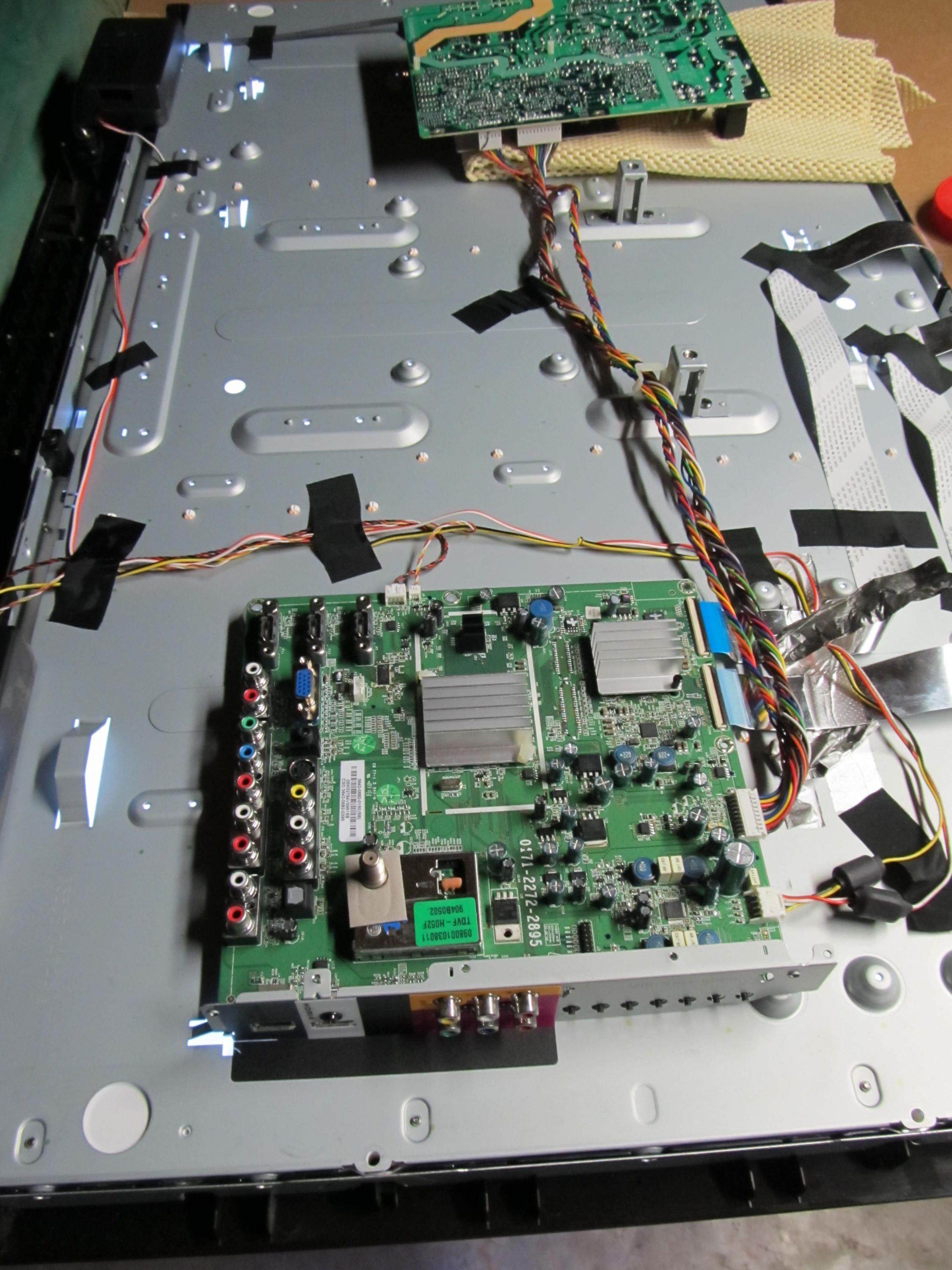

    When I was checking the DIM, as I would touch the red probe to it, it would make the back lights go “dim”,,,,,,,,,,,,,,,,,,but after dimming them several times,,,,,,,,,,,it would then “turn them off”. I would have to unplug the cord, then plug it back in before they would come back on.
    I think whatever is intermittent was/is in the "power board" but maybe I've screwed that board up more. Seems like something was stopping all the voltage from going to the connector pins after I had forced the backlights on.

                Well, there isn't too much left to do. There is no short on the 5V STBY line on the main board, so something is either open and no power is going there where it should or the main chip is fried. You could trace it maybe and see how far you get. Check all the little fuses. I can't help you much further right now, the main board pic is too fuzzy to see anything small. A schematic of the main board would come in handy now. Other than that, unless someone else has a better idea and after the fuses don't yield anything, I'd be starting to look and check how expensive a new main board is and way my options.

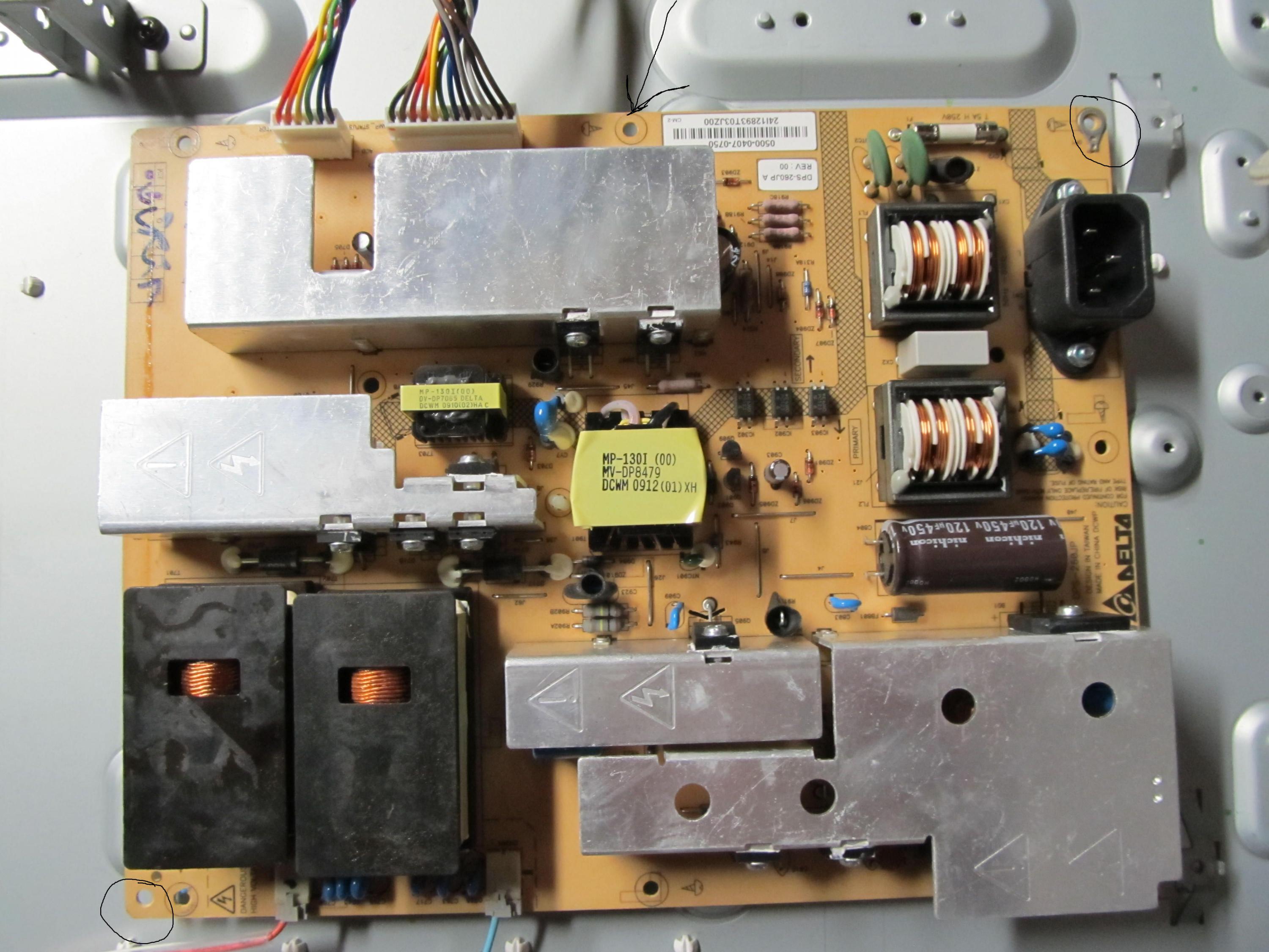

                    Well, I just went down, unsoldered the resisters, turned the board over and screwed it in place. I then plugged in both connectors and plugged the power cord in. Turned on the tv,,,,,,,,,,(white logo), but nothing else (no backlights). Wiggled all the connectors on both boards,,,,,,,,,and nothing. So I decided to recheck the voltages without the resistors and see how they looked. I unscrewed the power board and turned it over, plugged the power back on, hit the on button, and still the same, white logo, no backlights. I started checking the voltage on the 12 pin connector first. I got down to where the 12V pins were and stopped. Came upstairs to print out the page I had just posted on here to write down the voltages. When I went back downstairs, I could see the backlights were ON,,,,,,,,,and I had the picture (no signal) back on the screen. Then only thing I had done was insert the meter between ground and the connector pins. This is driving me crazy!

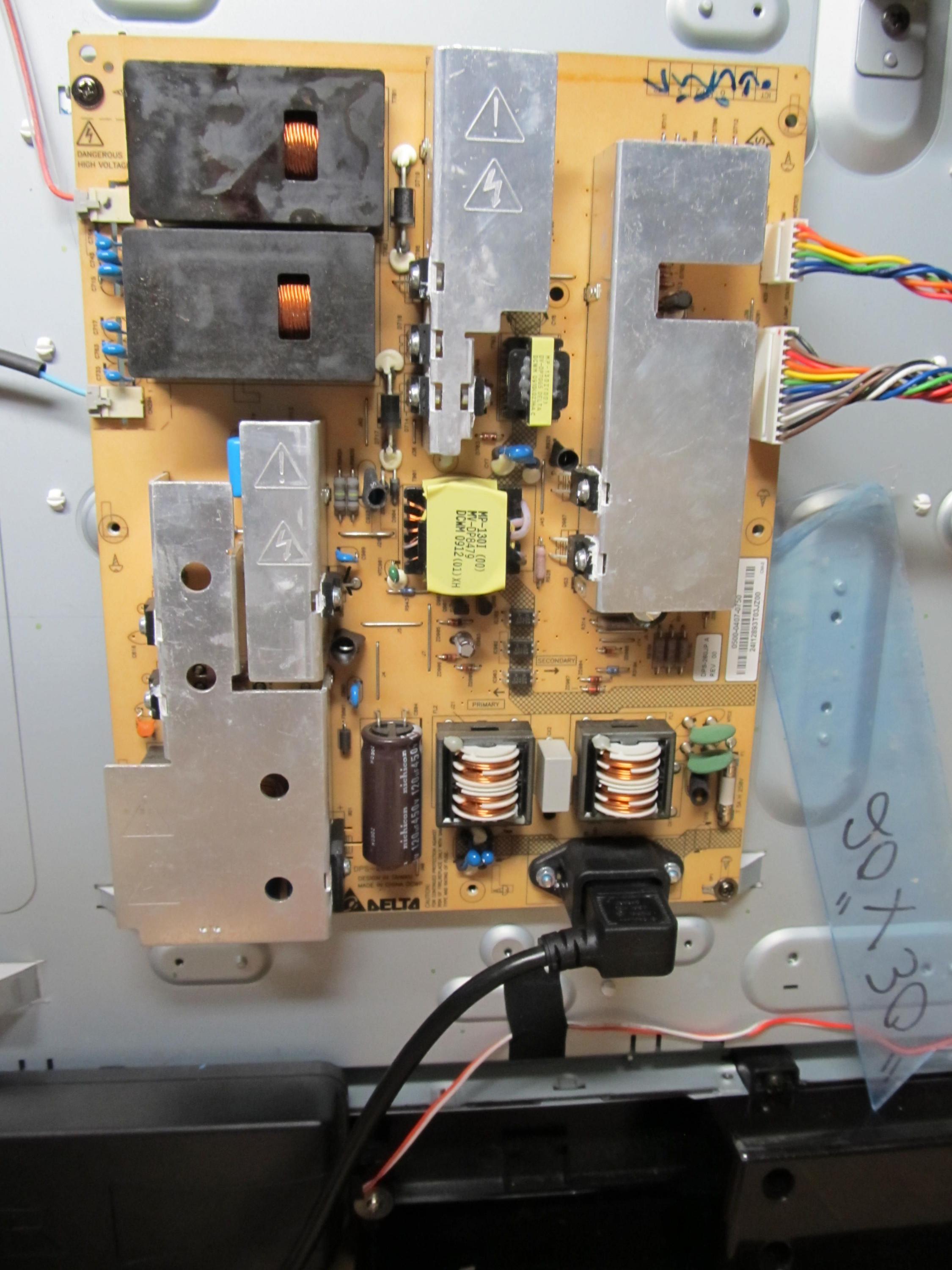

                              Well,,,,,,,,,after 45 posts,,,,,maybe I spoke too soon. This is what I did. After the back lights came on, I decided to turn the power board over and fasten it down. As soon as I did that, I lost the backlights again. I went through the whole routine again, moving things, wiggling the wires and connections, pulling and pushing on the wires going down into the connectors,,,,,,,,,nothing worked. I had already taken all the screws except two out of the power board mounting, leaving one in each corner, when for some reason, I put my finger on the edge of the board (where the arrow is), and lifted slightly (maybe a sixteenth or eighth of an inch) on the board. Every time I would raise the board, the backlights would come on let it go back on the mounting spot and they would go out,,,,,I did this about a dozen times with the same results. I thought the board was grounding out where it attaches. So I put a piece of plexiglass between the board and the metal, and the backlights stayed on. I put the base on the tv so I could “stand it up” and everything was still working fine. I had it on for about four hours last night, going down to the basement about a dozen times, and turning it on and off with the switch. Worked perfect EVERY time. I turned it off, but didn't unplug it, when I went to bed last night. This morning I went down and turned it on (white logo) but no backlights. I took the piece of plexiglass out and moved the board up and down like I did yesterday but again,,,,,,,,,,,,,no backlights. Sorry!

                                    I don't think there is a short. I think there is an intermittent open. So either a cracked solder joint, a broken trace or something along that line. Something doesn't make good connection, if you could make the TV work and quit by simply lifting or pressing on the power supply board.

                                        Re: Dead Vizio VL 420M
                                        You need to check and see which signals, mainly the PS-ON and BL-ON) are present when it works and when it does not work.
                                        it may be bad solder joints, bad wire crimping on the terminals.
