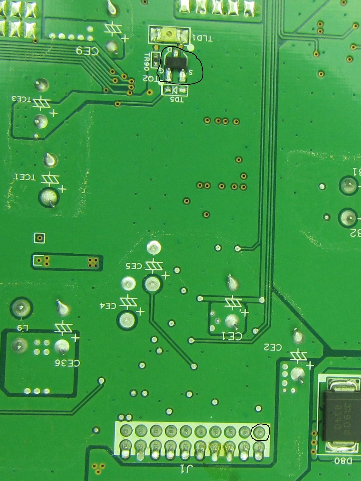

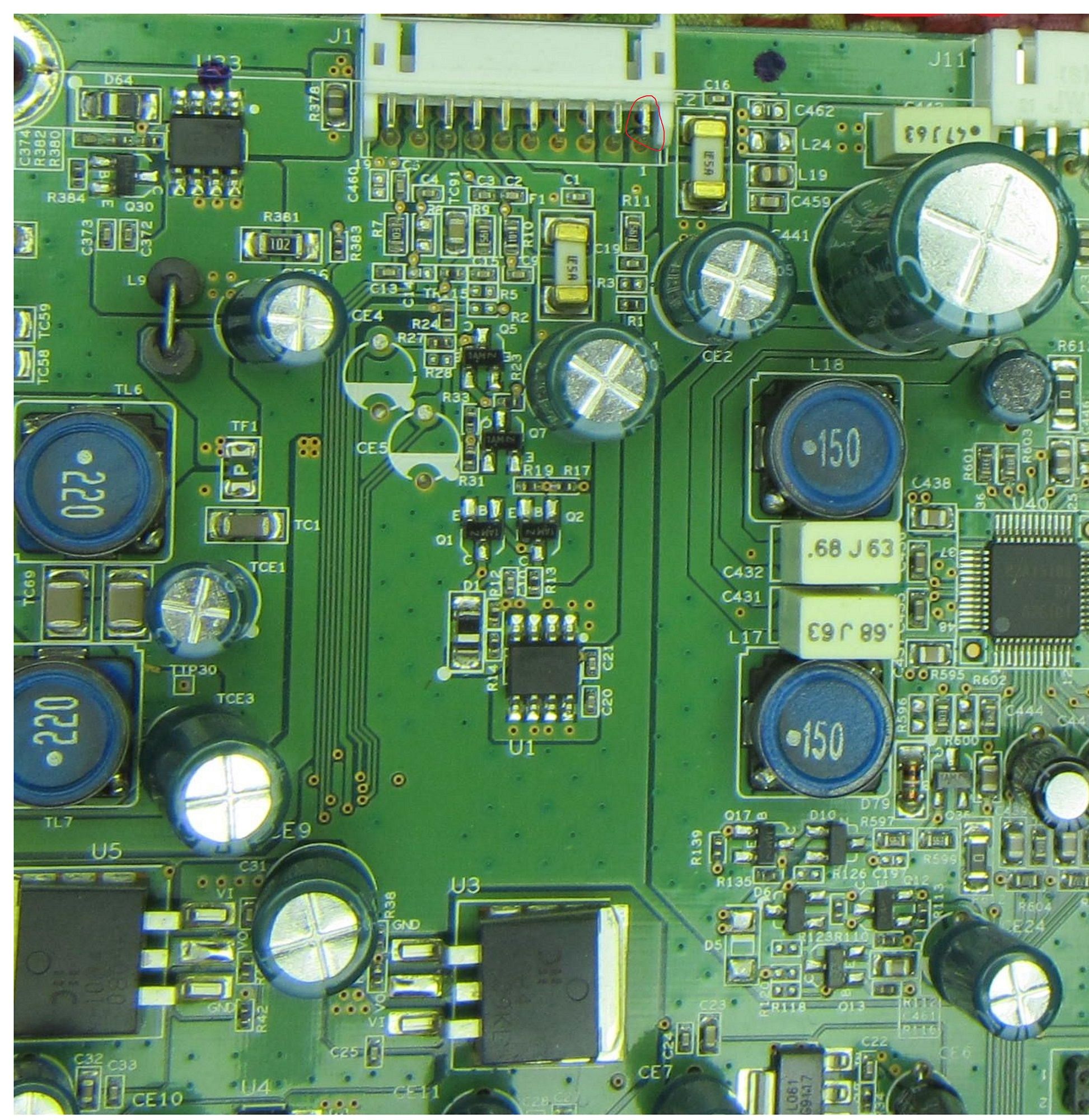

                            budm,,,,,,,On the switching transistor, I think you've got me there. I see a lot of tiny transistors on the main board, but I don't know if they are switching transistors or not,,,,,,and not sure where the one should be located that I'm supposed to be looking for Can see a lot of them near where the ribbon cable connects to the board.
                              #74
                              Re: Dead Vizio VL 420M
                              You just have to trace out that copper trace that is connected to the PS-ON post and see where it goes too, that is why it takes years of experience to do this kind of troubleshooting, not for the beginner, you also need to look up the spec sheet of the transistors, ICs to get the pin out, etc.
                              For example of what I have to do when I do not have the diagram or the board in front of me, this is a simple board. the main board is a lot more complex.
                              https://www.badcaps.net/forum/showpo...9&postcount=12
                              So if you are going to pursue this, then expect to spend days or weeks, or months tracing out the circuits.

                                    Finding that switching transistor on the main board, may be a real pain. Specifically if you have to trace it out. Good luck with that!
                                    • Tayninh55
                                      • Sep 2011
                                      • 153
                                      #78
                                      Trying to get two pics of the board to up load. They are both .jpg's. One is 7,664KB and it will up load. The one I really want to show you is only 2,107KB, it shows it as trying to upload to Badcaps,,,,then the whole box just goes blank.

                                          #80
                                          I took a couple pics of the top and bottom of the board, and then enlarged them, been working on them since trying to get them sized right. I circled the PS ON pin on the connector on the top and bottom of the board. budm and Cap,,,,,,,I'm asking, "not telling", but do you think the transistor I circled on the bottom of the board, is the "switching transistor" for the PS ON? I thought it might be, but as you know, I could be wrong!
