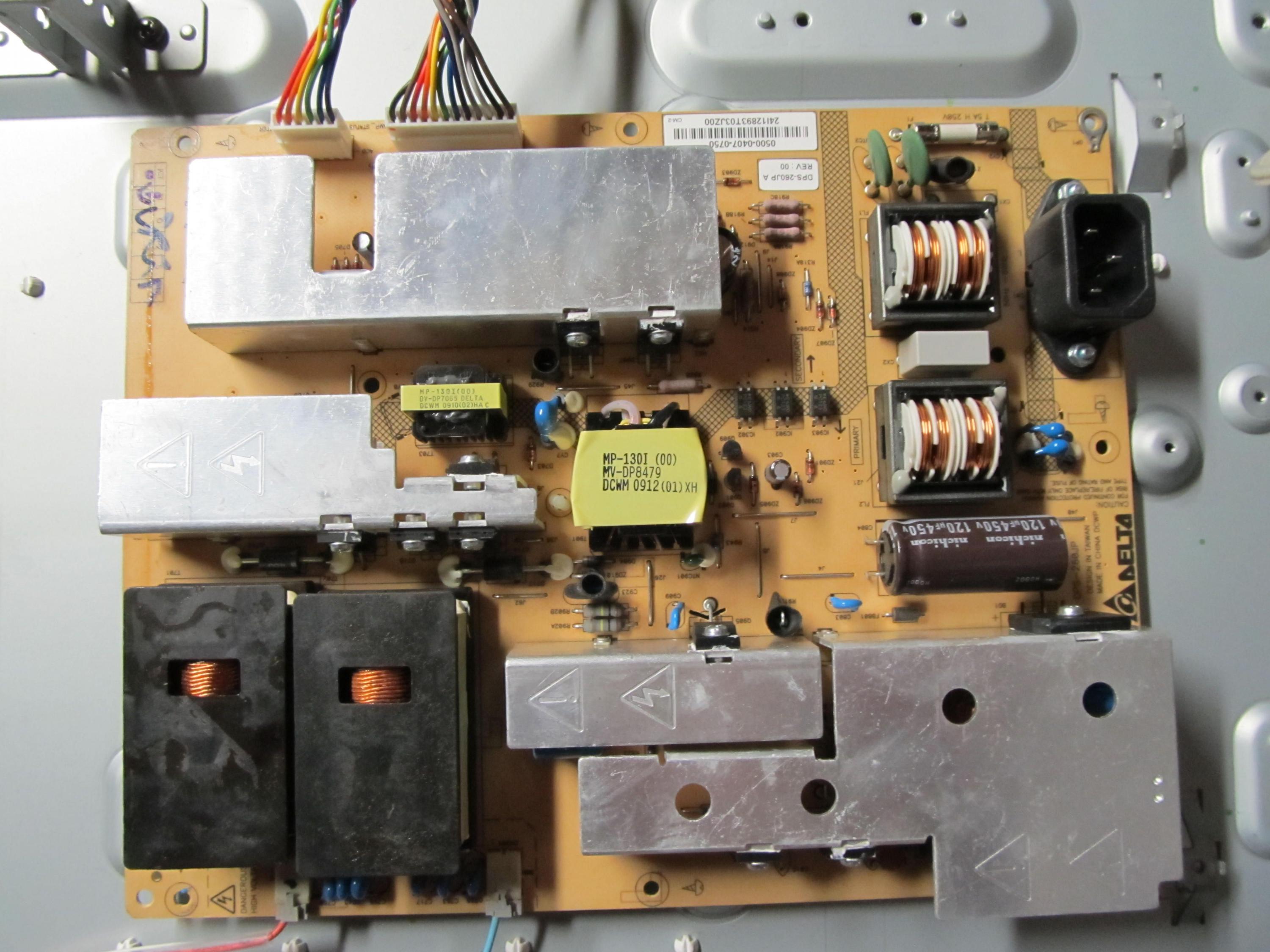

    So you got a main board issue.
      Re: Dead Vizio VL 420M
      One thing I do not know on this unit is the ACD signal (AC Detect), I do not know if it is normally HIGH or normally LOW.
            On a second thought: look at the backside of the power supply and look for cold solder joints, also look at the pin connectors. Once you got squared away, leave the main board disconnected and force the power supply and the backlight on.

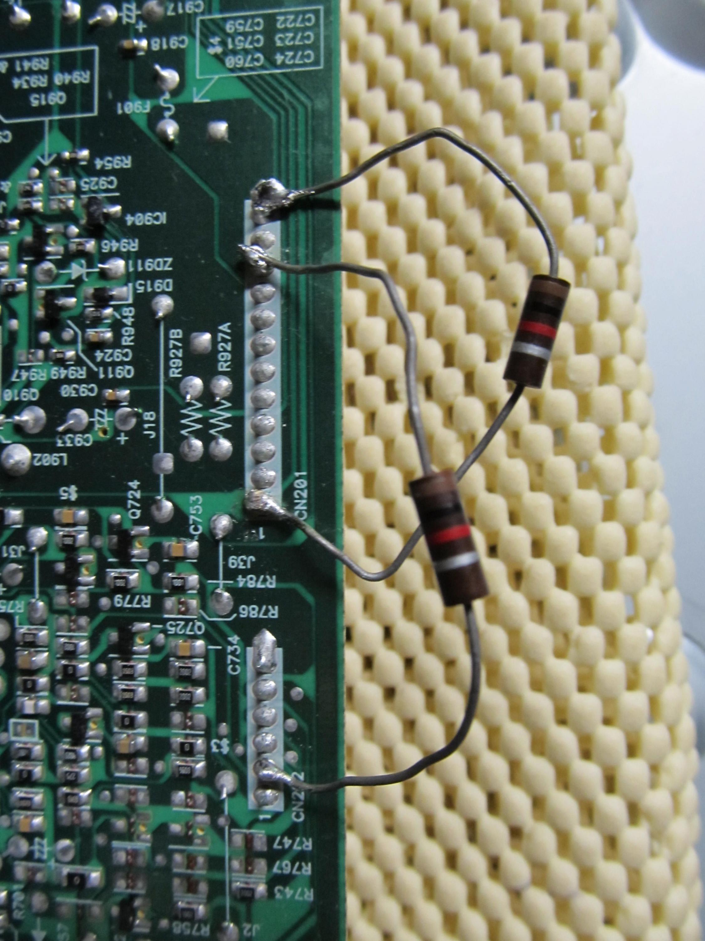

              Cap,,,,,I know how to look for cold solder joints, but how do I "force the backlight on? What you mean is to disconnect the 6 pin and 12 pin connectors going to the 2nd board, and then turn the power on? The logo light shouldn't come on then because the on/off switch will be disconnected? Once I plug the 120V back on,,,,,how do I force the back light on? Guess I'm really a big dummy!
              • CapLeaker
                Leaking Member
                • Dec 2014
                • 8133
                Well... sounds like something is intermittent. But what? Anyway... here we go:
                Unplug the ribbon cables going from the power supply to the main board. The only thing on the power supply that stays plugged in are the back lights. Now take a 1k ohm resistor from PSon to 5V Standby and another 1k ohm resistor from BLon (I think it is inverter on in your case) to 5V Standby. Plug the baby in and all the voltage rails should be up on the power supply and the backlight should be on as well. Now you can test nicely the output rails, let her rip and give her a few cycles as you wish. Hopefully the power supply never misses a beat. We are totally isolating PS and mainboard, "forcing" the PS manually on. As usual: Really watch what you are doing around the primary.
                  I guess it doesn't matter which of the three standby pins I use? Ok,,,,,I'll give it a try and see what happens! Might be awhile before I get back to you on this, and thanks again!

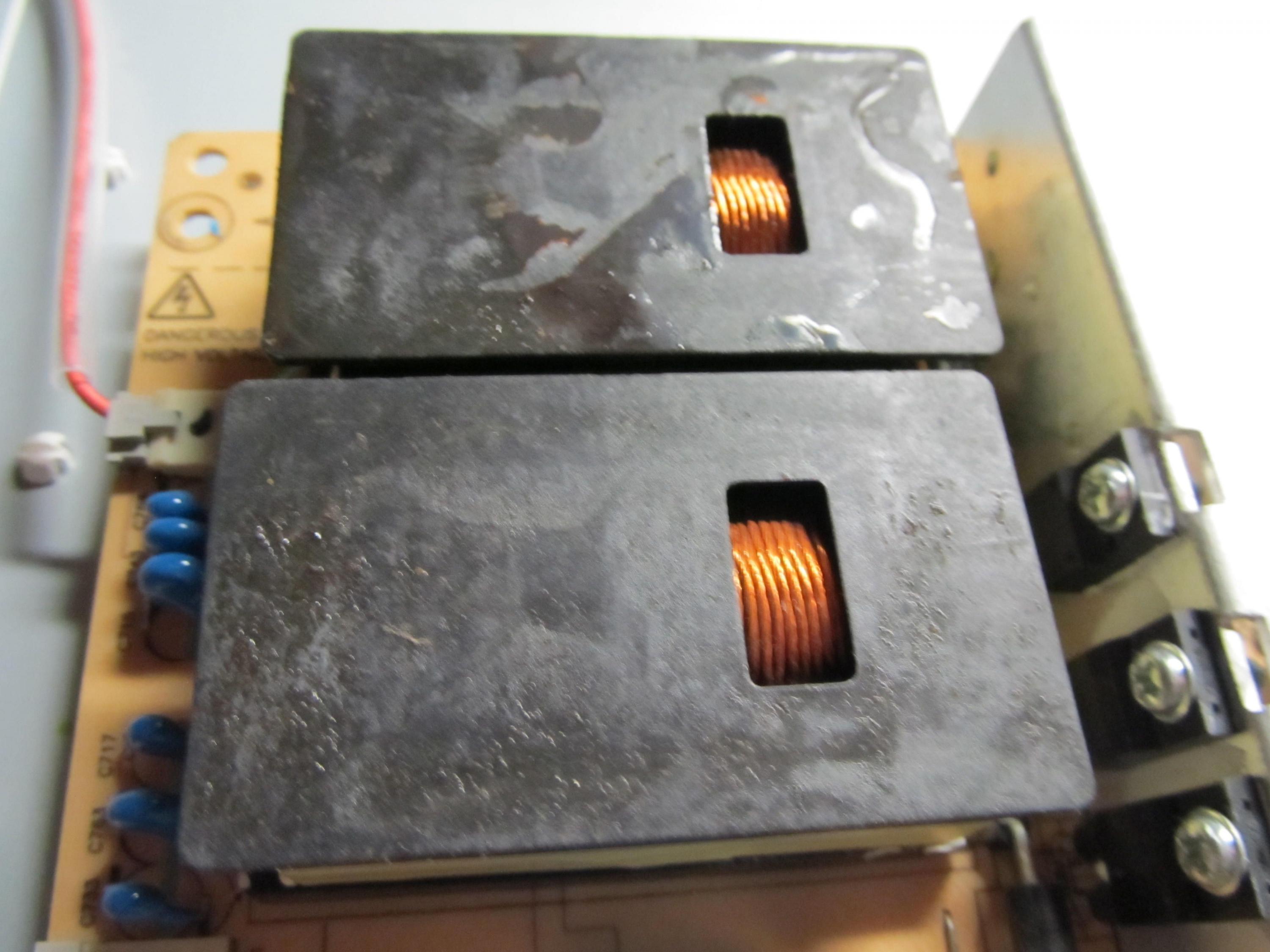

                      I'm getting ready to solder in the resisters, but before I do, I have another question. Probably doesn't have anything to do with my problem, but do these look like they've been "hot", or do most just look like this?
                        #31
                        I cannot tell from the picture if the inverter transformers were over heated or not.
                        What you can do for now is to force on the power supply first, no need for BL-ON force on yet, to see if the PFC Voltage is working or not first.
                          Cap, it didn't "blow up"! budm,,,,,too late, I already did the BL-ON force! The BL came on,,,,,,,should I still check the main cap for voltage, while the resisters are in place? What should I do next?
                            Did you check all the voltages? Try this setup a few times. No need to check the filter cap. PFC is working, otherwise you wouldn't have back light.
