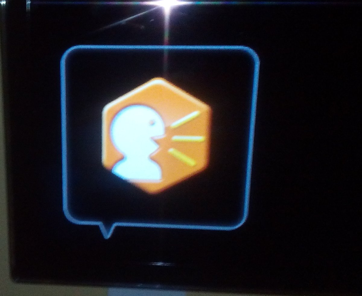

    EDIT: One thing I forgot to mention. There is a new icon I never saw before. This appeared to appear after the initial failed update in the lower left corner.. Not sure what it means..

        Any idea what that Icon is??? It appears now everytime the TV is powered up..

          It means the wife is going to give you hell for some time or RTFM
          P28
          http://www.manualslib.com/manual/416...page=28#manual

              Awww crap, now the wife is going to REALLY give me hell. She said it looked like some sort of voice control icon..
              Thanx for the link SD.. I did a search for "Chat Icon" but came up empty..

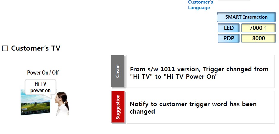

                                  I guess it all started after you made an update. The software allowed the motion control to be enabled, so turn it off.
                                  • Michale32086
                                    • Nov 2011
                                    • 1453
                                    Re: This Time.. It's Personal.. Samsung UN60ES7500 Constant reboots
                                    I'll give that a shot as well...
