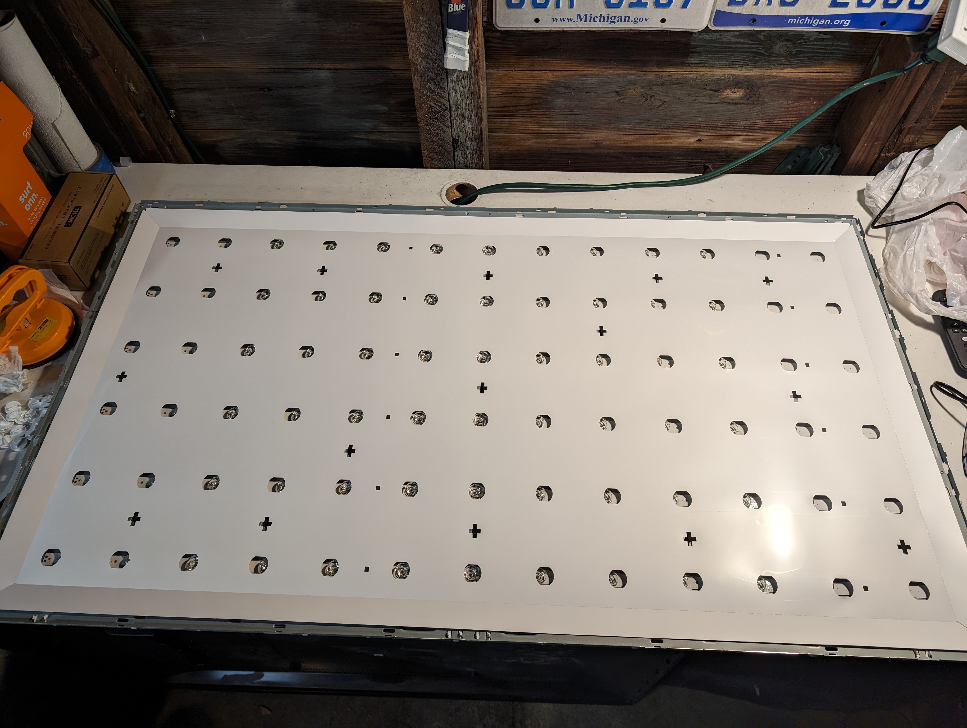

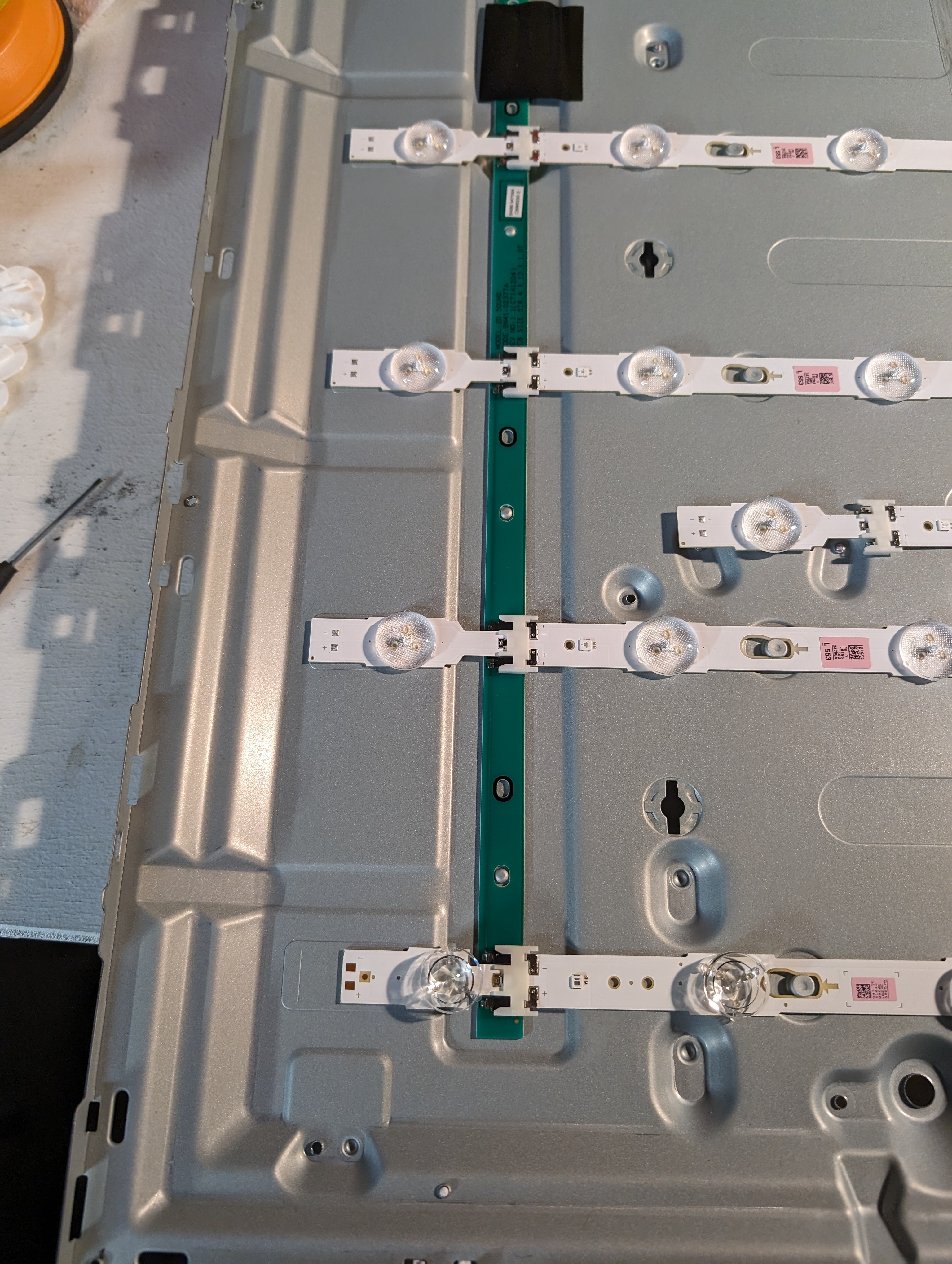

                          I got the backlights today. Took it apart and put them in only to find out I ordered the wrong ones. There's two different versions and I had to guess without having already taken it apart. So naturally I pick the wrong ones. They physically fit the chassis fine, but the reflector sheet doesn't line up with the leds because they are offset for some stupid reason in the other "version".
                          Should I definitely try and return them for the correct ones? Or could I successfully modify the sheet without ruining picture quality? Any one ever do this?

                              I also tested each strip before removing them and found 3 bad LEDs.
                              When I put all of the new ones in and plugged in the tv (with main board disconnected) I still did not get backlights. I'm thinking this may be a model that does not function this way. Obviously if there were 3 bad LEDs that would be an issue, so I'm hoping that's the ONLY issue.
                              I ordered the correct strips. Hopefully I can return the others.

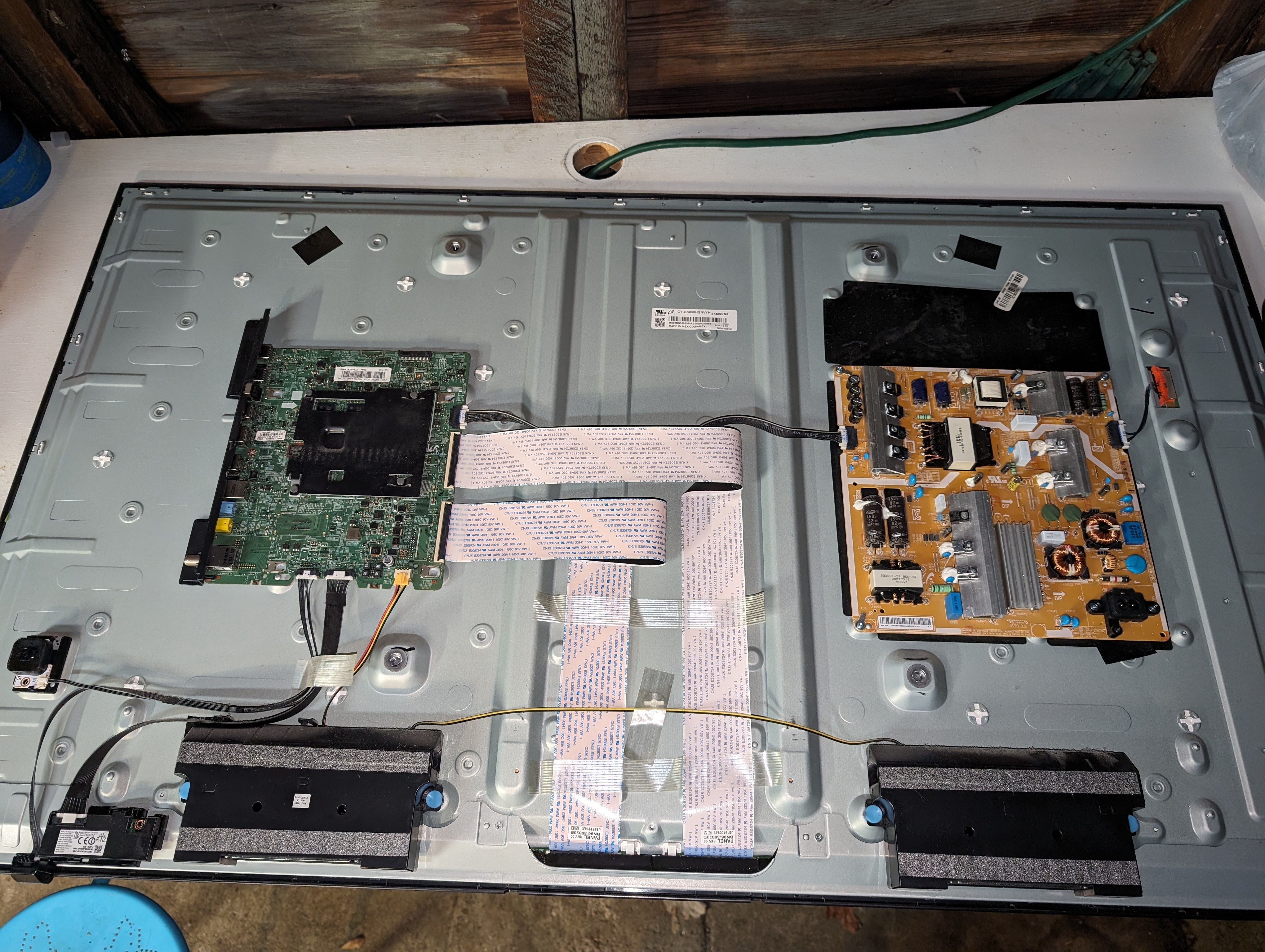

                                  I got the correct strips and put it together and it won't power on.. the indicator light just flashes red and so does the optical port. I tried a spare main board that fit and get the same result.
                                  • x_orange90_x
                                    • May 2015
                                    • 727

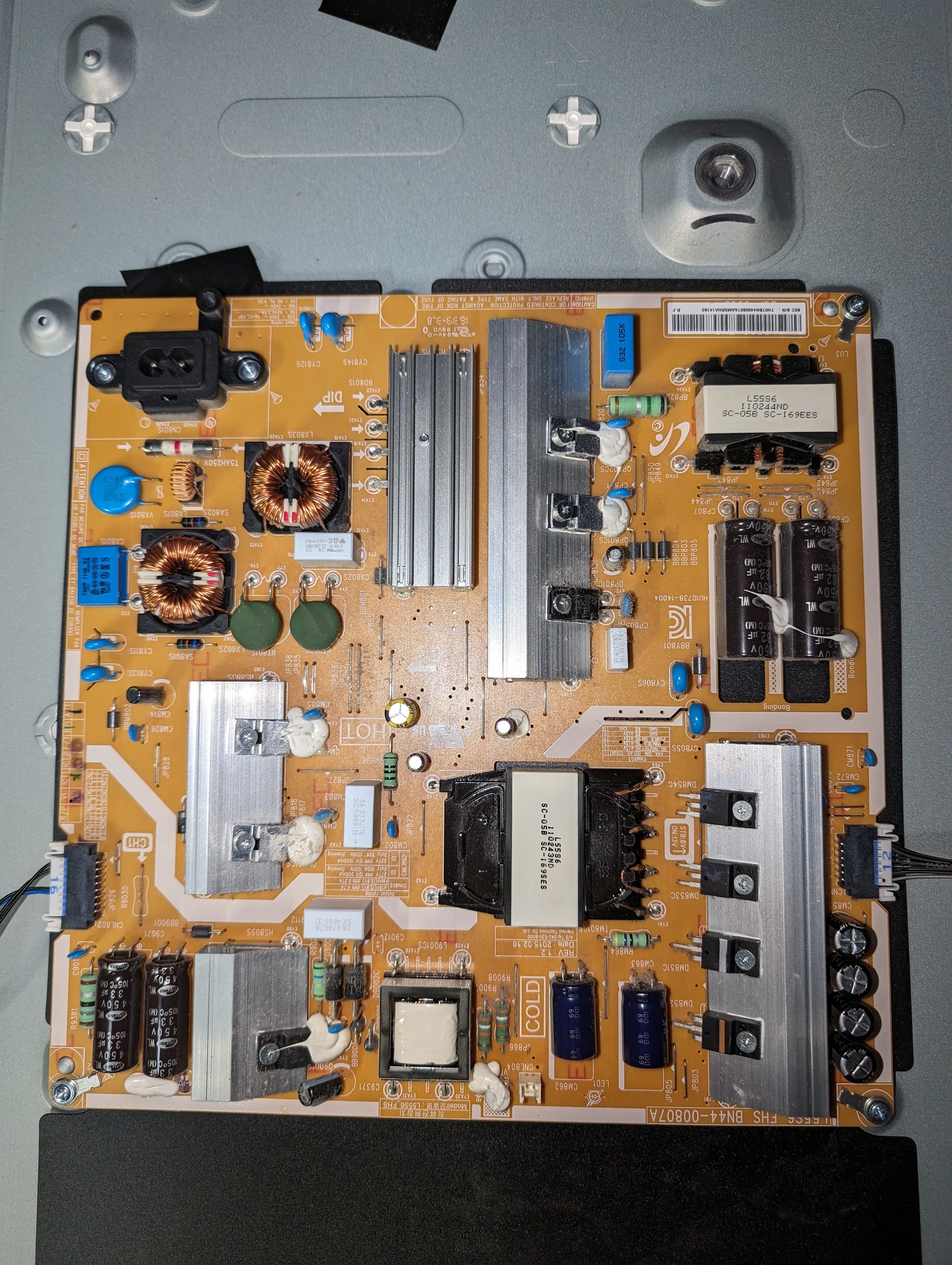

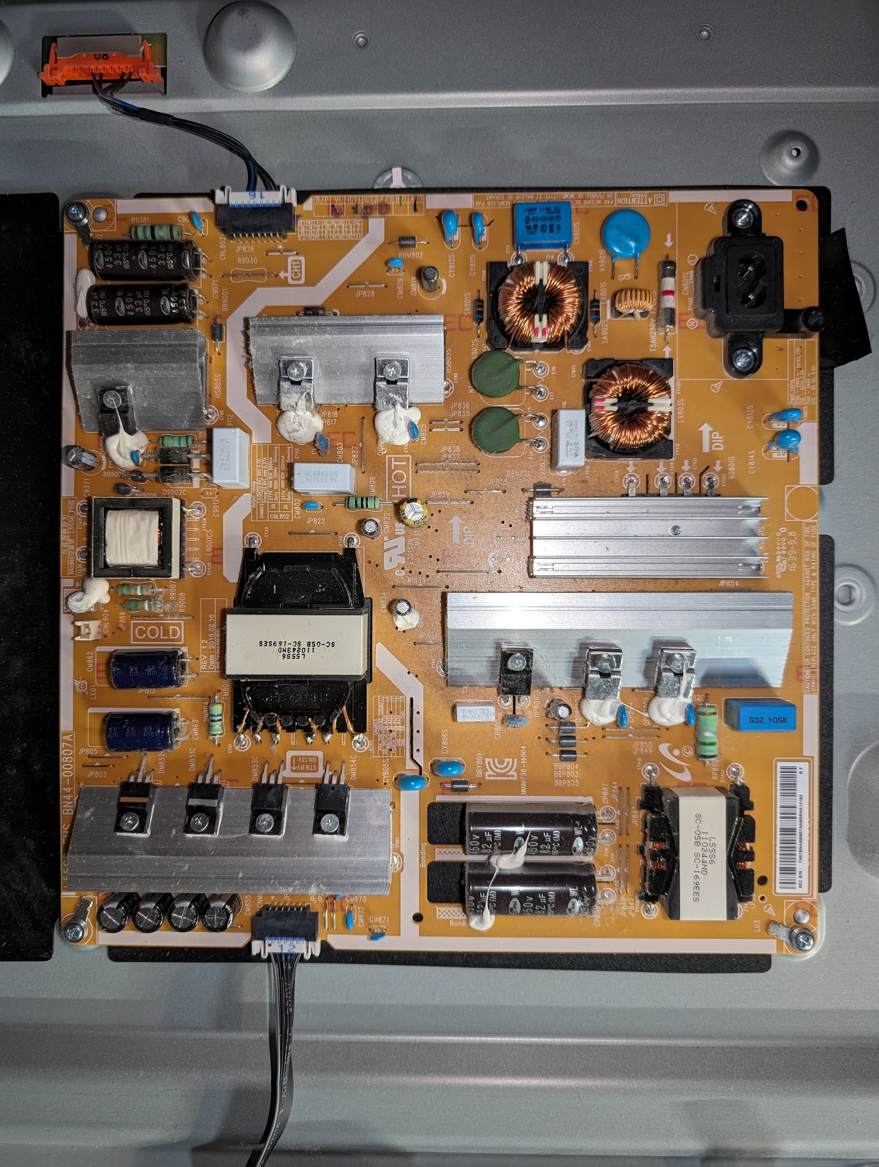

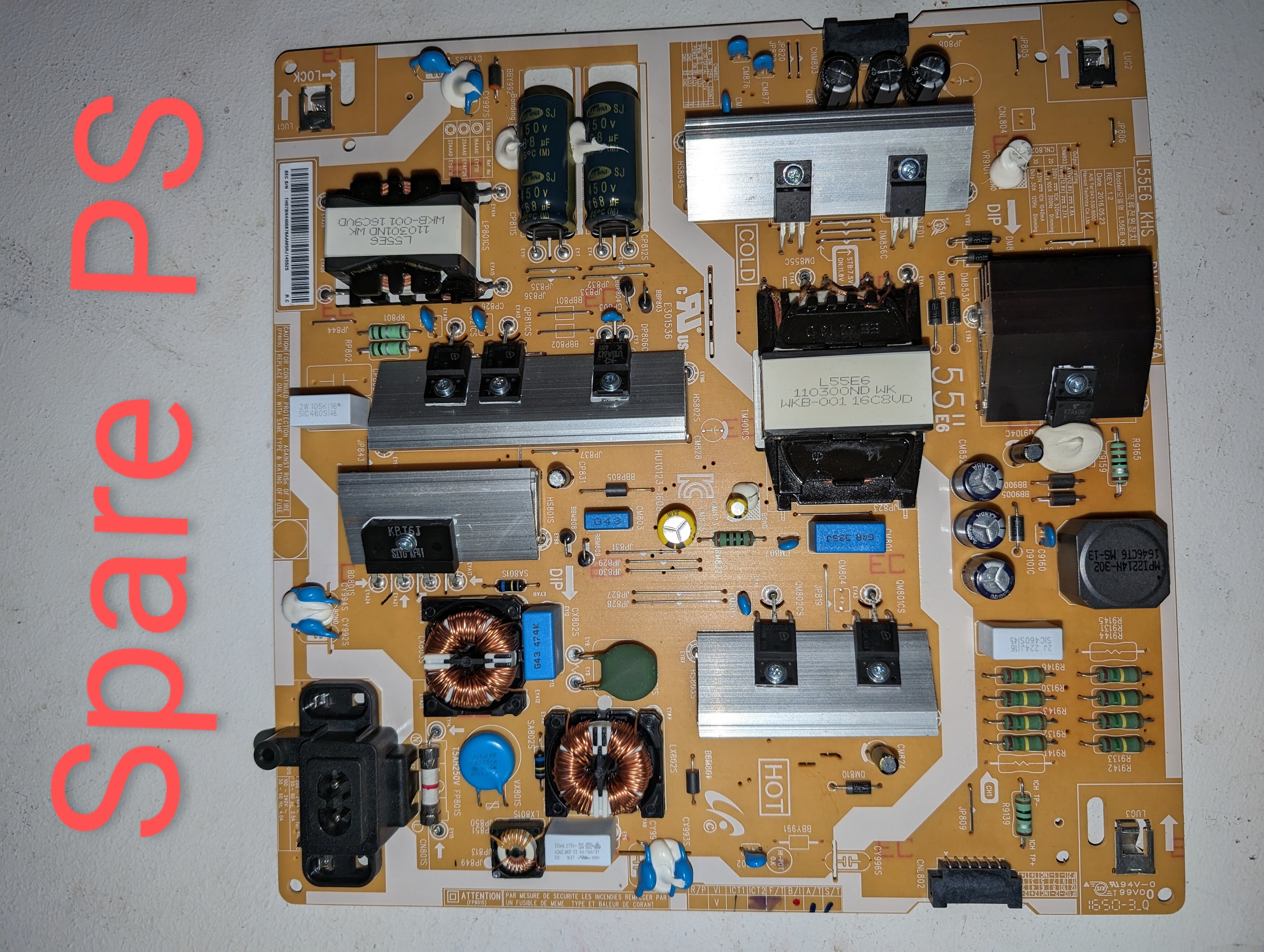

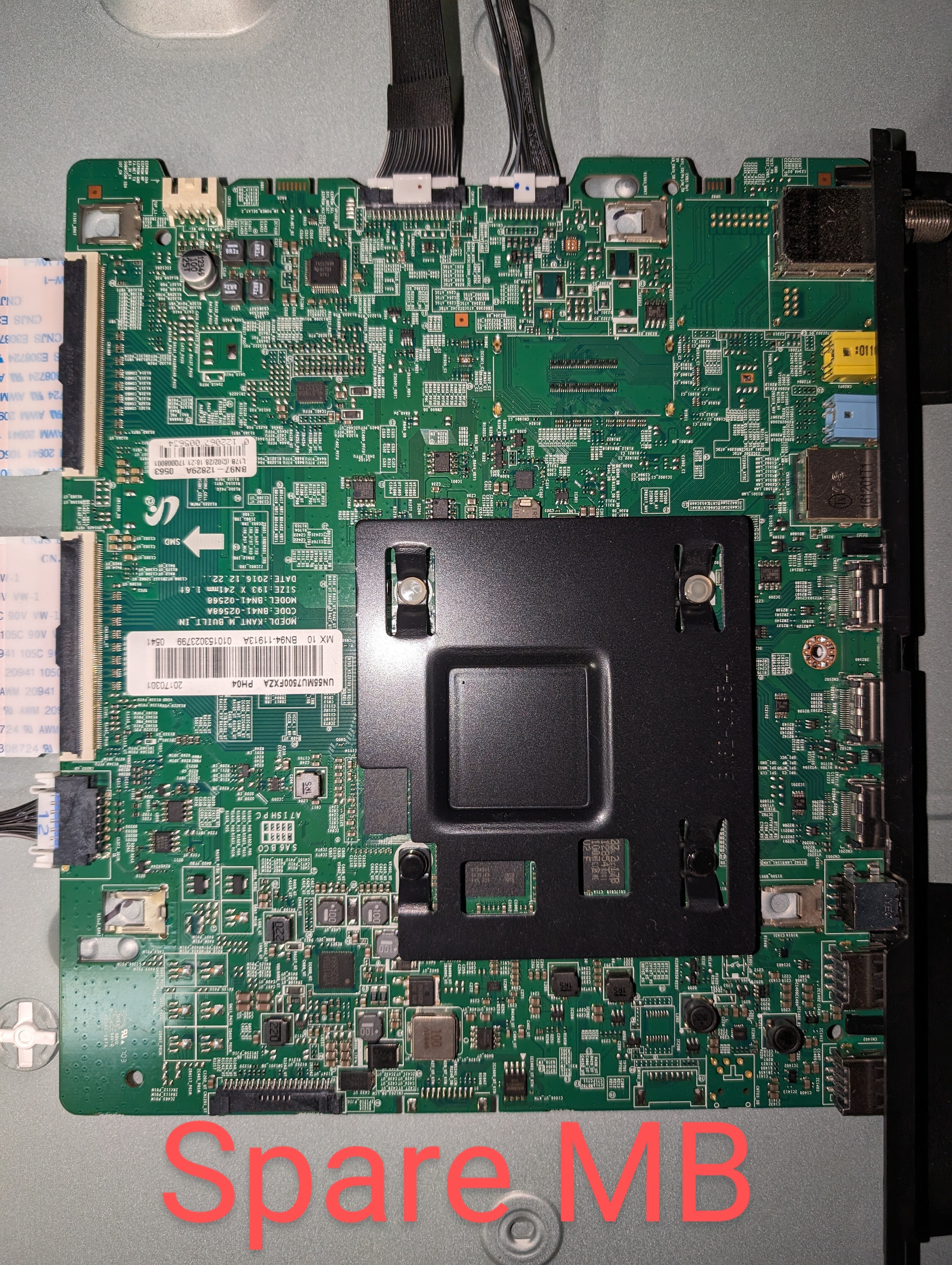

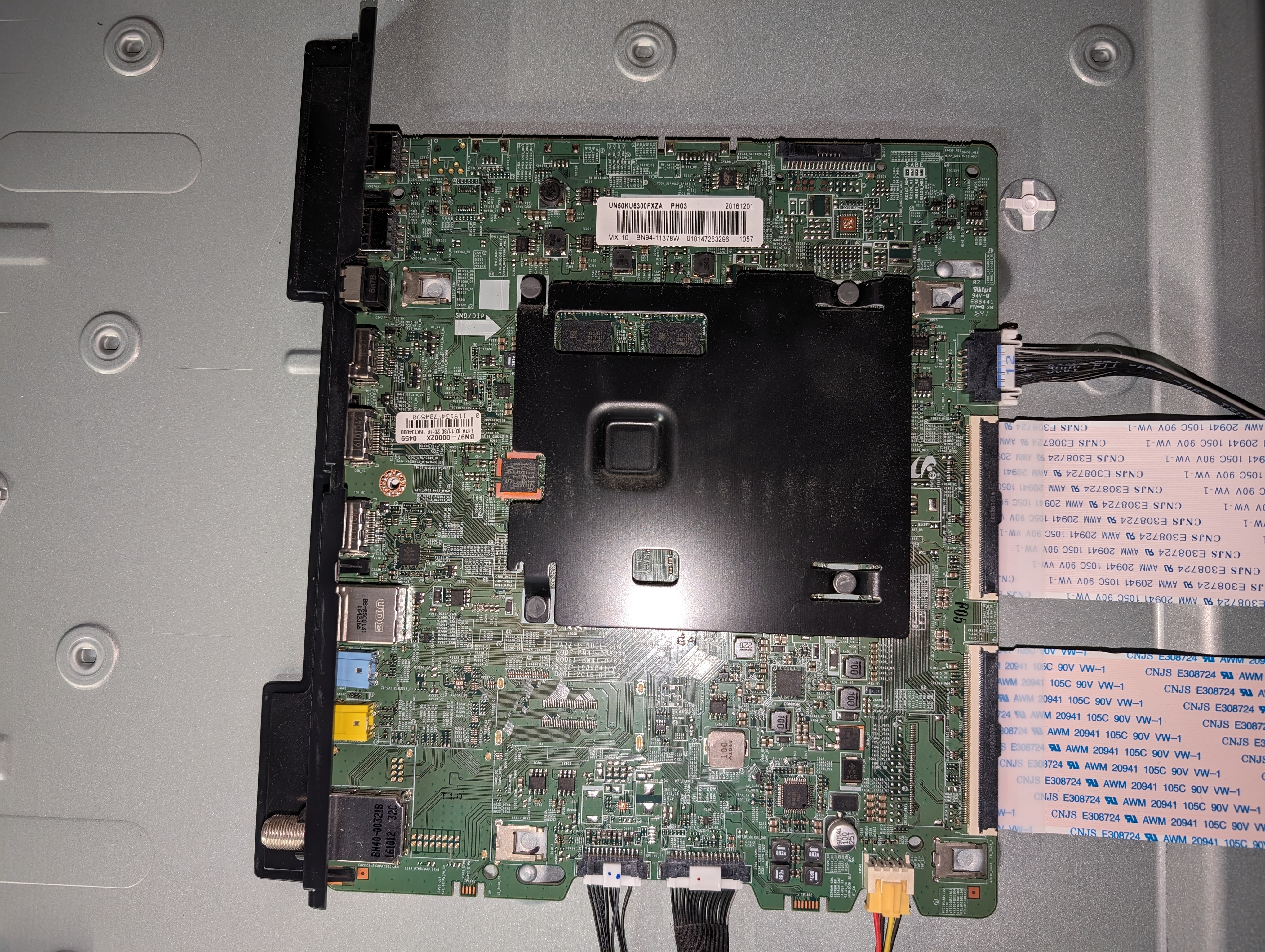

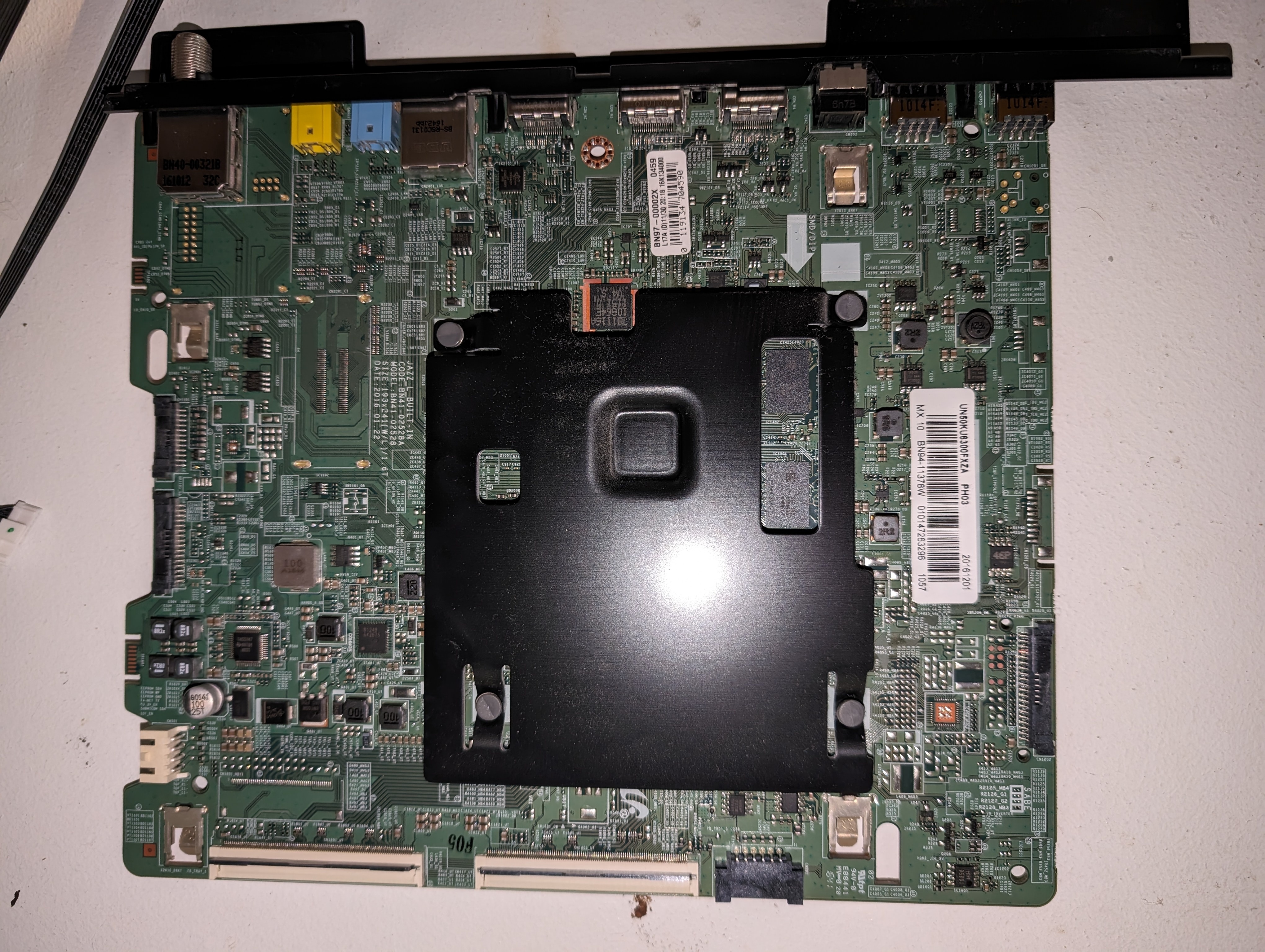

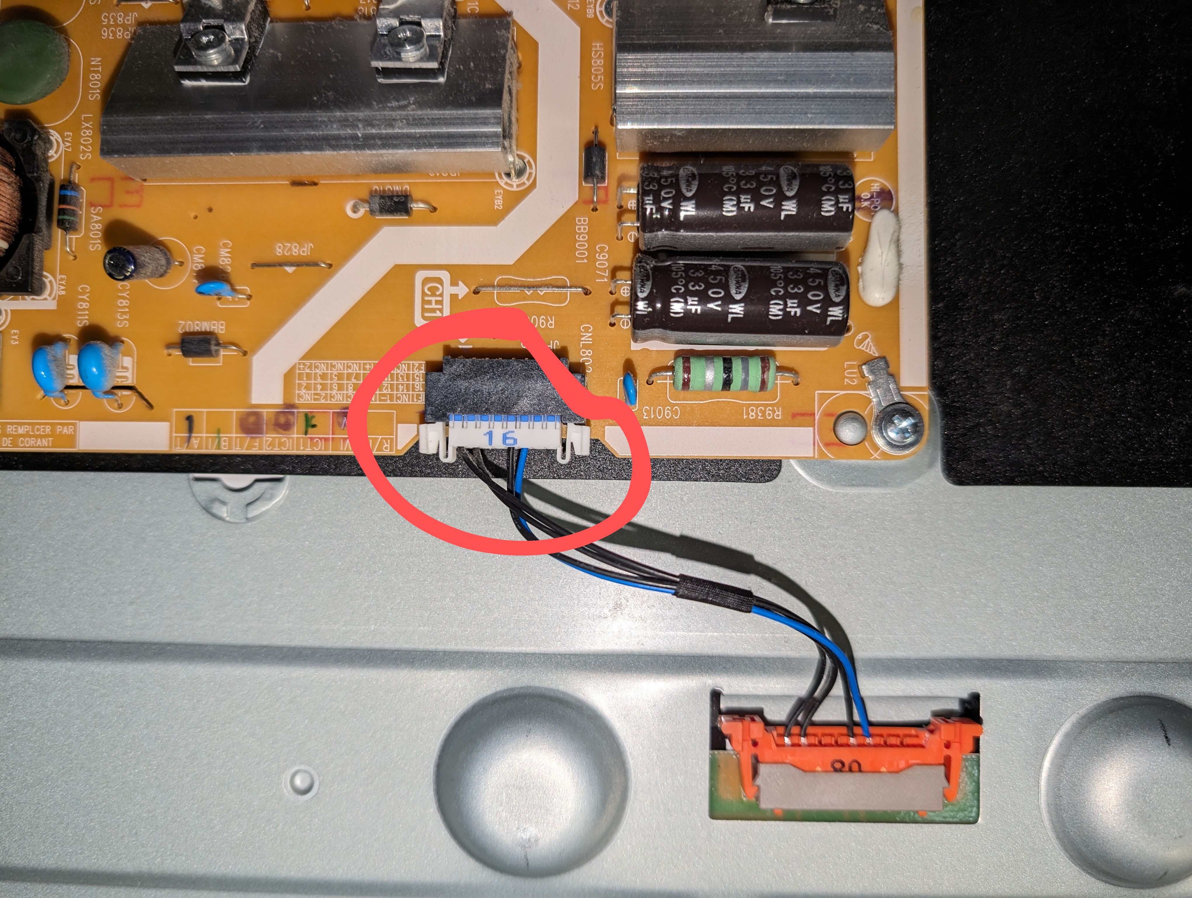

                                    I should mention that even after replacing the backlights they still do not light up when the main board is unplugged from the power supply. I'm suspecting a power supply issue, but I have also read about bad panels causing the standby light to flash. I should still get backlights with the main unplugged right? Because that's eliminating the screen as well.
                                    I have a main board and power supply out of a 55" that is *almost* compatible with this tv. The main board looks nearly identical and all the ports and connectors are the same. The power supply boards differ though where the led plug is concerned. They do not have the same size plug, therefore I cannot connect the backlights to the donor board.
                                    I'm thinking of putting the donor power supply in and trying with the LEDs disconnected. I *should* get the tv boot without them plugged in, correct?
                                    I've attached pictures of the original and spare boards, as well as a pic of the led plug that is different between the two power supplies
                                    • vinceroger69
                                      • Mar 2012
                                      • 6714
                                      • uk
                                      yes should get backlights without mainboard connected, certainly sounds like a power supply issue
                                      • x_orange90_x
                                        • May 2015
                                        • 727
                                        If I connect the spare power supply to the main and leave the backlight disconnected, should the tv boot up? I would expect it would, just as if backlights were shorted.
