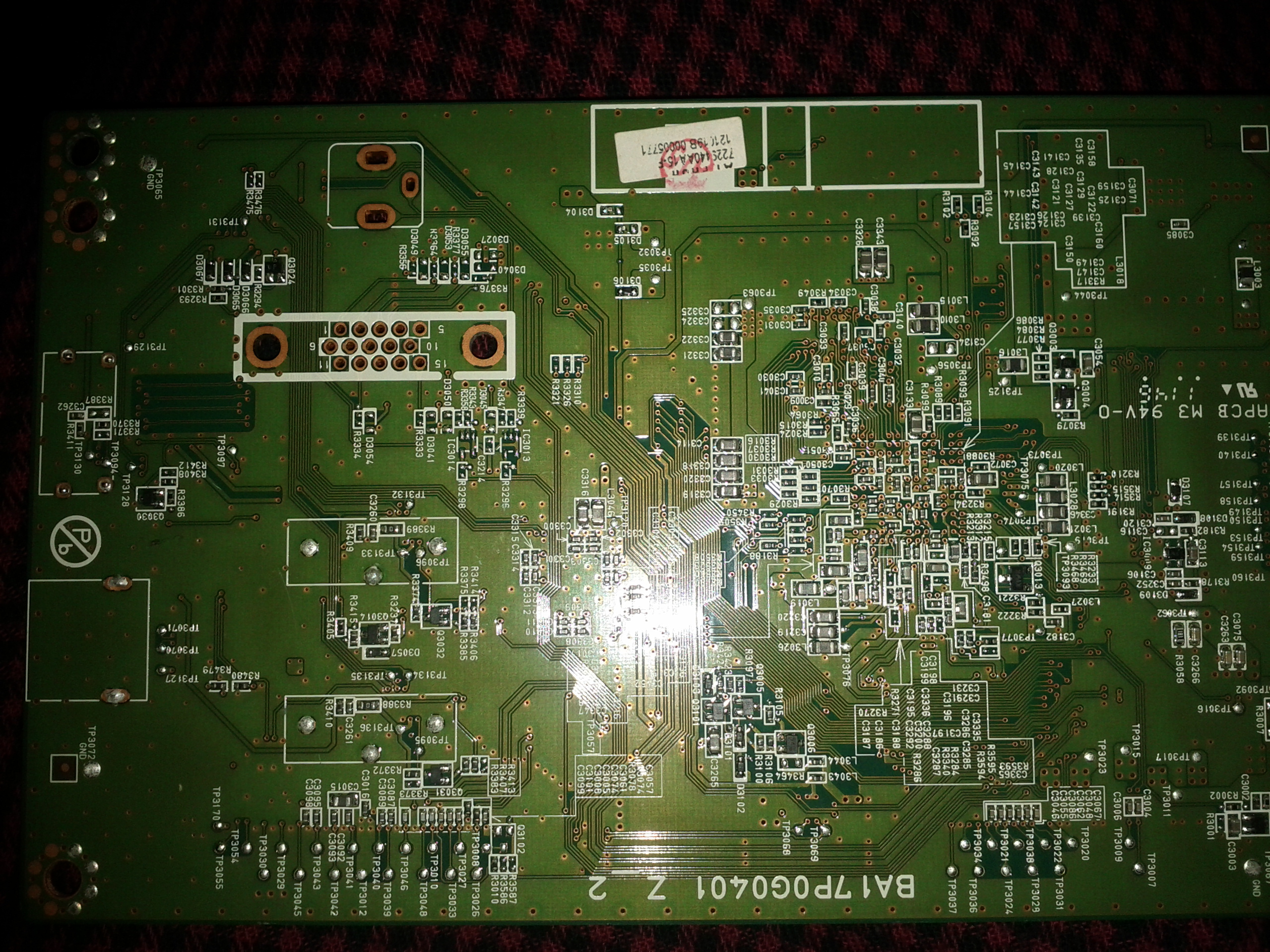

    Hello all! I have just started picking up broken televisions and trying to repair them as a hobby. I picked up a 40" Emerson LC401EM3F on Craigslist and have started troubleshooting it, but I am not sure what my next steps should be.
    I was having power supply issues when I first started looking at it. The television would power on for about 2 seconds (with backlight) and then go immediately back to standby mode. For some strange reason, yesterday this problem disappeared and I was able to get the backlight to stay lit. Additionally, I plugged in a source into the HDMI port and the sound was working! However, there is still no video available. When I first picked up the television, I purchased a used but functional digital main board (TCON - A17PHUH). I attempted to swap out the digital main board and there was no effect on the video. The same problem exists (backlight on - sound works, but no video).
    I have the service manual and have been looking through it, but I am lost as to how to troubleshoot at this point. Are there specific points on the TCON board that I can check to ensure it is getting power?

        The picture you posted is a bit fuzzy. I would expect the fuse to be near the LVDS connector on the right-hand side of your pic, but it's cut off in your picture.

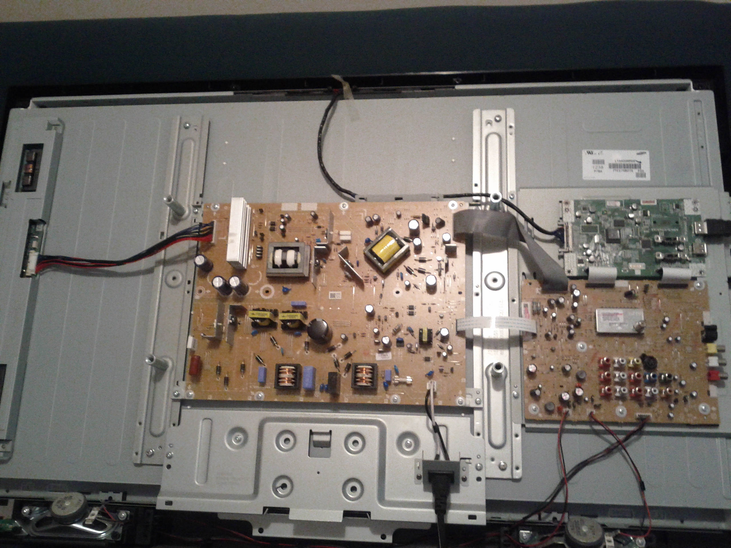

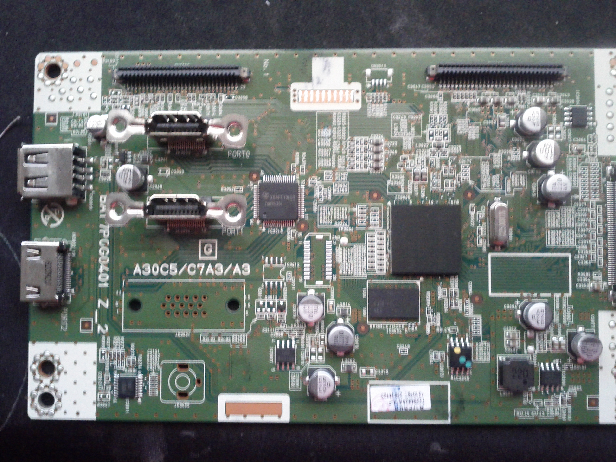

              Can we see the whole back side of the TV?
              That is the main board, not T-CON board.
              http://www.shopjimmy.com/emerson-a17...l-main-cba.htm
              Is the LCD panel this number? LTA400HM09-F05
              T-CON board is under the metal shield top center of the screen, you need to find out if you do have 12V at the SMD fuse on the T-CON board.

                Sure, see attached photos. The LCD panel is LTA400HM09-F05. I figured that was the LCD display driver board. I will check accordingly. Thanks.
                Edit: Found the fuse and it appears to be blown. I will try jumping a wire temporarily and see what the results are.

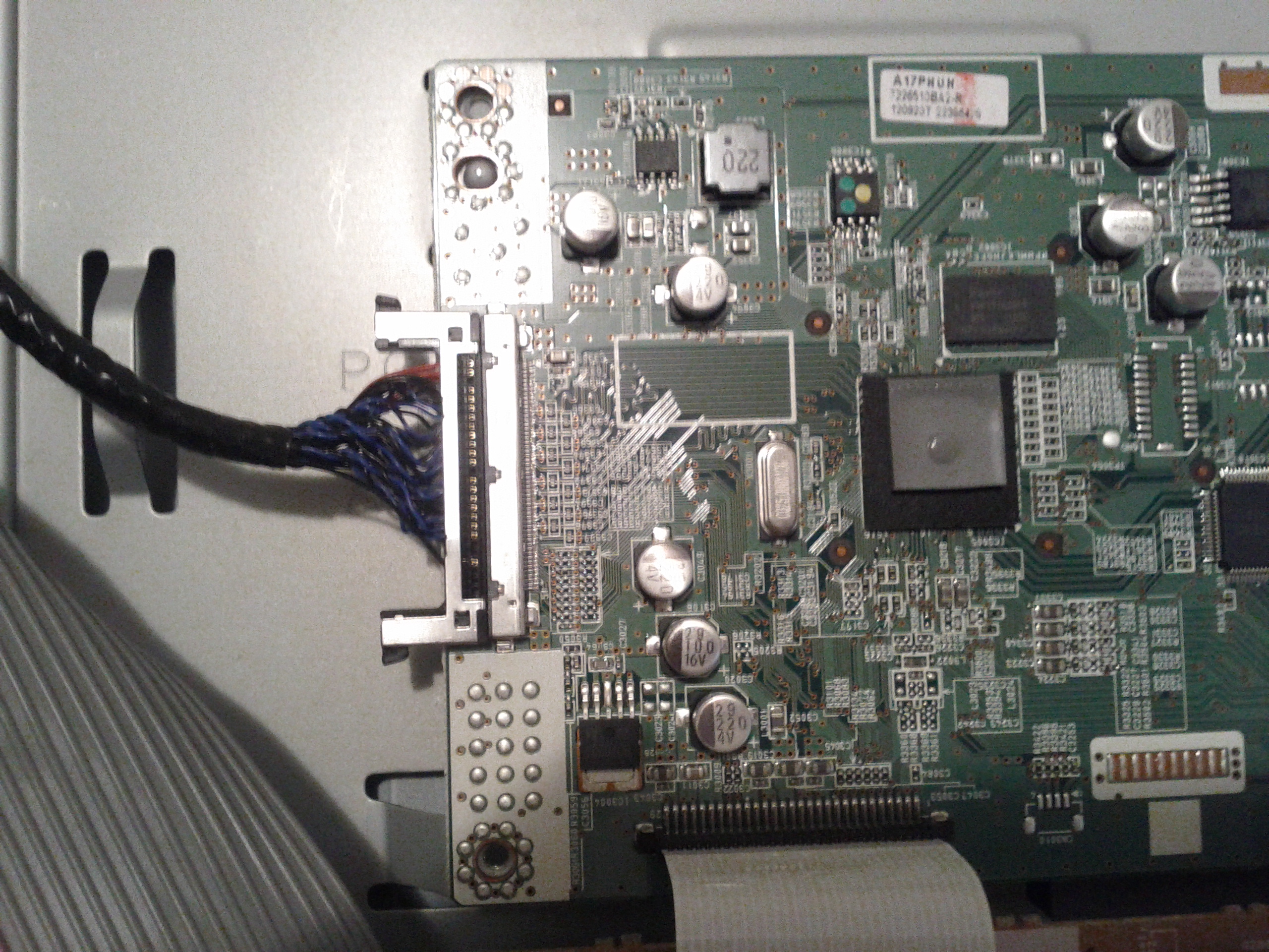

                  Re: Emerson LC401EM3F Backlight and Audio Work, No Video
                  Ooo, it is one of those LCD panel with integrated T-CON.
                  You will have to take the panel apart to get to that long PCB where the LVDS connector is attached to to see where the SMD fuse is.

                    Well... After jumping the wire, I believe there was a picture. Unfortunately, I was not in a position to see it when I powered the unit on since I smelled burning and saw a puff of smoke and quickly disconnected the power. There is a reason fuses are integrated in the board...
                      I think you are out of luck on this cheaply made screen not to be repaired.
