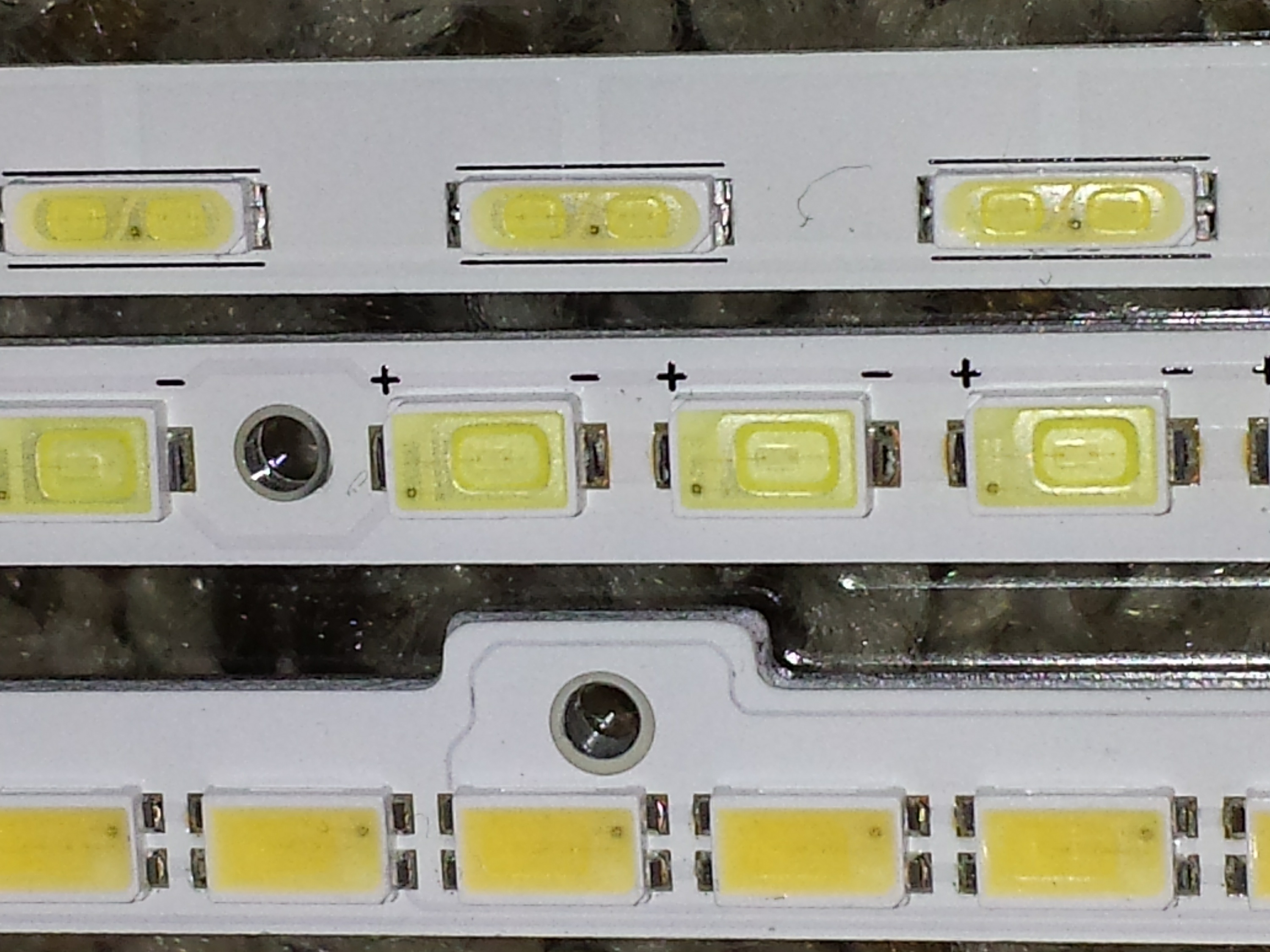

                                  I found one more type in the basement. Here's a pic of the 3 types I have. 2 strips say 94v so I suppose I can divide that by the number of LEDs to get individual voltage ratings. Third strip doesn't say.

                                    They are identical to the ones on the bottom...
                                    Here's a close up...
                                    iirc, I was told they are 3.2v but I'm pretty clueless when you get that far into it.

                                      They're approximately 3mm by 5mm, not counting contacts.

                                        I'm lost there, I couldn't tell you how long/wide they are, but they appear to be the same type as that bottom set you posted. Are there different sizes of that type?
