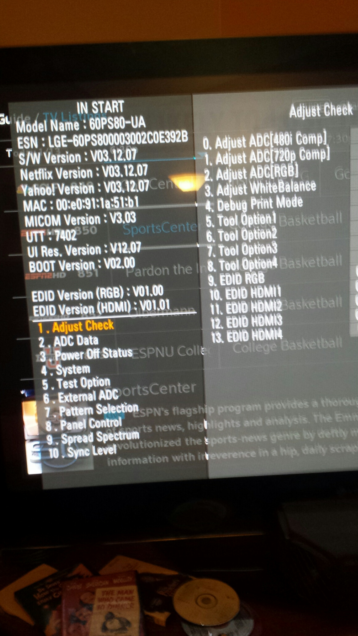

        I can get to the "hidden" or service menu using the steps you described (passcode 0000). But there is no factory reset or other reset in any of the 10 options, at least that I can find... Frustrating!

          Post a photo of the Service Menu, sometimes Factory Reset is not labeled clearly, could be named something else.

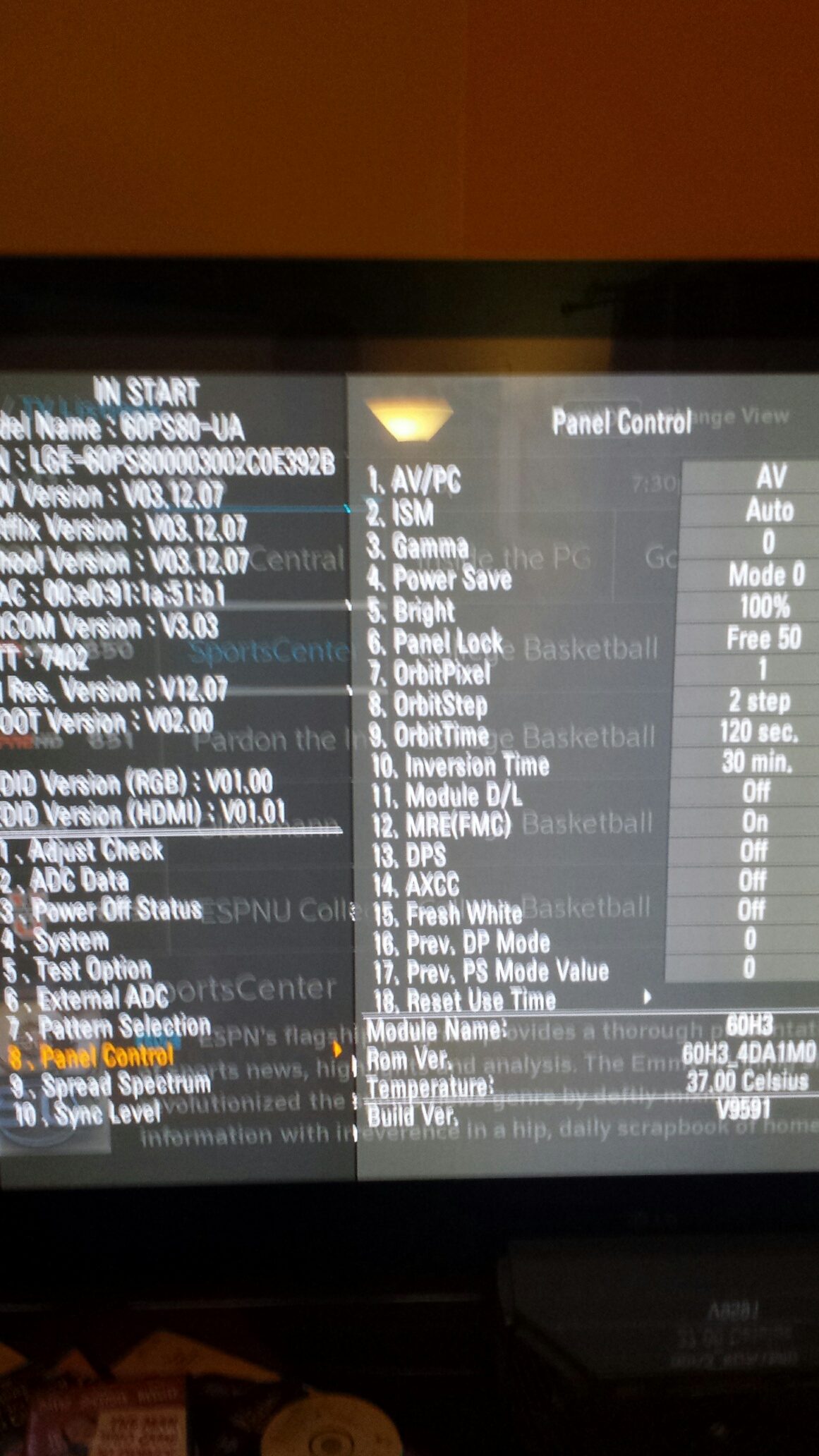

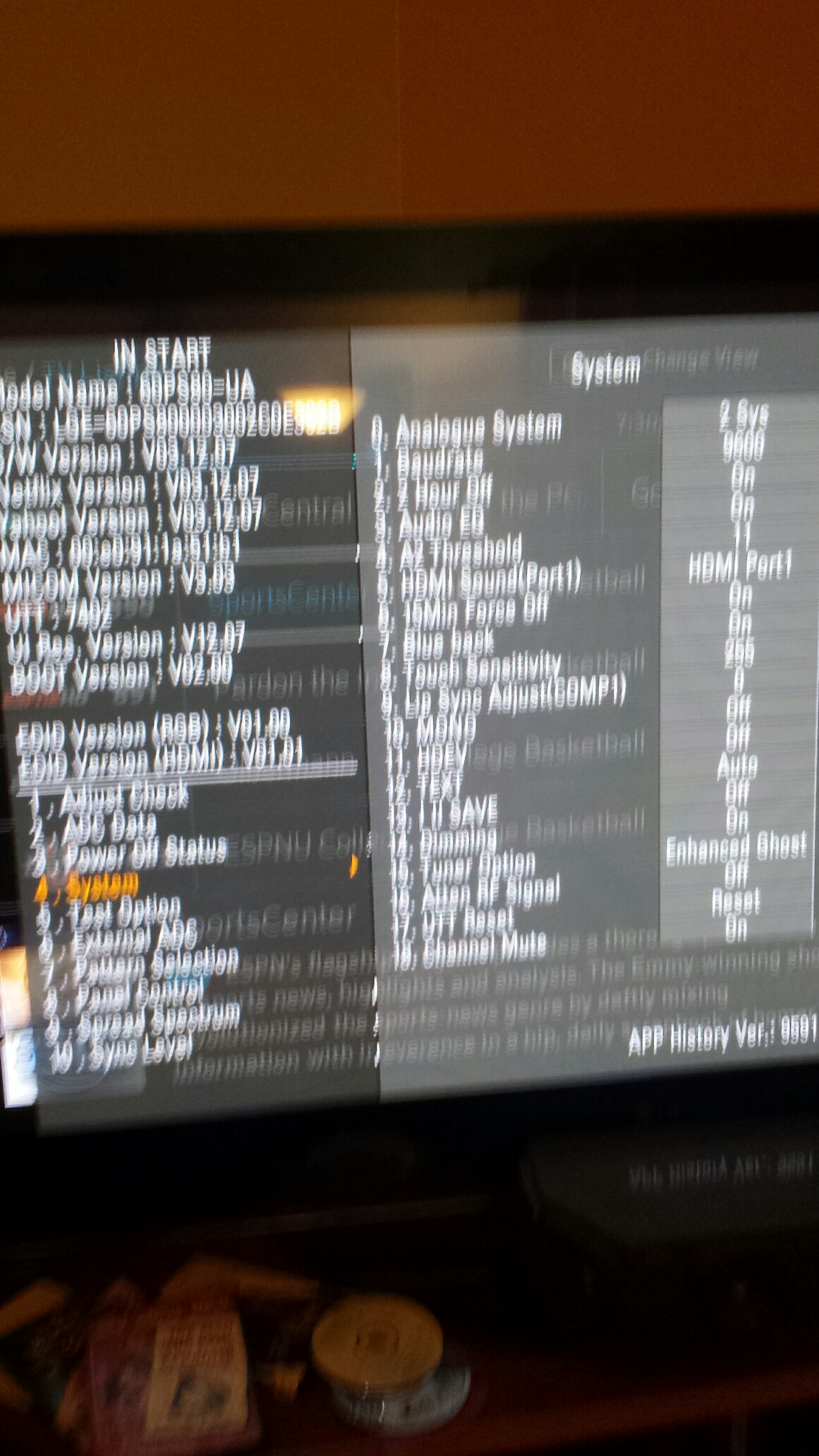

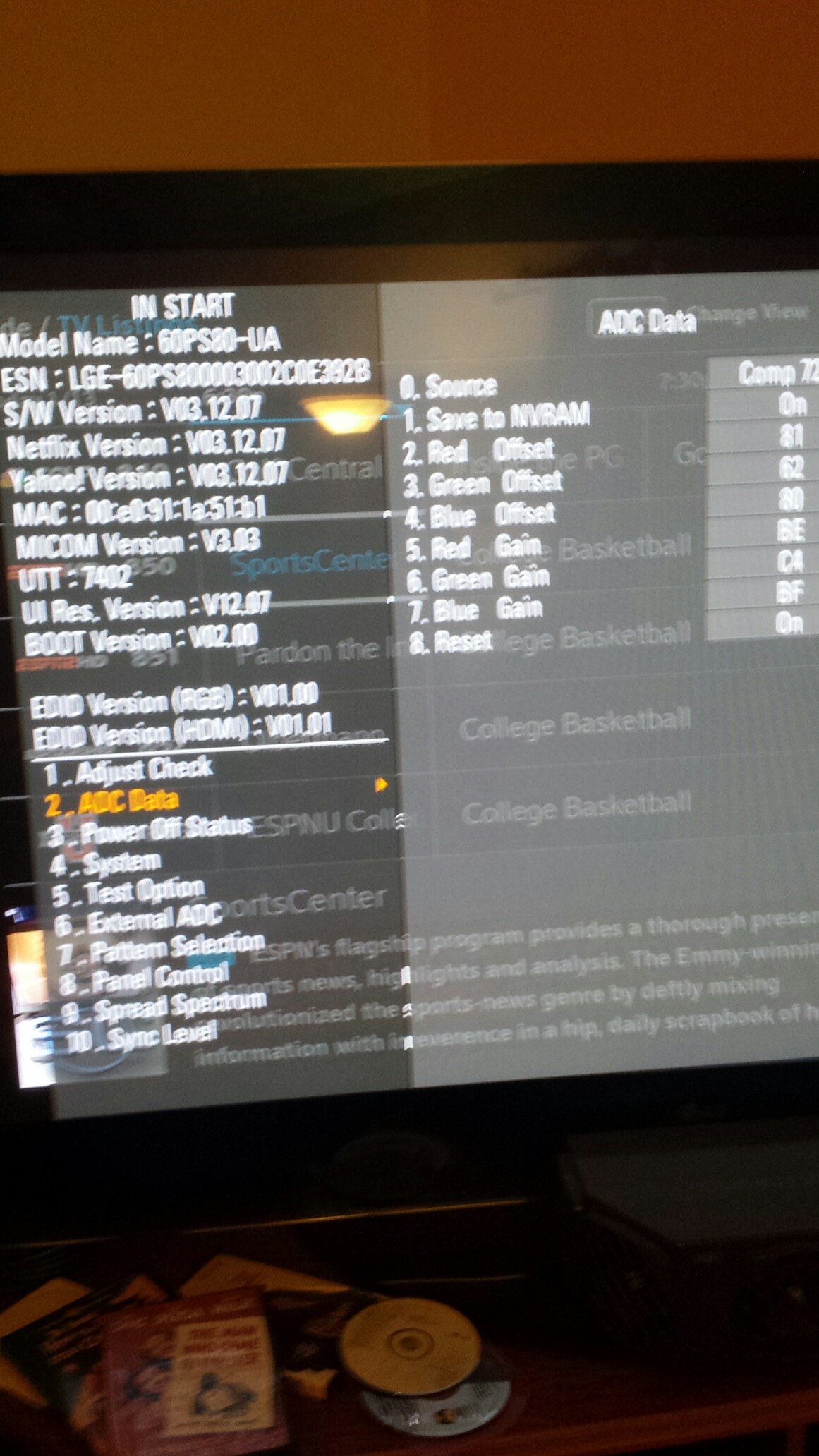

            tom66 & shinju- my first picture attachments -- I tried to photo everything that even had the word reset in it! Anything look like it will do the trick?

              Oh yes, LG is super cryptic. I don't recall the exact steps but I think there was another menu that would pop up when trying to access this one and I changed a setting in System and it reset the TV.
              I think you might have to have the special LG service menu remote control for some of these newer LG panels. Mine was a 42LH50-UC same Service menu from the looks of yours. I wish now I would have wrote down the steps, unfortunately I don't have the LG panel anymore or I would backtrack and help.
                Re: LG 60PS80-UA Plasma: All HDMI Inputs Show "No Signal"
                Check under Tool Option1,2,3,4...

                    I did find a place to reset HDMI inputs on EDID/IL. Did that, it said "rewriting" for all the ports, then showed OK - but no help.
