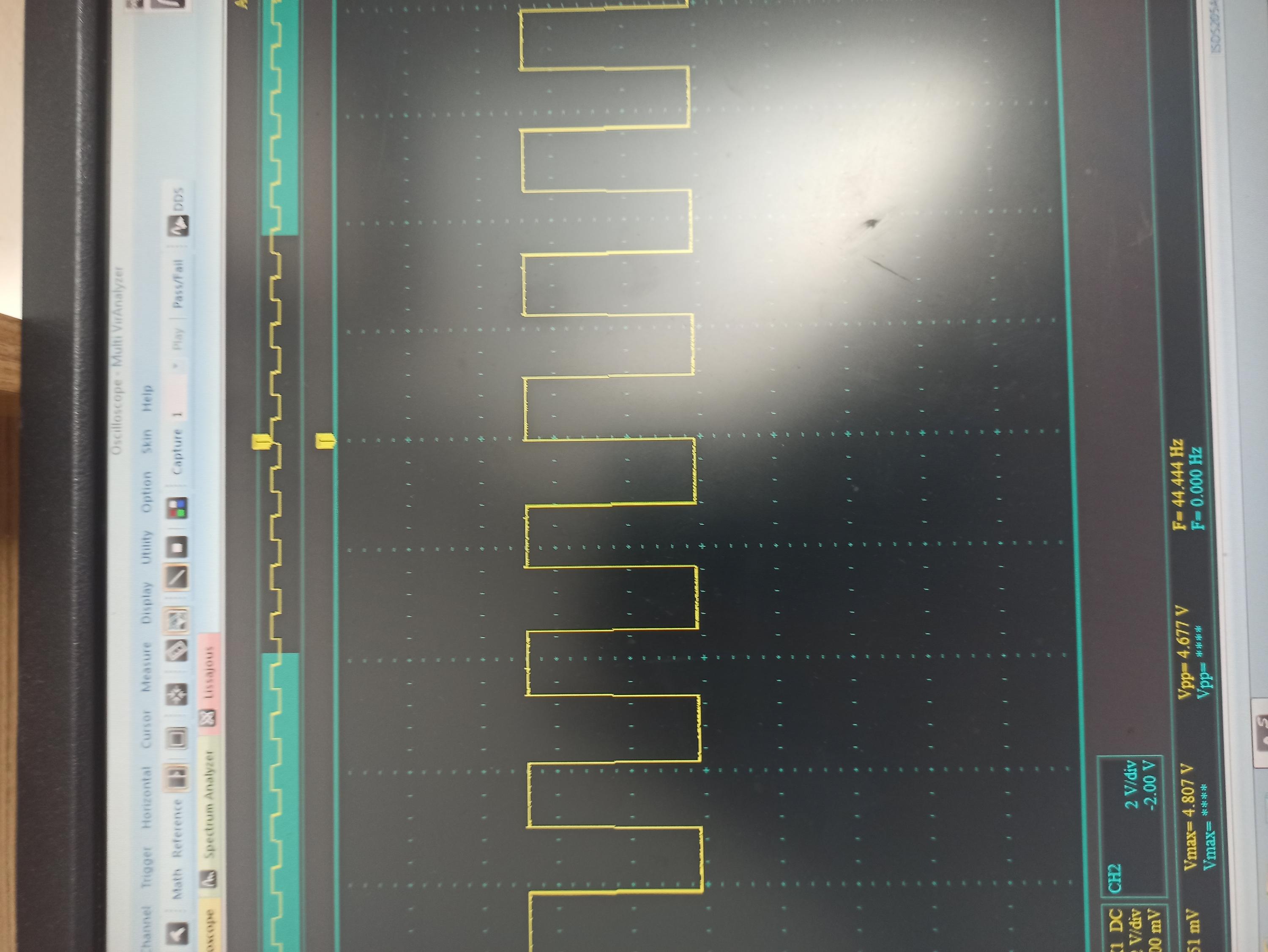

    Hello.
    Have this old Lenovo T61 that shows FAN ERROR, but Fan working, sensing works, Q81 makes FAN_FRQ signal, but system still show FAN ERROR
    any hint?

    is FAN_FRQ (Fantech) reaching on SIO?

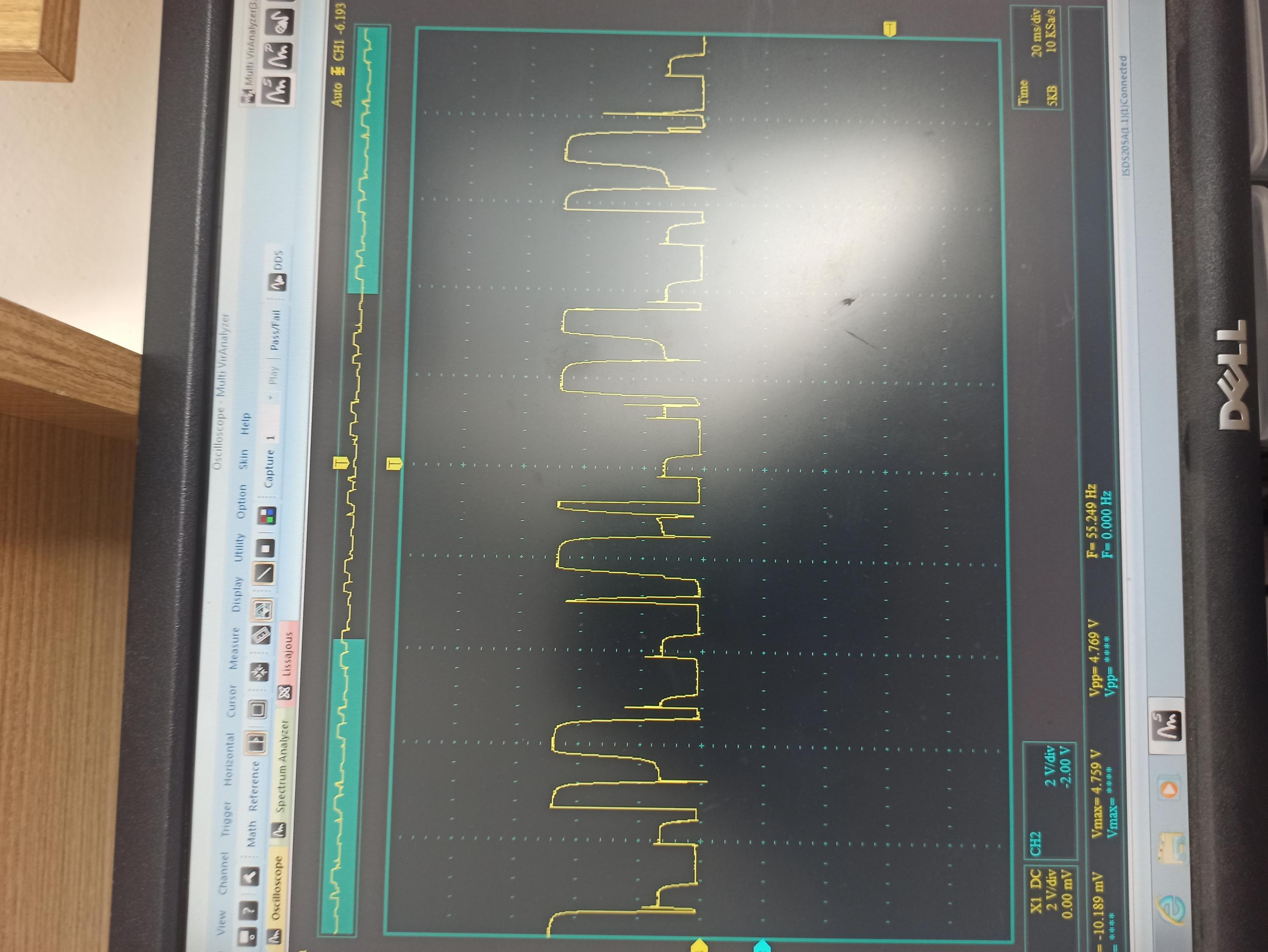

      maybe i was wrong about that fan is ok.
      I have nice square signal , but after few seconds signal from fan start to be very distorted. it think that signal from fan is bad but can be that distortion made by transistor Q81 ? signal come to base so i dont think but....

        Re: Lenovo T61 Fan working, Q81 makes FAN_FRQ signal, but system still show FAN ERROR
        after fan replace everything is ok, so it was bad TACH circuit in fan
