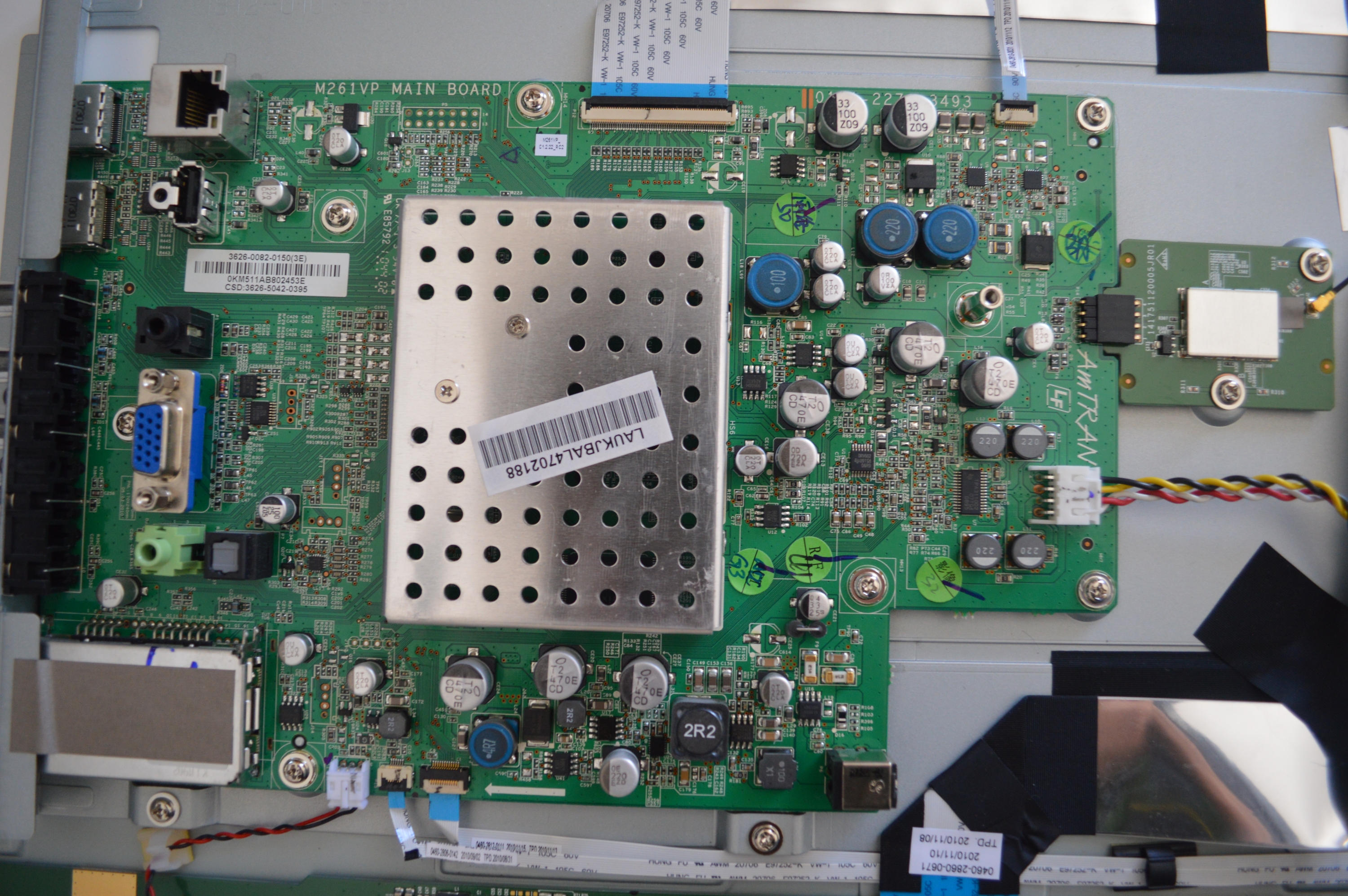

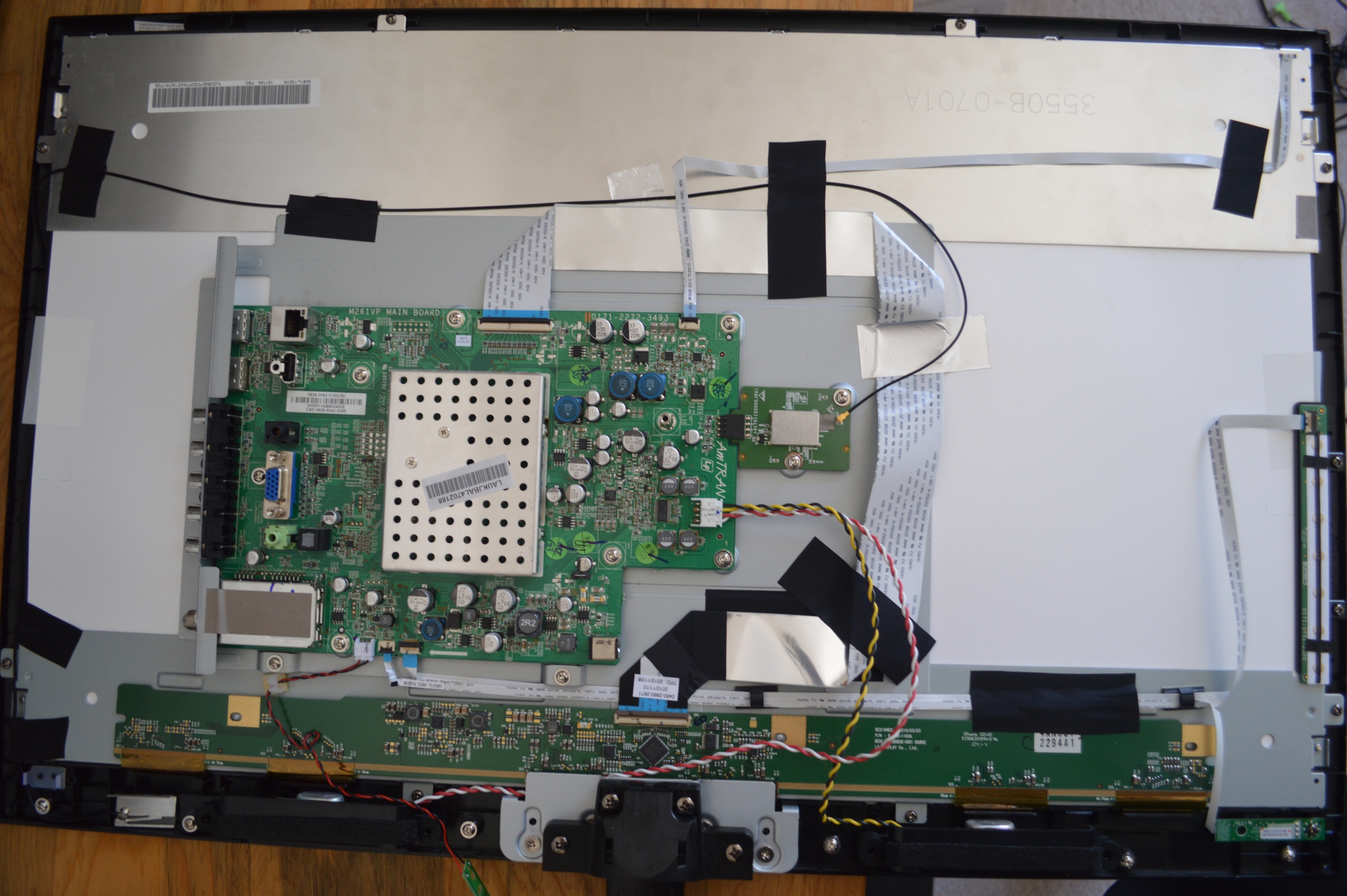

    Hi, guys. I have a problem with my Vizio LED TV, model: M261VP
    Currently the TV will attempt to power on and the power light blinks white for ~30 seconds, and then the light turns on for a few seconds and then the TV powers off. Nothing appears on the screen and the backlight does not turn on either. No sound is audible.
    I found this, but I do not know where that capacitor is. All of the capacitors seem solid, and not bulging. If it is a tiny one, where to find a replacement:
    Originally posted by jimg1948
    I thought I would post a progress update on diagnosing no video problem in case anyone has the same problem in the future. I removed what I thought was a shorted Schottky diode from the video display board power supply. To my surprise The short was still in the circuit. the diode checked ok. So after more diagnoses I determined bypass capacitor C71 on the display board (t-con) was causing the problem. Removed the capacitor from the circuit and the short disappeared. Reassembled the set without the bypass capacitor and I now get video. The video however is flickering and producing some black horizontal lines. The missing capacitor may be causing to much ripple in the power supply or there may be another problem yet to be discovered.
    I thought that the issue might just be the LED panel had gone bad, as noted in another thread (see below), but I tested every LED, and the connections seemed solid.
    Originally posted by popzoo42
    i have seen many of these units having backlight issues and in my experience a lot of them have been bad soldering on the connector right on the board with the led's on it...in order to repair u need to dismantle entire set down to getting led strip out...with it still taped to metal and resolder the actual connector pins back to the board( sometimes u can see that the connector is actually shifted off to one side) hope this helps
    Anyone have any ideas of how to proceed? I have searched Google extensively and the only thing that seemed to work for some people was the LED panel but mine seems fine in terms of the connections.
    Special Notes:
    -LED TV, all 84 are able to be lit externally
    -External Power Adapter (19V, 4.74A)
    -2 Years old
    -Internet capable (if useful?)
    -Special Reset Tried (Power button 30 seconds while off)
    See link for High Res Image:
    https://dl.dropboxusercontent.com/u/...9/DSC_0207.JPG
    https://dl.dropboxusercontent.com/u/...223_101829.jpg

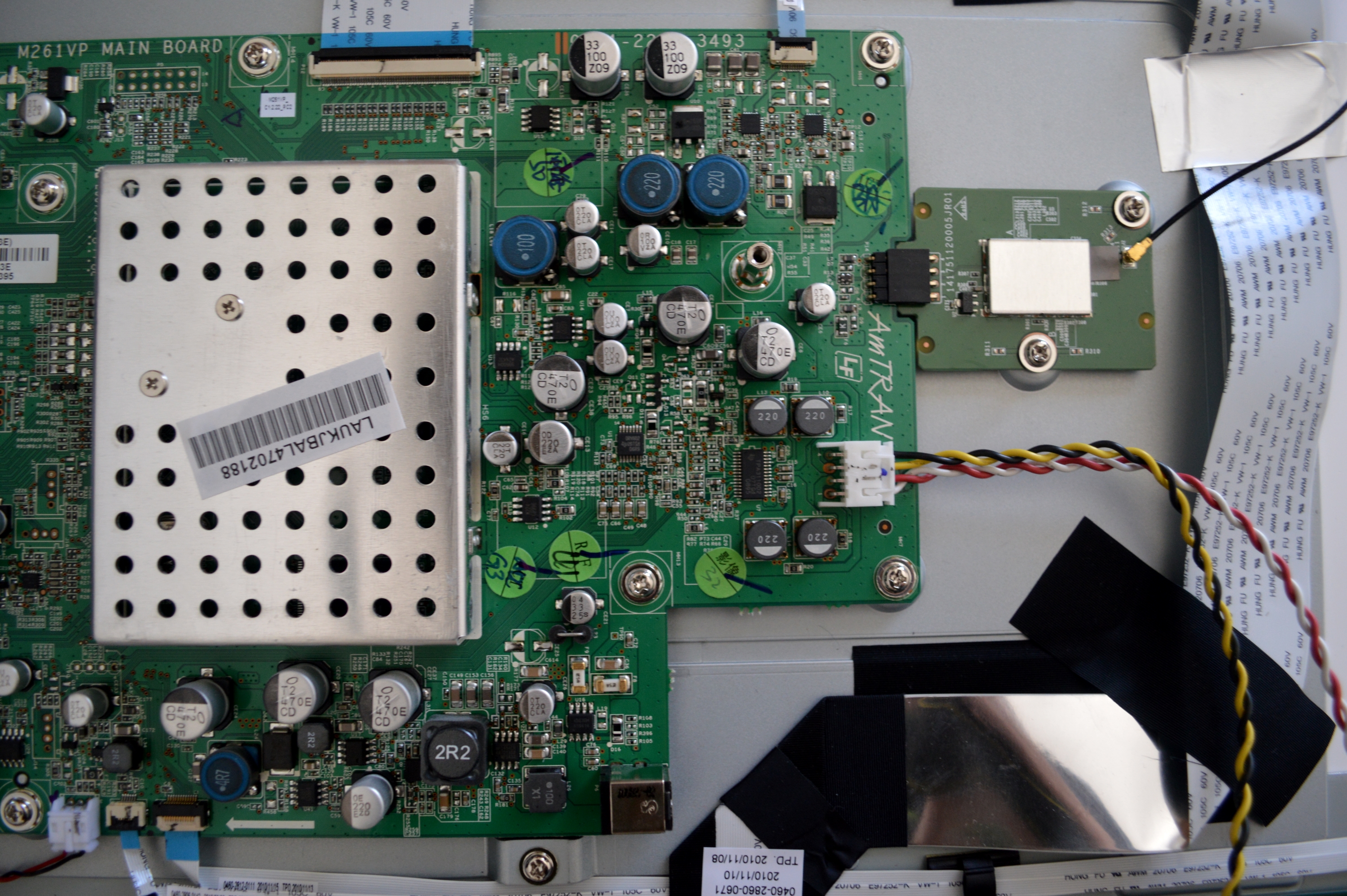

                                      I checked all of the LEDs in diode mode and they all lit up with my multimeter.
                                      Okay, so I measured the voltage regulators and what was labeled as U10 did not look like U9. See image:
                                      https://dl.dropboxusercontent.com/u/...69/Circuit.jpg
                                      -U9 to carry about .25V
                                      -U10 to carry nothing, based on the pins I measured.
                                      -U8 carried 18.5 V
                                        Re: Vizio M261VP Not Turning On
                                        OK, the info on 3-pin Voltage regulator 1117 series:
                                        Looking at it with the big tab (internally connected to the center pin pin2) up.
                                        The left pin is GND if it is fixed output regulator, if it is ADJ output then the Voltage between this ADJ pin and the output pin (center pin/big tab) should always be 1.25V.
                                        The right pin is the Input pin.
                                        The out put Voltage of the ADJ regulator will be = to the Voltage on pin 1 and circuit ground + 1.25V.
                                        So please take the readings and report the result in the format as shown in this thread:
                                        https://www.badcaps.net/forum/showthread.php?t=22231
