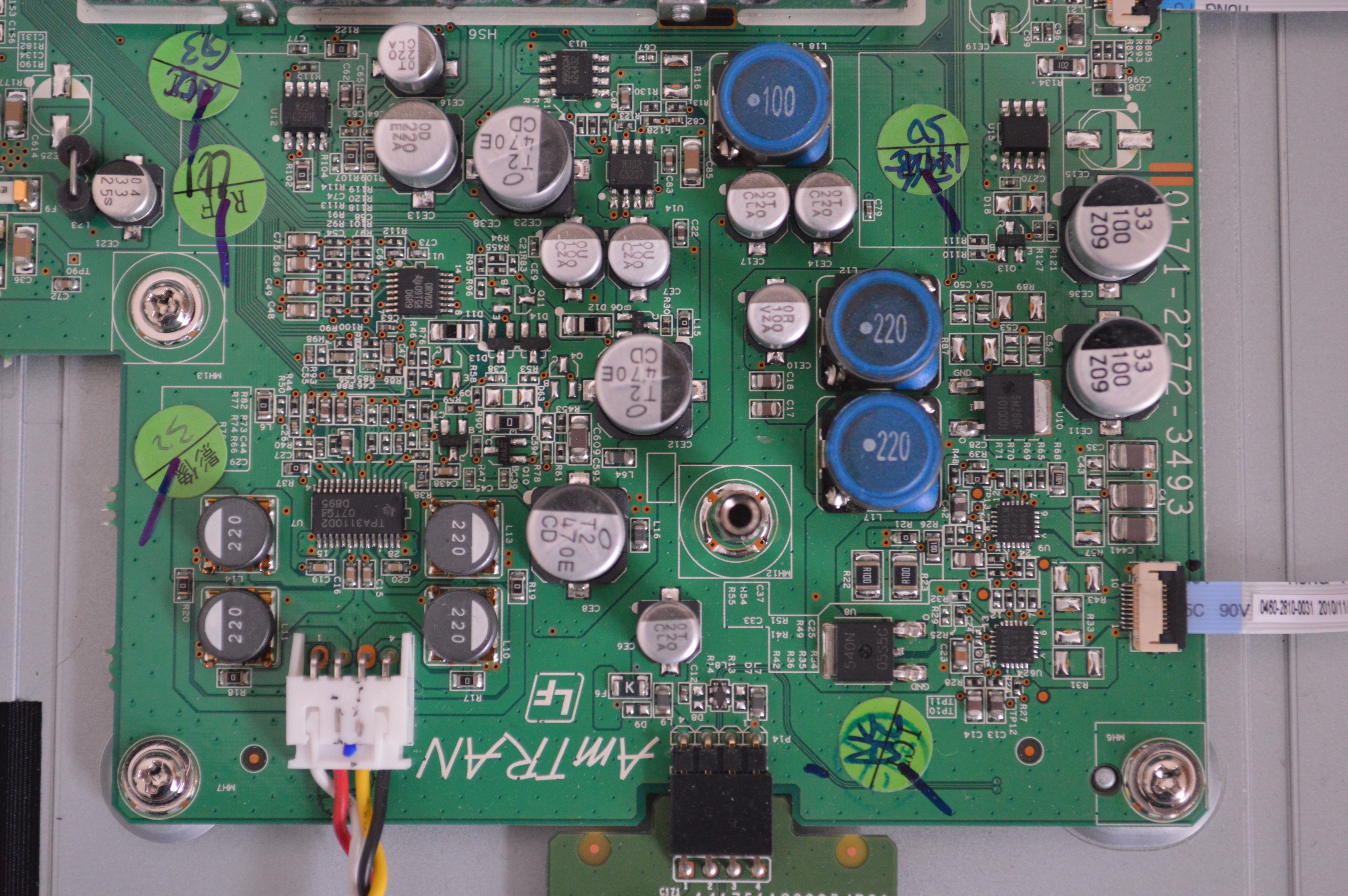

    I checked all of the LEDs in diode mode and they all lit up with my multimeter.
    Okay, so I measured the voltage regulators and what was labeled as U10 did not look like U9. See image:
    https://dl.dropboxusercontent.com/u/...69/Circuit.jpg
    -U9 to carry about .25V
    -U10 to carry nothing, based on the pins I measured.
    -U8 carried 18.5 V
    I couldn't quite read the #U8 correctly from the other pic. That's why clear pics are important. I was thinking on U8. However, one of them, U8, U9 or U10and maybe the one to the right of U9 (is it U6?) isn't working correctly. But I would check those regulators U8 and U10 first. Also have a look at these little surface mount caps and see that they are not shorted.
    Kind of looks like there are 2 power supplies, one supplies the left side and the other the right side of the LED's. Great! now you got something to compare, if components are the same. Now a schematic would be nice!

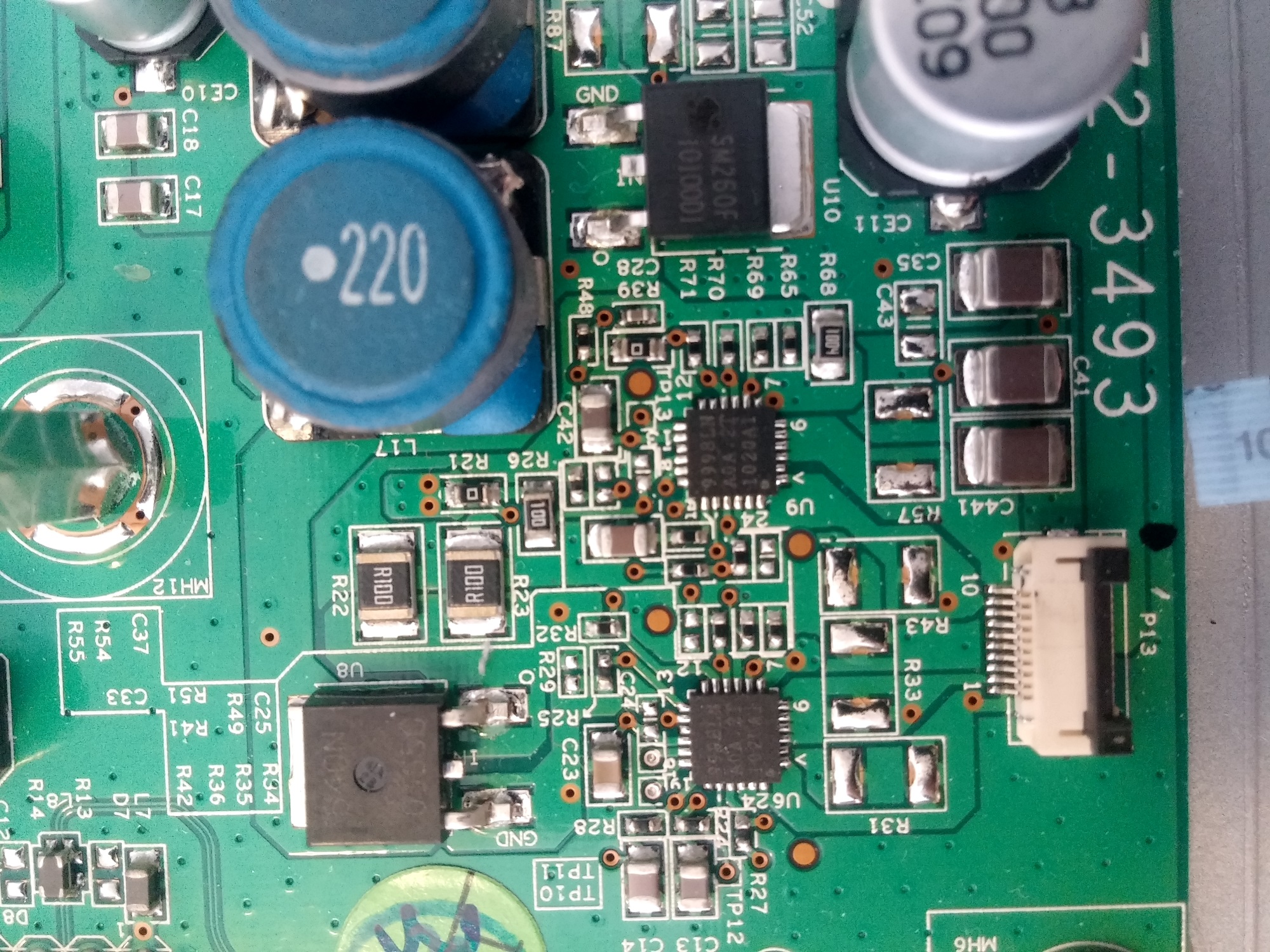

                Turn the tv on and measure u8 and u10. Put the negative lead on the GND pin on each individual regulator and measure the dc voltage. See if there is a difference between U8 and and U10. You need to figure out if there is any input voltage to the regulator. GND (left pin) middle pin is output of the regulator and the right pin is the input voltage. The tab of the regulator and the middle pin have the same connection. The difference between the input voltage and the output voltage is 1.25V. If that isn't within 1%, the regulator is bad.

                  Okay here are my results:
                  U8
                  Middle Pin (Output) = 0.23 V
                  Right Pin (Input) = fluctuates between 0.01 V and 0.09 V
                  U10
                  Middle Pin (Output) = 18.91 V
                  Right Pin (Input) = 0.00 V
                  That seems reversed to me from what you said, but it looks like they are both bad? Your help is much appreciated.

                    Well, there is for sure no backlight then when u8 doesn't get any input voltage on regulator. What is the part number on u8? Now we need a schematic to find out why one regulator (U10) has power and the other one (U8)has not. My bad on the pin switch on the regulators, O is output and middle pin or tab is the input on these.
                      #30
                      Re: Vizio M261VP Not Turning On
                      "The difference between the input voltage and the output voltage is 1.25V. If that isn't within 1%, the regulator is bad."
                      Please make the correction, the ADJUSTABLE REG IC (1117 series) will have 1.25V (+/-2~3%) between the ADJ pin and the output pin, it cannot have 1.25 between input and output otherwise it will not regulate the output voltage.
                      OP, it is important that you also provide P/N of the ICs as shown in the thread on how to test the Voltage regulator.
                      Some of these regulators may not have input voltage until all the power supplies are turned on.

                                So here is what I have (post #28 has mismatched values):
                                U8
                                P/N: 540N 05S5G
                                Middle Pin (Input) = 18.91 V
                                Right Pin (Output) = 0.00 V
                                U10
                                P/N: SM260F 10100DF1
                                Middle Pin (Input) = 0.23 V
                                Right Pin (Output) = fluctuates between 0.01 V and 0.09 V
                                High RES: https://dl.dropboxusercontent.com/u/...228_132020.jpg
                                read a post by tom66, think it was yesterday when I read it, he said a barely audible click meant something, cant remember exactly but I think it was to do with an IC, I could be wrong about if he said IC but it had to do with a very faint click issue. in reference to post #5
                                I was thinking about that and it seems likely.

                                  Dunno what a sm260f is, but see what feeds the tab of it.
                                    #37
                                    OK, those two regulators (now we know they are not 1117 series since we see what they look like now)
                                    U6 and U9 are probably the SMPS IC or LED drivers. I cannot tell. Can you take larger area to see more parts in that area?
                                    I cannot read U6, U9 P/N. If we can get the spec of these two ICs then we may have some idea how this circuit works.
                                    The more I looked at those U8 looks like power MOSFET for driving the inductor boost regulator circuit.
                                    The GND pin looks to be Gate pin which is driven by U6 pin 13 through resistor R25.
                                    the O pin looks to be the Source pin.
                                    https://cdn.badcaps-static.com/pdfs/...23be5e315f.pdf
                                    U10 GND pin and O pin seem to be connected to the same ground plain. Can you check the resistance between GND and O pin?
                                    I think U10 is a Diode (Common Cathode at the big tab) which is connected to the + of the filter cap CE11.
                                    You can verify U10 by using Diode mode, the big Tab i Cathode, the two legs are the Anodes.

                                      See attached. See Dropbox link for High Res: https://dl.dropboxusercontent.com/u/...9/DSC_0322.JPG
                                      I can confirm that the resistance between the GND and O pins on U10 is almost 0 ohms, and they seem connected.
                                      For U10, the big tab (cathode) and the GND and O pins (Anode) gave me a diode value of 0.343 and 0.324.
                                        #39
                                        So at this point you cannot trust the prints on the board, U10 is Diode.
                                        So what are the P/N of U6, U9?
