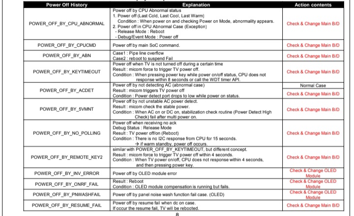

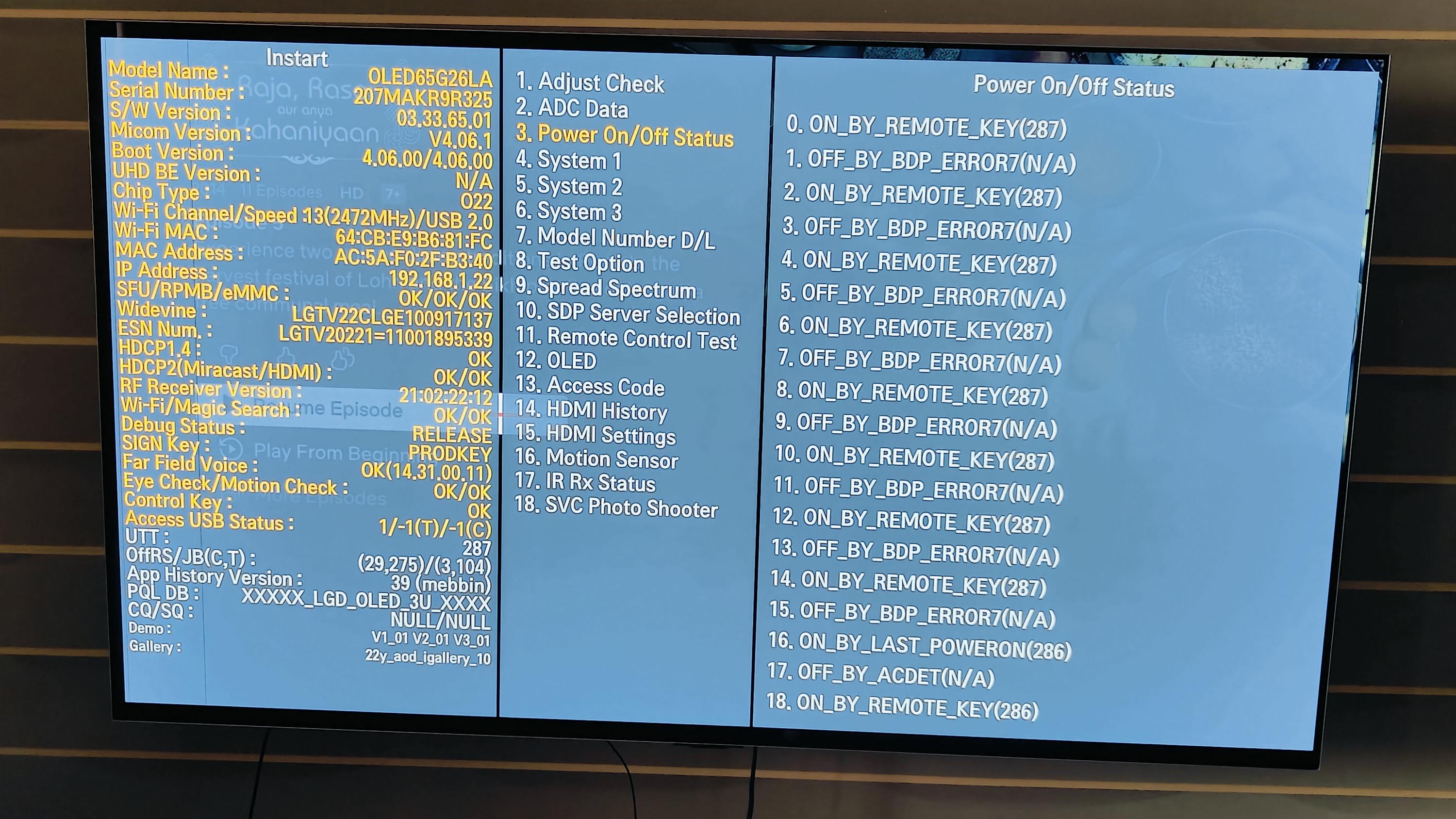

        So, I just received my LG service remote, and checked Power on/off status: the error message I get for every Power OFF is "POWER_OFF_BY_INV_ERROR(0x1E). I will attach the picture with this.

          I am not well versed in OLEDs like diah is, so more take his advice but Inv error is on this service.manial and the fix-if you can call it a fix-as well. Maybe helpful? This is from C9 manual though I'm sure similar
          Also my thoughts on if it's a power issue why would you change the tcon? I would think power supply and then main board first. But just asking as maybe I don't know something.
          But I think the manual is saying the "module" and is referring to the panel. Maybe diah can answer
            Yes you are correct, there are issue on OLED Cells which pulls high currents when they start ON. so the firmware section at the T-CON driver boards monitor this currents and when it exceed the T-CON will send SOS signal to Micom on the MB which it order the power boards to turn OFF.
            since you have S. RC. do the following
            1- turn off the set complete from wall socket too
            2- Gently with yours finger click on the screen surface corners and middle points., also you can try slowly to curve it from the side.. but don't do it in hard way to avoid the surface of Panel damaged.
            3-disconnect the 24V socket only ,, and turn it on normally ... wait until you have the sign its ON ( as i described before )
            4- send with yours S. RC IN_STOP one second later follow it with 0413 the TV will go to Stand BY... if it did mean it received IN-STOP correctly
            plug it out from wall socket again... and do the point 2 again
            5- after 5-10 minute from yours points 2 plug it in wall and tuen on.... wait enough time to have the set roll back the firmware and the Optic out put lit red...
            now connect back the 24V socket and yours eyes on the screen..... hope it will remain on

                      Hello Diah, thank you for your reply and support throughout this process. I tried your method a couple of times today, but it hasn't worked its magic yet. The TV is still suffering from the same issue. I will continue to try out the method and monitor the results. Just to clarify, when you said "finger click on the screen surface," do you mean to tap on the screen or make a firm press on the screen? I did try both ways, but it hasn't shown any results, so maybe it isn't a difference maker.
                      I do want to mention this, though. On the day that I tried your FIRST method, and it seemed like it wasn't going to fix it, I posted the error message I found with S. RC. (POWER_OFF_BY_INV_ERROR), and about an hour or two later, the TV started working. It continued to work until this morning when it stopped working or regressed back to having the same issue after I had the brilliant/stupid idea to factory reset the TV. So, it hasn't worked since, nor after I tried your second method.
                      If there are any other ways that I can try to fix this TV, I am all ears. And again, I am appreciative of your support thus far.
