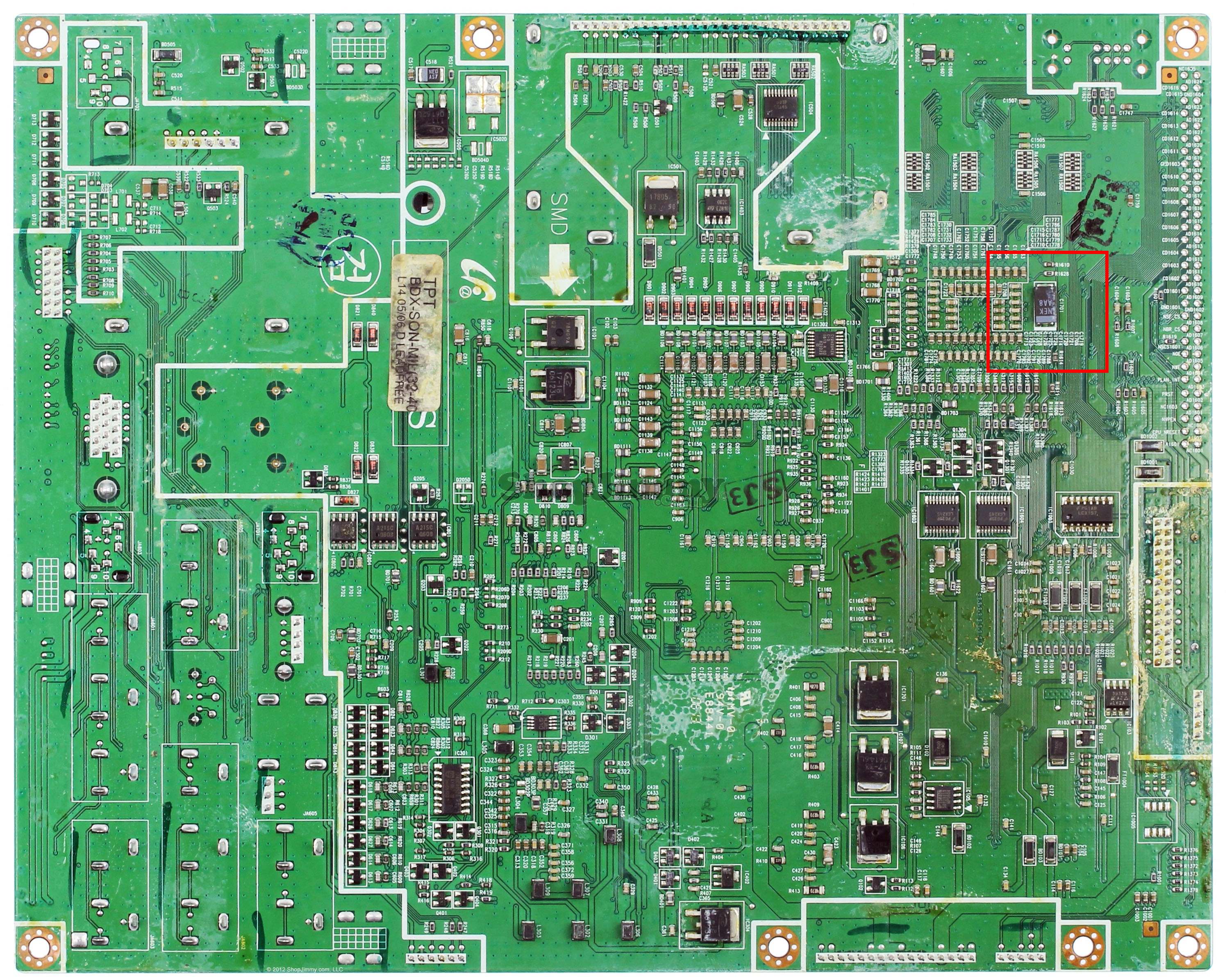

samsung LN-S4051D diagnal lines

    quick question: could there be a bad IC on power supply, yet still get all the proper voltages at the connectors on power supply, thanks.

            got bad reading from diode ds805 read in board .058 in both directions, tried to take it out to read it but broke it, no solder skillz at all lol, also diode ds804 read .344 is that too low?, hard to read numbers on tiny diode , looks like GP v8180 n493 or n498?, does that sound like a familiar diode, I messed up label a bit getting it out, Thanks.

                    can not figure out which diode to order, appears to be a gp, n493, dont see it anywhere.
                      #30
                      Re: samsung LN-S4051D diagnal lines
                      What do get using Ohm mode to check the Diode?
                      Location of that Diode?"
                        #31
                        They were talking about the caps on the power supply board.
                        I never seen this symptom like this before.
                        Last edited by budm; 12-31-2014, 03:42 PM. Reason: Coreection on the lines on the screen
                          its this diode, wanted to check it out of circ. but I broke it taking it out, its tiny, I believe its a power/rectifier diode, thanks for reply budm.
                          • splitcrete
                            • Dec 2012
                            • 387
                            • usa
                            #33
                            Check caps cm 807,808,809,811,812,817,cs806
                            Check diodes ds801,802,803
                            You just may find a couple of them bad.

                              hi splitcrete, I dont have an esr meter to check caps, checked diodes,801,2,3, checked ok in cir., 804 was .344, 805 was .058 in both directions, tried to take it out to measure out of cir. but it broke, or is there a way to measure caps with the mm.

                                theres numbers on the tiny diode, I couldnt match them up on digikey, pretty sure its a power/rectifier diode, black with the grey band, numbers on it are v8180, n493, gp, Thanks for helping, not getting too far with this one.

                                    do you think a bad diode would make that snowy horizontal like picture?

                                        That model tv is known for bad panels. I would change the caps,and diodes to see if any thing changes.
                                          #40
                                          Which one of these is you board?
                                          http://www.shopjimmy.com/samsung-bn9...ain-board.htm#
                                          http://www.shopjimmy.com/samsung-bn9...main-board.htm
                                          Does your board have this cap?
