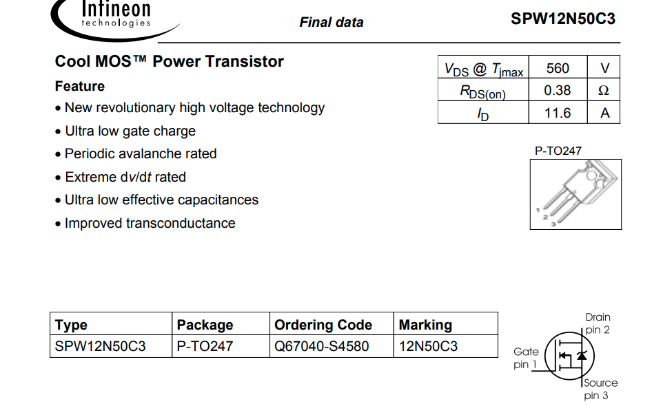

              think i found a bad mosfet, QI802, read funny, took it out, getting 192 ohms from drain to source, isn't that way too low?
              • lotas
                • Jan 2016
                • 4752
                • Russia
                #107
                Re: samsung LN-S4051D diagnal lines
                Discharge its mosfet (short all three legs with a metal object) and check again with a multimeter.

                  #108
                  ok, shorted all 3 legs, it's 197 ohms drain to source.

                    #109
                    I think I messed something up earlier, I was trying to test voltages on that mosfet with tv on, had a probe on neg. of bridge rec. and when I touched drain or source it was one of them, then the backlights went out, now they won't come back on even after heating that small section like before, but the damn thing did quit clicking every 5 seconds.
                    • lotas
                      • Jan 2016
                      • 4752
                      • Russia
                      #110
                      Well, if the mosfet has broken, you need to check all nearby components for breaks and short circuits (resistors, diodes, zener diodes ...). After that, you can install a new mosfet.

                          #112
                          The mosfet should not have low resistance between the drain and the source (if a diode and a zener diode are built into them), then a multimeter will show a working mosfet as you check a regular diode.
